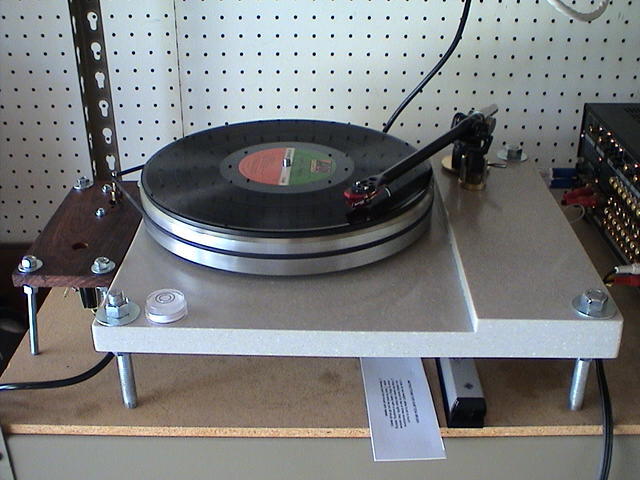

I bought an Empire 208 a while ago, and used the guts to make a new table.
They are not as sought after as the more famous Garrards and Lencos, so I think you can find them for better prices.

There was a reference Empire turntable made some time ago by Atmashere. They called it an "enhanced" Empire 208. There are certain tables that I have always coveted, and the Empires are in that group. Love to see some photos of it.

Here's an old pic of my "Empire". I made a corian plinth for it, so it doesn't look like an Empire anymore.
Randy

randy: interesting blog. The table looks pretty good, except I would use a "sub-plinth" or second plinth of wood. It can help to stabilize the tall all-thread legs you use. Dito for the stand alone motor pod.

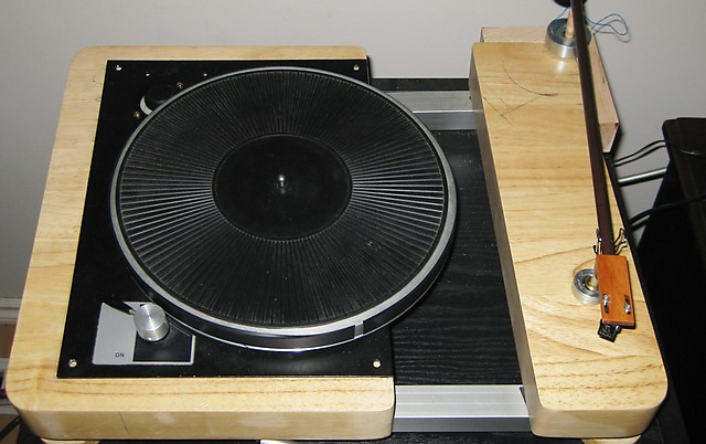

I think the smartest thing one can do if wanting to build a complete new table is to re-plinth an existing turntable, such as my Sugden BD-1, add a new/better/modern tonearm with the required wiring, and a suitable cartridge.
As I stated previously, the gutted changers with my 219 arm run in the same league as a Roksan Xerxes MkI/modded RB250/Ortofon MC3Turbo cartridge (about $7k-$8k to replace with current models) and my Oracle Alex MkII/SME309/Grado Sig8 (similar cost to replace with new production, as the smallest Oracle table with suspension is the DelphiV, there is the suspensionless Paris, and no Alexandria).
