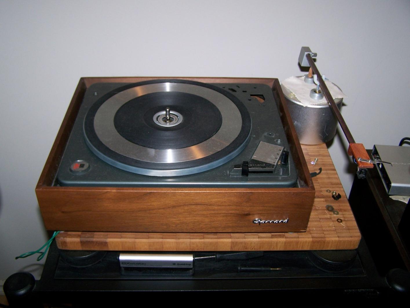

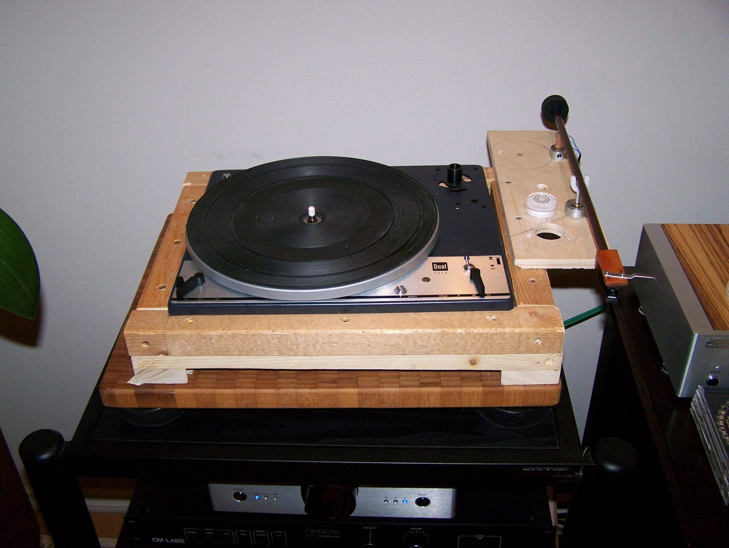

I'm a bit embarassed at my workmanship with my plinth and tonearm which are still in the prototype stage.... when i get them in their finished state, i'd love to share
Embarrassed? Say it isn't so.

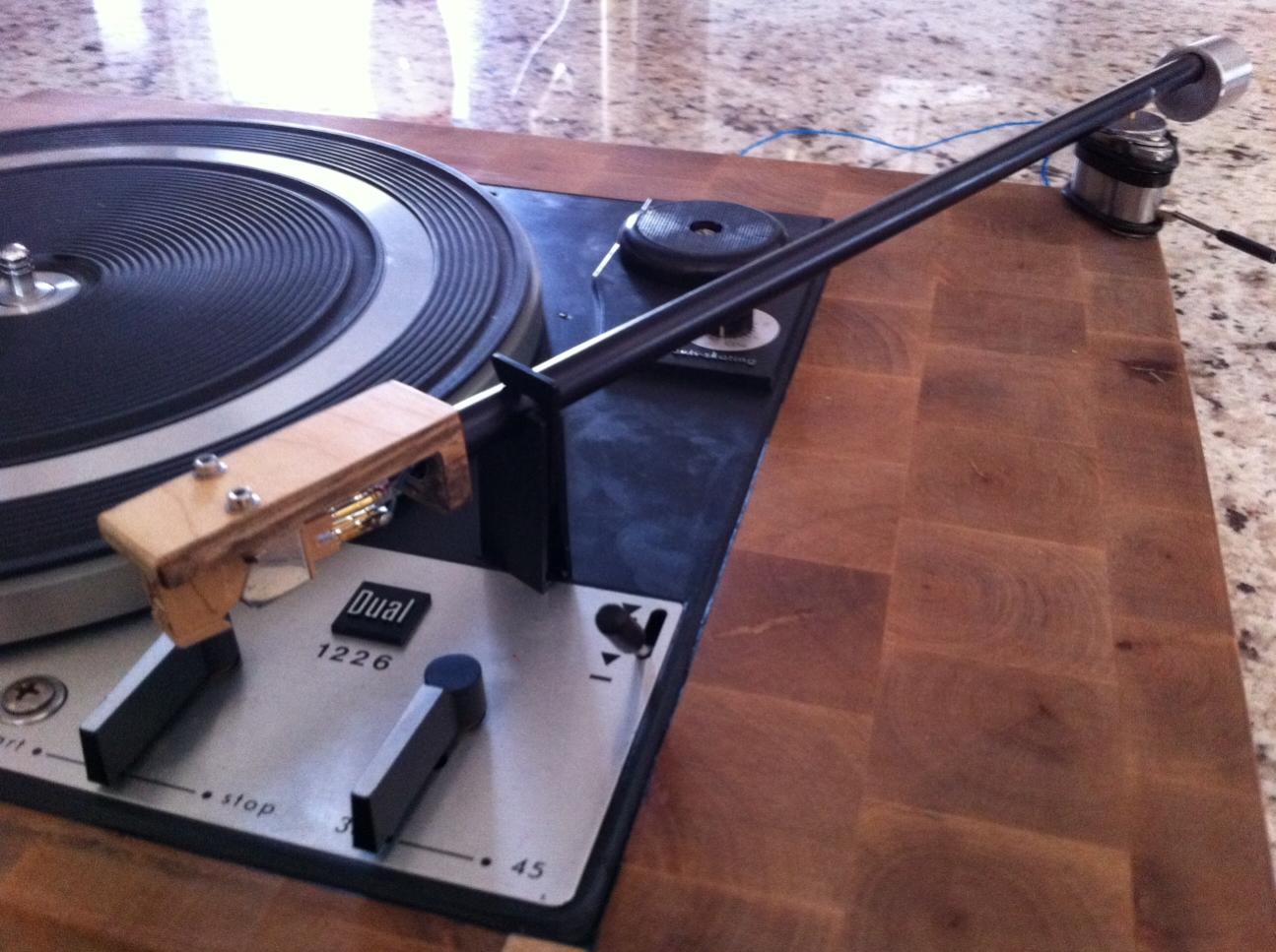

Seriously, i don't consider my workmanship to be photo-ready but it was very easy to build and sounds fantastic. Make sure you get the right silicone fluid and use nice floppy tonearm wire to make cable dressing easy. I used graphite for the shaft... was easy and cheap to build- a great combo! I was astounded at how good it sounds...

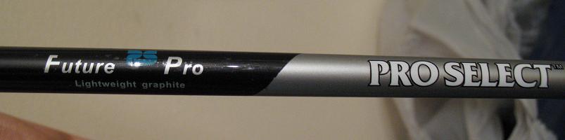

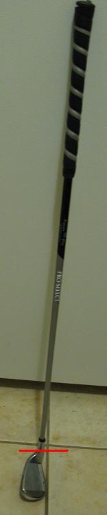

Here is my golf club. Graphite not carbon fibre how I wrote, if there is any difference between the two material.
I will cut it done at the neck to see if hollow all the way. If yes I will buy the titanium and the graphite boron mixture to.

here's a photo of my "fugly Dual". This is with an earlier arm and without a top plate for the plinth.
And it looks terrible but sounds great.

The golf club arm has to tick wall. At the neck 2mm and about 18" another side 1.5mm.

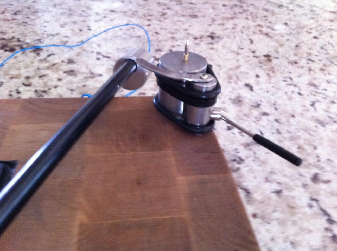

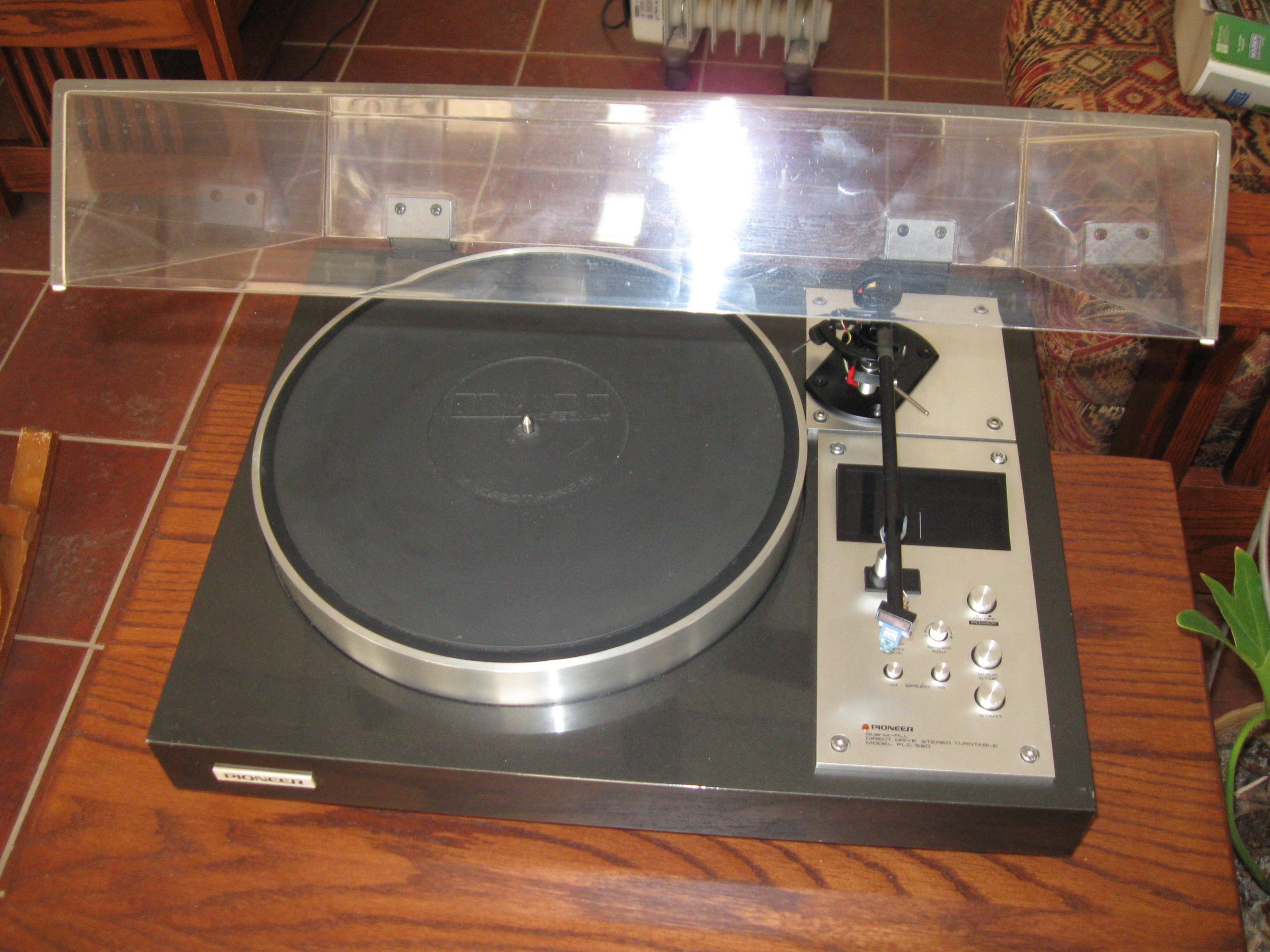

gaborbela: Yes, the whole point is that it sounds great. The arm presently looks good too! Really similar to your ideas for an arm. I use 70ksi + arrow shafts (Easton). They are relatively cheap, and very easy to get. Ti may be better, but no Ti was easily available here. I like the idea of using "made in the USA" (or Canada ) products as much as possible. Often "True Temper", and "Easton" branded stuff is produced in North America, and for me that is a no-brainer. Carbon fiber hafts are as well, again using arrow shafts. Even the lower quality shafts have a very good spec. The only titanium arm I've had experience was an old Alphason that I wish I still owned.

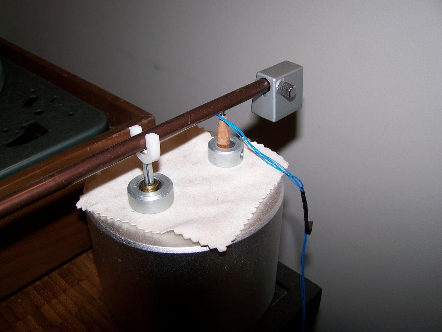

Info on the arm: The arm itself has a effective length (pivot to stylus tip) of approximately 305 mm. I never bothered trying to make or have made a headshell that has any offset angle. I just use smaller bolts (2mm ) to retain the cartridge. That way alignment can be easily done by loosening the bolts and twisting the cartridge. The headshell is a custom piece done by a friend of a friend. I have since been able to get access to a end mill, so I can make headshells now that are absolutely accurate. The counter-weight is a salvaged piece from a Garrard LAB60. I can now make a similar piece myself, again using the end mill. The great thing is based on this trapazoind design, once a location is found that allows for correct VTF and azimuth, you only have to finger tighten it. Similarly a disk of material could be used, using a similar arrangement, but with an offset hole, thus ensuring that the centre of gravity (c.o.g.) of the counter-weight is lower that the centre of the shaft, and (I haven't done any calculations) approaches the same plane as the stylus. I'll take a couple of photos of the current configuration.
The pivot point is above the centre of the shaft. The female portion of the bearing is installed into a carrier that is glued in place. I use a precision 1 mm tungsten carbide roller as the pivot, installed in a metal carrier (a ball point pen nub). That is then installed into a shaft that can be easily adjusted. The shaft is held in place by a locking collar.
Finding the location for the tonearm is pretty easy. As I used a similar length as a SEAC 12" tonearm, I assume an O/H of 15mm. I then use my Oracle "calibrator" disc (Oracle's protractor), and adjust the location of the base of the tonearm to allow good alignment with the protractor. Once determined, I mark he plinth, so that if it gets nudged from the location, it is easy to put back. As I experiment with various alignments, I have yet to permanently fix the tonearm to the plinth. In a previous post, my audio partner's Dual 1226 is shown with essentially the same thing. He just used some 1" precision rod that he cut and tapped for a set screw to hold the pivot, and used o-rings to hold a tonearm lift.
I'm attaching a few photos of the Lab60 and the tonearm, as well as Mike's implementation of the tonearm. Any are appreciated (as long as they do not affect the sound). All three of the tables (the "fugly Dual", Mike's Dual, and the LAB60) easily bested my Oracle Alex MkII/SME309 MkII/Grado sig8, and Mike's Roksan Xerxes MkI/tweaked RB250/Ortofon MC3 Turbo.
Info on the Thorens headshell: I've also attached a marked up picture of the Thorens headshell. As long as the indicated edge of the headshell is parallel to the centre-line of the arm tube it should be fine. If not more work is required.

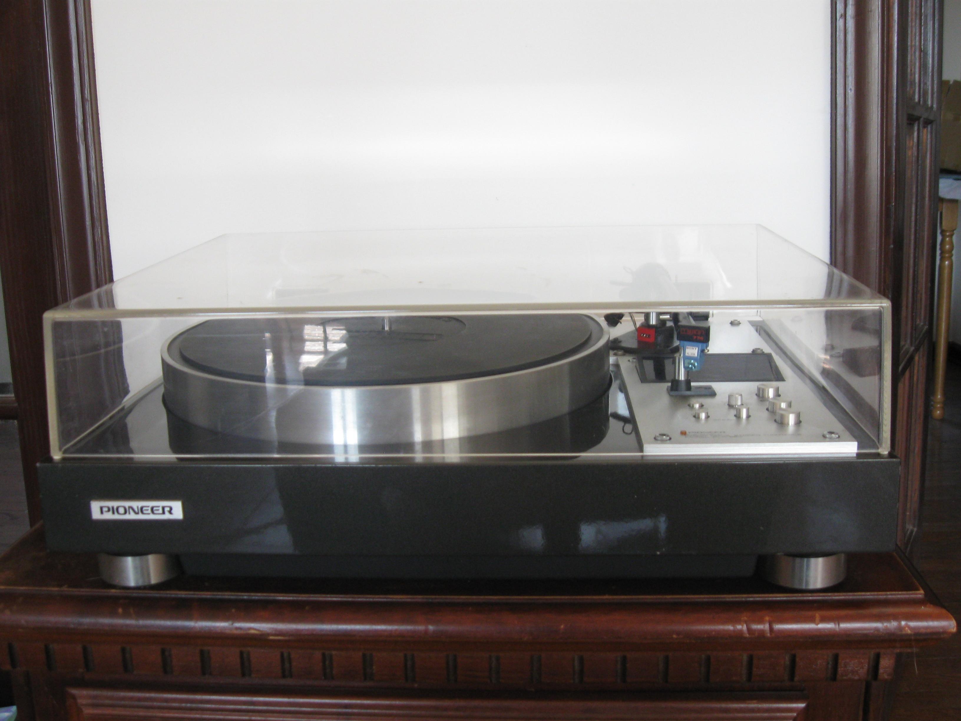

Cambe: I bet it sounds good. I think the PLC590 was the closest thing that Pioneer had to an SP10 or SP15. Certainly one of the best DDs that Pioneer ever made (and perhaps anyone), but I think they are quite rare.

Nannok do you think my graphite tube heavy?
Now 18" long now and weight 42Gr. I know is to long I have to cut done may be 3" or more because I still have to ad a head shell.

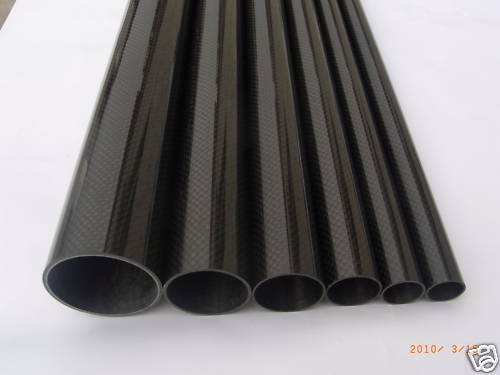

I found a great Carbon fibre pipe source 9mm inside diameter 7mm and another 7mm inside 5mm.
That is from China 2PC from each 50Cm long plus shipping cost $34. Picture att.
Very nice pipe, but I still don't know which material better, titanium, carbon fibre, graphite...
I do not want to waste money. If is good tube of course I'll buy it... Some opinion it would be great

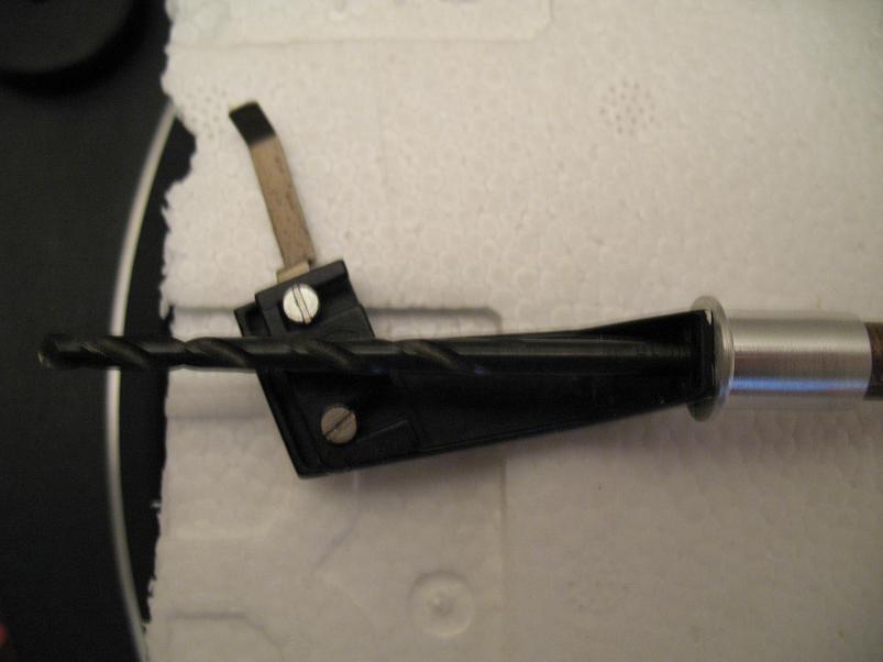

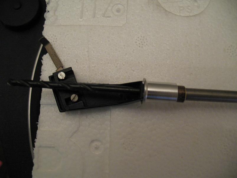

Yes I understand what you mean. The center of the cartridge (actually the needle) must be at the center of the pipe...
May be I get read of that head shell and I'll ad a 2mm piece of titanium for head shell

Hello Nanook
I made two picture where you can see the center of the head shell.
Actually the drill bit is the center of the pipe.
The cartridge mounting screws are attached to the finger lift not to the head shell. So if I move in angle the finger lift that moves the cartridge to..
With that I can adjust the cartridge to a position where the needle will be right at the center of the pipe.
Please look at the two screws and com pare the two picture to.
Right now it look like OK to me.
May be I'll make another head shell from the 2mm titanium I just purchased last night..
These Thorens was removed also from straight arm, what I do not like about the Z model.
Greetings Gabor
Greetings Gabor
