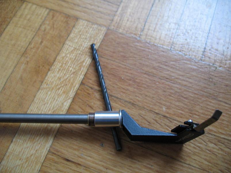

titanium tubing suitable?

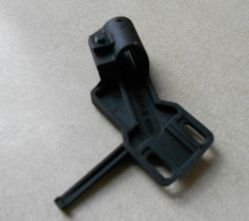

gaborbela: there can be "too much lightness" . As long as the effective mass of the arm is in the 12-18 gram range, then yes it can be used. If much lighter, than mass needs to be added. This can be accomplished by adding some sort of dampening material to the interior of the tube. Some place I read some one using EAR yellow foam earplugs to dampen an arm tube, to good effect. You may still need to add more mass to it.

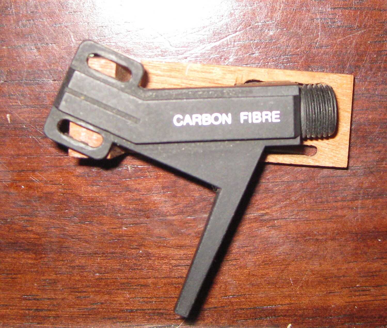

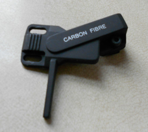

If using the Dual carbon fibre headshell, you will need to duplicate the arm geometry that it came from or cut it and alter the angle and then glue or repair it. I just found one of these in my office (and pulled it apart). The cartridge wire can be easily puled out along with the square plug that is in the headshell. Then it should be easy enough to run tonearm wire down the complete armtube and exit where you wish.
Hello
If I seal both end I can use oil for dumping it I have to ad more weight.
The weight of the tube 38G/meter.
That is around (minimum) what you wrote, I don't think it will be to light, com pare to the Dual aluminium thin arm these 0.4mm thick and titanium heavier than the aluminium.
Unfortunately that head shell getting very expensive. Very rare, I must get one if I want to test these tube.
That feet the tube nicely.
I bid 10 Sterling but I was out bid right away.
I must get these if I want to use that pipe. These for 5mm but I can enlarge the hole a bit.
Take a look at the pictures
Thanks for the advise🙂

Hello
I didn't knew these belong to the CS5000.
Even the guy who advertise wrote belong to 505 but it can't be because I have a 505 type II total different.
Now I understand why so rare these head shell.
With these I can use that titanium pipe and I can connect direct the wires to the cartridge.
I know it will be a lot of work to resolve the suspension counter weight etc.

The one listed on EPay is correct. The one for the CS5000 is different. I'll take a picture and attach it or post it later.

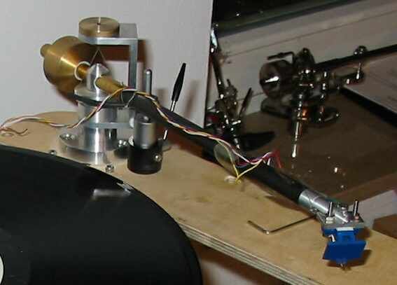

I think I would try similar type of suspension (more simple design, picture attached) something.
I have to do my own research to get some idea.

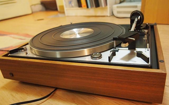

Hello
Yesterday finally I purchased the Dual 1229.
These very nice deck with the longest arm Dual ever made, over 3Kg platter, 3 speed, strong motor condition is great very little use. Of course idle derived.
Unfortunately I do not find cheaper for DIY turntable donor.
Some people sell these on EPay even for $400.
These has no dust cover but I do not need. I'll build my own plinth from solid Baltic birch as heavy as possible. Large enough to use two tone arm a 9" and a 12".
Paid $185 with shipping (from Vancouver) and pay pal fee.
I will get two cartridge, a Goldring and Oyster, lubrication kit, manual.
I will see how will com pare with my Elac.
I put up some ad I want to buy Lenco or these Dual but no answer at all, many people look Lenco or for these decks to get their hand on.😕
Greetings Gabor🙂

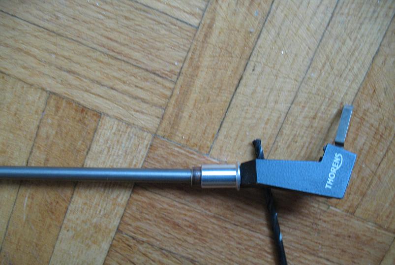

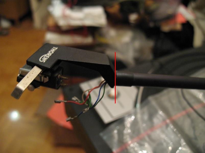

With the Shure came a Thorens tonearm parts. I want to take of the head shell to use it in my DIY tonearm.

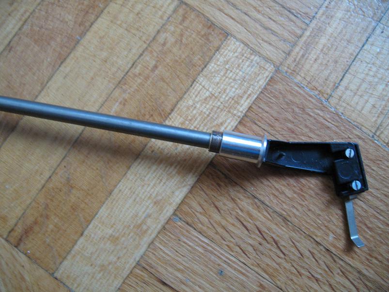

I have 6mm titanium tube I want to build a straight arm.
Did someone ever took of the head shell from these arm? I taught I ask before I start to cut anything. I would like to take it off at the red line. It has some movement but I do not want to break it. Only move a bit where is the read line.
Please take a look at the pictures.
Greetings Gabor

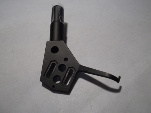

Hello
Just purchased another head shell for straight arm
The Thorens will work but way to light, I don't know if that will be a problem.
I want to test several arm (option).
Also when I build the plinth I will need help about the size, I want to use 2 arm.
One 9" and one 12". The 9" like usually mounth the 12" on the top.
I have to make large enough plinth to feet both arm but I do not want to build a diner table size deck.😀
For the 9" I know the right measurement but for the 12" I will nee some advise.
Greetings Gabor

gaborbela: first congratulations on all of your finds and good luck with the 12229 rebuild/re-plinth.
I have had a little bit of experience in regards to tonearms. So lets have a look at what you want to accomplish.
the Dual 1229: As you stated, an excellent turntable. Apparently the 1229 was the first "full sized" automatic table made by Dual. It is worth too much (in my estimation) to hack up and modify for a DIY table. A great table to repair and restore, and it will always have some intrinsic value. Many are sold in the $300+ range, so yo if yours functions well, I would clean it up and leave it at that.Make sure the cartridge stylus is in good shape, and enjoy it. (If the 1229 was a beater and not in good shape or incomplete I would suggest using the parts and bits to make your own). One area where almost every Dual suffers is that they often solder tonearm wires to a little circuit board underneath the tonearm and the wires from the tonearm become brittle. A tonearm rewire using a single run of wire to the phono input is the best bet for avoiding this problem.
regarding tonearms: The Thorens headshell looks as though it uses a fixed mounting for the cartridge. This means that the geometry of the original tonearm must be followed or the headshell must be modified to allow its use on a different length tonearm.
The other headshell has some promise for use on any length tonearm. If the headshell to tonearm angle (O/S angle) can be altered a few degrees then it has the potential to allow easy modification for use with a much longer tonearm. I might suggest cutting the headshell or remove it from the existing tonearm further down the arm tube.As it has slots for some adjustment of the cartridge in the headshell you may even get by without having to alter the angle much.
regarding either headshell and its mass: Mass can always be added to a headshell as needed. Small lead weights, washers, etc (even the venerable "penny") can be added. This can also be used to help reduce the resonant frequency of the arm/cart/fastener system.

I have two factory arm in case (com pare with them) one from a Kenwood KD550 and the other from Yamaha YP 801 BL.
Both great condition.
I have a question to you. Do I stick to metal arm (as a material) or it worth to test some carbon fibre pipe to.
From that Thorens I use only the head shell, I did mounted very well, I just have to ad a screw to fix the head not to move.
Even with out screw I could use it, very tight does not move at all but still safety first.
I used a small brass tube at the neck of the arm so I can use a screw to tide up.
My question do I keep far away from the cartridge iron screw etc?
Think about the magnet....
I did check the cartridge mount on the head shell it is possible some adjustments in angle.
From these I try max 9" length.
If you think carbon fibre pipe is good also I buy 2PC, or if the titanium better I'll buy two piece more.
For tone arm suspension I want to try the golf ball to.
All of my arms I put together such way from the cartridge to the RCA connector one wire, no connections.
The metal arm need ground wire, the same is true if I use carbon fibre?
Thanks one more time
Greetings Gabor
