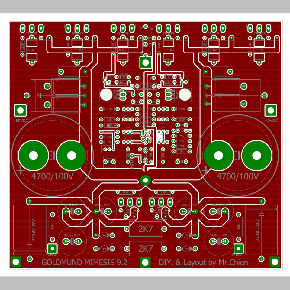

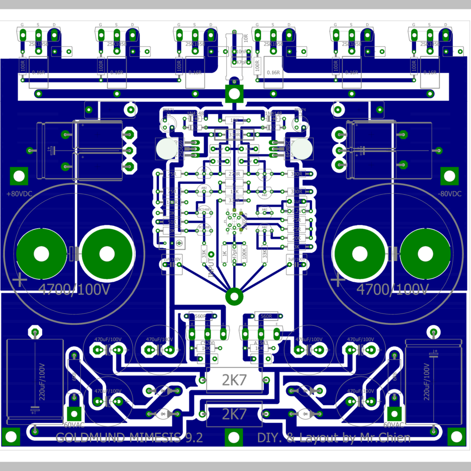

The 4700uF at 100V caps that are supplying or receiving the current to and from the loudspeakers are expected to do it by passing it all though four tiny copper track links from each solder pad. What's that going to do to the output impedance? It's not going to improve it. Might those tiny links evaporate with 8 amps to large less sensitive speakers?
There are only 3 baby copper links around the pad of the 4700uF/100V capacitor, and there is a large copper link (app 0.2 inch).
That's Eagle Layout's fault when I plan them by with = 0.16". The thickness of copper is 2oZ. I think with a minimum of 0.2 inches is not a problem. But it would be better if they were 100% sealed around the pad.

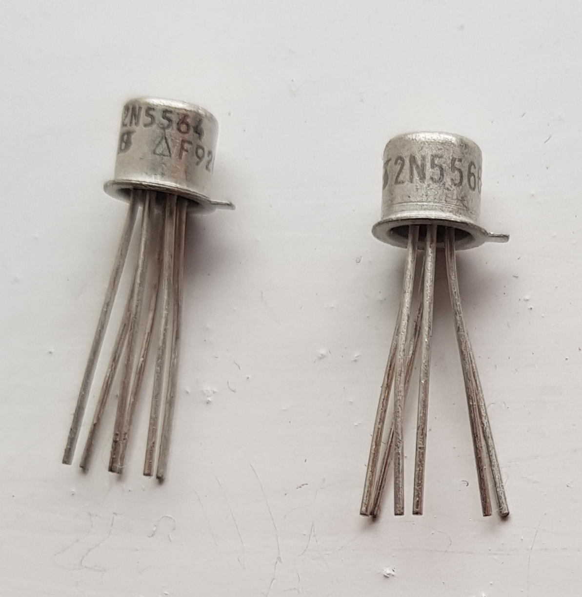

What about If I'm tried replacing the Sony 2SK43 (Rank 3 or 4) to 2N5565. I see they have Cis and Gm/Yfs best match when compared to 2N5565.
Thank all.
Thank all.

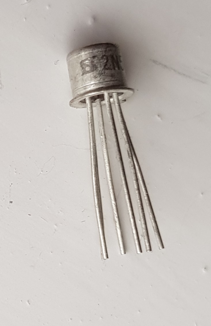

I don't have the 2N5565 but I do have the 2N5564 and 2N5566 which look like this (originals from the '80s):

Sorry, I am not experienced enough to recommend substitutes. I have to see what other builders of the Goldmund amp suggests myself 🙂
I will try the 2N5564 in one of my projects though.

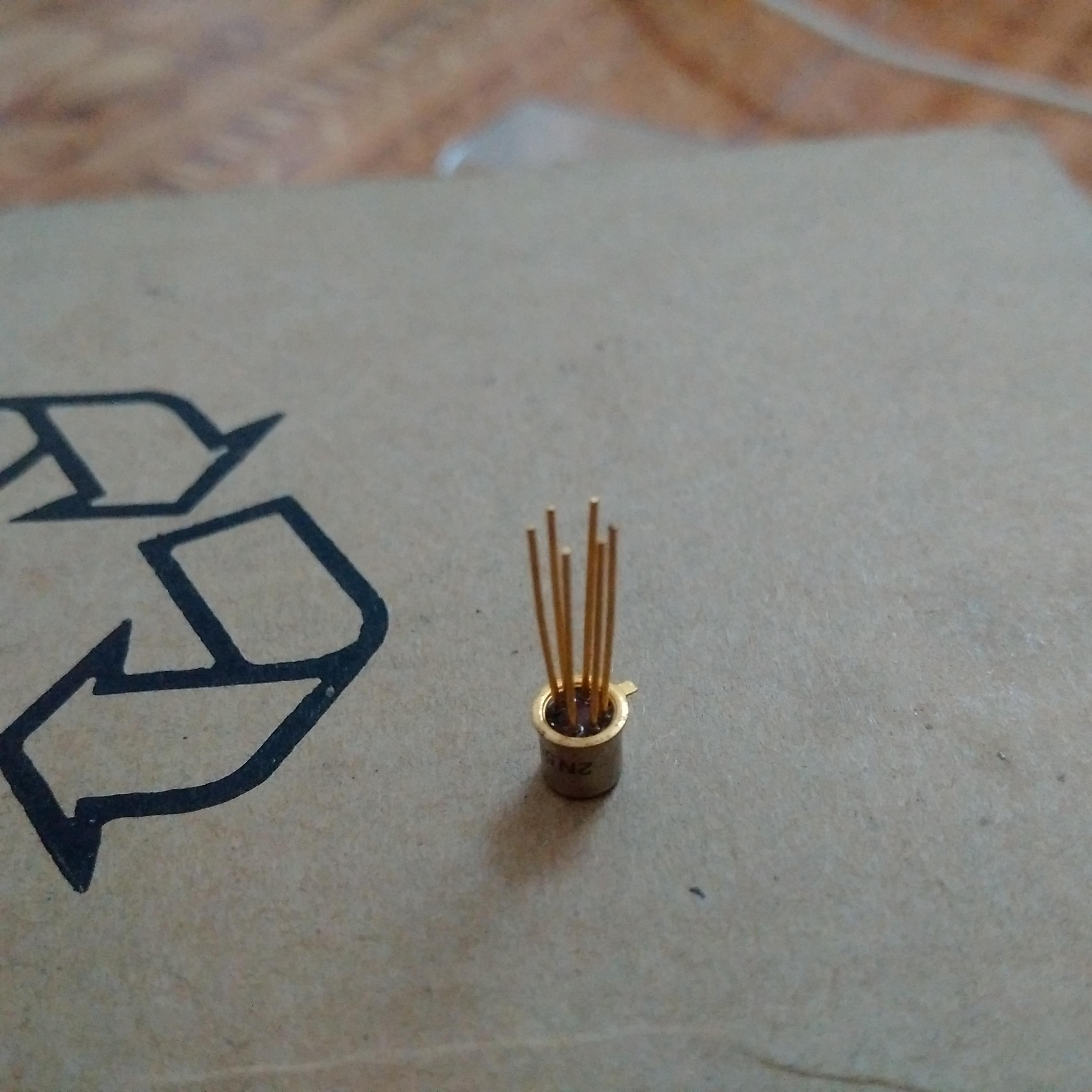

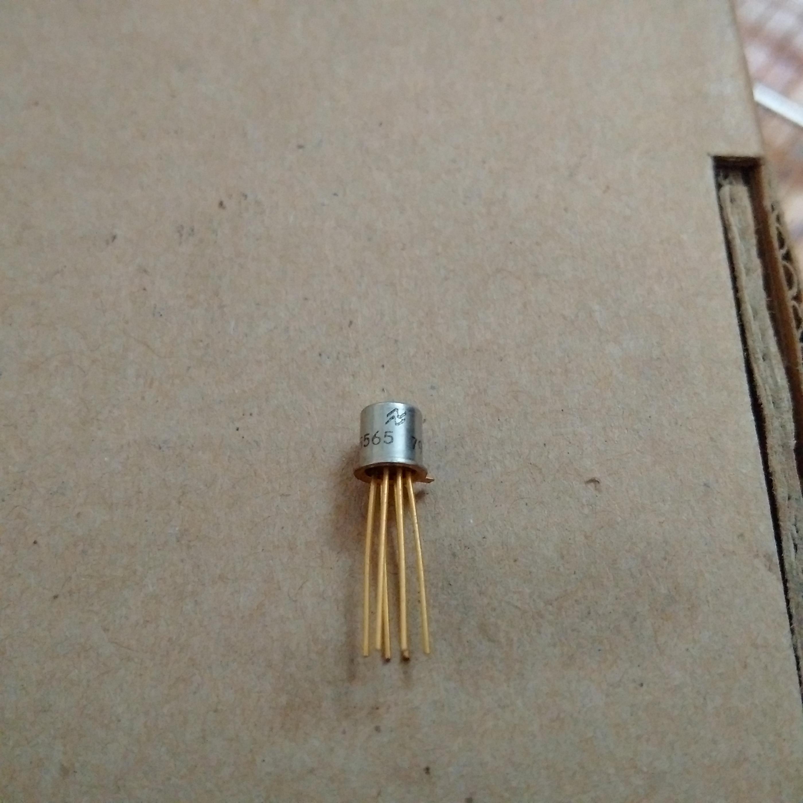

I'm also building Goldmund M9.2 from Naggy schematic.
But I'm can't sure the 2N5565 I having original.
Nice layout! Good job!😉
This compliment was sent to Goldmund because I only learned from them, with only a few modifications without 24 pins module.
