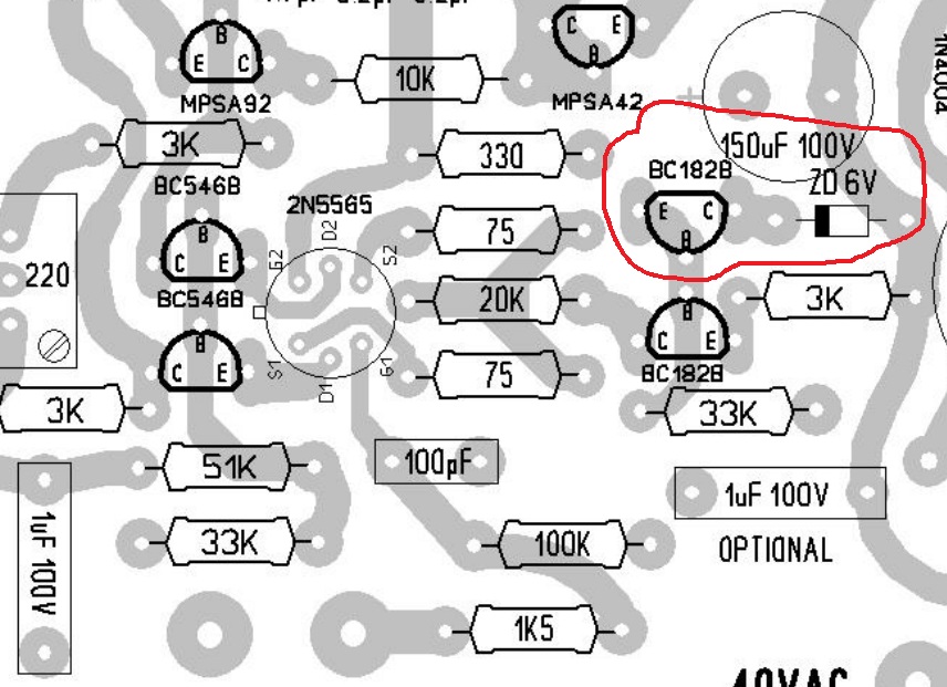

That is a VERY interesting reason. Let me check the board with care, and be back to you with the details. Also, about the diodes I want to know your suggested position of these.

The correct position of the diodes and zener diodes I signed red "correct"

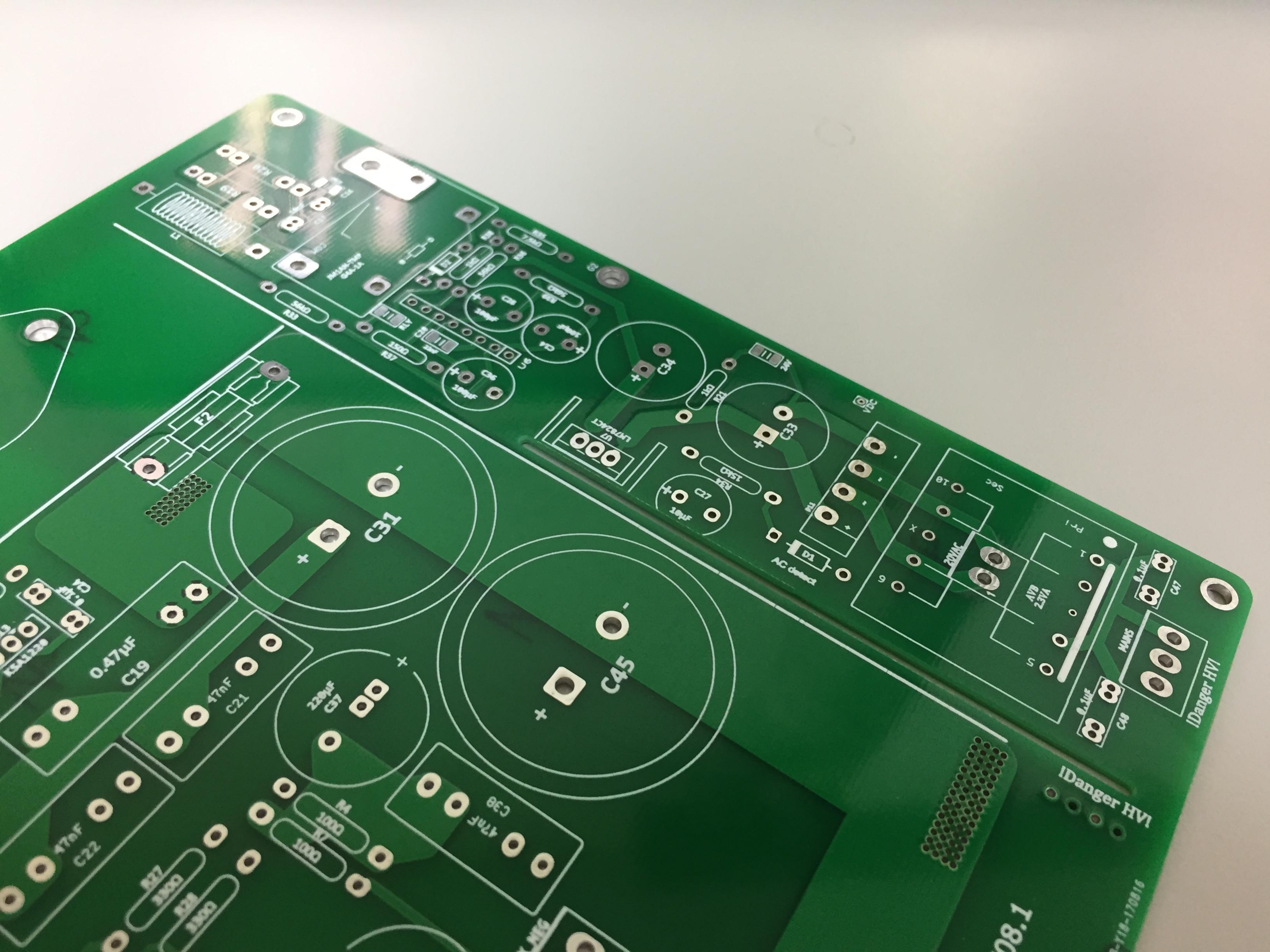

Hennady he is the thing: attached is the original board component distribution. the Wilson Mirror transistor is inverted. Anyway I could assemble with the transistor in the typical position as you kindly suggest.
It would be nice to know what test method could be efficient to tell the difference using the simulator ...
On the board the transistor is drawn incorrectly, it is necessary to swap the Сollector and the EmitterHennady he is the thing: attached is the original board component distribution. the Wilson Mirror transistor is inverted. Anyway I could assemble with the transistor in the typical position as you kindly suggest..
Measure the voltage across resistor R11 (3k) in the emitter T5....It would be nice to know what test method could be efficient to tell the difference using the simulator ...
This voltage should be equal to the voltage at zener D1 (6V)

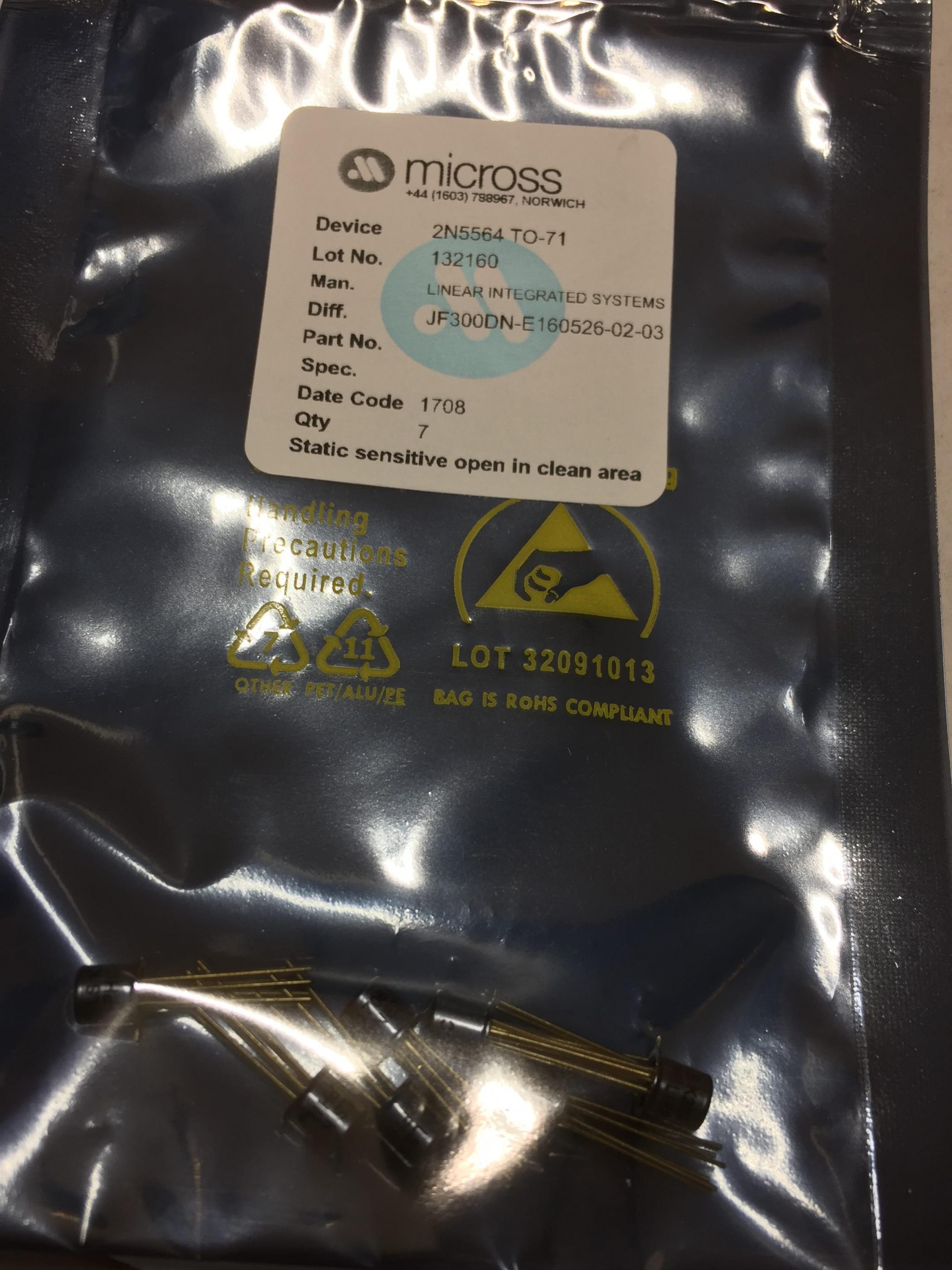

I think you owe me an apology. I am just trying to help GM builders and buy genuine parts.
I'm sorry and thanks your try to diy community.
I busyness for answer before via email.
I will soon arrange to order a few to build GM 2017.
Tks u,
Now, do you still think I offer fake parts?

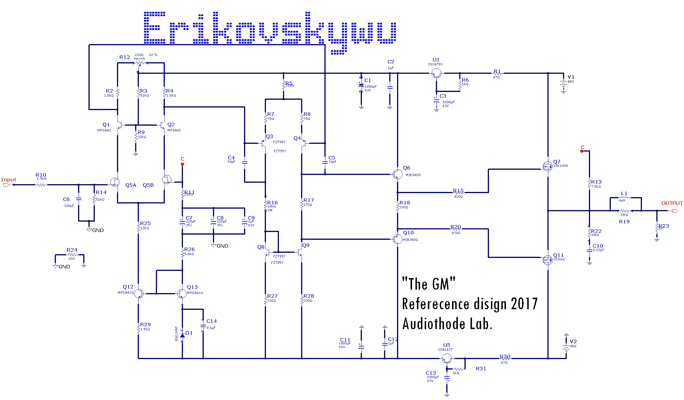

Because I am publishing a "reference" schematic.😉
... Which could innovate on using a better type of parts, 😉

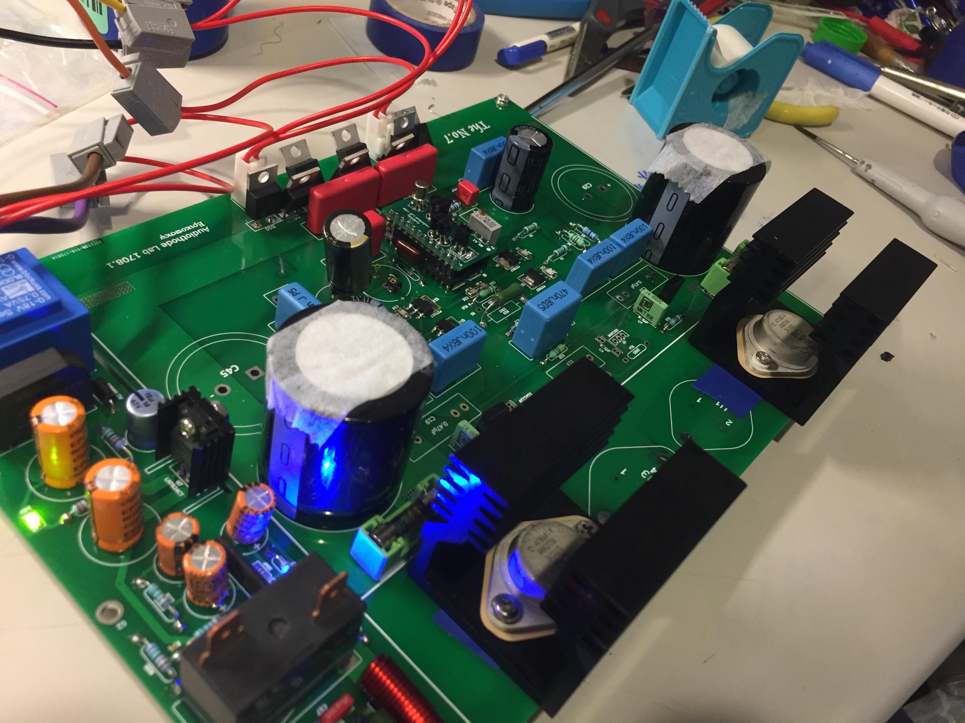

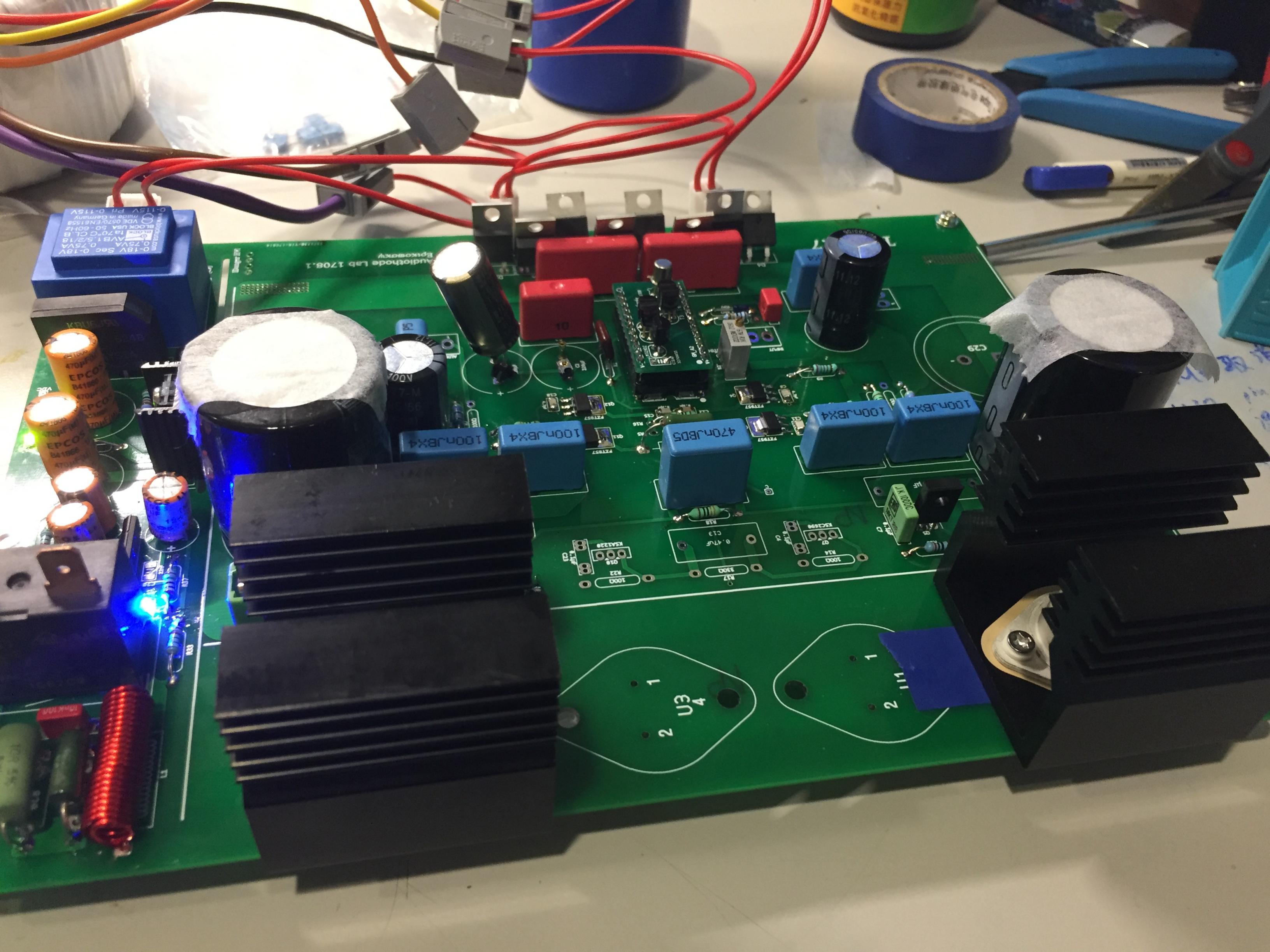

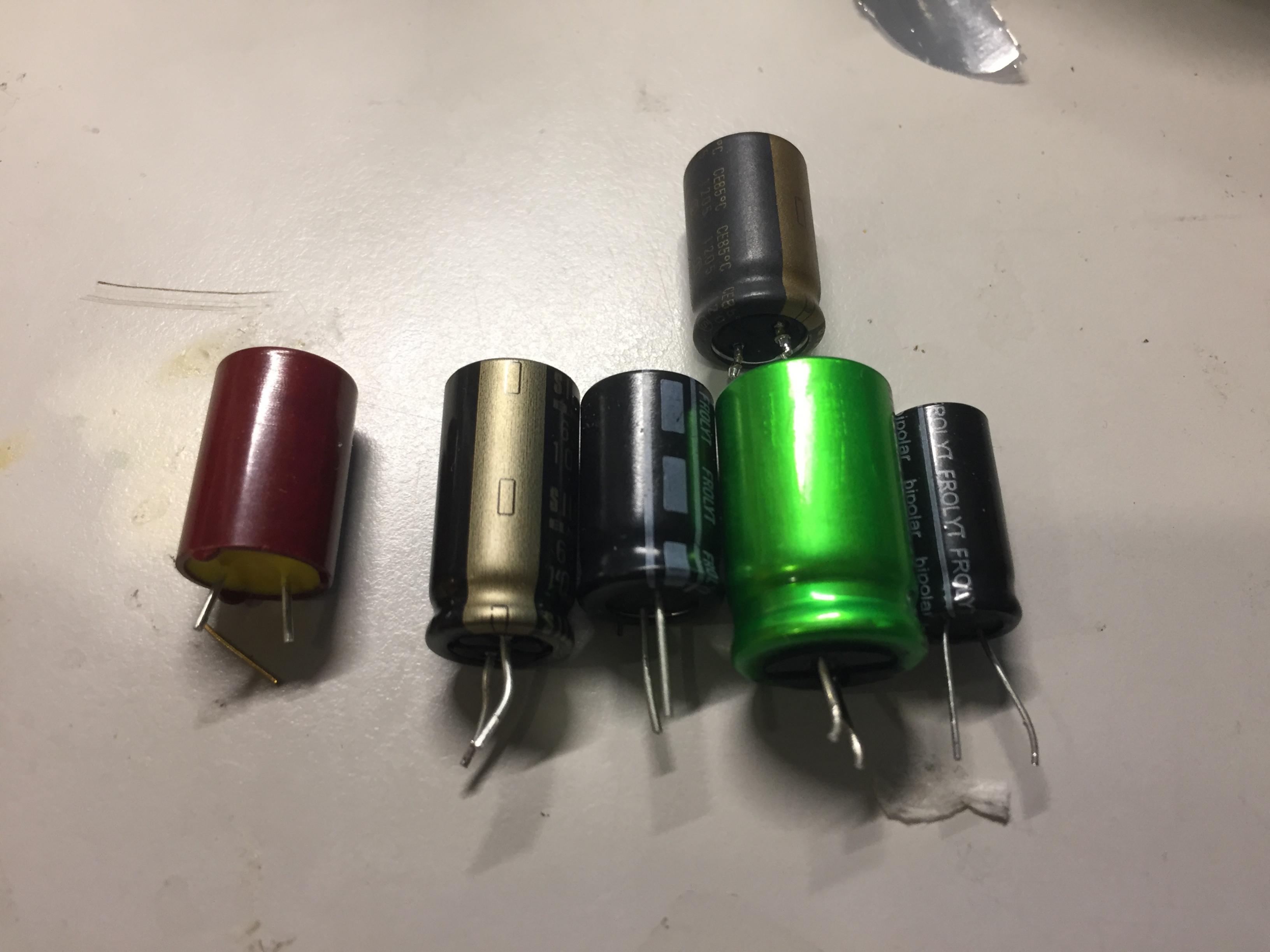

Hi all,
Finally, modulized GM was done! I use it as a test platform.
There're several feedback cap I've tested.
And,.... I love Elna Cerafine the most! Very vivid and gorgeous sounding!
My conclusion is :
Cerafine>Frolyt EKSU>Nichicon Muse BP =Elna Silmic II > Frolyt EKM>ROE EK
The input module uses 2N3958, and the power transistors are BUZ901/906.
