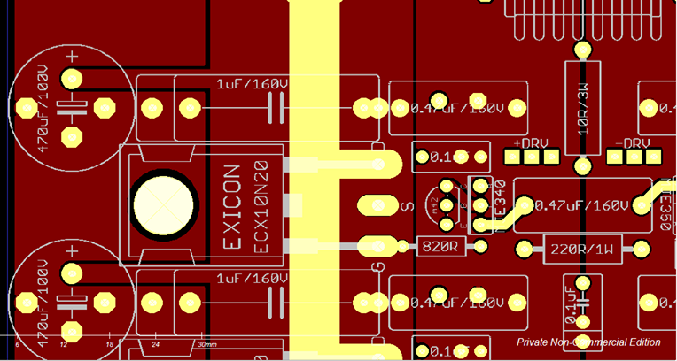

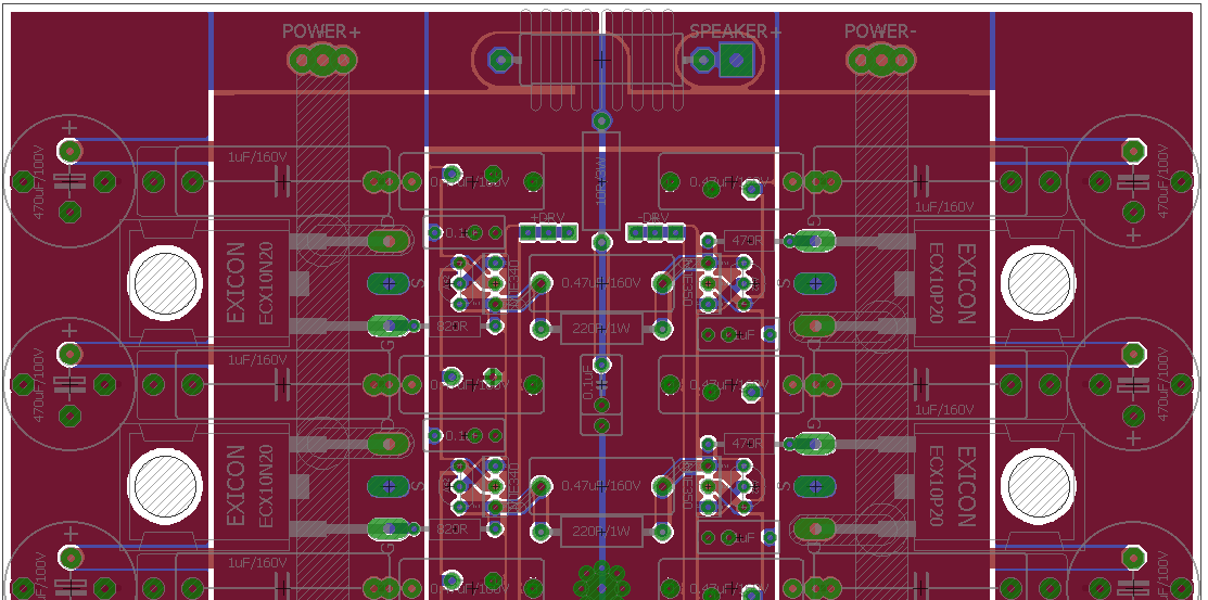

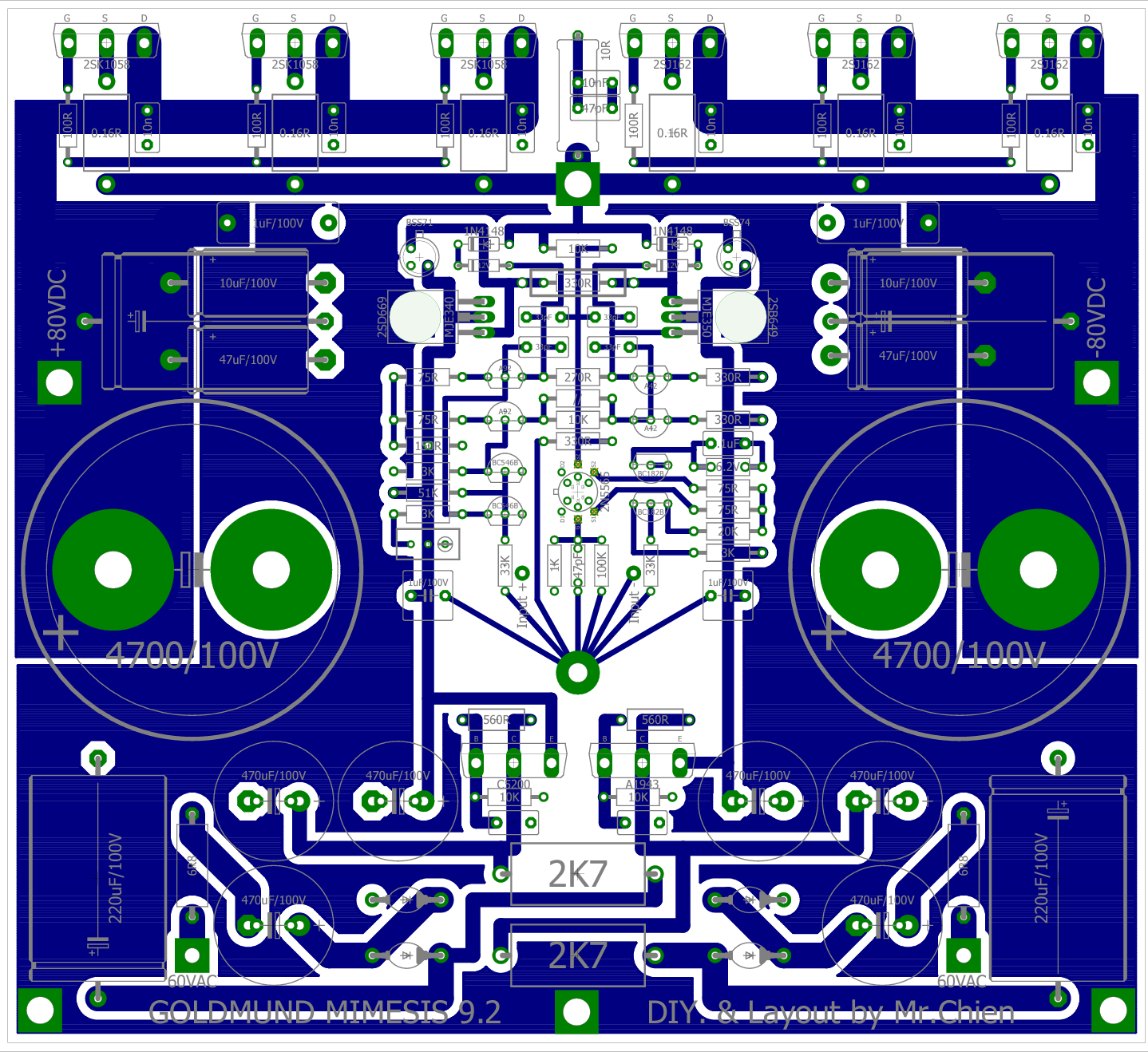

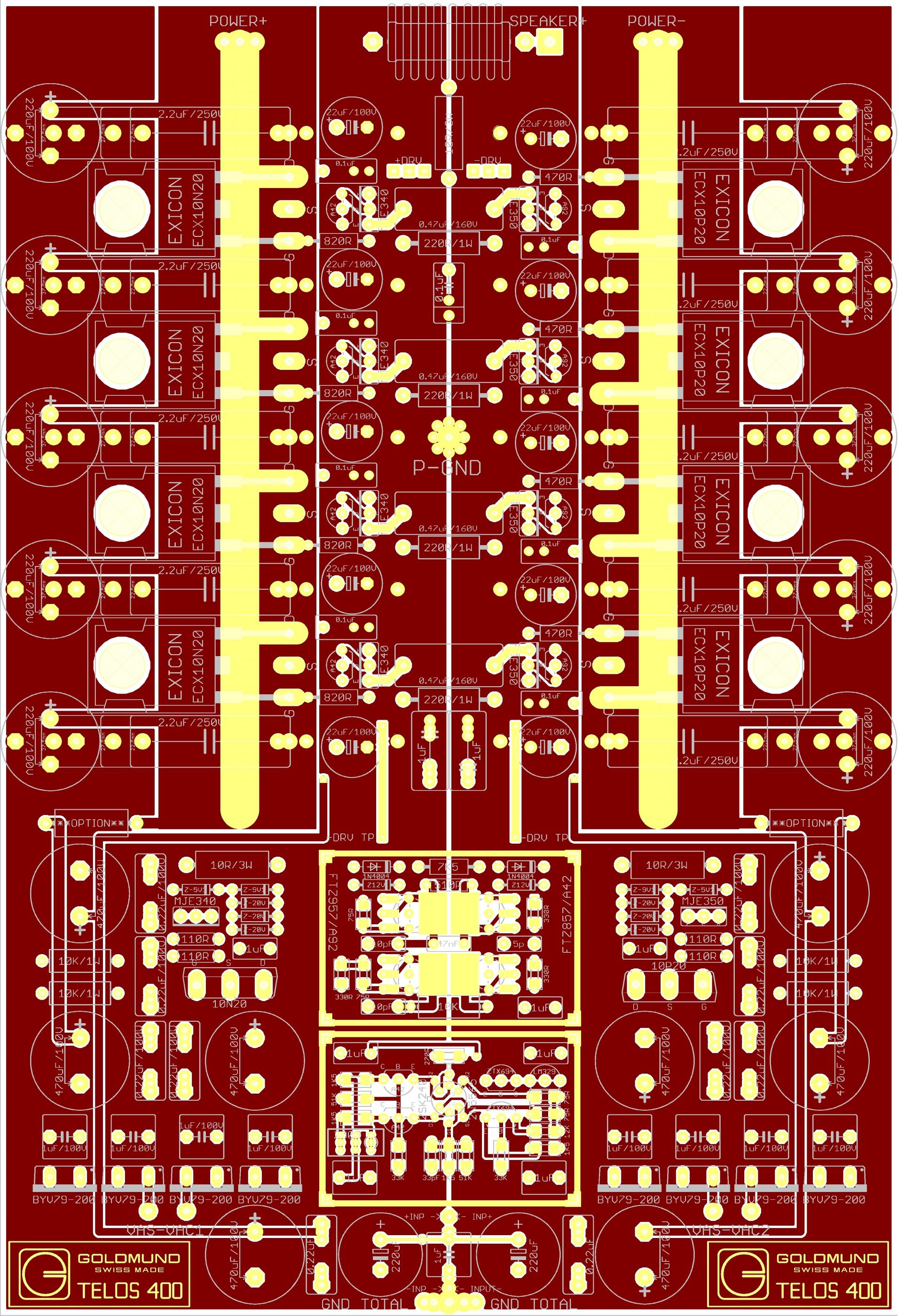

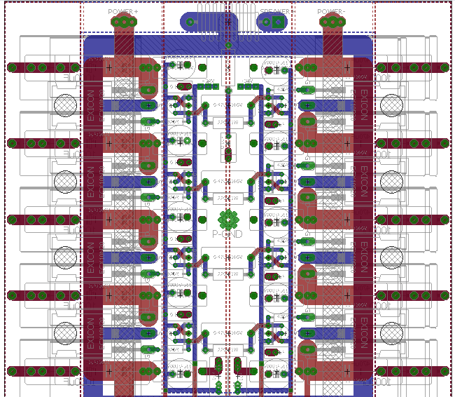

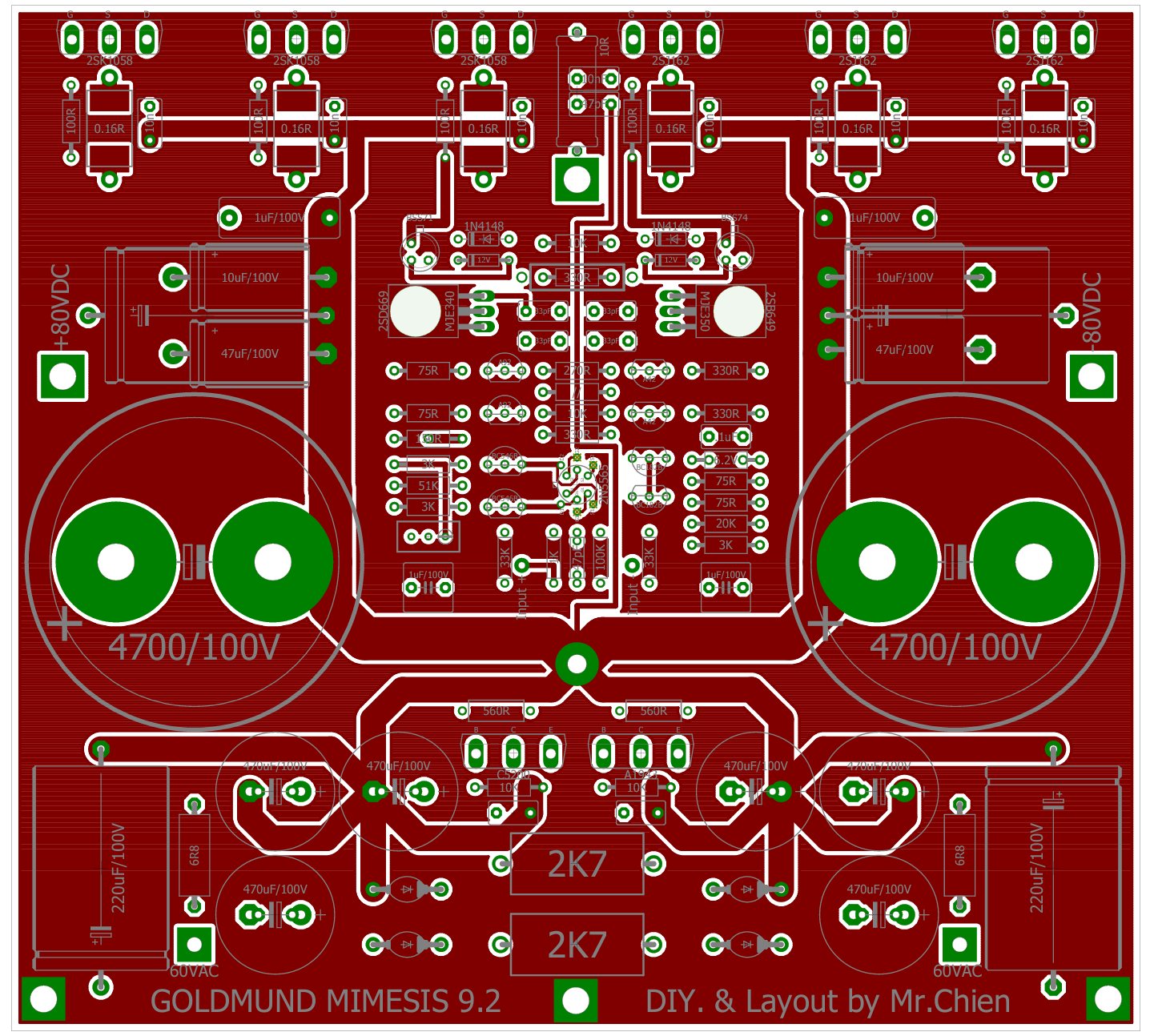

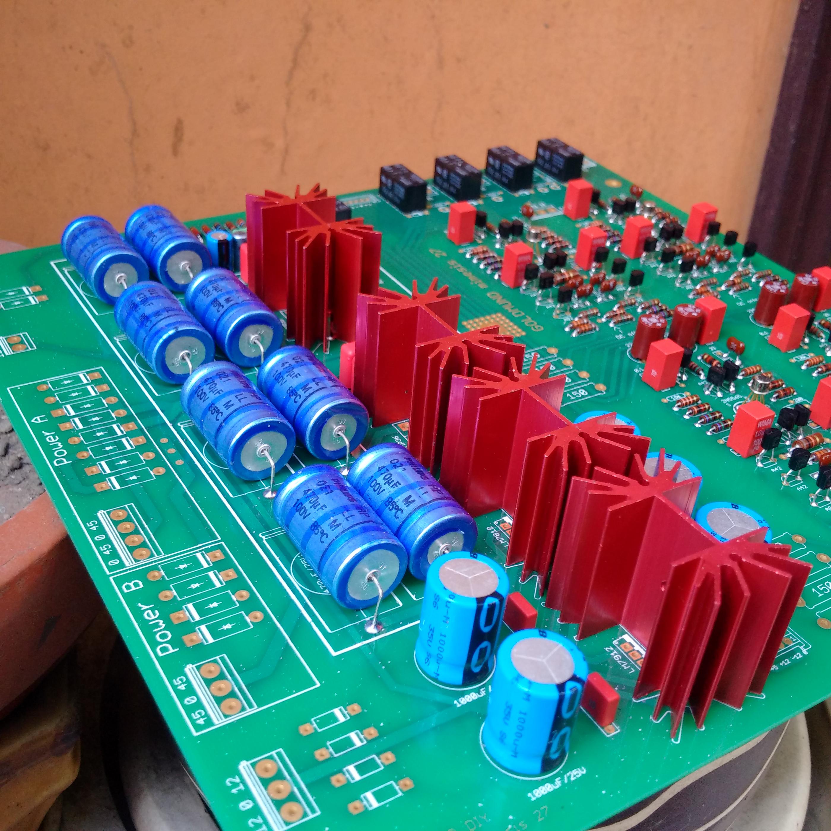

The 4700uF at 100V caps that are supplying or receiving the current to and from the loudspeakers are expected to do it by passing it all though four tiny copper track links from each solder pad. What's that going to do to the output impedance? It's not going to improve it. Might those tiny links evaporate with 8 amps to large less sensitive speakers?

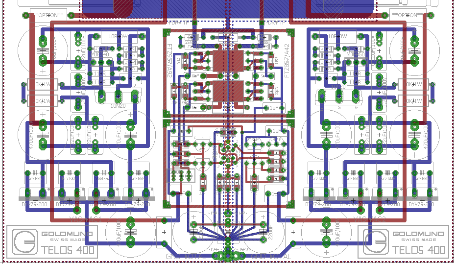

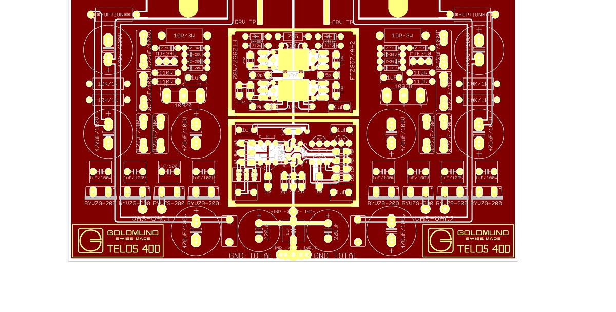

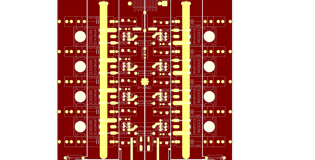

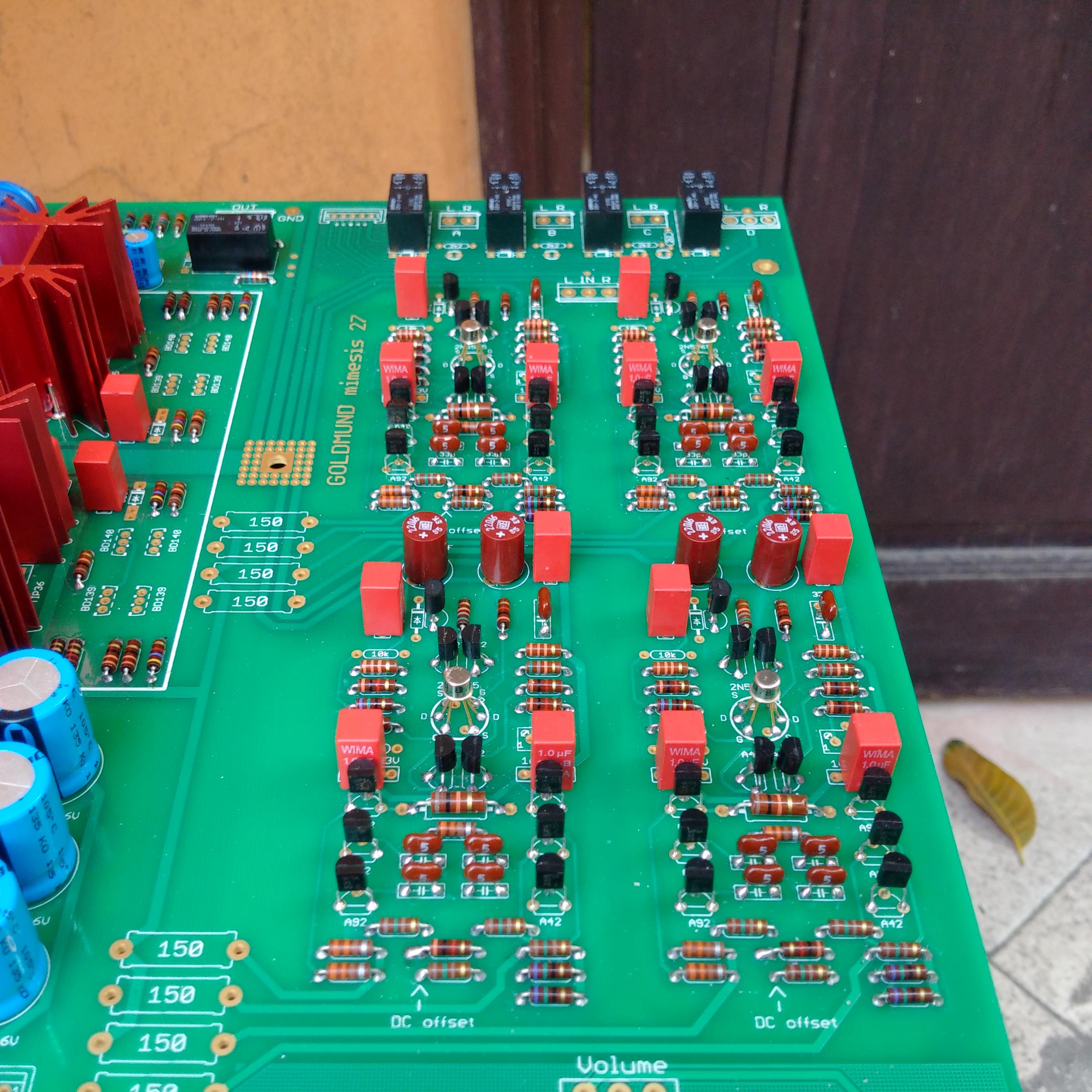

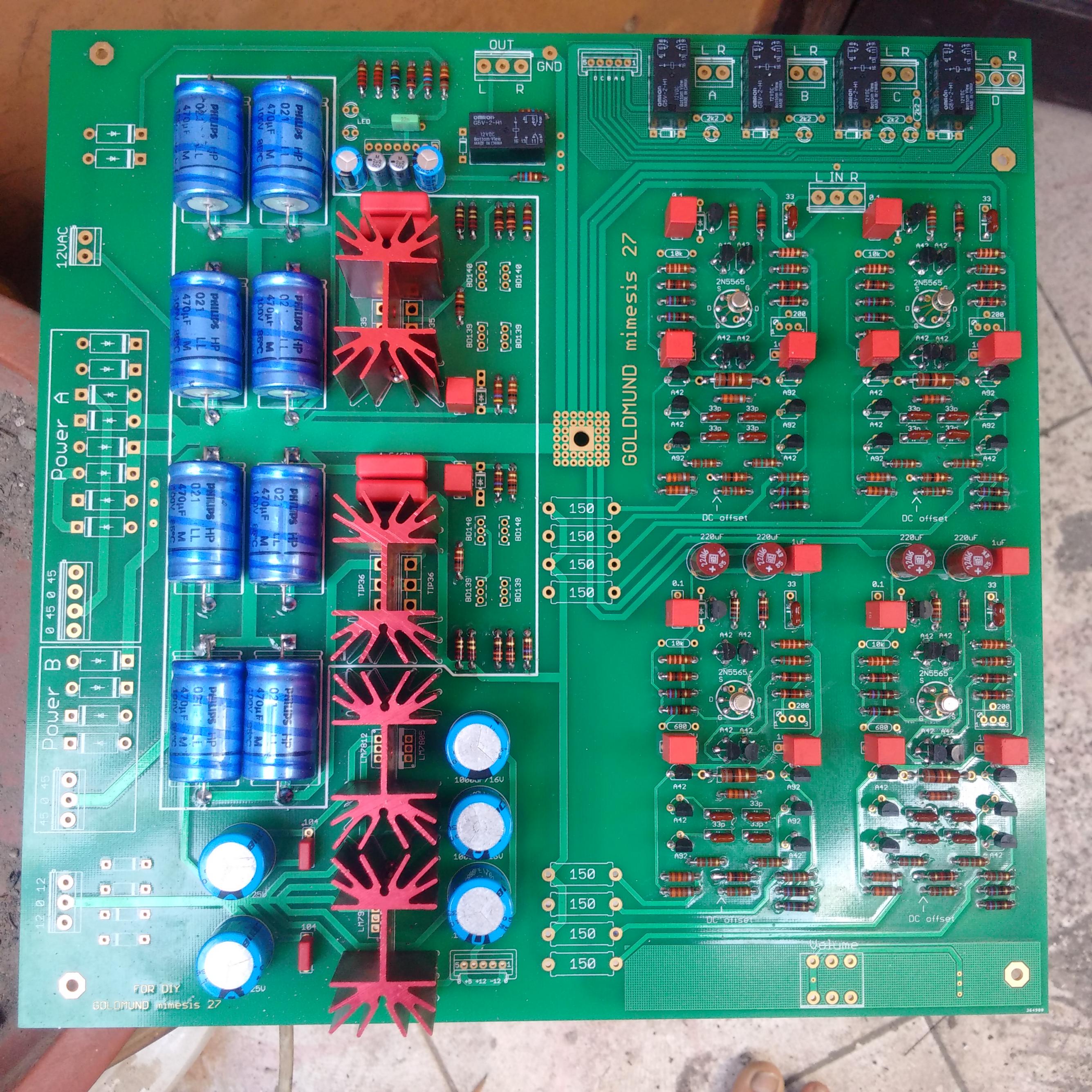

New update at here with some small mod.

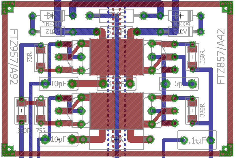

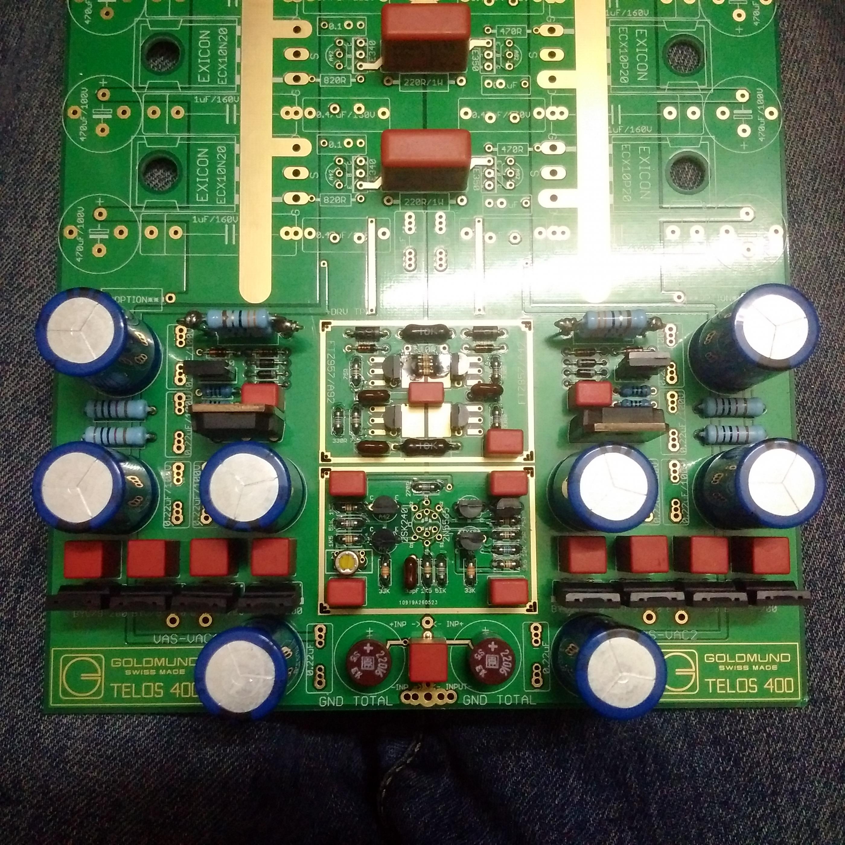

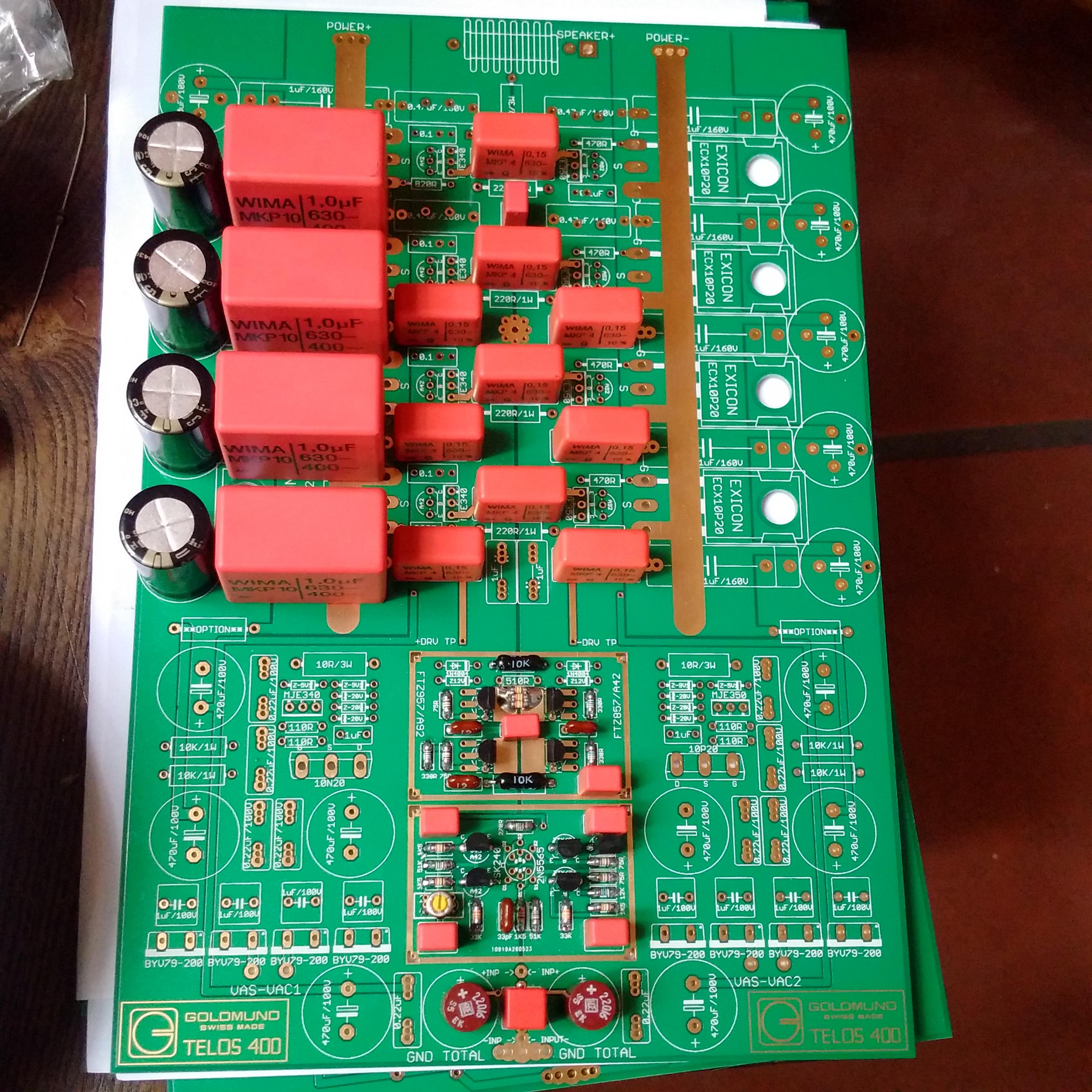

New upgrade version
All in one and full Option (from Mimesis to Telos) 😀

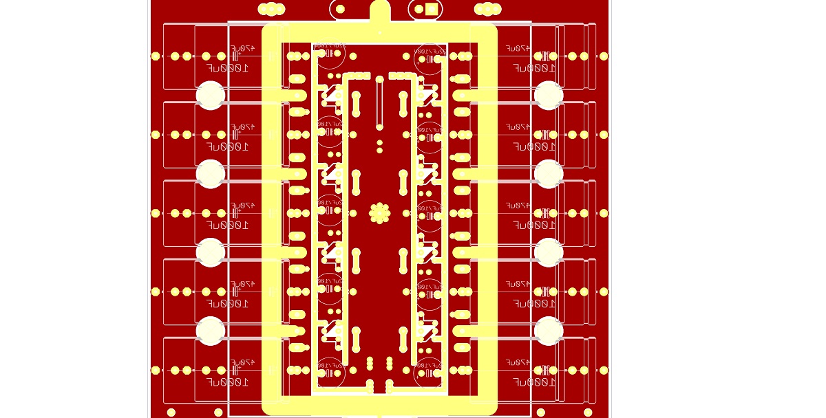

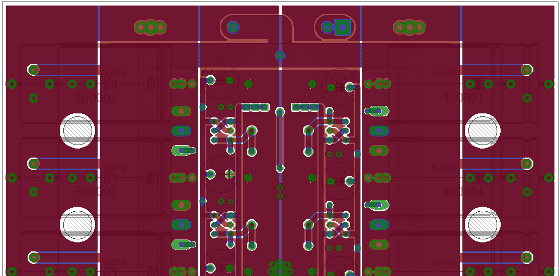

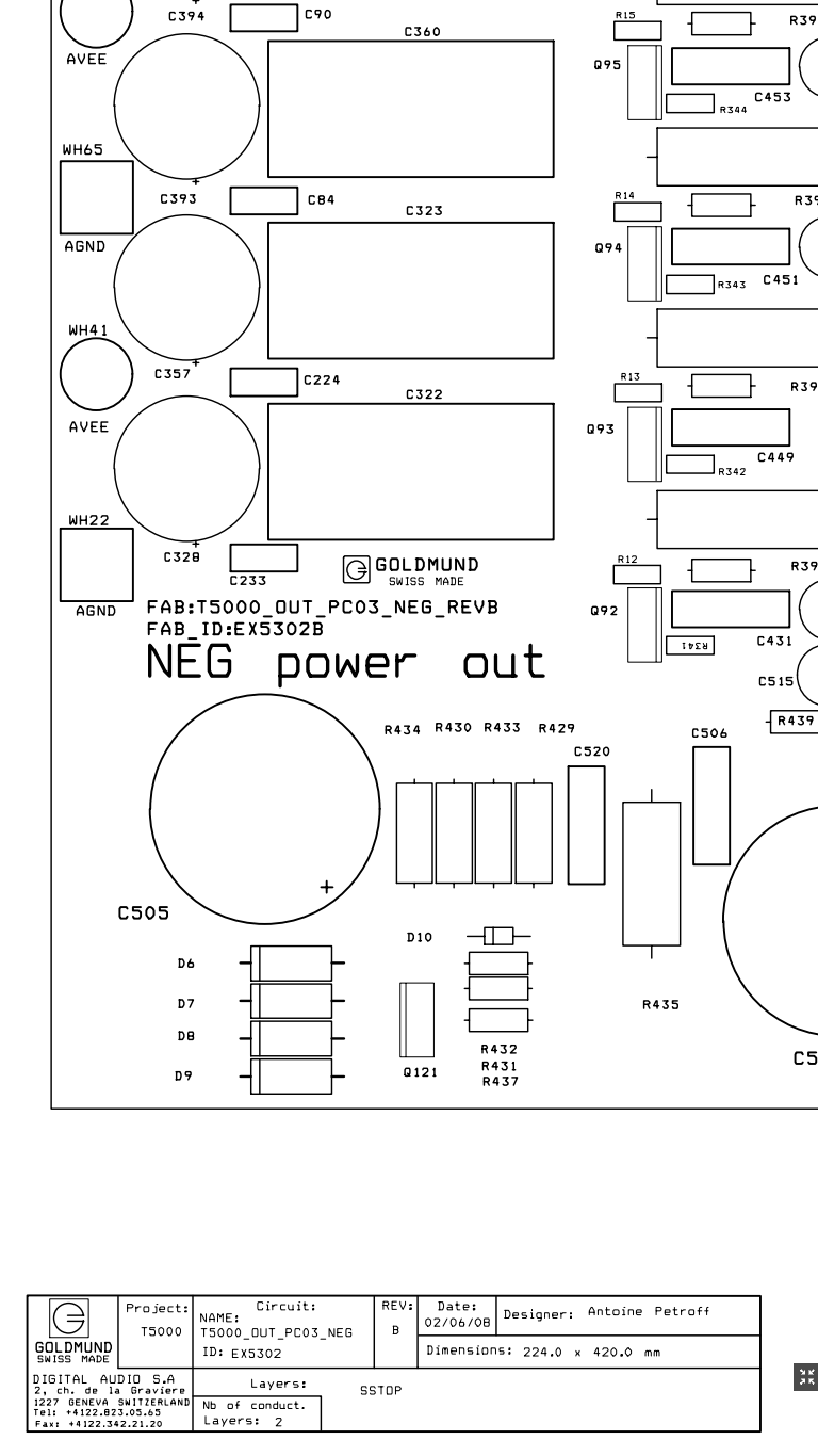

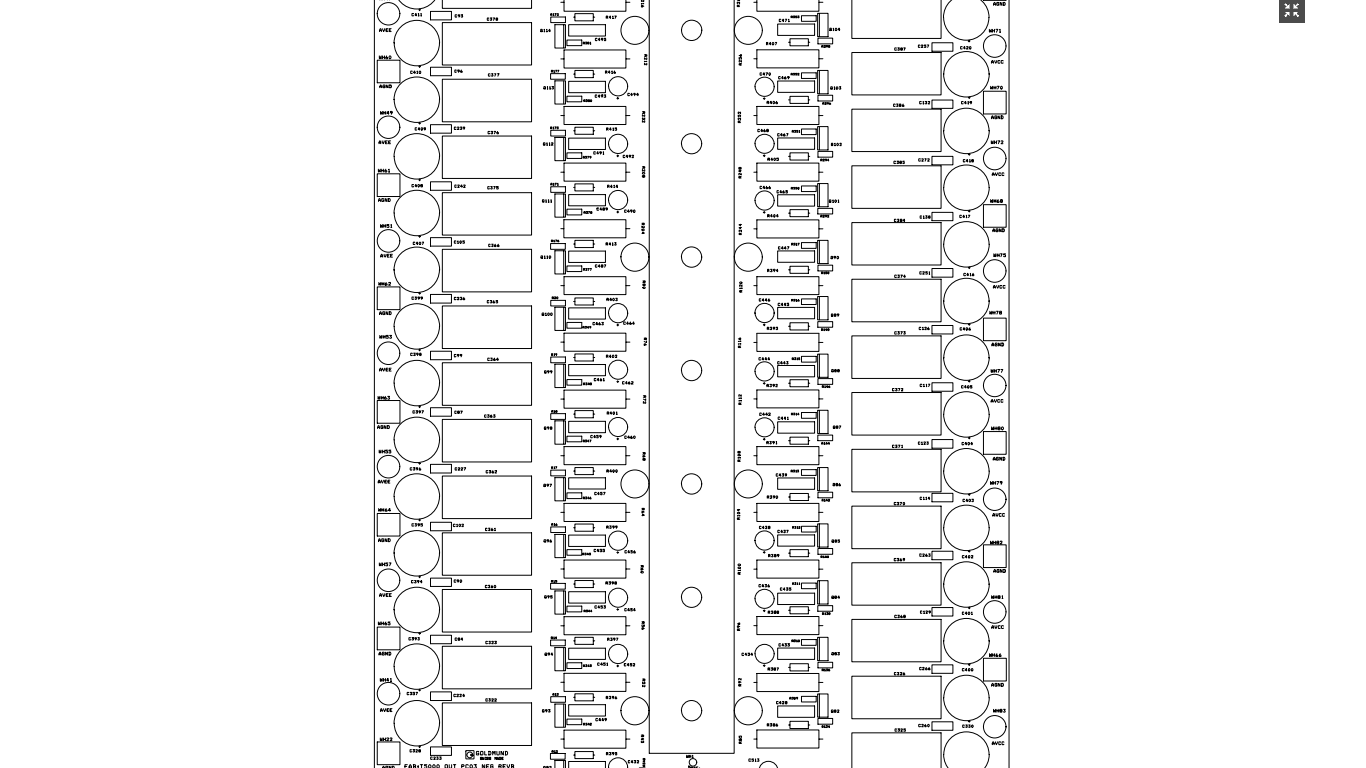

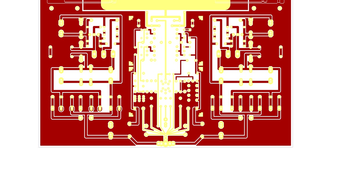

This is the highness images of full layout when view on GerberLogix.

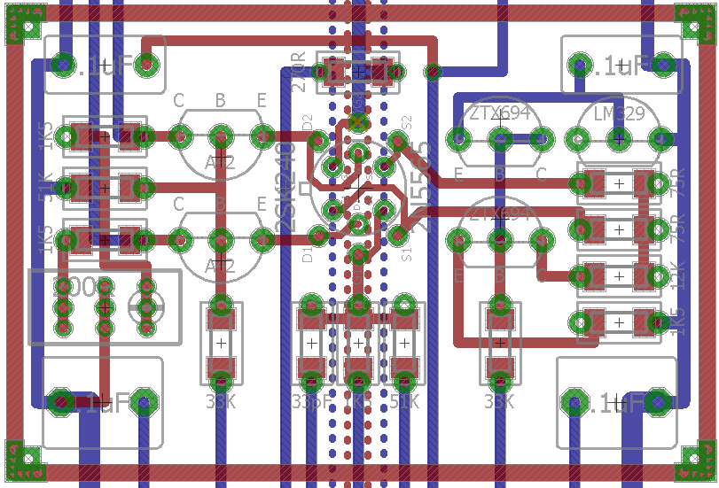

I don't have the 2N5565 but I do have the 2N5564 and 2N5566 which look like this (originals from the '80s):
I have a small drawer with old 2N5566's from the 70's-80's. All three of these
numbers are pretty much the same except differential temperature drift,
which is best in the 2N5564.
Also I have a bag of the NDP versions in dip package.
I don't see any reason not to use any of them, I did for years and they were
fine, but switched to Toshiba 2SK389 and 2SJ109.

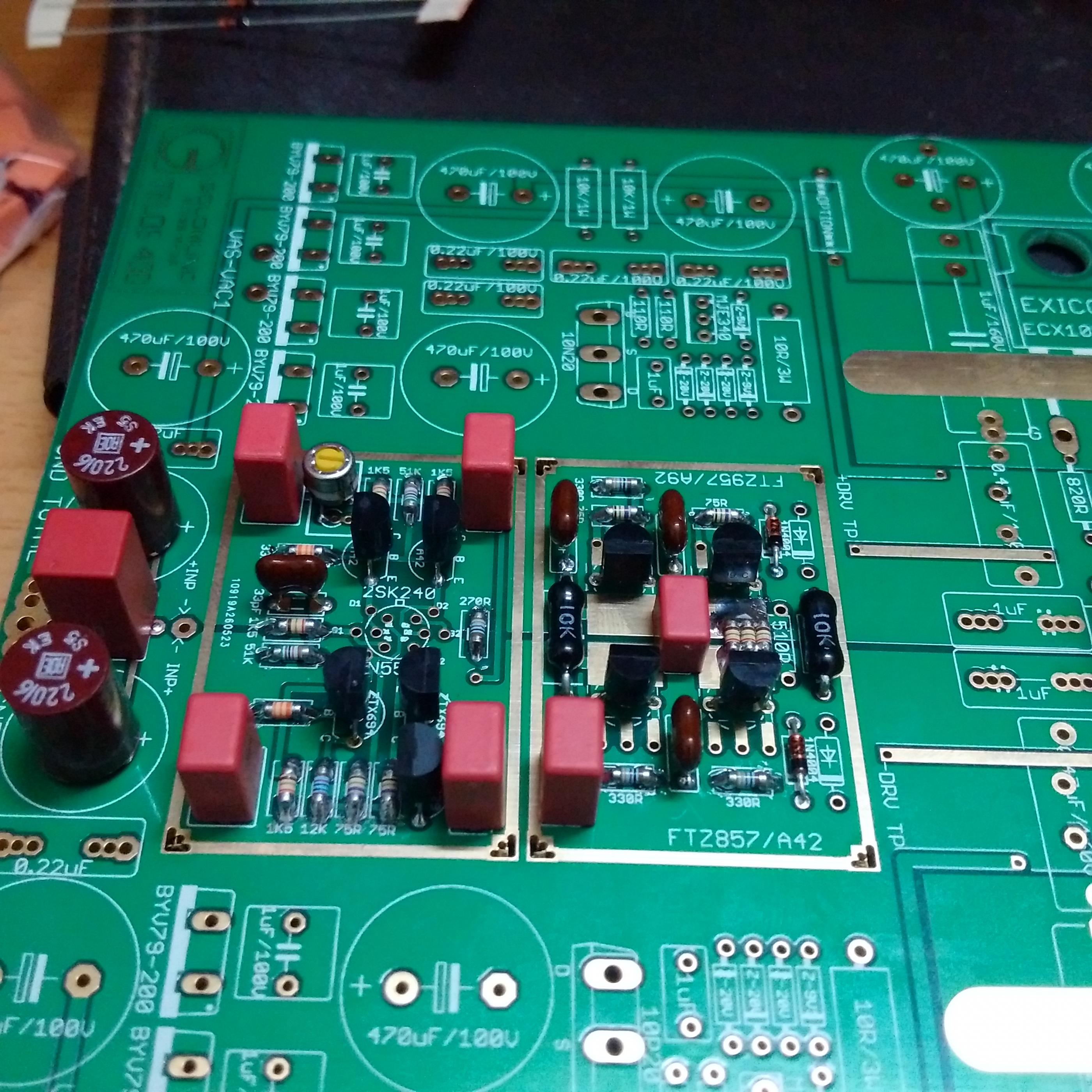

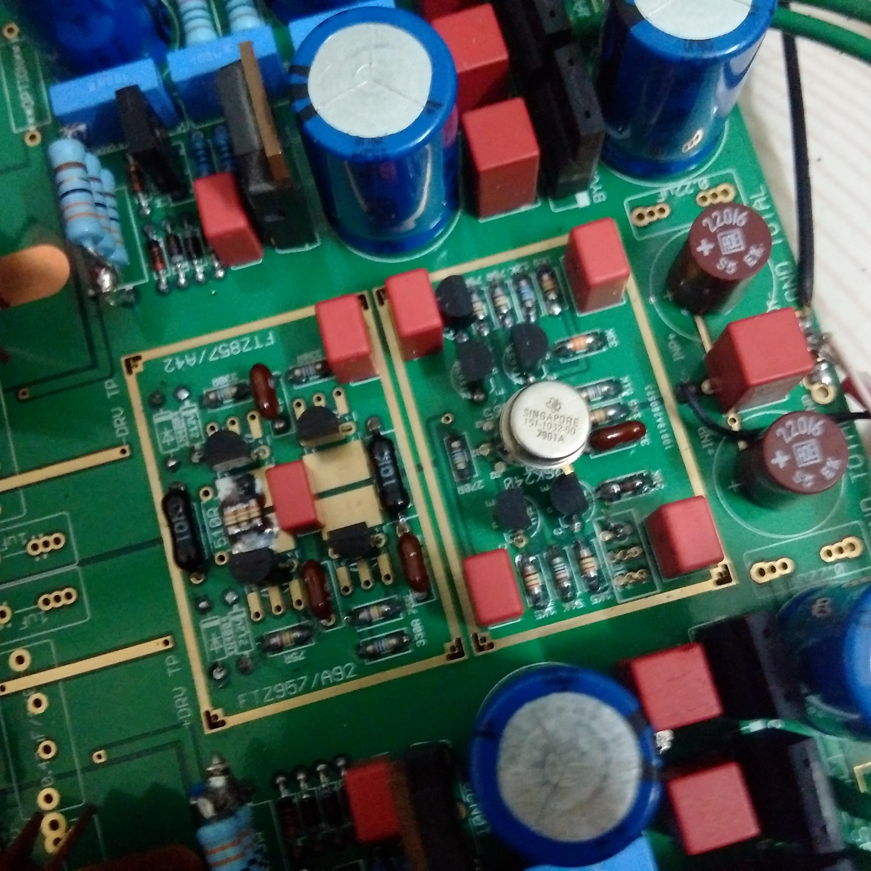

I've done a reality check on the table and they run very particularly impressed with lyrical music my country. It has a special sound to me, it different to all other many amp heard and I love it.
I using Tektronic dual jfet, it's same 2N5911A. I will test on 2N556x later when I own them.
Video test: YouTube
