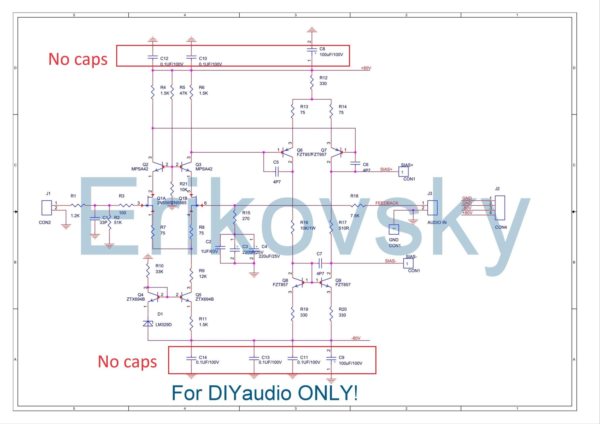

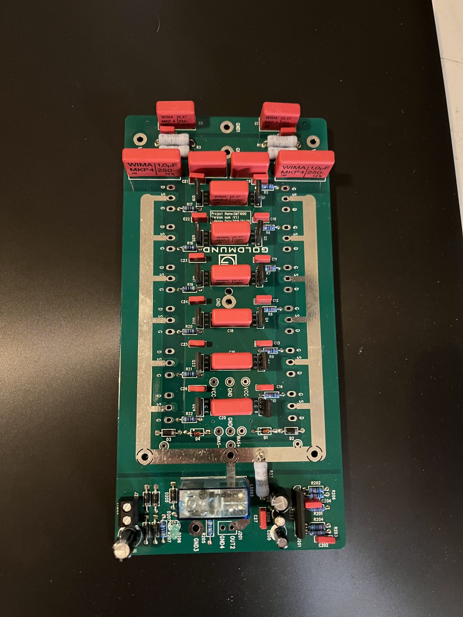

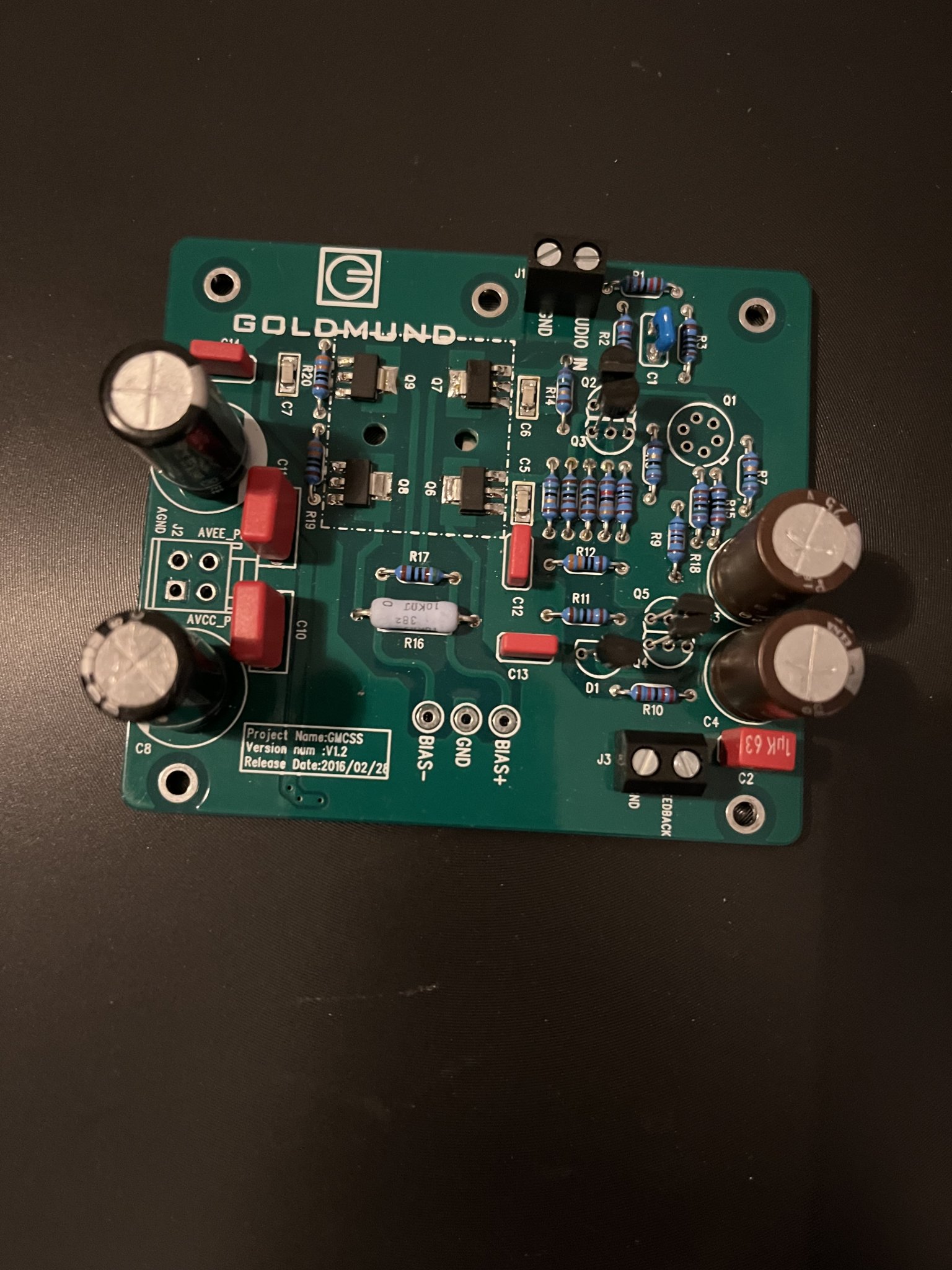

I have bought boards supposed from a Goldmund Telos 600 clone (ppower output and input boards) but I received no schematics and I really need help to make this work.
Input board:
output board:
The input board is very close to Erikovsky schematic but no caps connected to GND:
2N5565 has been replaced with U402 and I don’t know if this is a direct or any good substitute or better fit LSK389 (2sk389) or 2N3958.
I'm just building output stage and no input selector or whatever. I will use my preamp to feed the front end input board but I have some questions:
It looks obvious I have to connect input board BIAS+/-/GND with output boards BIAS+/-/GND.
Most probably I will use +/-60VDC to feed the amp and will connect regulated +/- 60VDC to the drivers (VCC+ / GND / VCC- ) and unregulated +/- 60VDC to the output mosfets VCC+/ GND / VEE-
Shall I feed +/- 60VDC to AVCC_PRE / AGND / AVEE_PRE as well?
What about feedback input? shall I connect anything there?
Will this only two boards work properly?
Thanks in advance for your help.
1. Siliconix U402 may directly replace 2N5565 due its same pins out. But its much lower Gm, therefore the circuit is more stable and lighter sounding. However using U402 is not good idea.
2. You can supply to front-end card, driver transistors, output MOSFETs by +/-60VDC. This is most popular way.
3. Feedback input connect to solder pad that near ''bias +/bias -'' points.

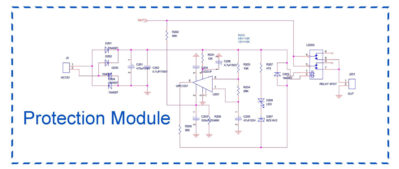

hello.
I was looking at the PCBs and I see, if I'm not mistaken, at the speaker output, a circuit with a relay for delayed insertion and, I think, protections for offset voltages.
It seems like a similar circuit to me because, if I'm not mistaken, the UPC 1237 chip is used.
Can we know something more?
Also because, through the usual wholesaler channels, I can no longer find this UPC1237.
Is there something similar as a circuit, but without 1237?

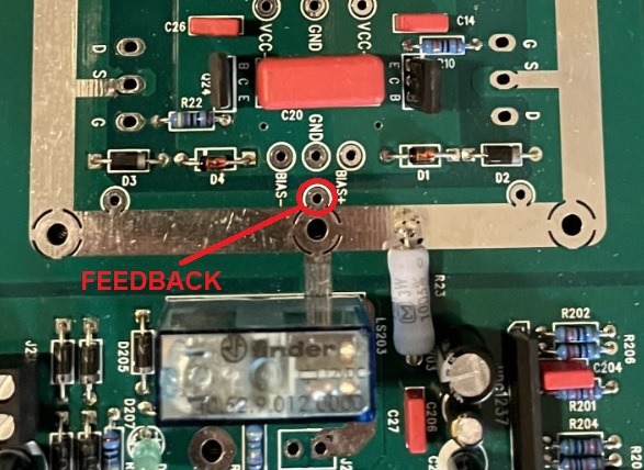

Thanks @Walkalone and @domenico80 for your answers.
I bought the boards from a leer at marktplaats.nl but I'm not really sure If I will build anything with them or will be sold. I had to admit this is a bit complicated for me, although I'd like to try:
So, should I replace U402 with LSK389 or any other?
feedback + connected to BIAS+ and feedback GNG o BIAS- or you mean solder to the solder track feeding the Source pin of all the mosfets??
the board comes with speaker protection circuit based on upc1237 following this schema:
No,
Here is solder pad to feedback the signal into front-end card. Imagining there are 3 points to connect OPS board to FE card: BIAS +; BIAS -; FEEDBACK. Of course including its GND.
// Firstly Use U402 to test, ensure that the circuits operate as nornal.
Reactions: Nikos
It looks ok for connections.
But grounding scheme seems complex. If BIAS + and BIAS - go together with its GND, it makes ground loop.
On otherhands, the FEEDBACK must goes with GND due it's inverting input, it also make ground loop.
Complicated grounding may contain hidden ground loops.

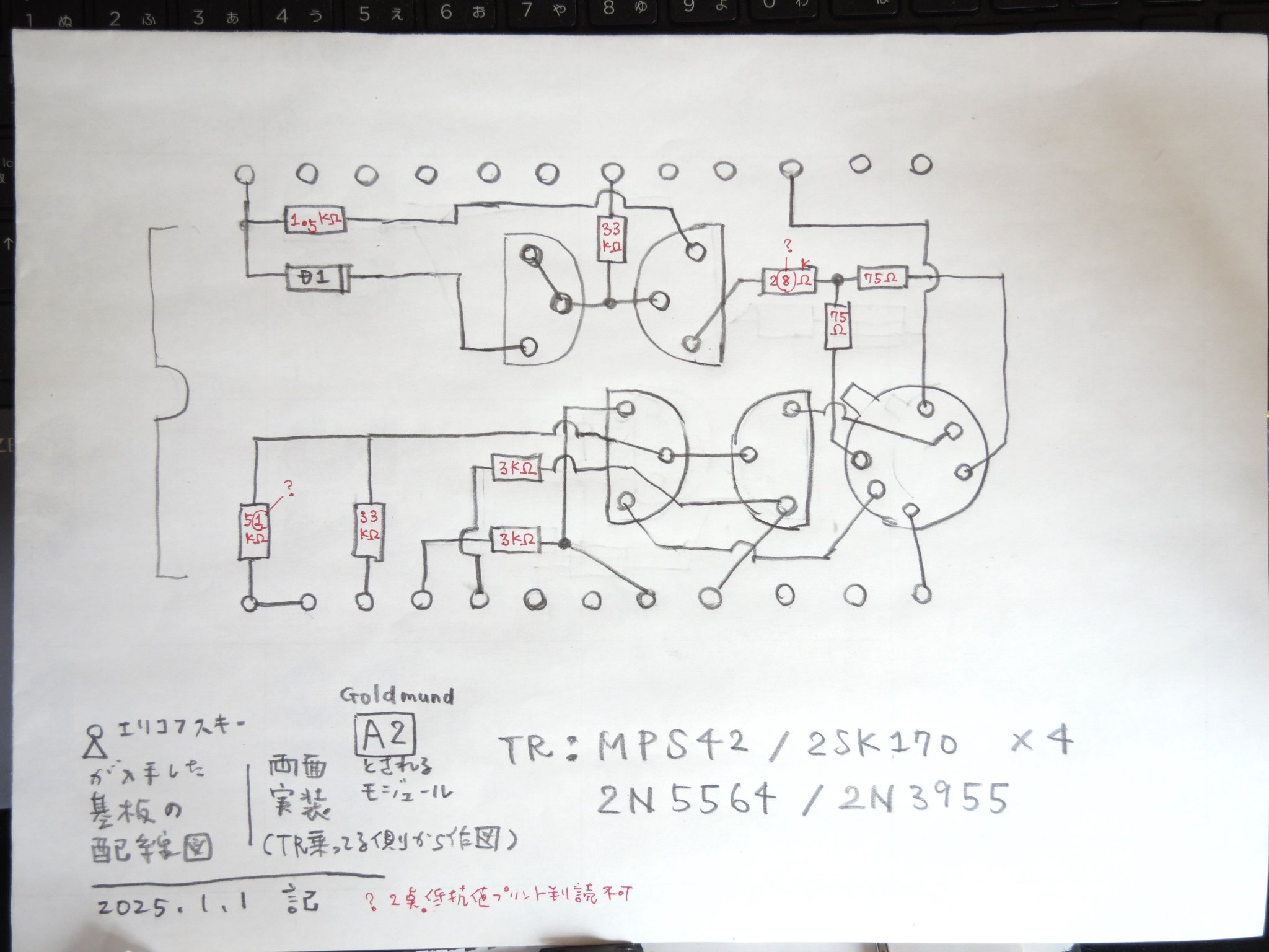

Hi all,
Finally, the module PCB arrived. Very tiny.
Thank you for the precious images.
I drew a wiring diagram based on the image of the board you provided.
I apologize for being an amateur, but there are two places where the resistance values are unclear.
Could you please comment on this when you have the time?
