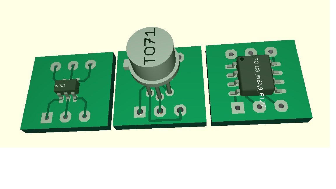

I've tried DIP-8 footprint on PCB. The advantages are:
1. Compatible with NPD556X
2. Compatible with 2N556X metal-can if you solder them on an adapter
Hi Mr Chien,
great idea from erikovsky. A DIP-6 footprint allows also to use the LSK389/489/589 from Linear Systems in SOIC 8 , TO-71/6 or in SOT-23/6 cases with a small adapter borard. As i check in the layout, there is sufficient space in that area und would make the designs very flexible .
BR
Gunni
additional to previous post
Hi erikovsky,
DIP-6 or DIP-8 doesn't care, i choose DIP-6, because the actual available prodducts, like SST404 from Calogic the LSK 4(5,6)89 are available inthe shown cases. The DIP- (NPD556x) is still in production, or has reached EOL? As a DIYer i am interested in buying devices from trustworthy sources. All these device i mentioned before are still in production. And for me this way was sufficient enough.
Are you planning to change your designs with LAT-Mosfets for the TO-247 cases from EXICON (the last remaining in active production)?
BR
Günni
