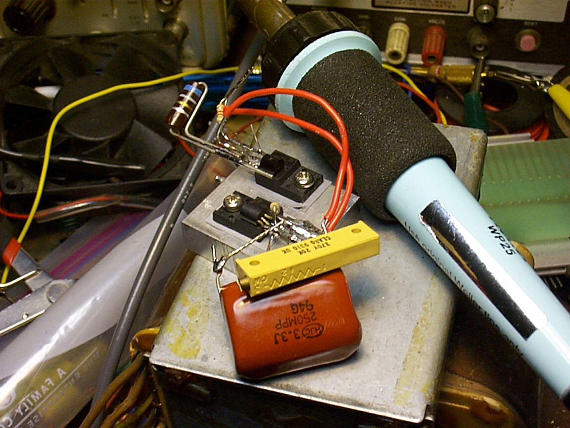

OS, you'll delight in this. This whirlwind of soldering prowess, not a foot away, is my headphone amp prototype. I want to get some blank PCB to do ground plane P-P prototypes.

Thanks Hugh. I've been letting sheer inconvenience deter hands-on studies quite a bit. To use my bench I have to stand on a chair, which itself has less than a foot of clearance as all the space around it is covered in dismembered junk. For lack of suitable shelves or organizers, my bench is stacked and ready to landslide at the next unlucky attempt at stepping off the chair.

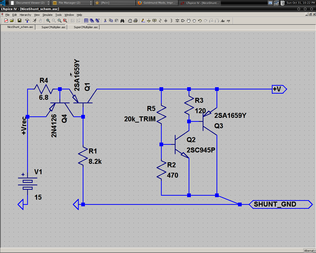

Nonetheless, the built regulator as in the schematic, shows <400uV of noise at 200uV/div (My 561B measures to 10uV/div!), at 5V output. I found no trace of oscillation on first power up with my 20MHz scope, then switched to my sensitive 561B. I used the older reference since I don't have suitable Jfets. No load connected.
It is stable with no output decoupling, but without the 20k bypassed with a cap output impedance is not very high. After I bypass it, I suspect output bypass will be more important. For lack of a signal generator, I will use my scope calibrator through a DC blocking capacitor to test pulse response, and output impedance will become evident too since the calibrator has a known output impedance.
Looks nice and simple, KT, CCS followed by a CFP in shunt... certainly not up to your usual component count!! I really like this direction. To avoid too much AC gain which might cause overshoot and possible instability, divide R5 into two resistors, 10K pot on the rail in series with 10K to the CFP driver, and bypass only the pot.....
One more thing, however. Output voltage might drift substantially with variations in Vbe for the CFP driver.
Hugh
It is one of the fastest and best performing combinations you'll find. Without significantly higher component count you can't increase performance without degrading speed. Output impedance rivals that of all but the lowest ESR electrolytics, which theoretically makes it an excellent introduction to all things shunt.
Unfortunately the prototype's output impedance won't go below .25R. I don't know why. Oh, wait, it looks like my grounding wire has a bunch of inductance... Okay, fixed that, but now my scope is reading DC when it's in AC mode. Oh, it's oscillating at 25MHz! Finally, a sign that it's working as expected...
Time to add output bypass.
- keantoken
Okay, added a 220uF 35V Samwha cap I harvested from a computer monitor. The designer MUST have been a rabid amp builder because all the transistors were all audio amp part numbers. Samwha caps, and even the KSP42/T92.
No oscillation, and HF noise is lower than my scope can measure (lower than 10uV!). LF noise is below 80uV.

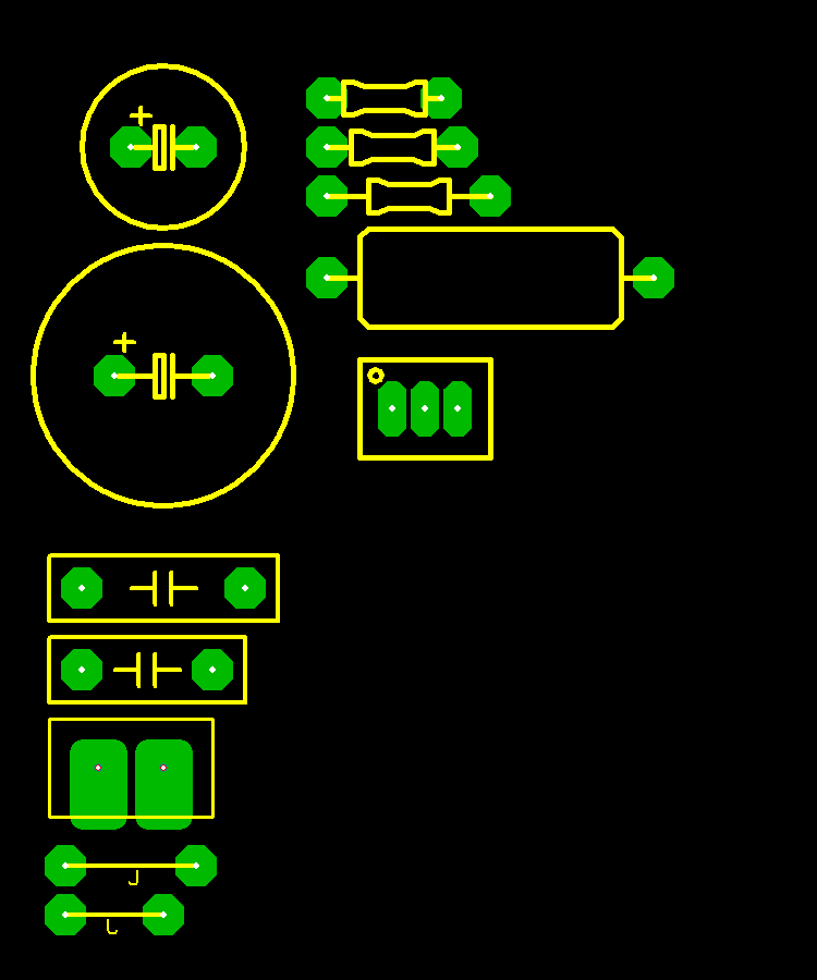

That is why I am working so hard to refine layout techniques. Also making my own sprint templates (makros-german 😀) for "better than alex" results.
(below - my own work). 🙂 All that paint shop, :headbash: paid off !!

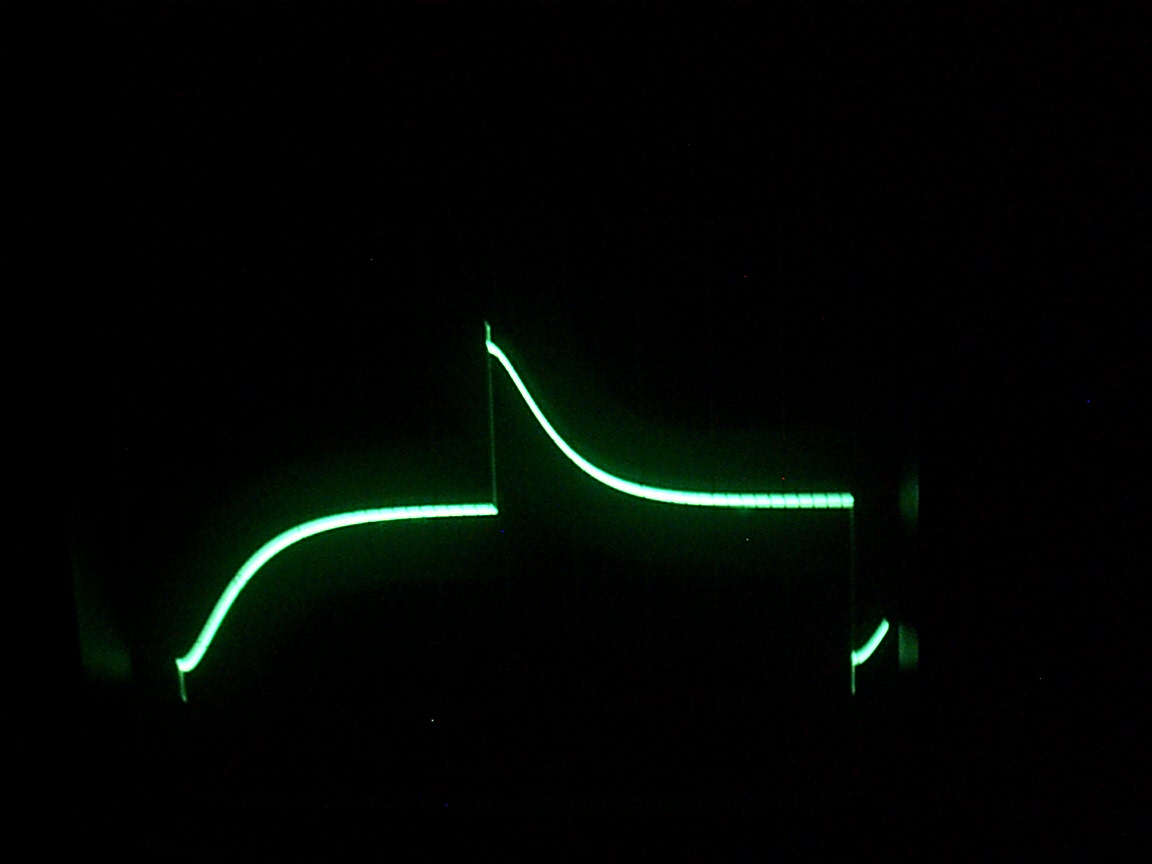

OS, the fact that the oscillation frequency is so high is a sign that my layout is effective, and the fact that it was stable without output bypass until I slapped it with a 2.5' long coax.
Although, I daresay it may still be oscillating, just at higher than my 20MHz scope can show... Noise is low though which would seem to indicate otherwise.
- keantoken

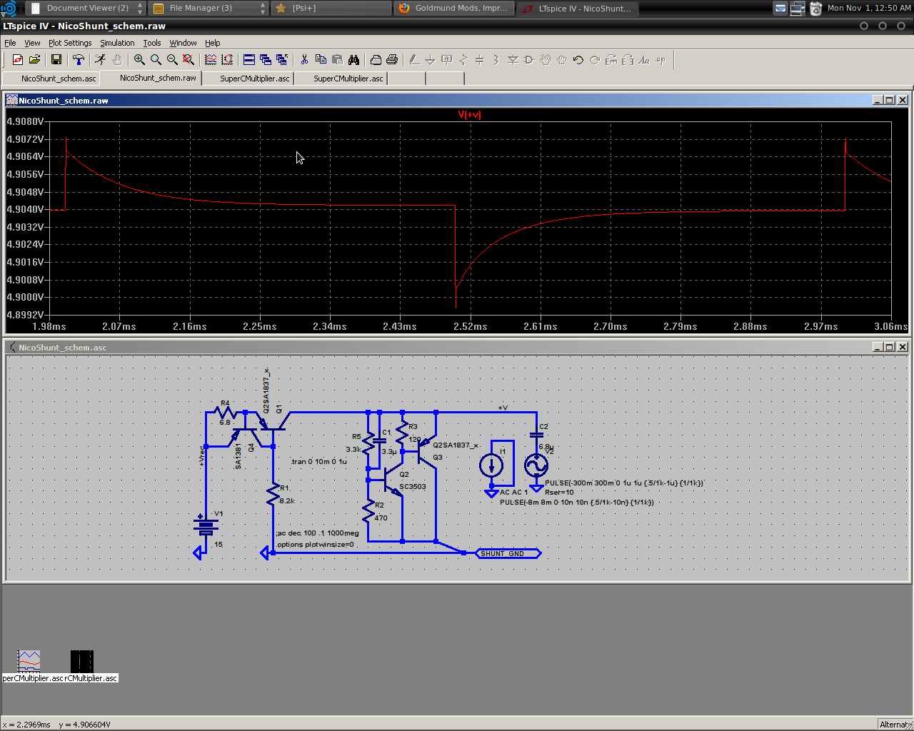

Does that plot look familiar?
- keantoken
Yep, it only slows down by the output cap. In the final layout if integrated to the driver board is the best time to decide the final output cap's value. One that will not show noise, mitigate layout inductance (i.e. no oscillations) and be fast. The type and make will play a role, and better be that certain cap fixed in BOM. How's the drift with the passive ref? Is Vbe steady enough?
