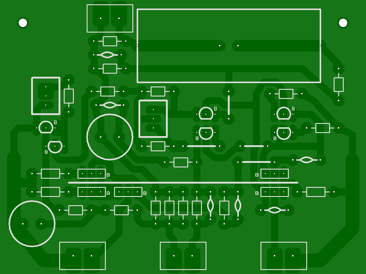

How about something similar to the Goldmund but shrunk down with all SMT devices, other then the output devices and what not of course. Well that and whatever other mods you guys deem it needs.
might be nice if you could cook it down to diy friendly single sided boards
and not make it too complicated
I would suggest to forget the Goldmund "competition" completely
it started out like that, sure
I hope the priorities are now to do the best you can think of, and not "just" a different Goldmund
at the present stage I think its about using laterals, mainly
and to find out what that takes
Im sure you guys can do it

Yes that's what I hope 🙂 I don't know every one seems to say that an SMT design sounds better, I imagine it's because of the shorter trace length and what not.
You mean SMD ?
well, it could make sense in some places, and do a mix of SMD and ordinary through hole components
for one, SMD components cant be used for jumpers
but might be a problem to get the parts
seems to me that many SMD parts are only available in larger quantities

I think that commonly used parts and some strategy with board layout would do the difference. Once someone asked here: "Holes? Why holes?" He meant that we could avoid the holes by soldering components at the tracks side. This would also make easier the use of the ground plane, I suppose (sorry, never etched a double layer board before).

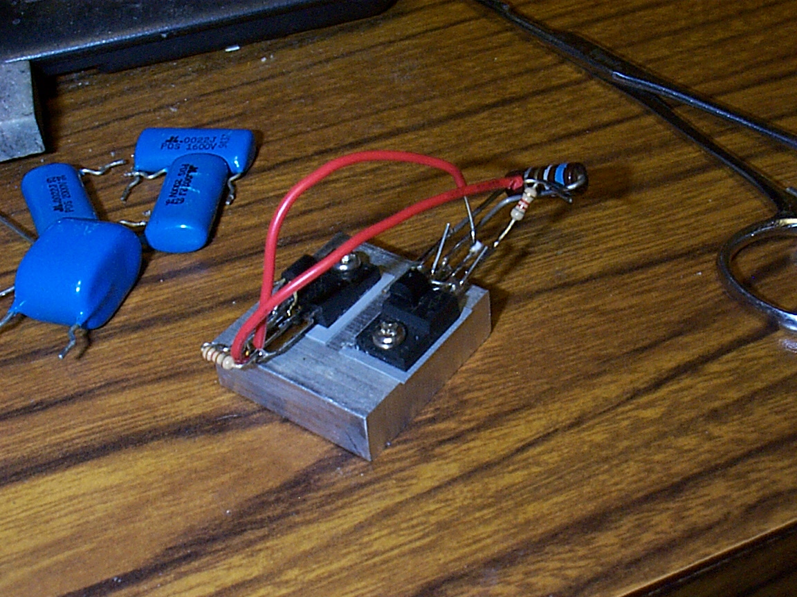

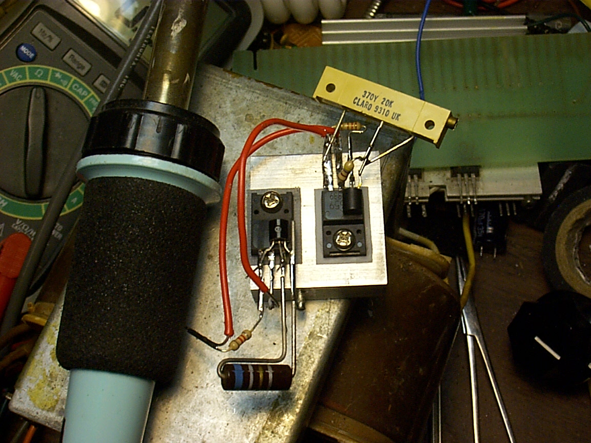

I am currently building the shunt regulator, but won't be able to test at HV, only say 30V. Uses 2SA1659Y, 2SC945P for CFP and 2N4126/C1659Y for CCS. Unfortunately my signal generator broke, so I won't be able to test it. I will at least be able to test stability.

Keen , you do the point to point thing , too. 😎 I thought me and carlos were the only ones. I guess it is the only way to the TRUTH...
I did my first VB with sprint today. (below) I went with the to-126 version of the original goldmund with just a 3 device wilson mirror and added input CM. I will abuse it/test it. That is the only way to do it. I'll make separate boards for the BJT/FET versions.
