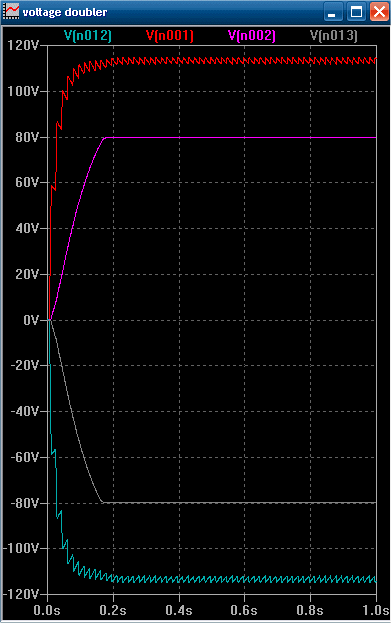

Many ways to get HV ... doubler/Tripler , wire 2 trafo's together in series , add 2 small trafos to a larger CT one (24 - 45 - 0 - 45 - 24 / nico's trick)

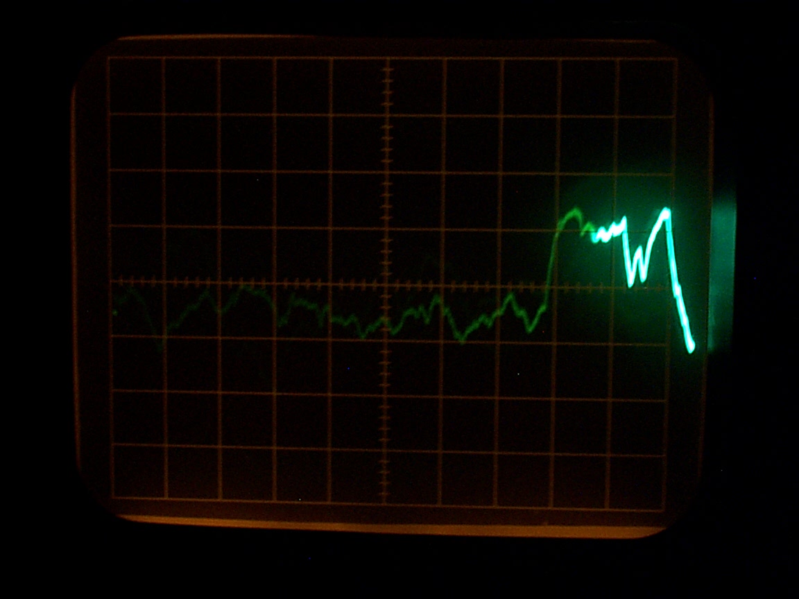

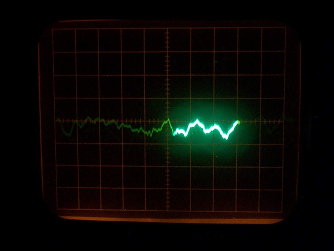

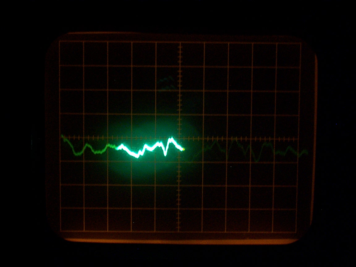

LF noise! 100uV/div, 50mS/div. It is neat to watch and try to identify a pattern. Oddly enough it looks not unlike brainwave charts I've seen. We would have to see it with a spectrum analyzer...

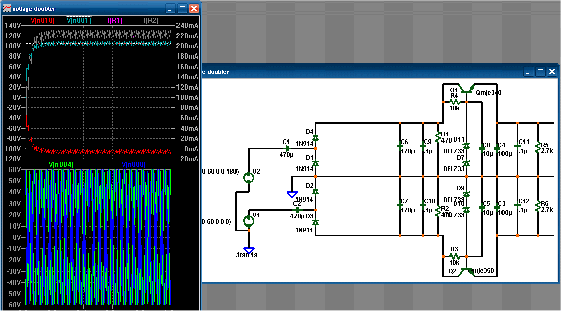

I was thinking with the 60-0-60 V cheap trafo... http://www.diyaudio.com/forums/solid-state/175289-goldmund-mods-improvements-stability-56.html#post2344610 (post 560)that would rectify out to 110- 0- 110V (160v/470uF caps) , with a 470r load (220mA) , I still get 105V "dirty" DC. look at schema/plot. This is close to what the original goldmund must do with that 60VAC tap. I just would not want THAT on my power board. Offboard is preferred , I mean we are using a separate trafo anyways , why bring the trafos leads to the OPS board??
If we run the OPS at lower rails (60-70V) +/ - 80Vreg would do fine. 🙂 BTW , just ignore the crude Zener reg's. , I took the readings BEFORE them... (second pix) is the real OP of +/- 80V , 40mv ripple ..OMG! Just for laughs.. 😀

It (the goldmund)has the equivalent of my mongrel cap multiplier after the doubler. all I had to do was increase the 10uF's to 100uF or more .... about 1 mV after. My point was that there is plenty of voltage to play with , OVER 120V w/ no load and that the regulator will have to deal with 5V ripple by default. (Big 160V caps are costly)

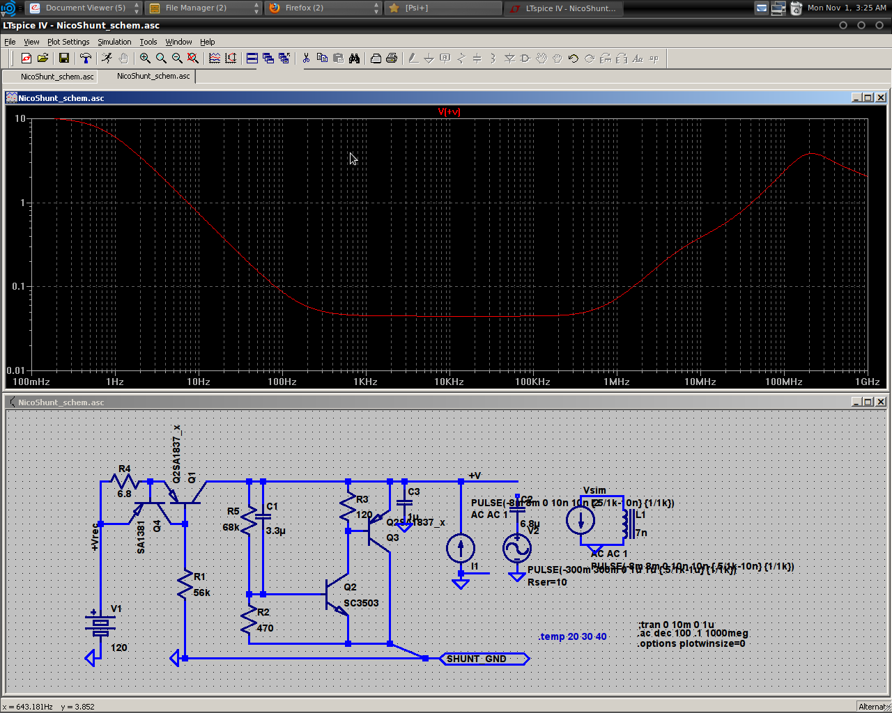

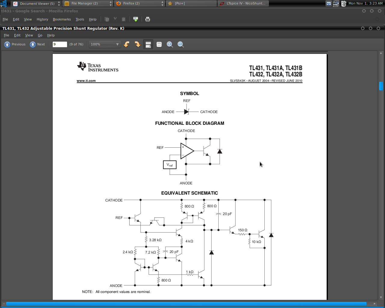

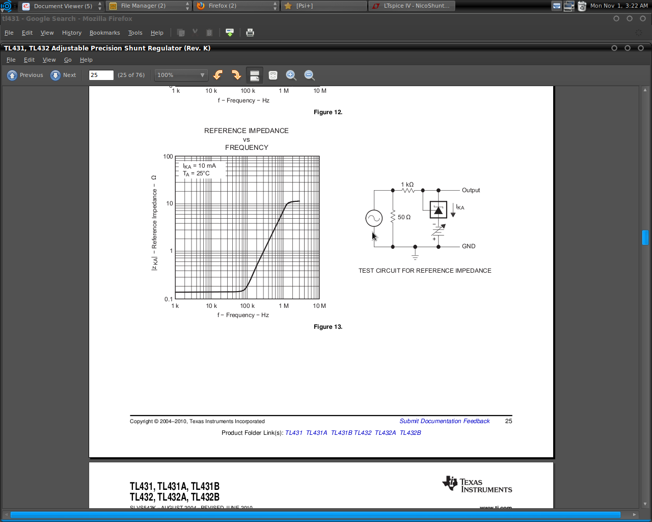

MiiB, the TL431 is slower and has lower impedance. About the only improvement is in bass, and if it's that important we can substitute zeners for R5.
These comparisons might help you decide which is more appealing.
