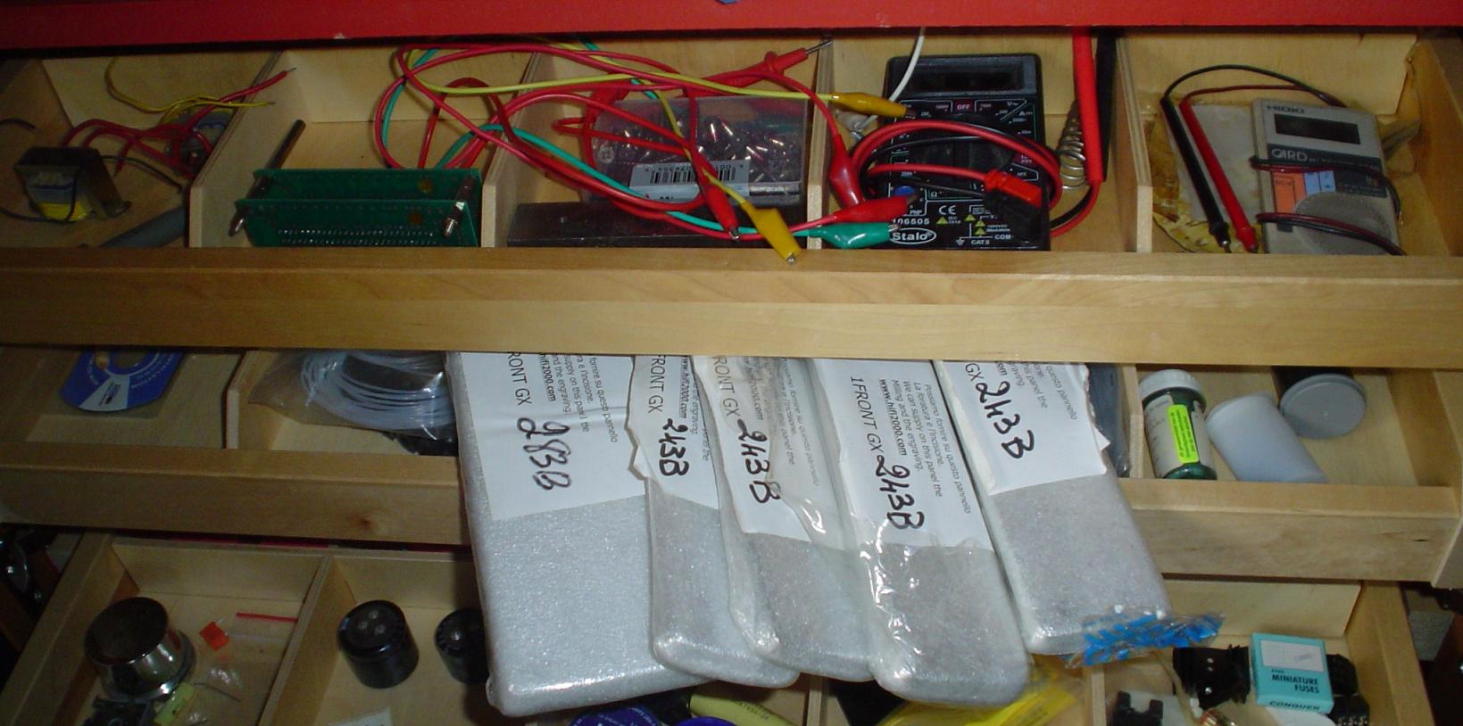

To solve the storage problem i've built closets with Ikea pull-out drawers, 20-section each, 30" wide, 20 drawers in each closet.
Helps a little, i tend to buy chassis and front panels by the dozen for future projects too, transformers, or big rubber amp feet from Apex by the hundred.

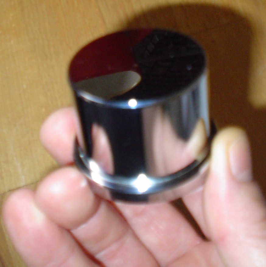

Example of the stuff i built +20 years ago, welded chassis frame, polished and chromed machined 6mm panels, hand engraved, one-off machined and chromed hollow bronze knobs, all DIY moi.
(hand matched MAT02, 0.1% L+R selected RIAA polystyrene, hand made pcb dampers, ear-selected silver plated ptfe hookup wire)

Here's a spare knob, 60mm diameter, polishing chrome drives a person bonkers.
(see why i enjoy your vet guy so much ?)

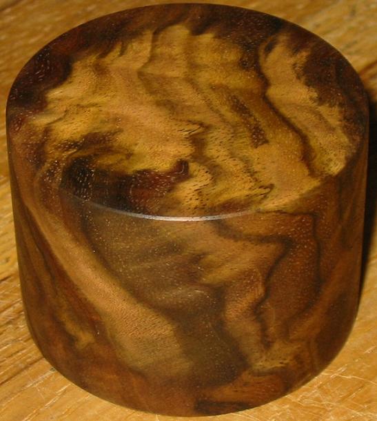

Others may fancy a CTC BT original knob model more.
