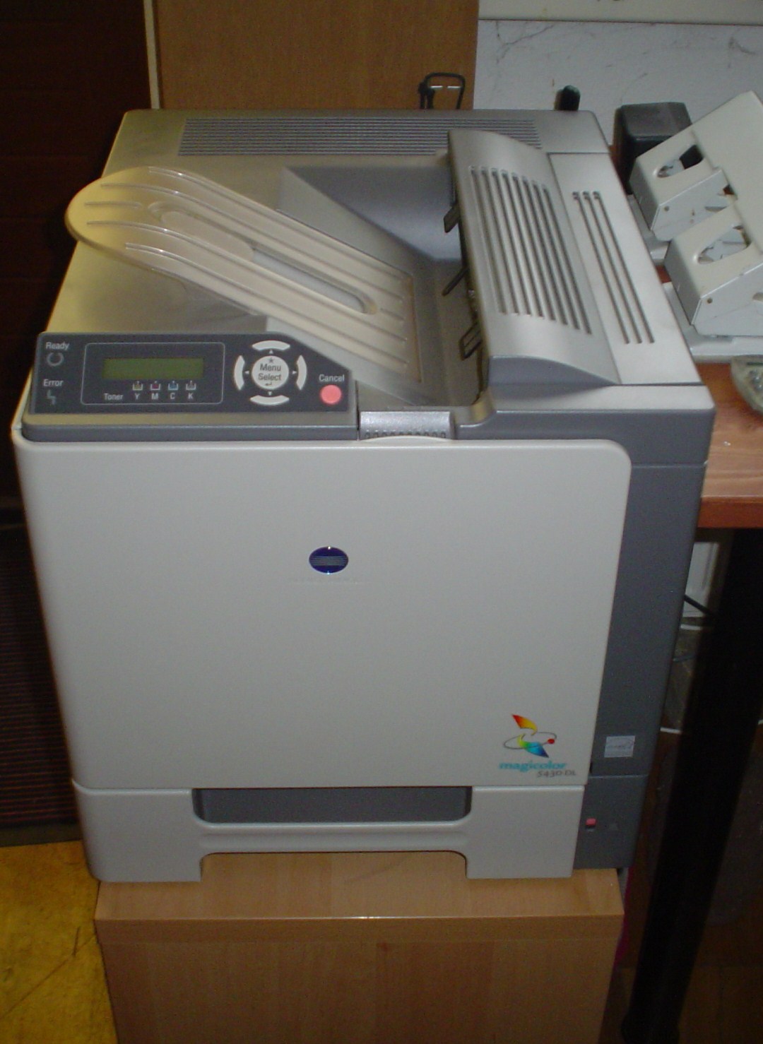

Er, it's normal to etch both sides at the same time... hasn't anybody here ever made a doublesided board?

Yes that works when you have transparencies. NOT with iron on laser transfers.
It works with iron on laser transfer also. Drill through the paper at your registration holes in the first transfer, iron it on, then drill through the board at the registration holes, align the second side transfer with the holes and iron on. Remove the paper and etch.

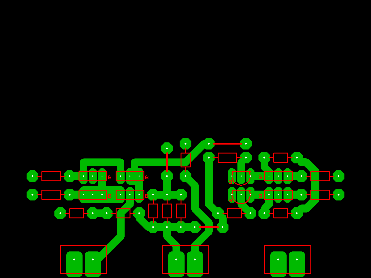

I am having fun with the new pcb software, so lets get me and a couple of other guys some schematics to build and try some pcb layouts with.

I think I can even get nearly jumperless with my new toy (sprint layout-below).

Them pads are just "fat". I am workin' from ..(below-best candidate). Soon.. w/splan , prettier schematics will be the order of the day. Front end will have every mod known to play with while remaining professional. I had to learn how to make my own "macro's" , I now have my own library of custom HD patterns. 🙂Hey OS

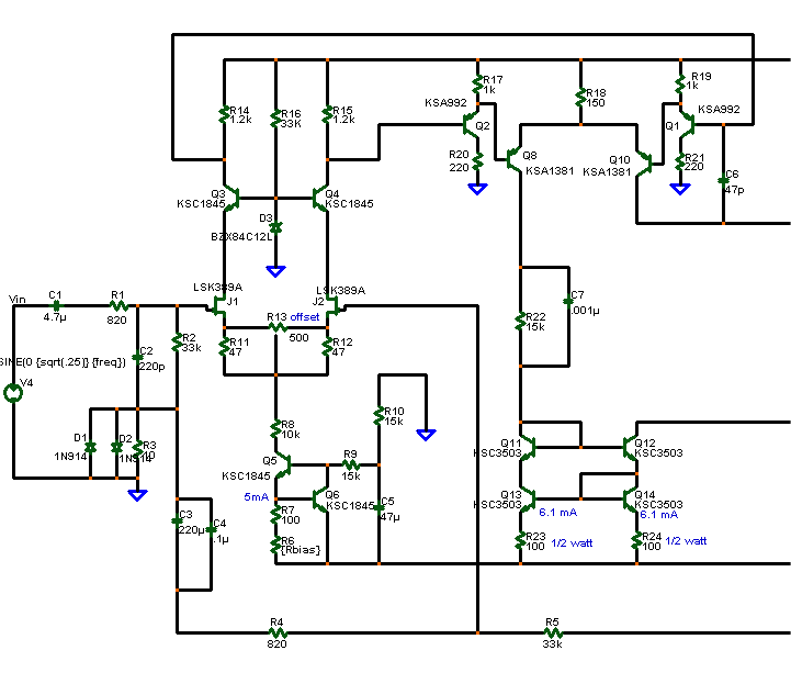

No and yes... This voltage board will gracefully accommodate the basic 4 tranny original VAS or the 8 device beta enhanced version. Before I would ever send a board off for "mass production" , it would have to be absolutely exceptional in both stability , reliability , and looks/layout. Of course it would have to sound exceptional, as well....and to a wide range of people.
We should be able to do it with 2 boards. The big one (OPS/HV PS) , and the little one (VAS/LTP). What is "nicer" about this , is that the small signal stages are not even close to the power stages... not even on the same board. won't be stuck with a bad design , just rework the board - plug it in !
Personally , this coincides with my development of my symasym board (CX) , so I will be the first to hear THIS voltage stage (10 days from now-I need FR-4). I will start the "Big" board , but only if it incorporates my plugin. IF , for any reason this is unacceptable , screw everybody

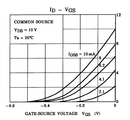

Its not that hard to consider a better Tempco region in a JFET Norton Vref's type CCS. A 4mA IDSS K170GR shows -0.5V pinch off (-Vp) on its datasheet. Vgs(0Tc) will be (by that formula I mentoned) 0.5-0.63=-0.13V. Its Ids-Vgs curves show 1.8mA Ids at Vgs0TC.
IdZero=(0.63/0.5)squared*1.8=2.857mA. A proper source resistor for that would be Rs(0TC)=0.13V/2.857mA=45.5R. Our Norton ref resistor for say 90V B+ to voltage stages of the amp will need be (90-vbe)/2.857=31.29K. Practically you stick a 33K 1W and a 100R Rs trimmer in Kean's CCT and you play midway travel near Zero TC. The large impedance can be cleaned easily for self noise by a 2u2 MKP with no real ESR to keep noise bugging up high in frequency. The residual 33K resistor noise is 23.4nVrtHz. That was it.
