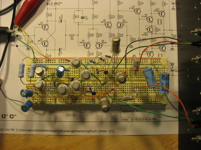

The parts actually sang to me a couple of hours ago, and I'm going to go with a design that incorporate Germanium devices in a Darlington config, with diff front end, and active loading. It won't be the most efficient beast around (what Class A design is?), but it should make some noise. More (much) later, as my Aleph headphone amp will be usurping most of my free time.

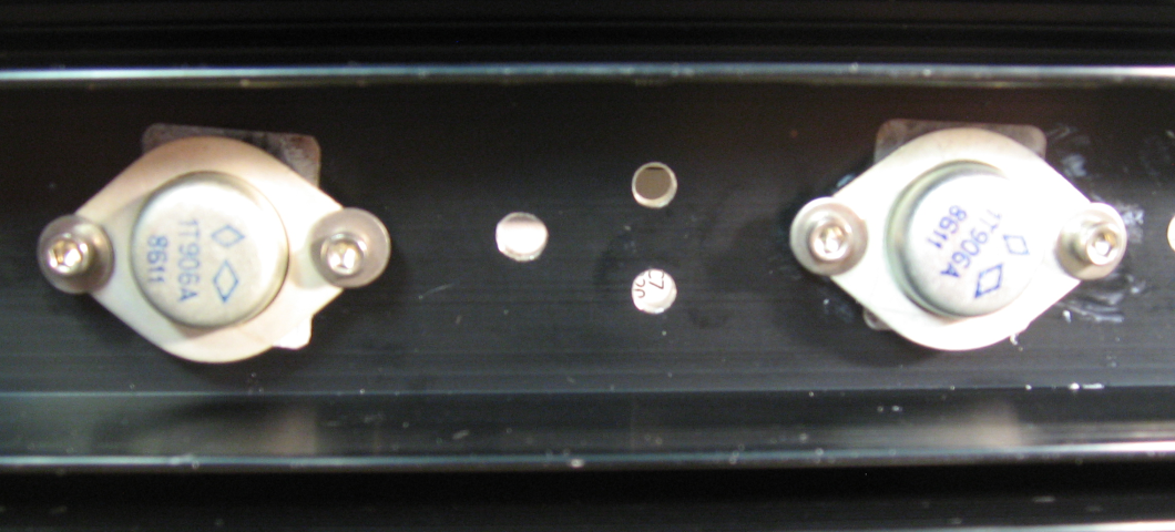

Little Ge Power Amp

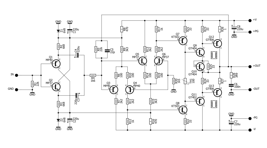

Here is a little Ge power amp using Soviet (mostly) Germanium transistors. The schematic was suggested back in 2005 by WP@forum.vegalab.ru (in Russian), I just added a Baxandall diode (Q10) to improve the output stage's symmetry.
The transistors are:
With +/-15V supplies, it can deliver 8-9Vrms before (soft and nice) clipping. The supply voltage can be increase to +/-18V, but since the drivers are only rated at 40V, a regulated power supply would be a good idea.
Also, the amplifier quickly runs away thermally, as I didn't have a suitable thermistor at hand, so a current limited power supply saves the day. Stability/compensation needs to be revised once it is off that solderless breadboard.

- MP37A and MP40A - small signal NPN and PNP, respectively, rated at 30V, 20mA, 150mW, fT 1MHz (common emitter), hFE 15..30
- GT402G and GT402G - medium power NPN and PNP, 40V, 0.5A, 0.6W, 1MHz, hFE 60..150
- GT906A - power PNP, 75V, 6A, 15W, 30MHz, hFE 60..150
- KT502/503 - small signal silicon transistors
No Germanium designer would use 13 transistors for 8 Watts. 20W-80W with 4 or 5 devices was par.
You could use Ge diodes. Which can be half-dead Ge transistors. But now we approach 17 devices.
I have every faith that your project works. Just saying it isn't historically typical. A lot of audio improvement is not from Si but from increased production (computers) driving down costs.
Totally agree! Sixties style amps were using the absolute minimum of (expensive) active devices. No current sources, no current mirrors, no LTPs, no diamond buffers, no dual NPN/PNP followers, and certainly no RF power transistors in the output stage. These days, even those old Ge parts are cheap, so one can explore completely different topologies.No Germanium designer would use 13 transistors for 8 Watts. 20W-80W with 4 or 5 devices was par.

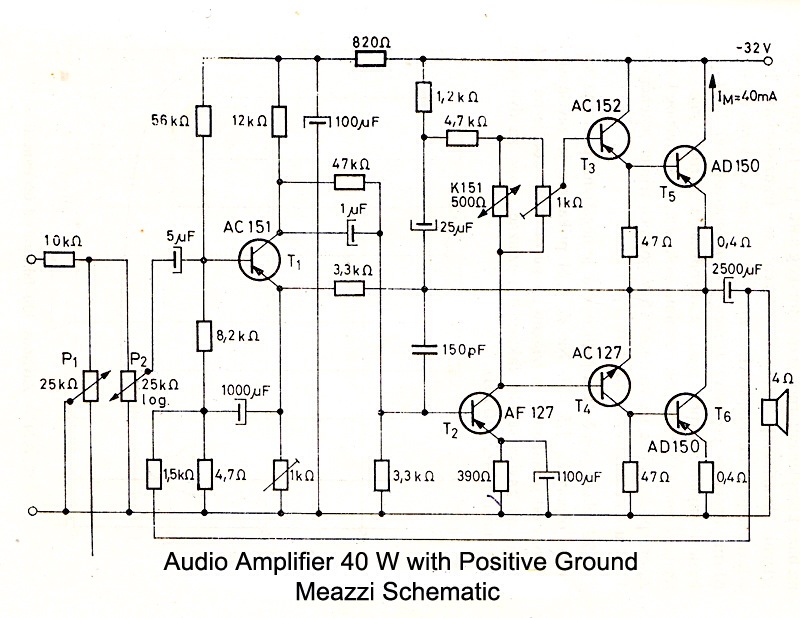

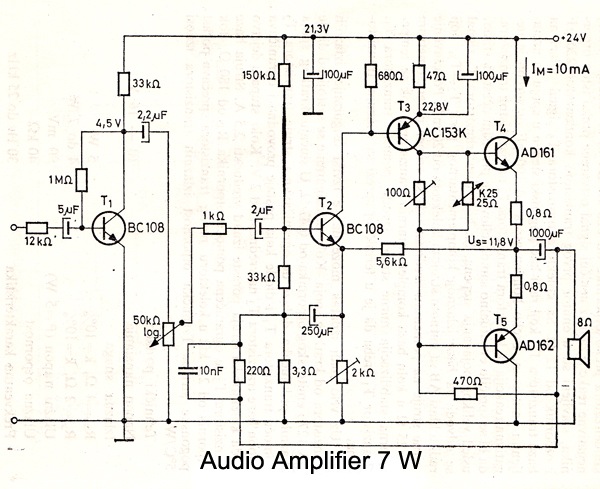

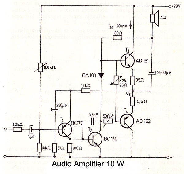

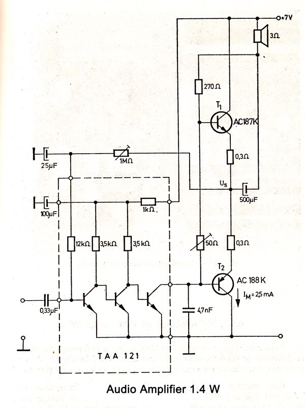

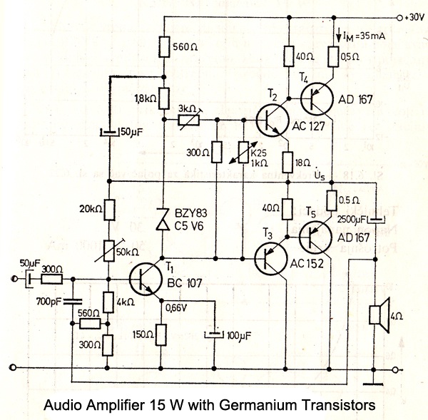

GE schematics flashback

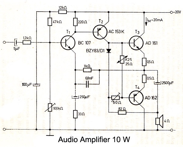

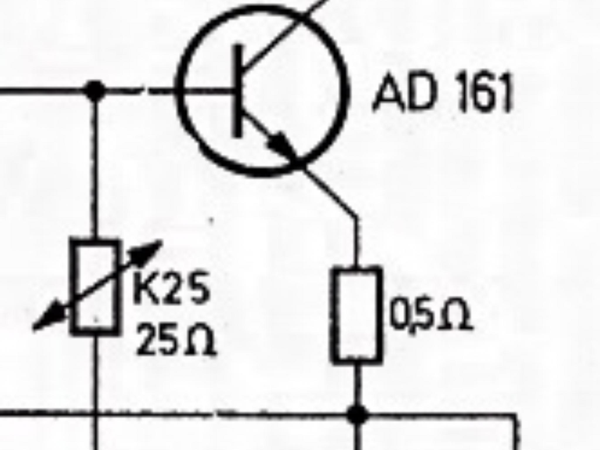

K25 was one enigmatic component The answer is a thermistor.
