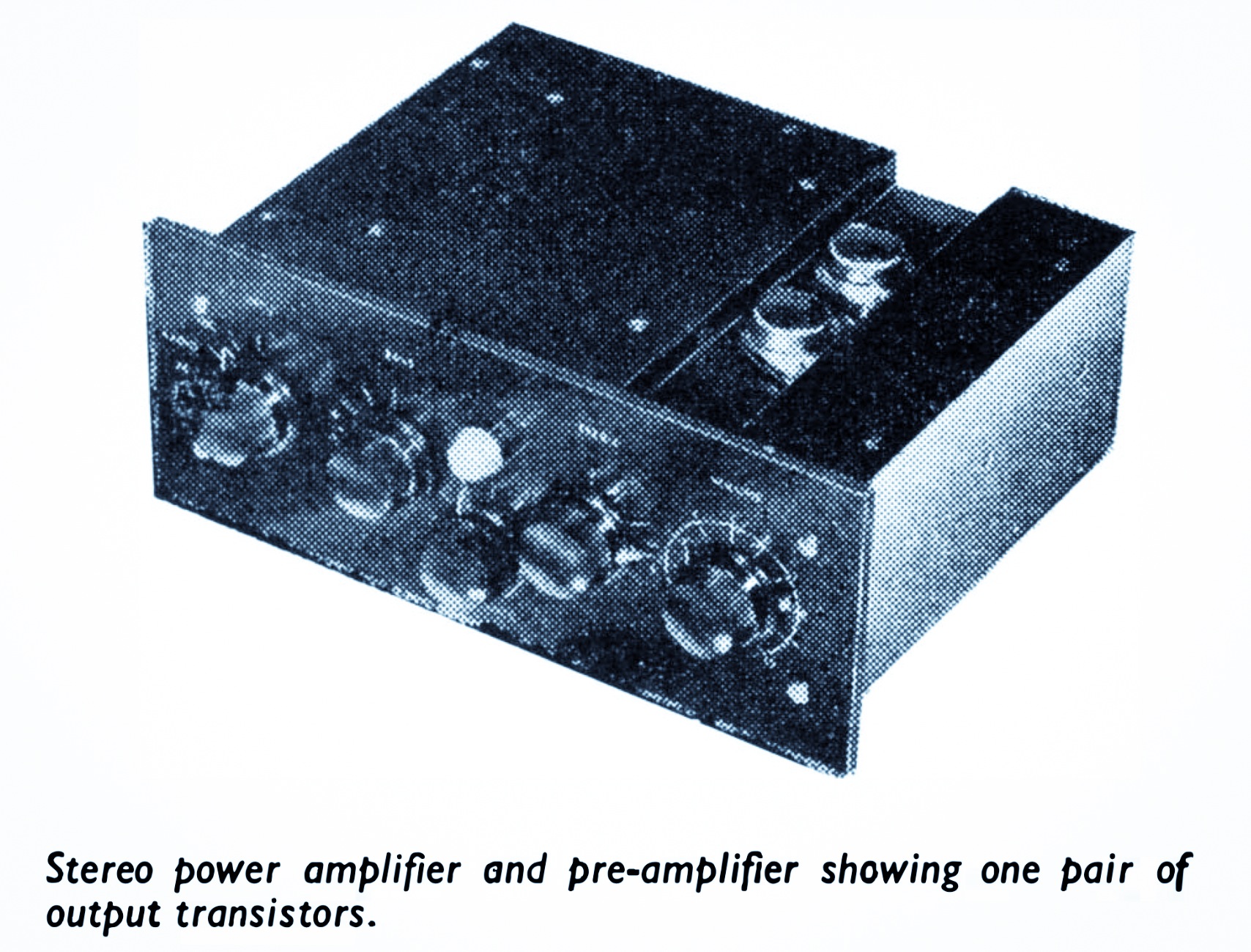

Imagine Ge's 2SB206 etc. green light curve traces show on the screen of Mr. MR Tektronix 577 Germanium investigations
Curious what amplifier Mr. Pass friend swear about desirable audio germanium output power stage quality.
Guesses high level of expectations with such long audiophile experience.

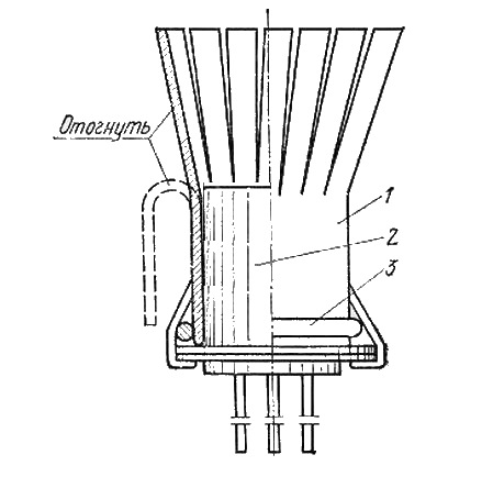

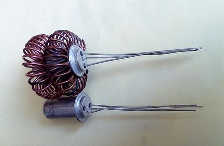

Home made heatsink for small signal Ge on the photo.
Source : Простой германиевый усилитель мощности - Усилители на транзисторах -

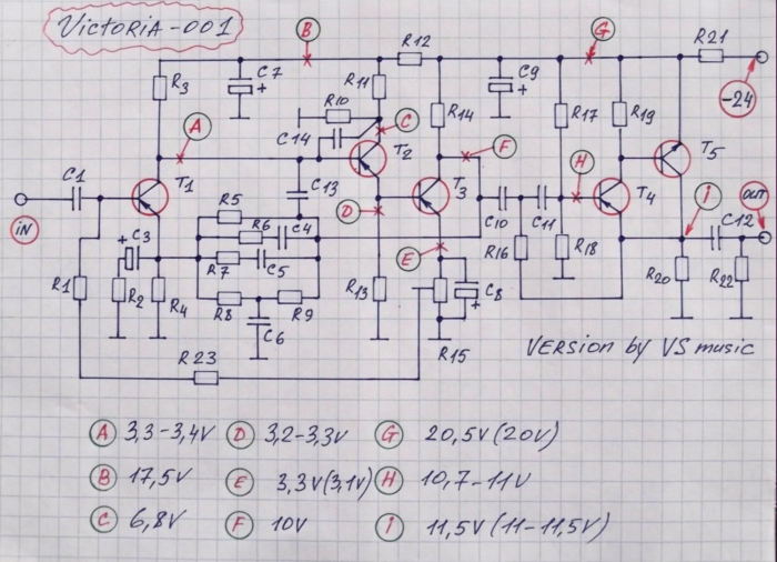

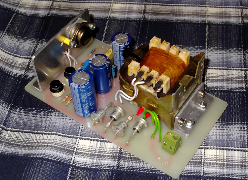

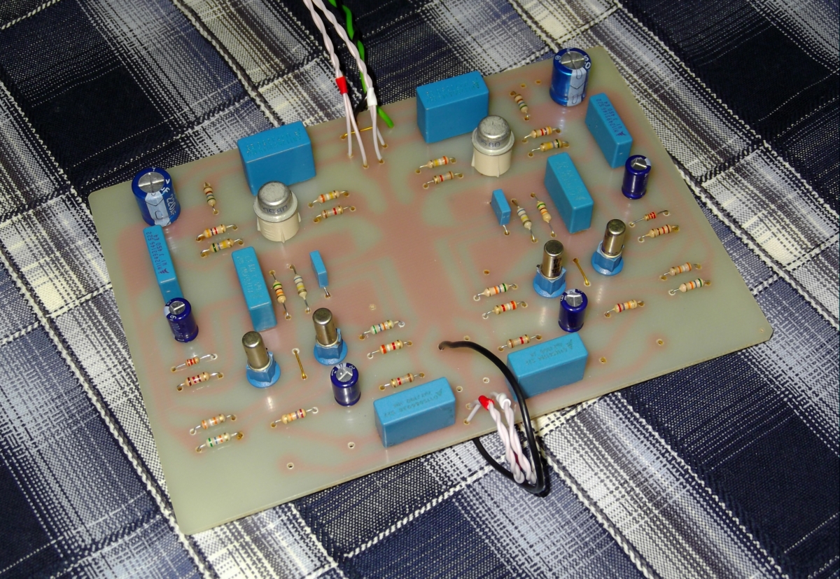

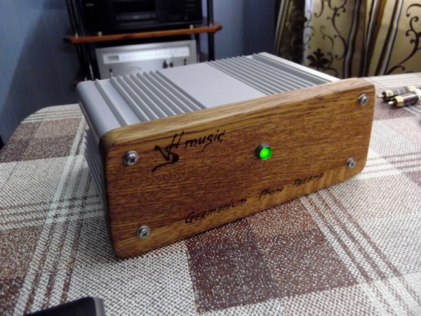

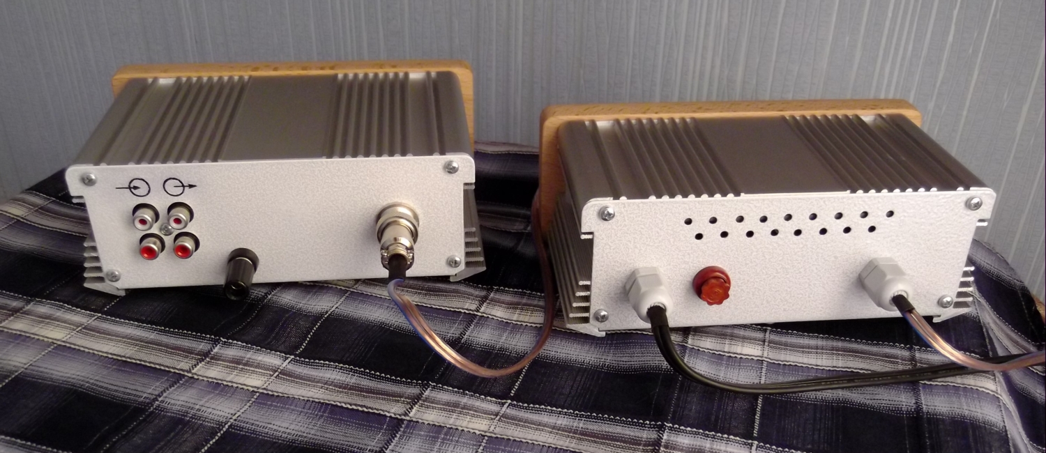

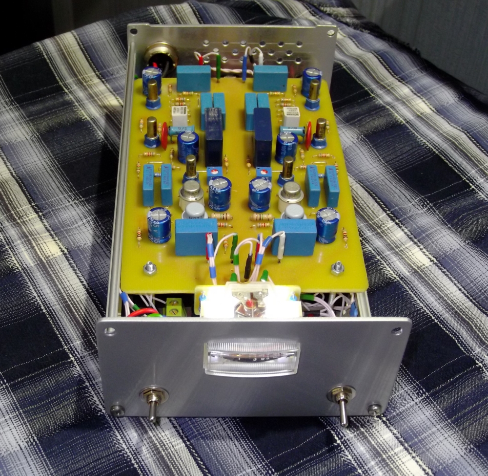

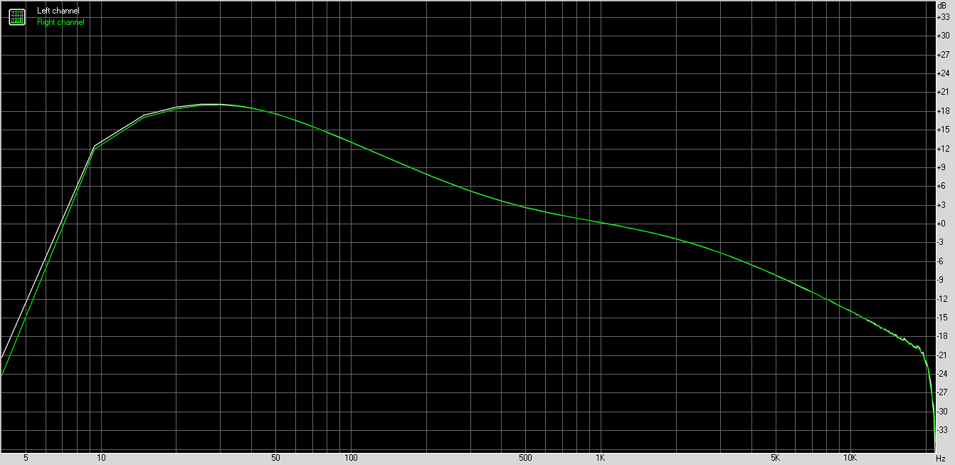

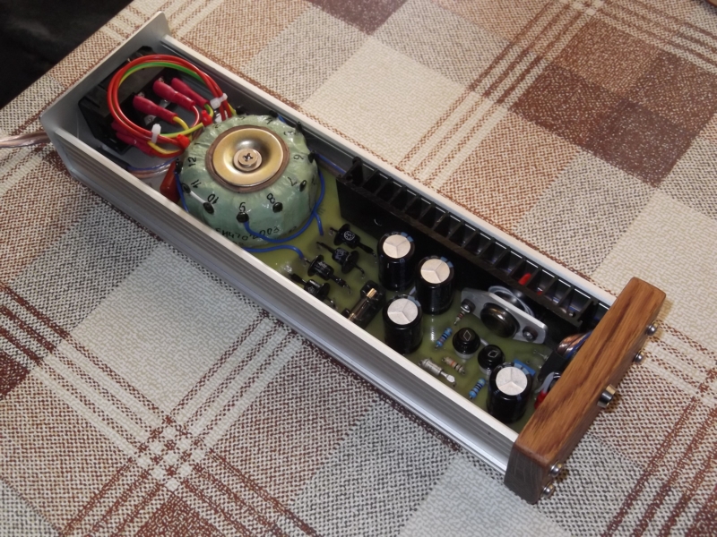

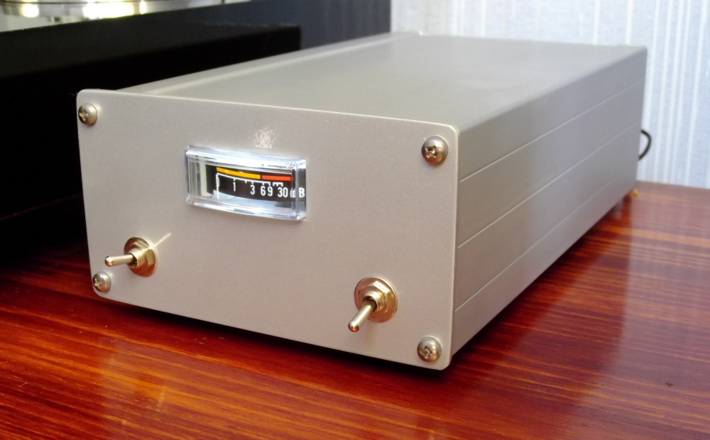

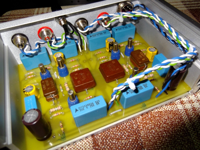

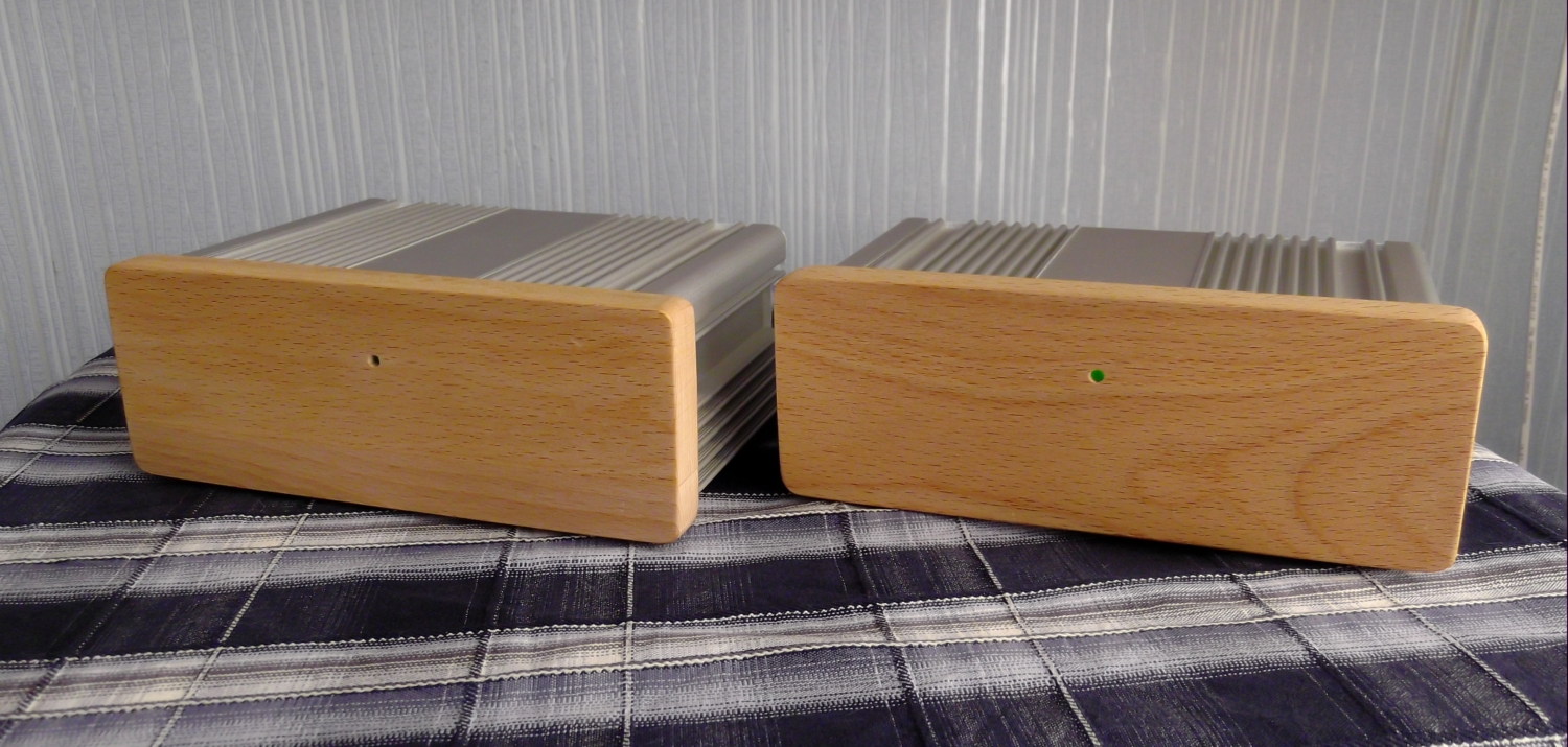

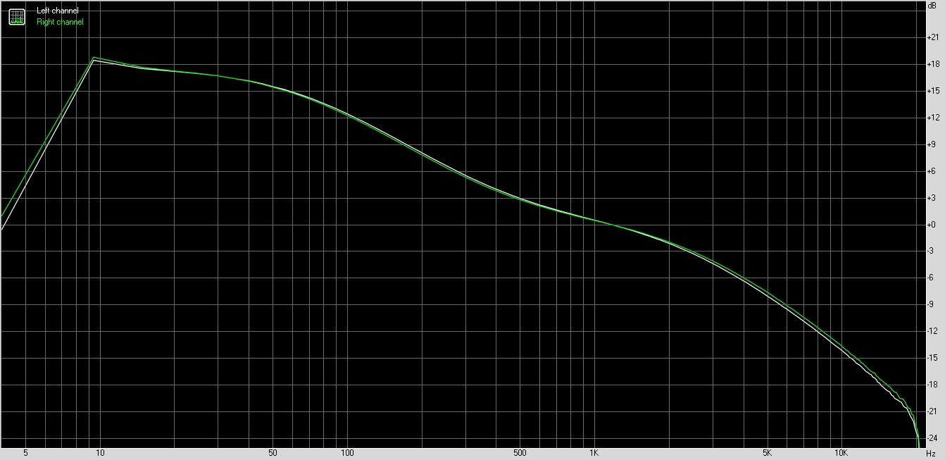

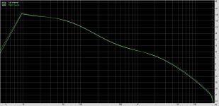

Soundhappy The first product is an upgraded version of the 1972 scheme . Measurements using RMAA showed this result-the noise level is minus 73 dB . Harmonics - 0.044% . The measurement was made at the signal level at the preamp output of 2 volts from peak to peak . Gain greater than 40 dB . The product is powered by a VRLA - 24 V battery (2x12 V / 0.8 a / h). The scheme has a rumble filter .The indicator shows the signal level and battery level. The battery receives a charge from an external automatic device .... The sound of this product is good . I use it in conjunction with the Kenwood KP-770d player and the Empire Broadcast one cartridge .

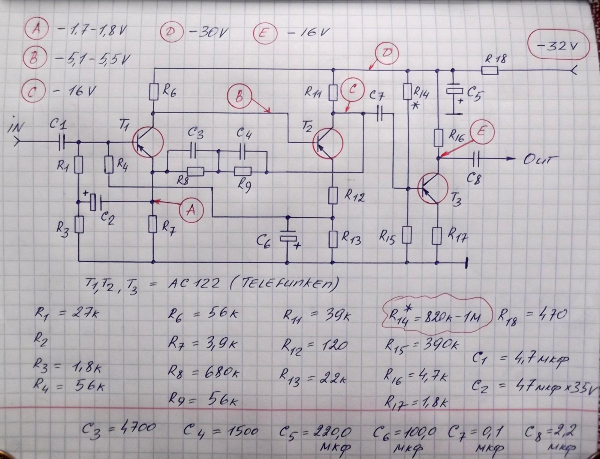

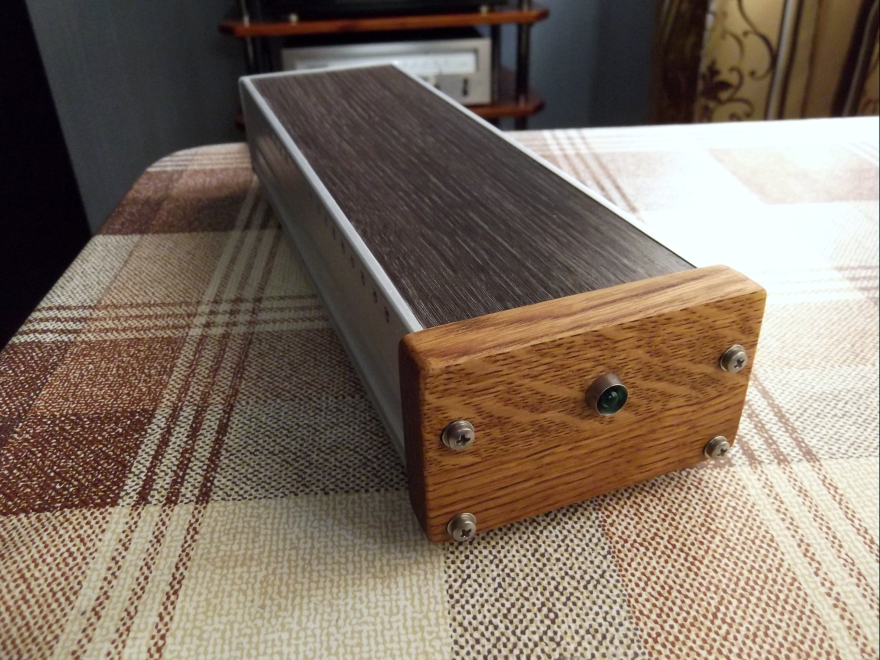

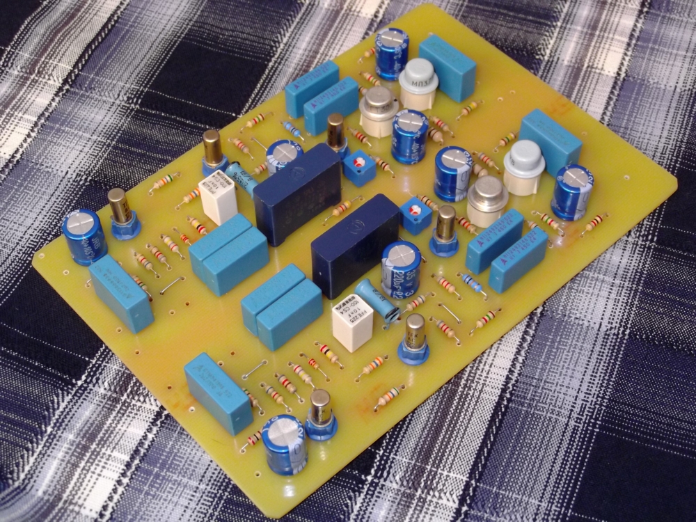

Soundhappy - The second device is an upgraded Telefunken TV-206 scheme . One transistor is added at the output . The gain is about 42 dB . The noise level is minus 73 dB ( at the output of 2 volts from peak to peak). Harmonics-0.016 % . RMAA . Power can be supplied from an external stabilizer 32 volts .
The third device is also made according to the Telefunken TV-206 scheme . Differs from the second product - a different type of capacitors in the correction circuits . This copy was made for a friend of mine .
Preamps on germanium transistors provide a very good sound-three-dimensional, with a beautiful transmission of voice and acoustic instruments . I like these preamps . I have been using one of them for about 5 years . I have preamps on both silicon transistors ( BC149C / BC550C/ BC560C) and JFET transistors (2SK170 ) . But I like the germanium preamps better ....These were experiments , and they are still ongoing - I am building another preamp . And this will be another germanium scheme .But there is still a lot of work to be done .

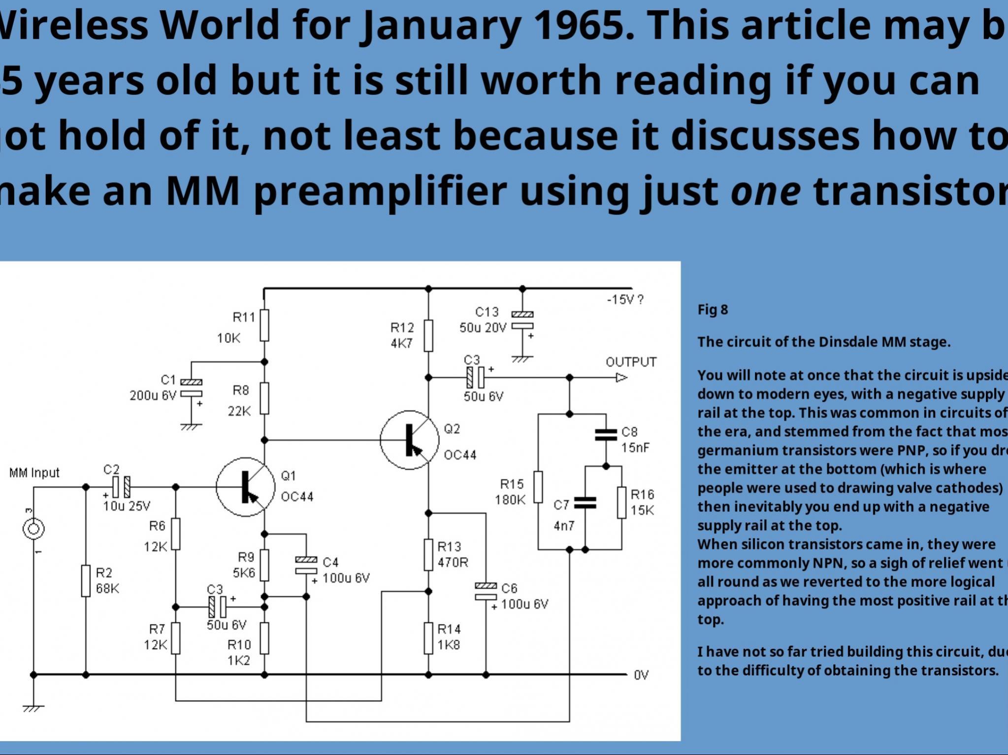

https://www.keith-snook.info/wirele...rld-1961/Transistor Audio Power Amplifier.pdf
https://www.keith-snook.info/wirele...5/Transistor High Quality Audio Amplifier.pdf
