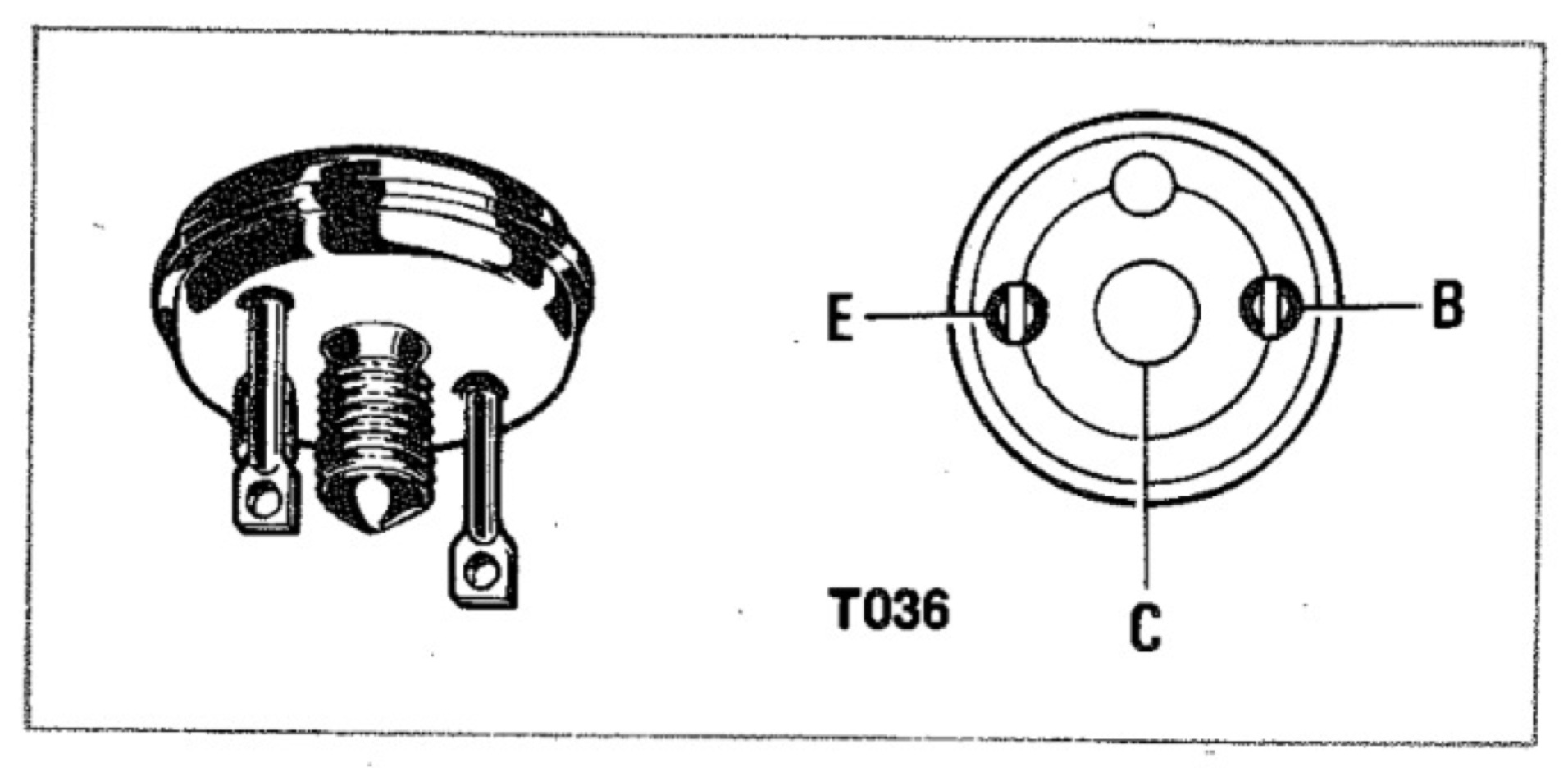

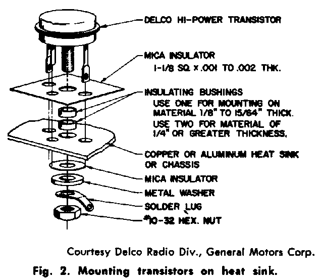

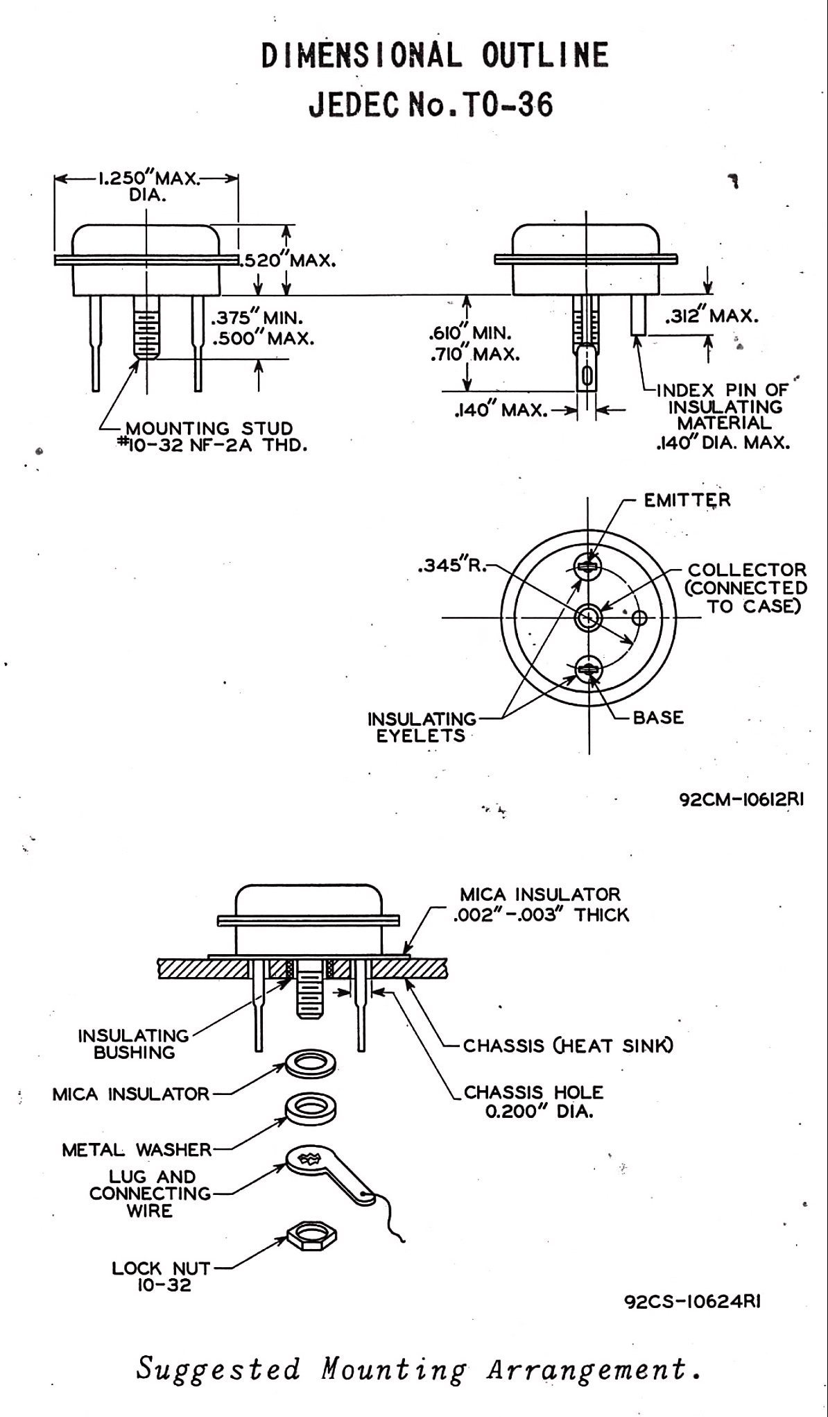

How do you heatsink those devices?
With a heat sink, of course - spot the holes using one of the insulators, and in a pinch, use a TO-3 shoulder washer to insulate the collector connection. The locator pin will also need a touch of heat shrink for insulation, as all the plastic sleeves used for that purpose have likely long disappeared from the market.
If you do some semi-diligent searching around on E-prey, you can find Keystone TO-36 mounting kits for a decent price - I just nailed down a few. I also have some TO-36 silpads floating around in my stash somewhere.

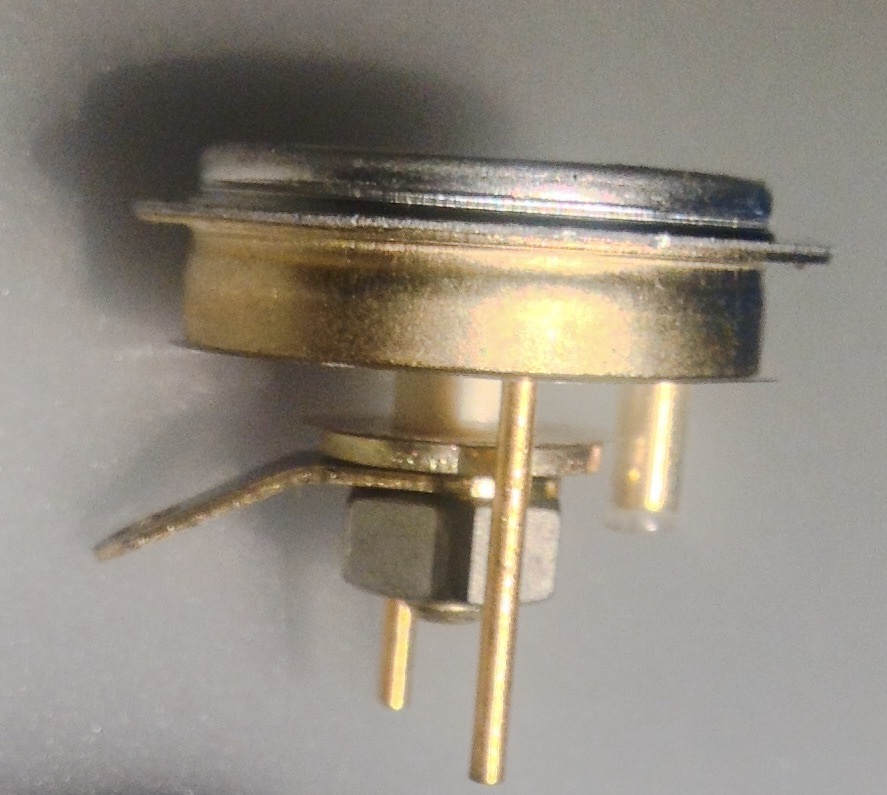

I just got my TO-36 hardware kits in the mail. There is no sleeve included for the locator pin on the bottom of the package. I'm going to need to check some of the TO-36 packages I have in the basement to see if the locator pin is already insulated. The JEDEC spec says it should be, but we'll see. If not, the pin could easily be covered with some heat shrink.
