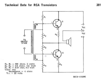

RCA vintage datasheet with typical amplifiers schematics examples

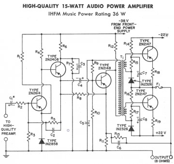

The first amplifier in my dorm room system at school was an Electro-Voice 1144 that used a class B solution vaguely similar to the one in the RCA data sheet with drive transformer/phase splitter and output coupling capacitor. The power amp used only 3 devices, a silicon front end driving the phase splitter transformer in Class A mode, and two germanium output devices. I got it completely busted, and had to replace all the power amp transistors with HEP equivalents for the inputs, and for the outputs, Ge samples that I begged from Bendix (a lot of players in the transistor markets in those days). It never was a stellar performer. and I ended up gutting the insides totally and replacing them with my own design - it sounded a lot better after that...

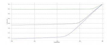

Any investigations news ?..Curves soon.
Peak tool max V / A range are ok for small signal but too low for the big Ge power transistors ?

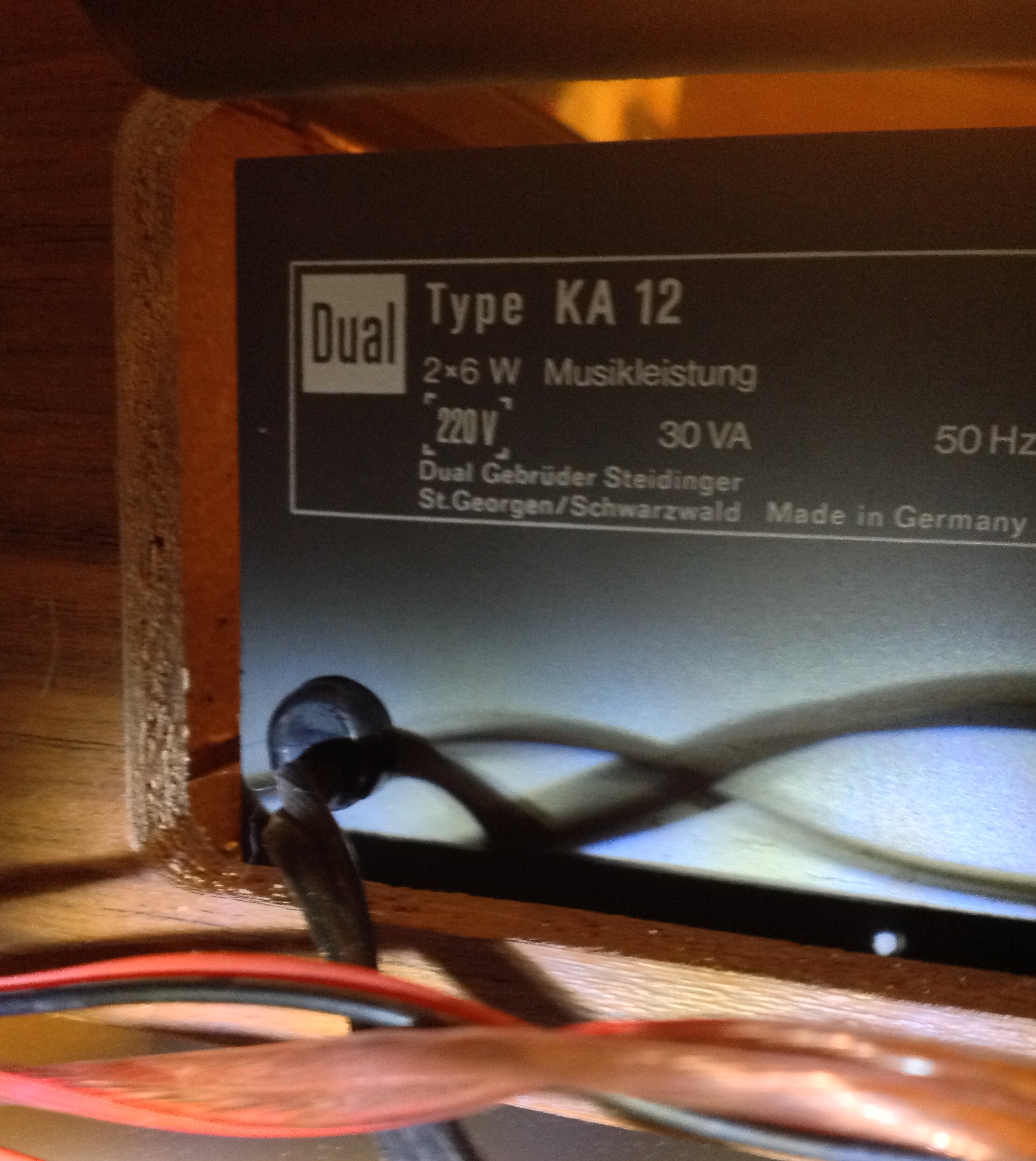

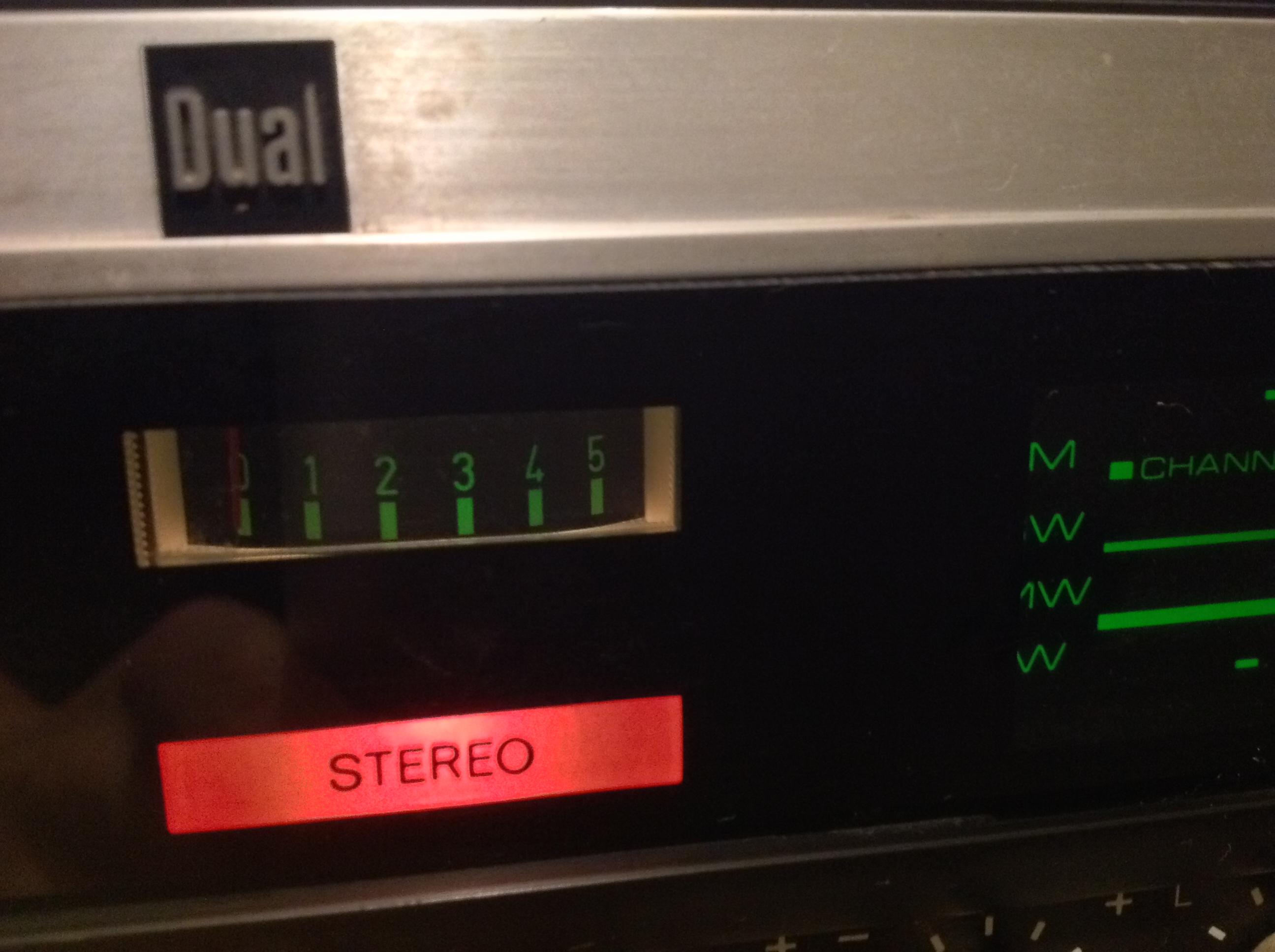

I can play music with vintage Dual receiver, have fews honesty watt's in class B 😀
Hi-fi mainstream product example from that time, Ge AC180| AC181 push-pull stage.
The sound quality is surprisingly nice and relax..
Pure Class A amplifiers with great components build PSU, big heatsinks are practically unknow , even today in the year 2020

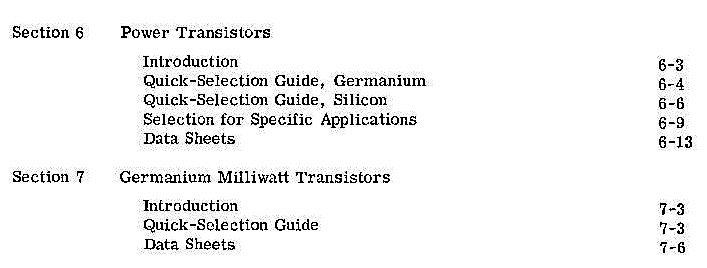

Plenty of germanium datasheet's made for audio: small signal and power stages
motorola :: dataBooks :: 1966 Motorola Semiconductor Handbook 2ed Aug66 : Free Download, Borrow, and Streaming : Internet Archive

The common transistor used in the germanium totem pole circuit was the 2N2147. It was in everything from Heathkit stereos to Acoustic guitar amps. The circuit design comes from the RCA transistor manual.
I wound my own driver transformers and used the circuit for everything from 10 watt guitar amps with car radio transistors to a monster amp that put out over 1 KW from 24 X 2N3773's.

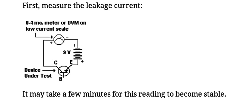

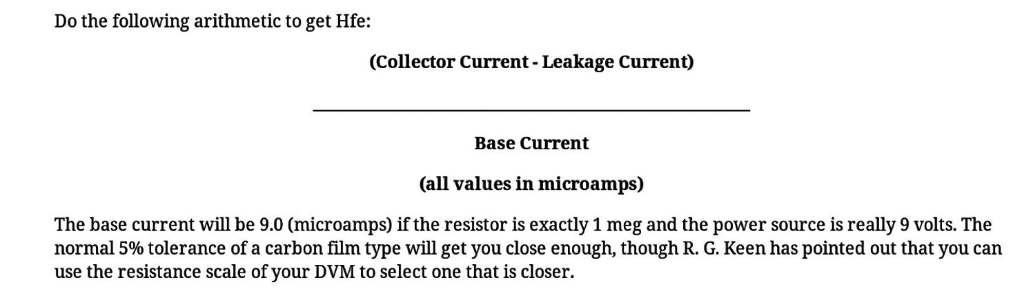

Germanium DUT circuit ( small signal )
