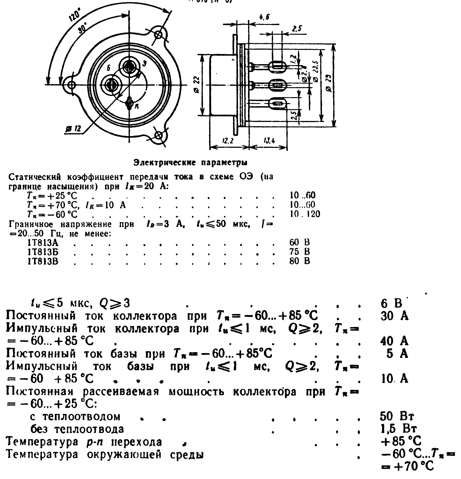

What is the maximum safe, and max useful, temperature of Ge compared to Si?

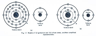

Ge and Si have different physical atomic structures and melting point temperatures.
Usually +85C, at junction.
Is that an answer? "COMPARED" seems to ask for more than one number.

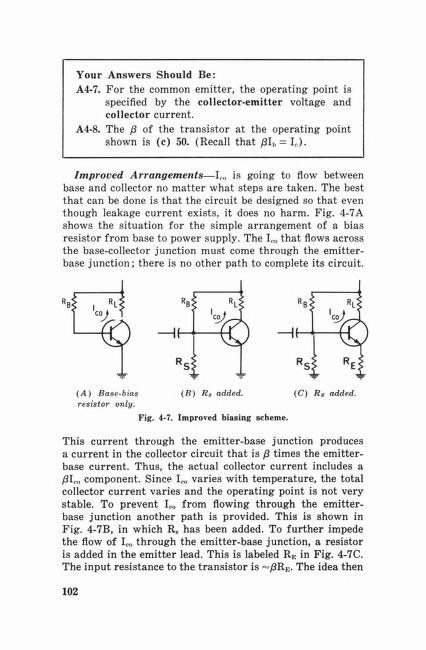

Anyway, I happened on this book from the end of the Ge era, with comparisons against Si biasing. May be good for those who did not grow up with Ge.
https://ia600301.us.archive.org/34/items/ElectronicPrinciples/GraySearle-ElectronicPrinciples.pdf 74MB PDF

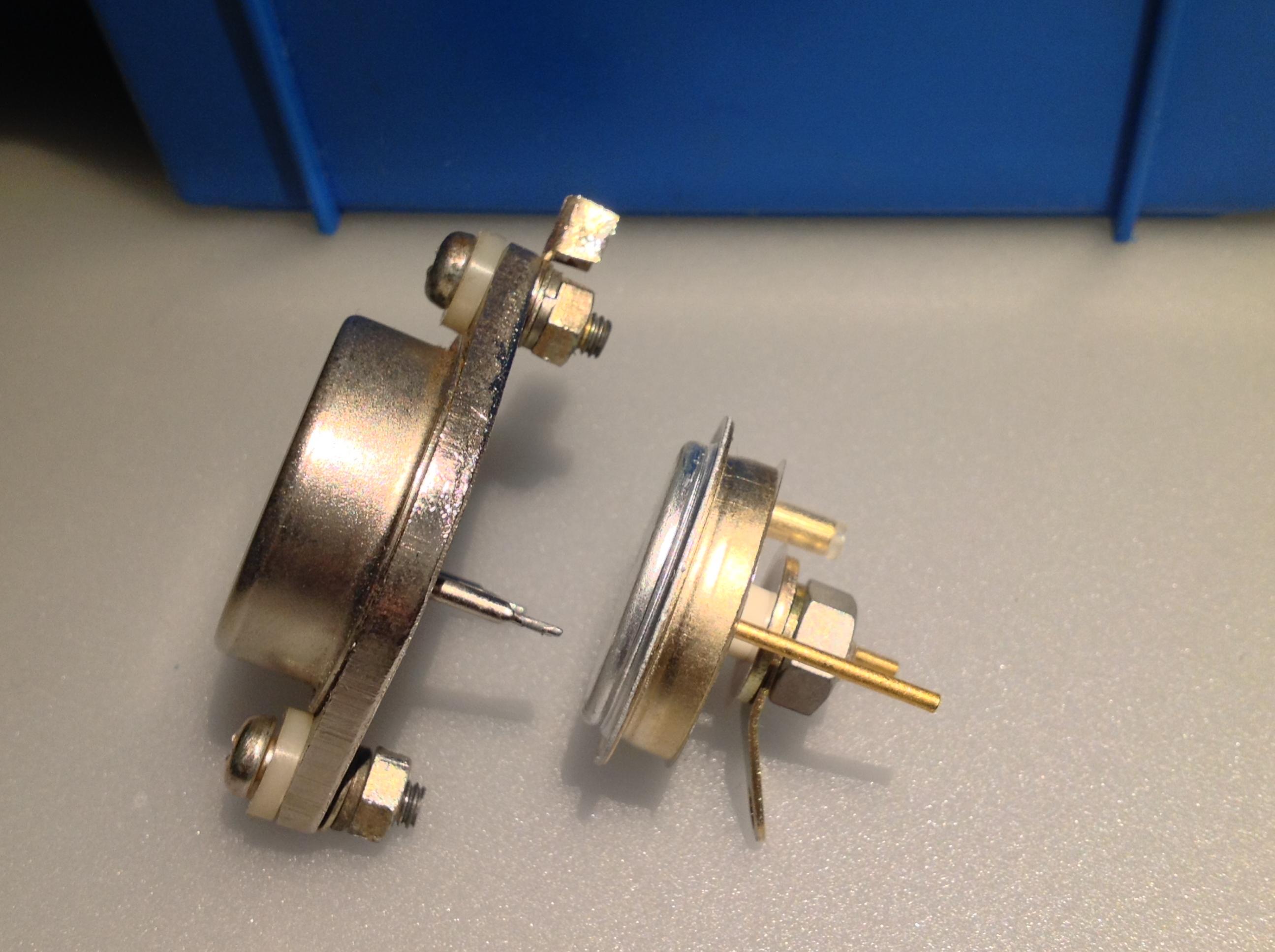

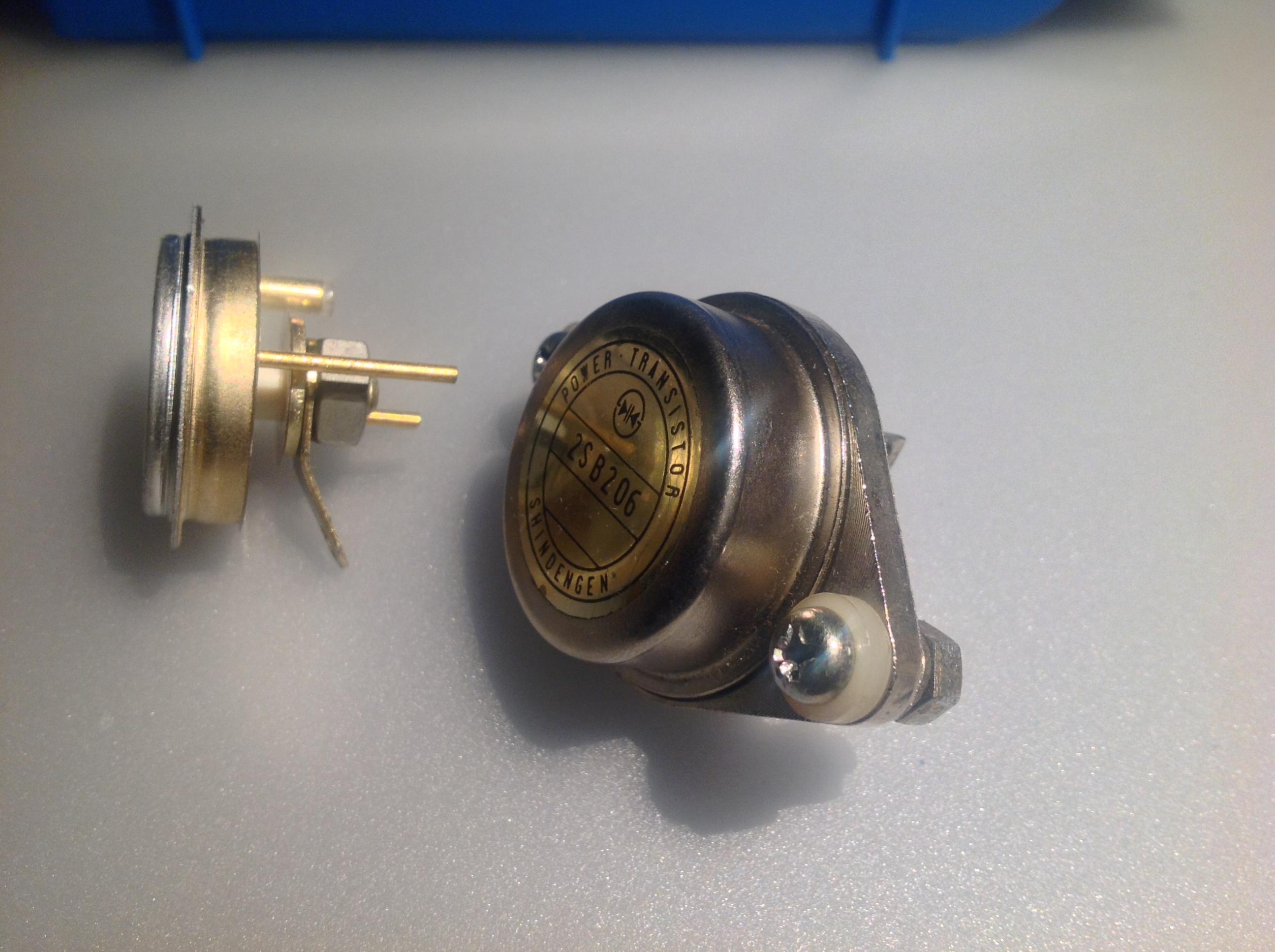

I am curious 😀My qty 2 of 2SB206 arrived..On the schedule is a curve tracer session with these parts.

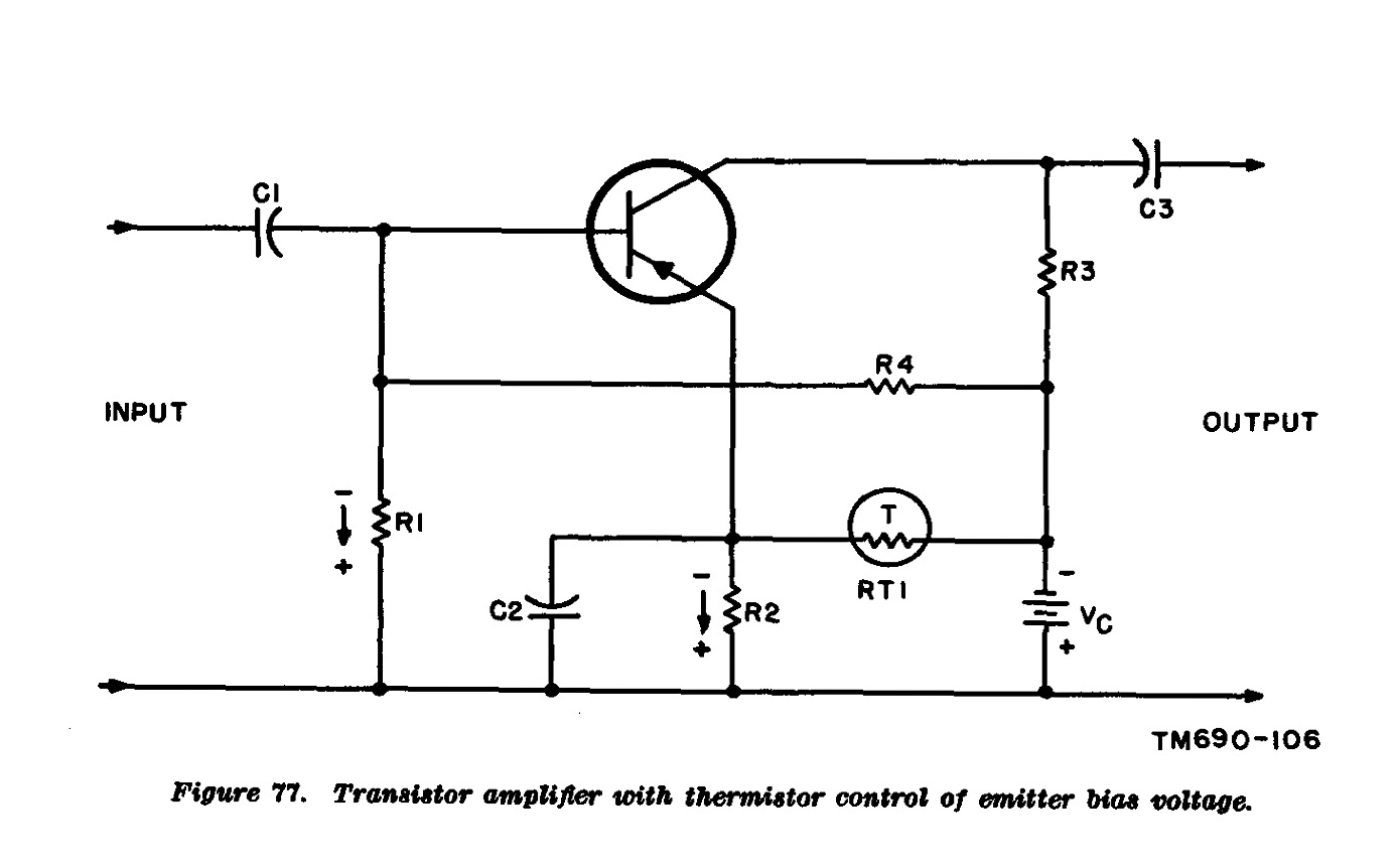

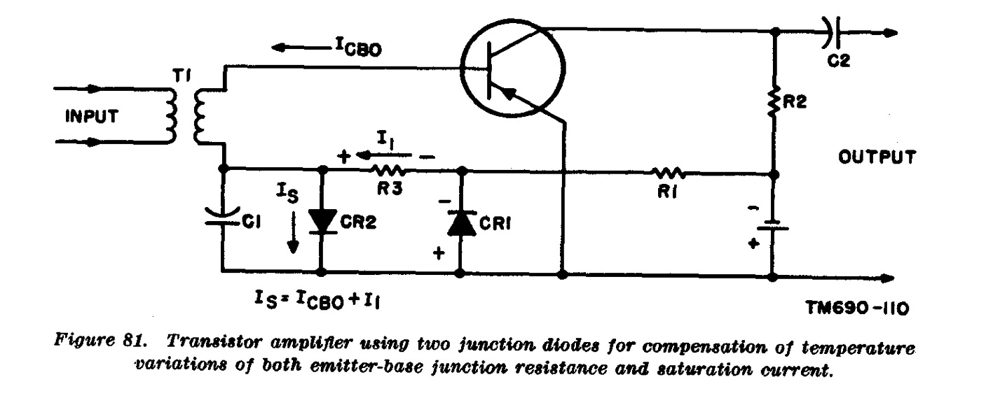

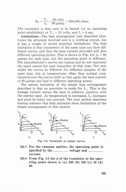

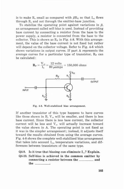

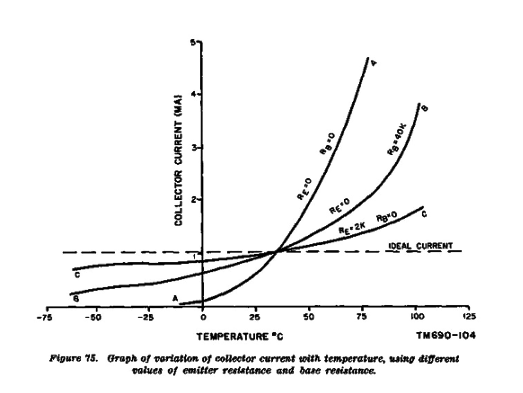

For class A with Ge transistors self bias is an interesting option
Pike_-_Transisotr_Fundamentals_1968_2 : Free Download, Borrow, and Streaming : Internet Archive
Haha we read the same book 🙂Is that an answer? "COMPARED" seems to ask for more than one number.
Anyway, I happened on this book from the end of the Ge era..

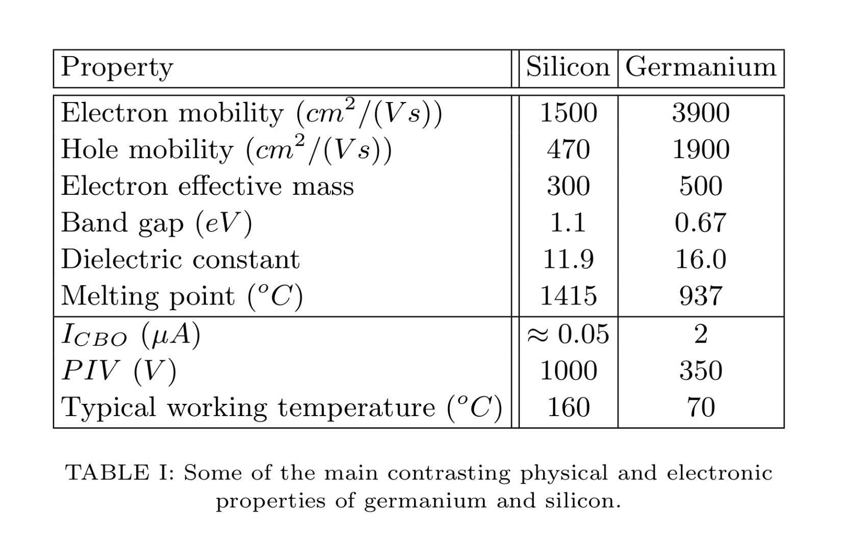

I have real doubt those numbers are typical. But lets roll with them.
> ...germanium power devices ...seem to be low power rated compared to similar size silicon...
Typical working temperature: Si=160 Ge=70
Typical working temperature RISE above 25C: Si=135 Ge=45
135/45 = 3
For the same size mounting face, the Si device can dissipate 3X the power of a Ge device before 'melting'.
As alexberg says, often the limit is how much reverse bias you can apply and control.

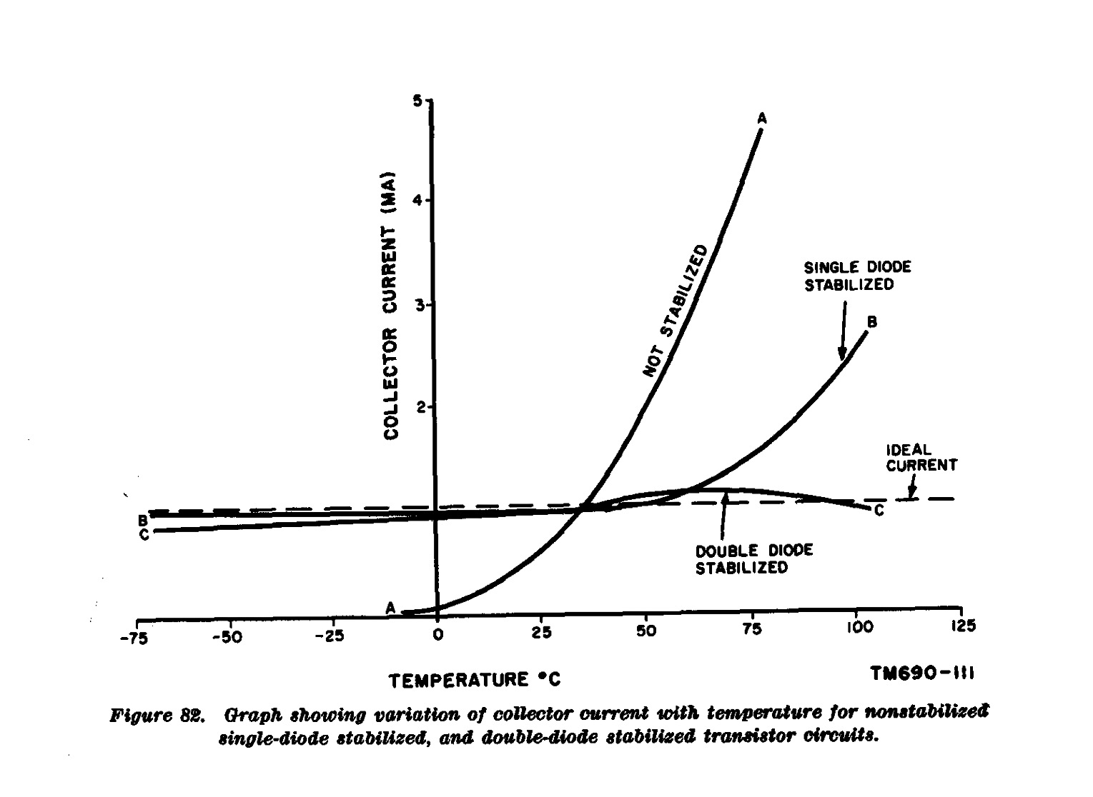

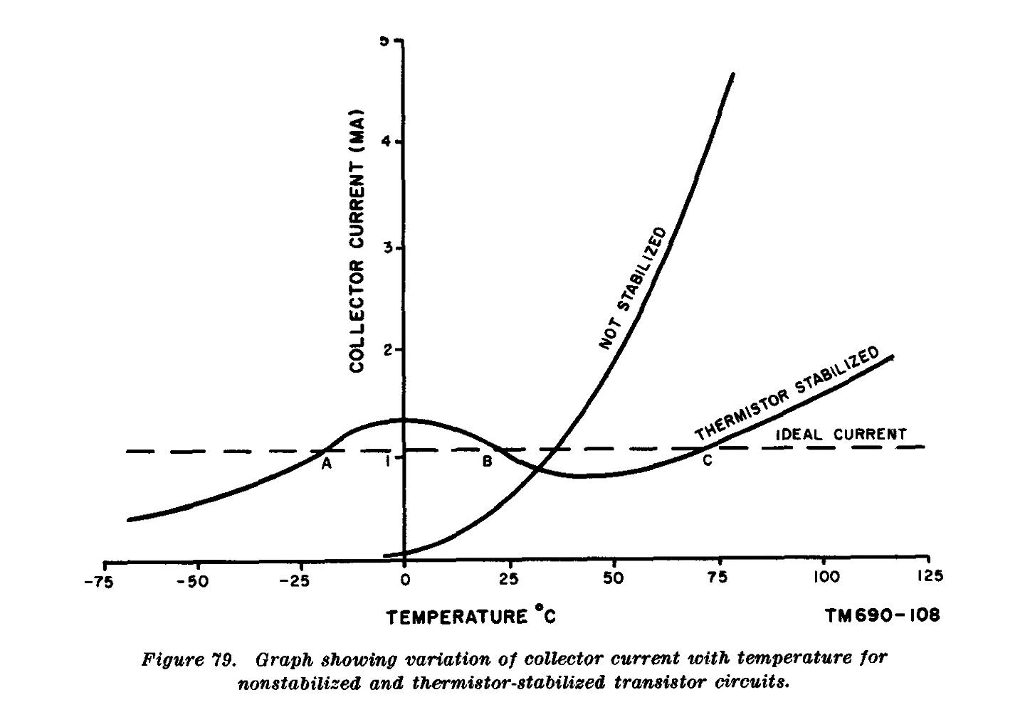

Germanium curves examples , circuits to compare from the 50´s early transistors book.
Transistor Audio Amplifiers : Richard F. Shea : Free Download, Borrow, and Streaming : Internet Archive
Started investigating the 2SB206. At Vce =-2V, leakage is ~1.8 mA.
At Ic = ~1.2A, gain ~220. Curves soon.

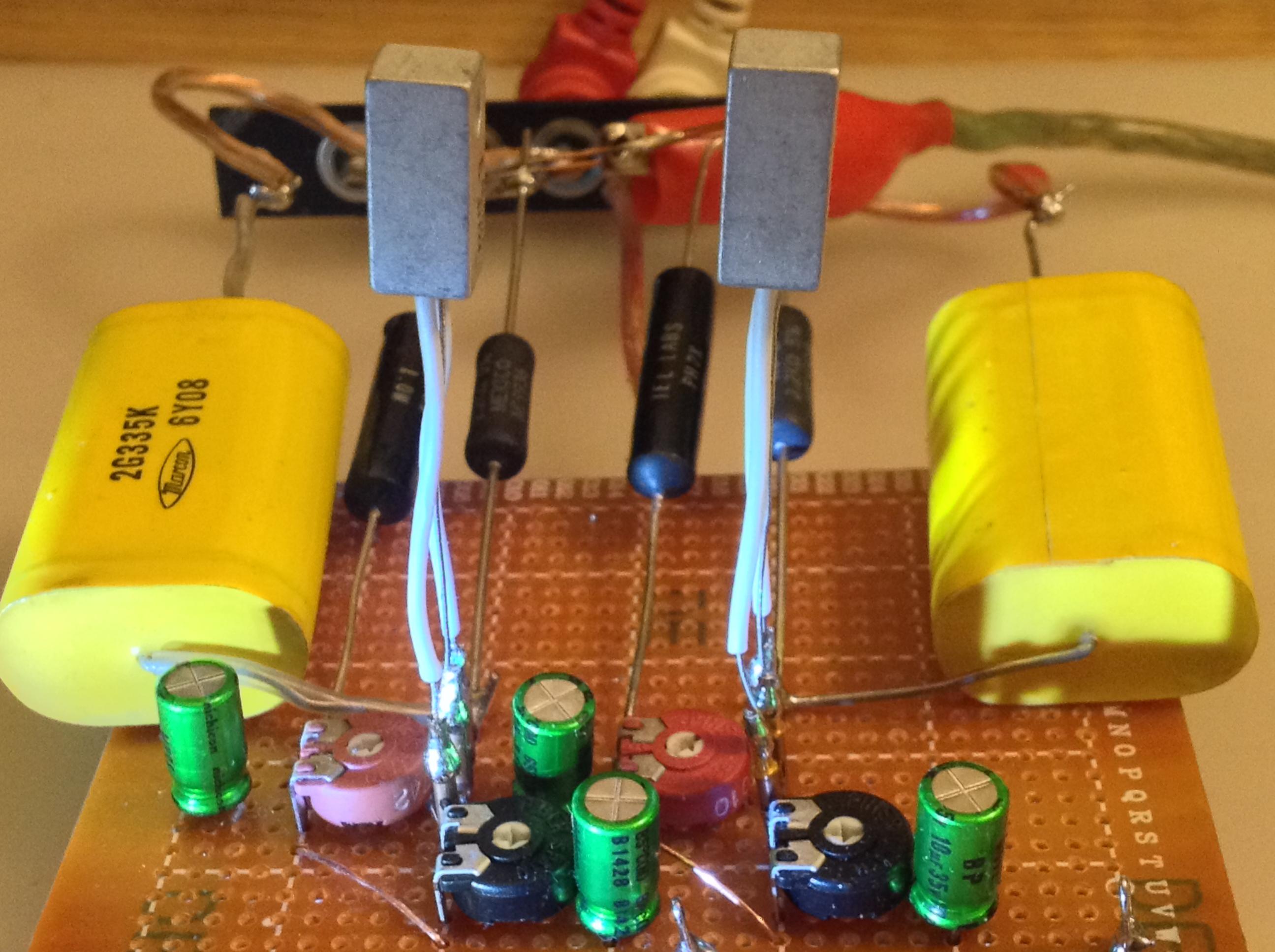

Last weeks I wanted to put some Ge into audio.
There is point to point quick build on perfboard
line stage with AC187K germanium. PSU is 15V SMPS brick.
