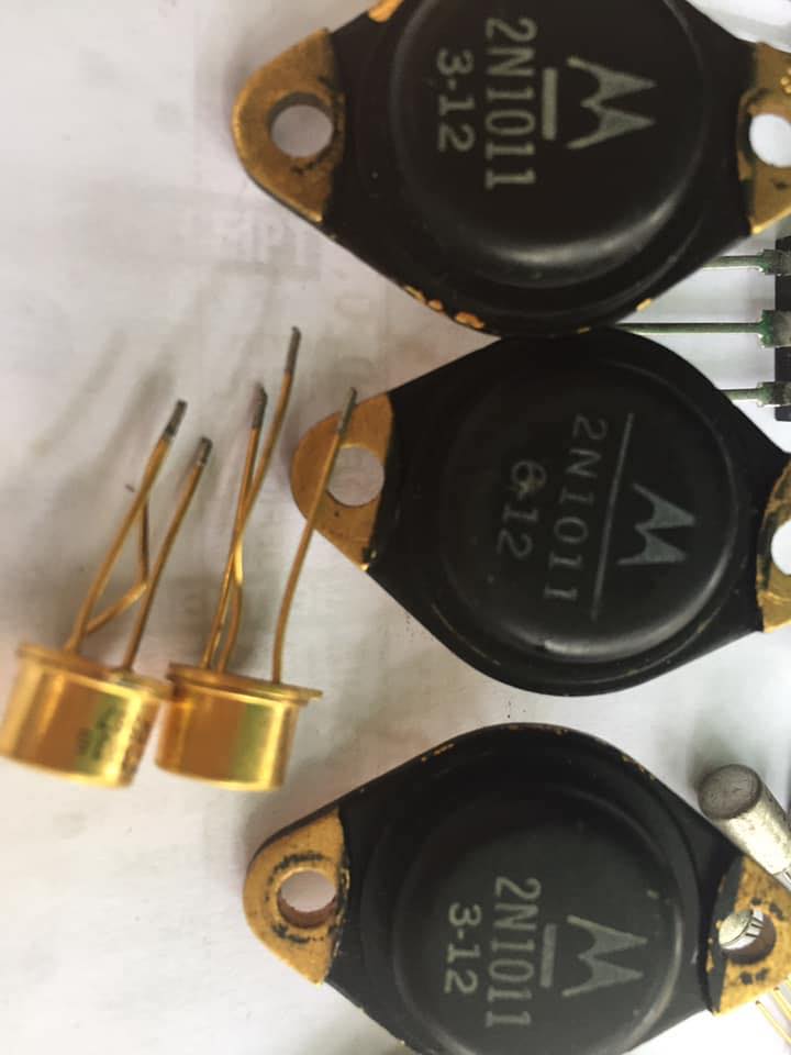

Its so happened that i have those Big TO-3 2SB216(SHINDENGEN) (100v/30a.80w) germaniums and some Motorola 2n511a, 2n1011, 2n1540, 2n1546 2n2567, Ad161,Ac128 and Japanese 2SB410,2sa221,2sa329 and RCA SK3035 and SYLVANIA ECG176.

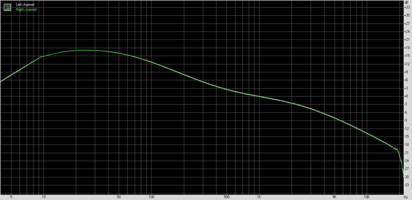

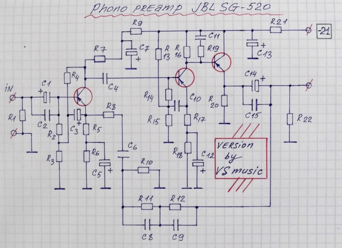

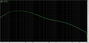

Hello. The new germanium phono is based on the JBL SG-520 scheme ( 1964). I had to make some changes to the circuit - because I used other transistors . I couldn't get the original 2n508 transistors . Used GT-308V (T1), P-416B ( T2) and MP-16B ( T3) ( all transistors USSR ) ..... I took measurements using RMAA . The signal level when measured - the output of the corrector was 2 volts from peak to peak (gain about 40 dB /1kHz). Noise - minus 73 dB ( weighted), and minus 69 dB (unweighted ) . Harmonics - 0.05 %, but this measurement is controversial-the Board was not installed in the case and just lay on the table . And the measurement was made through the built-in laptop card
The sound of this phono is very good . I liked. Voluminous , very balanced . This is a good scheme . I powered it from a 24-volt power supply (the original circuit was powered by 21 volts). When checking, I used Empire cartridges .
Changes I made to the original circuit-increased the value of the resistor in the bias circuit of the transistor T2 ( applied 68 K instead of 43 K). And increased the gain of the feedback circuit ( used 68 ohms instead of 160 ohms). The original JBL circuit had a gain of about 32 dB . I changed that .

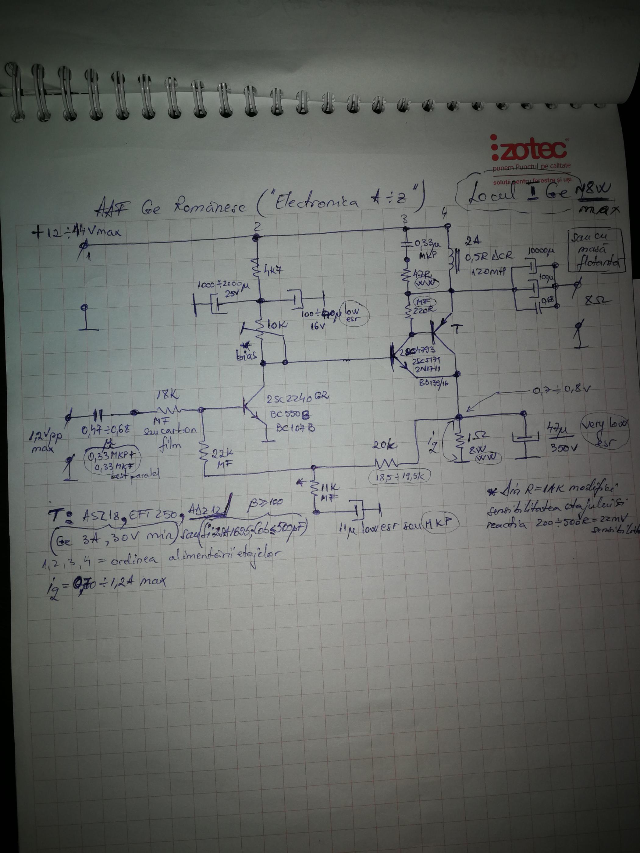

Lets brake the ice

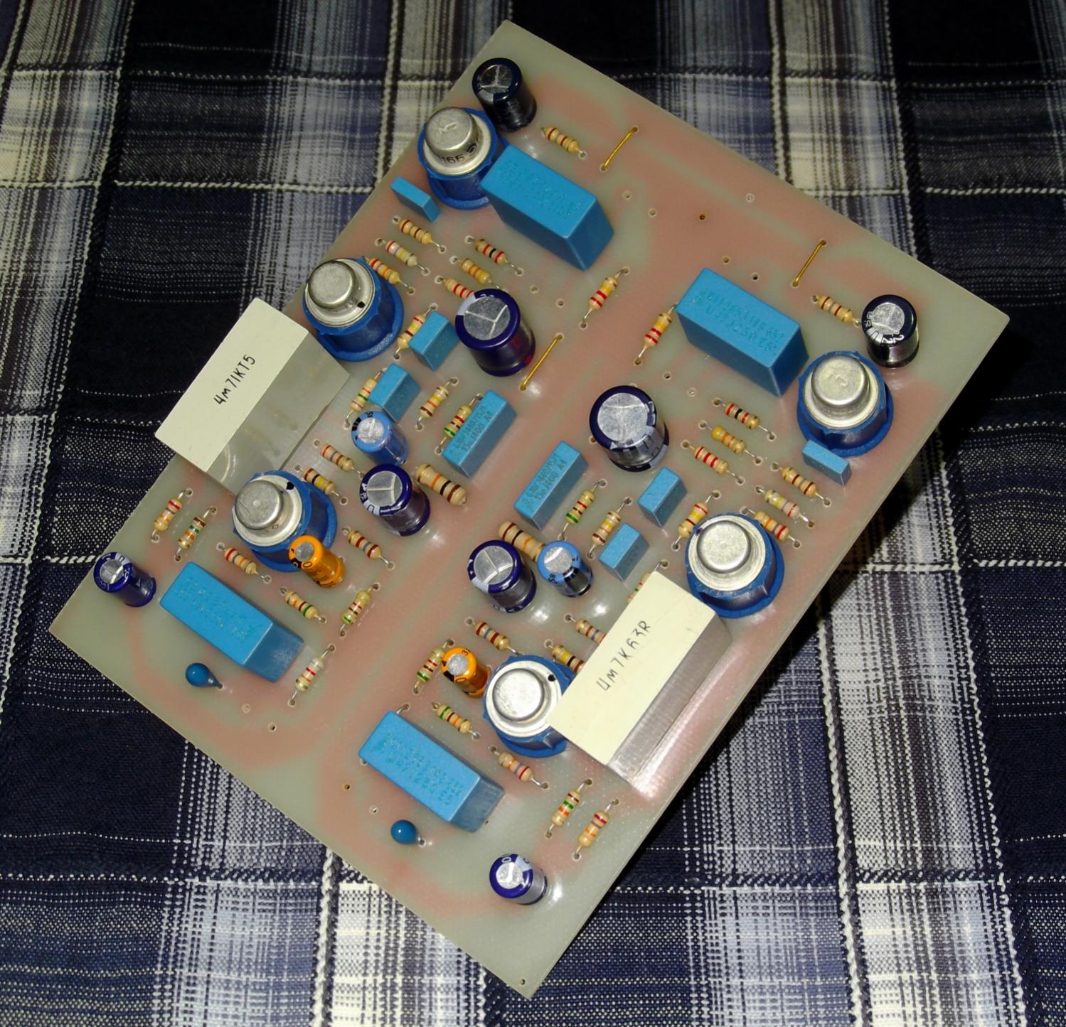

From my personall collection:a very musicall amp. It outputs 2-3w in 8ohms and almost 4w in 4ohms at 2-3% dist. It needs 1v max input. It works from the start. It had an output transformer in the originall schm but i modified the nfb to suport a choke for convenience. I used a shielded 10A@12v smps but would sound very very nice from a clasic CLC or 10000uf+10uF in parallel with a 65A car battery (best).
Lowering the 11k to 200-500ohms gives you an input sensitivity of about 50-100mV and the lowest NFB feedback possible. Basically you can use it directly from the phono pre.
