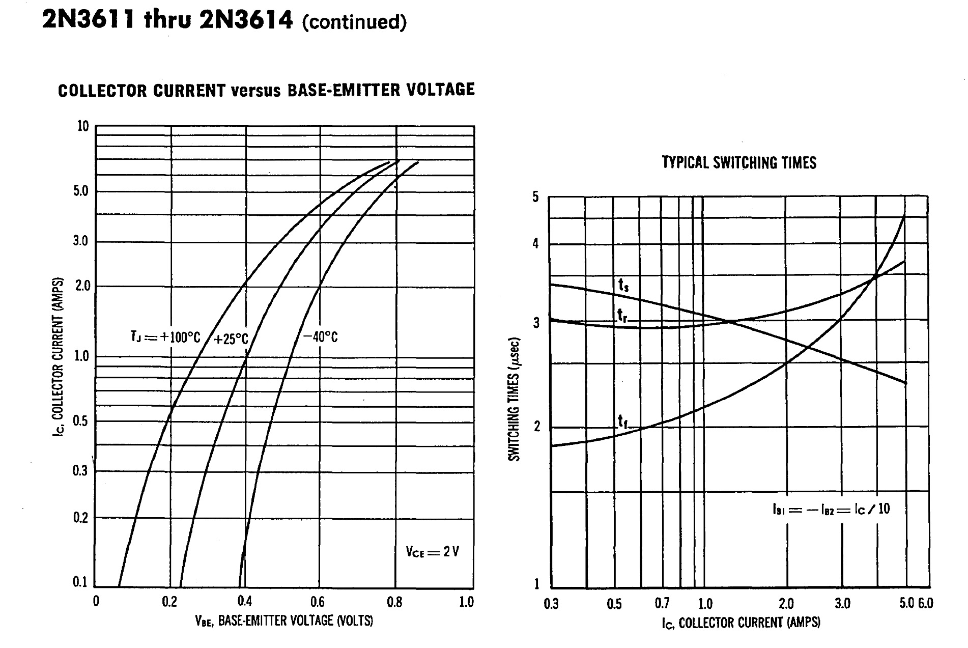

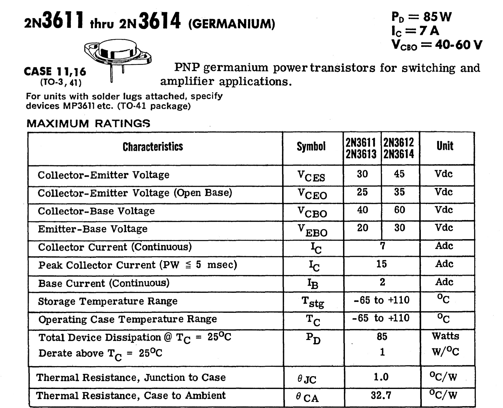

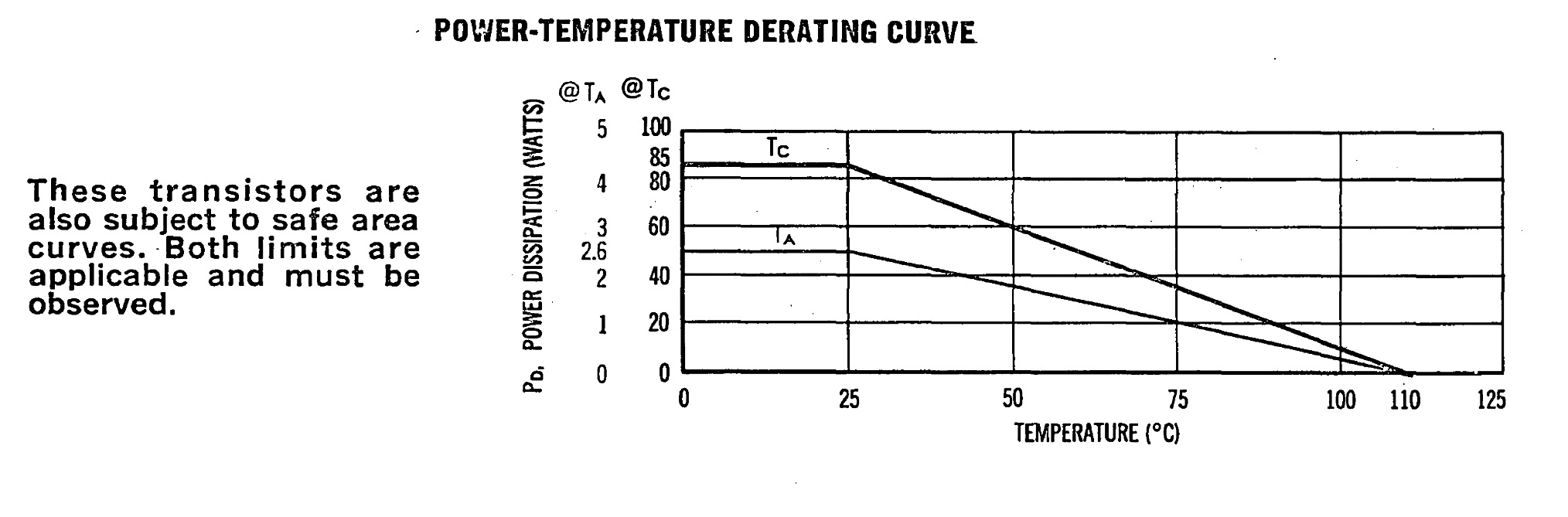

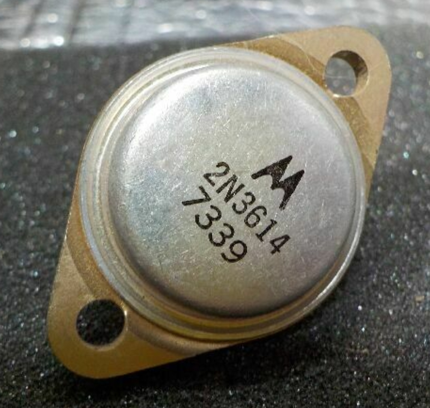

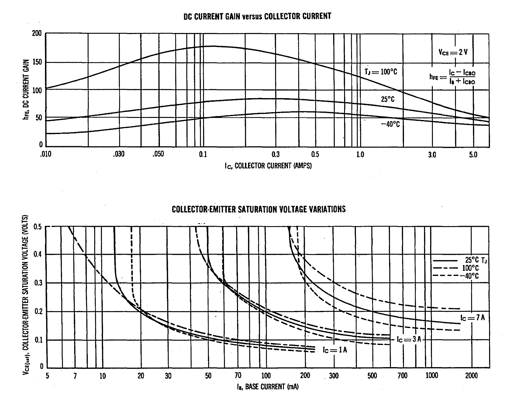

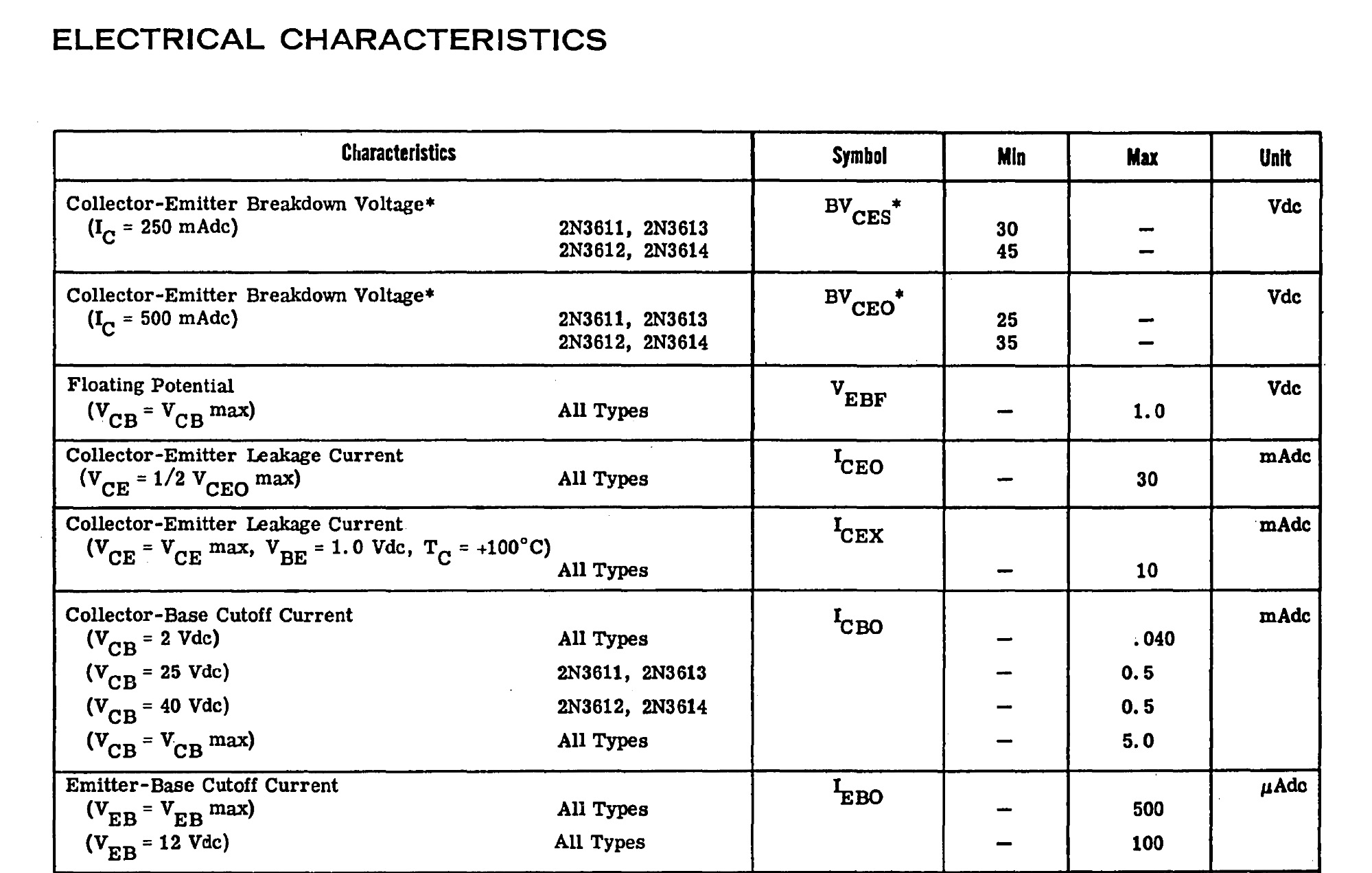

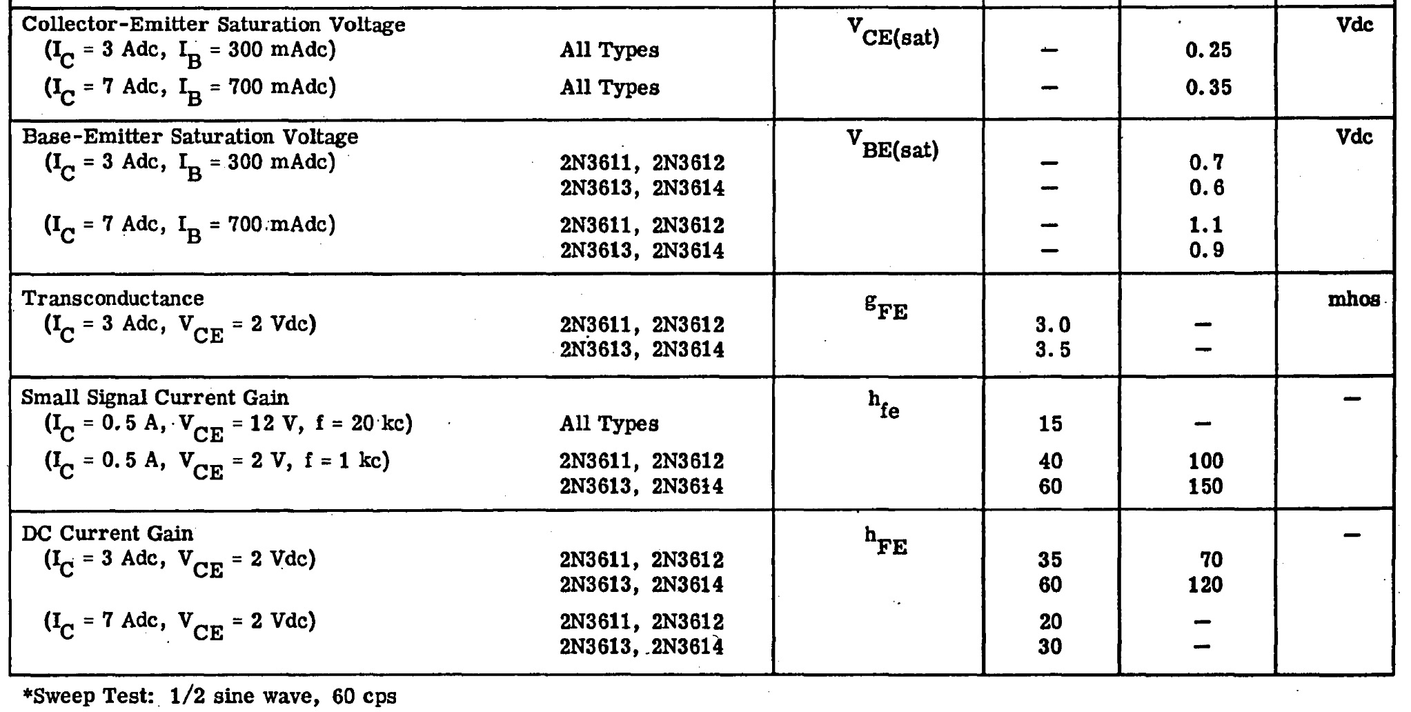

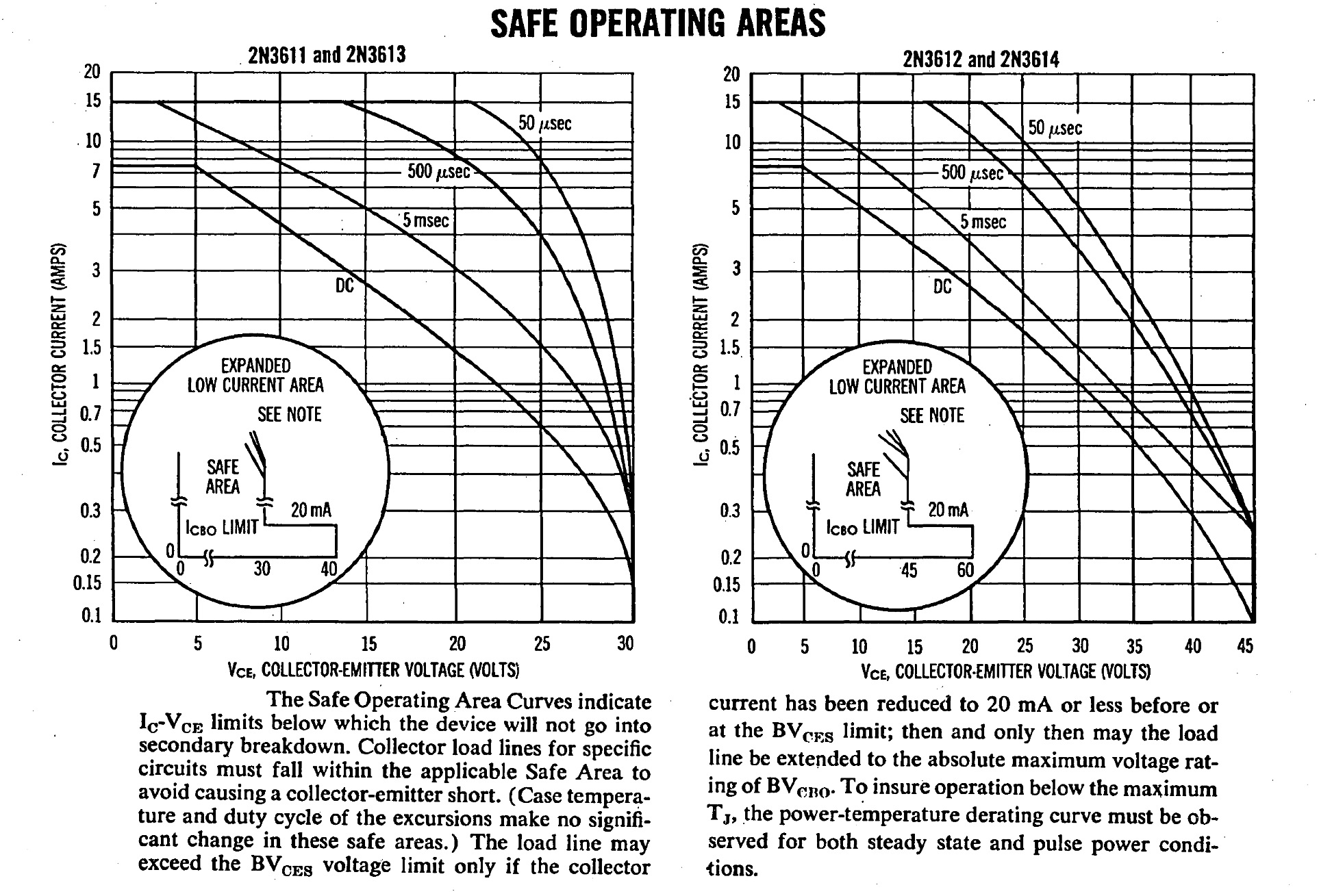

I was cleaning my used stuff drawer, with boxes of old used transistors, and once i sorted stuff out, i found four output transistors, 2N3614. They measure as good.
Any idea what these are good for? I searched, but did not find much.
Data sheet for expertise
1 Piece Motorola 2N3614 TRANSISTOR (R5S8.5) | eBay
