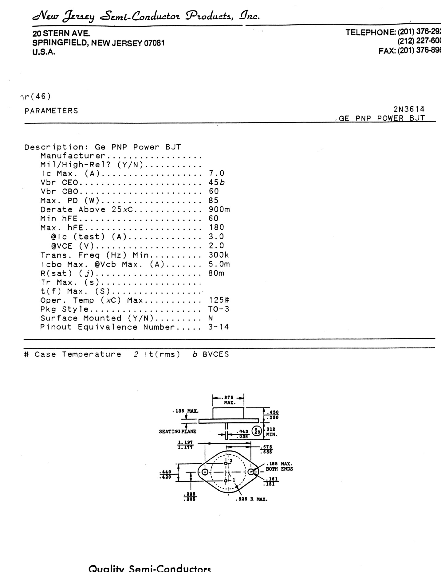

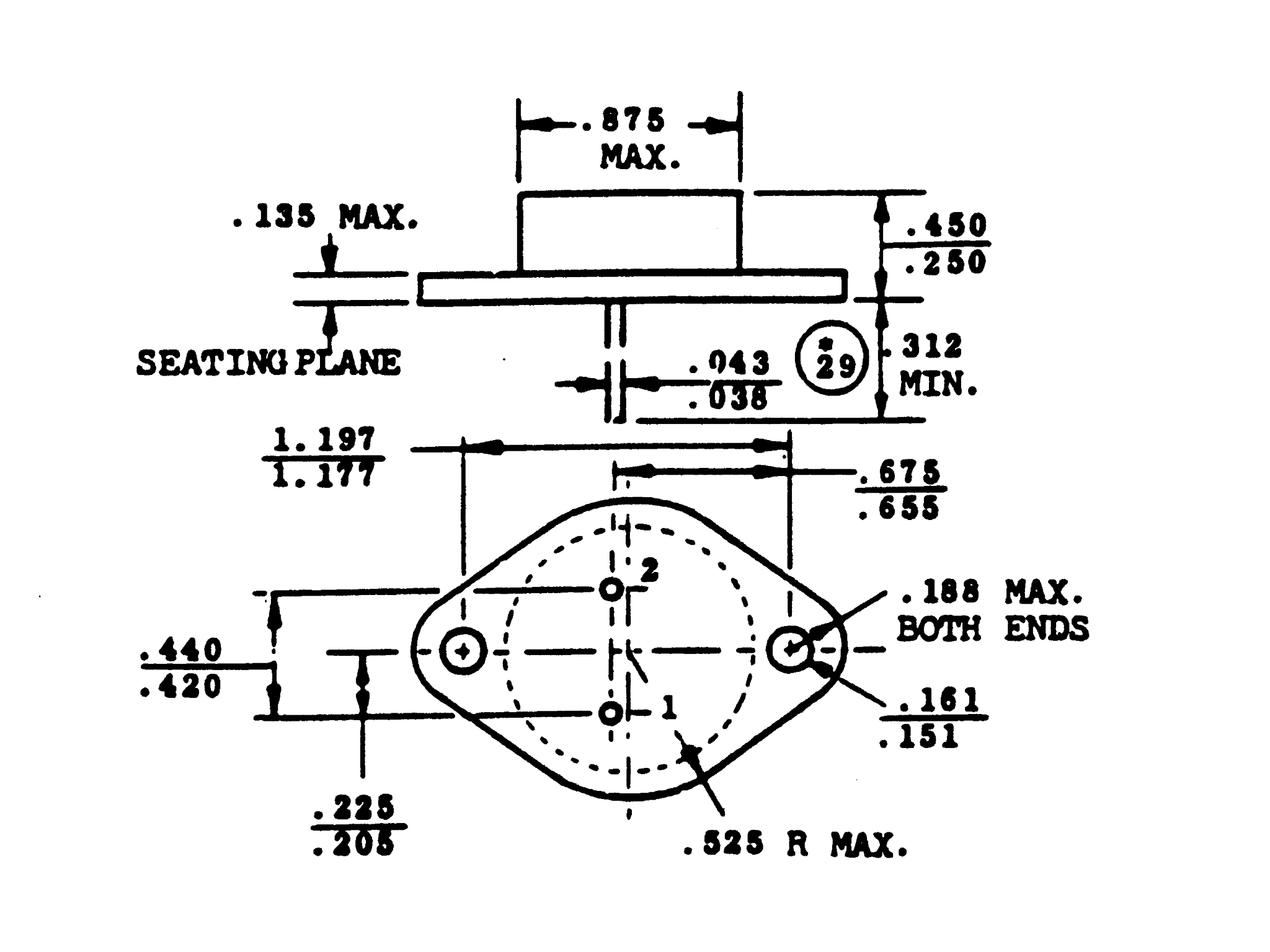

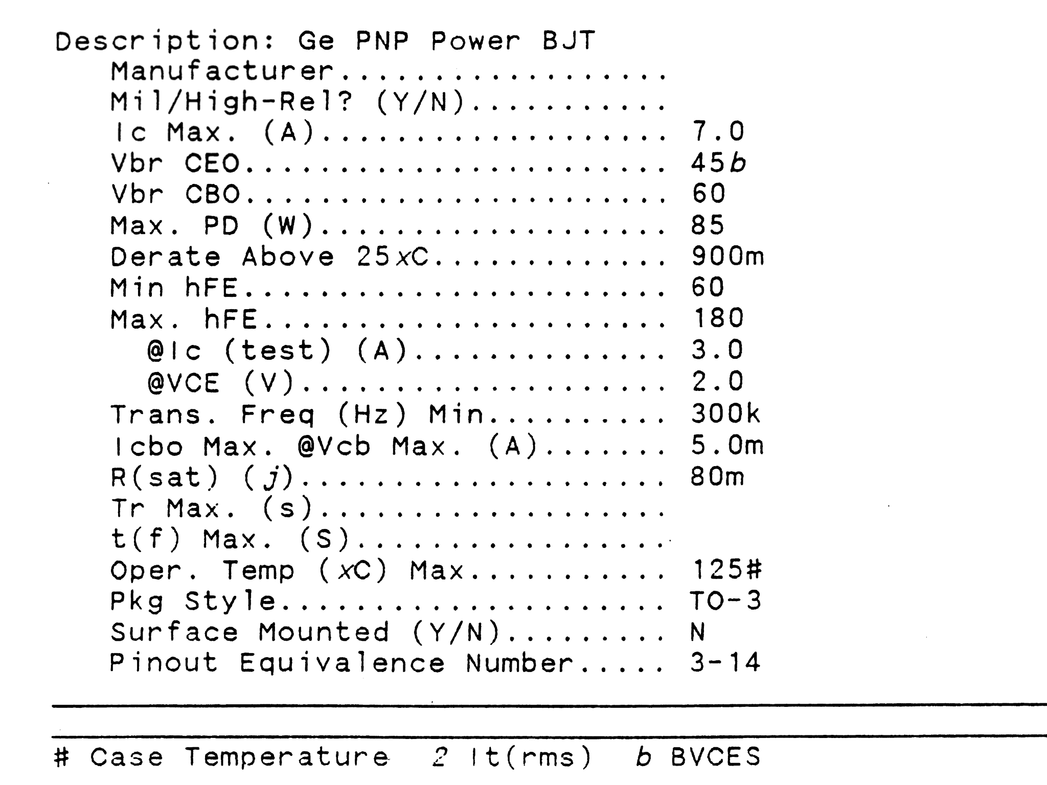

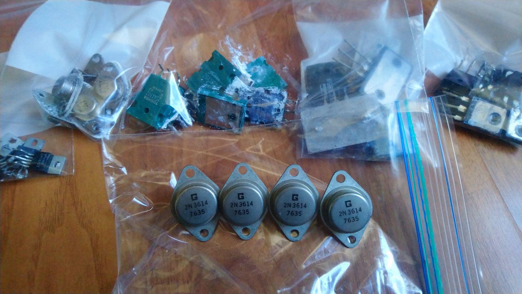

..i found four output transistors, 2N3614. They measure as good.
Any idea what these are good for?
Maybe we request expertise of Mr. Pass ?
2N3614 data sheet this time is complete with SOA etc. Germanium investigations

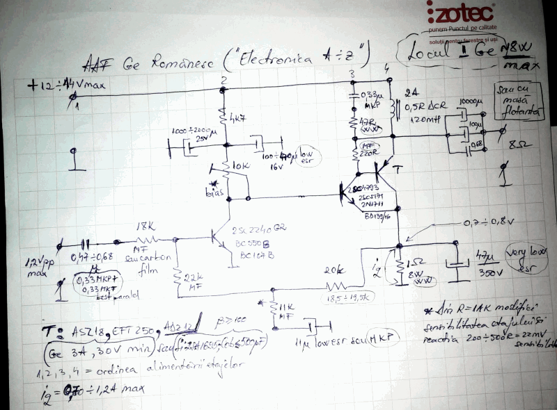

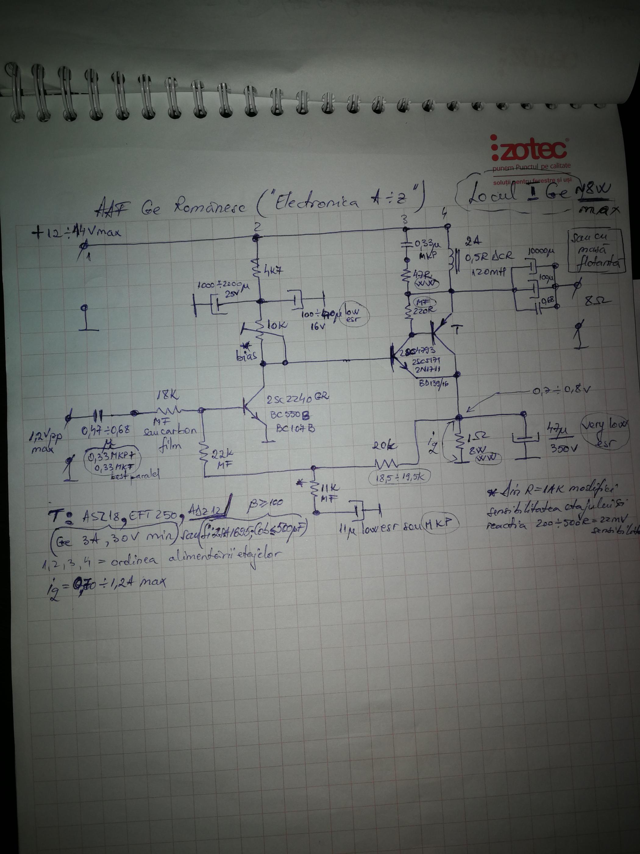

the picture
Hello, the picture is not clear, can you send me high-resolution pictures?
From my personall collection:a very musicall amp. It outputs 2-3w in 8ohms and almost 4w in 4ohms at 2-3% dist. It needs 1v max input. It works from the start. It had an output transformer in the originall schm but i modified the nfb to suport a choke for convenience. I used a shielded 10A@12v smps but would sound very very nice from a clasic CLC or 10000uf+10uF in parallel with a 65A car battery (best).

I have attached the pic again. To me is very clear. Try to download it and see it again. If not send a pm with your email to me to send it to you via email.
