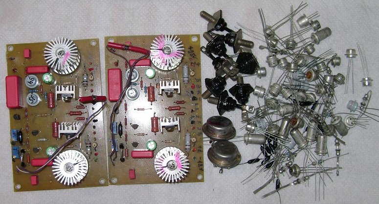

You can order the production of PCB yourself:
Сirklotron with germanium transistors Darlington output. - Share Project - PCBWay
Circlotron with germanium transistors Shiklai output.. - Share Project - PCBWay

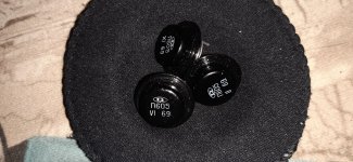

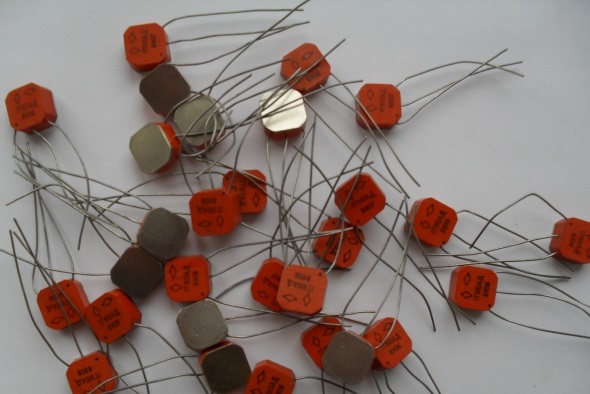

P605 - Transistors from the USSR
1969 🙂
45v / 0.5a (1.5) / 10mhz / 3w - Burned like matches.
There were DIY quasi-complementary amplifiers (Lin) 6W / 8Ω.
The main application is mainframes (When computers occupied a large hall).
1969 🙂

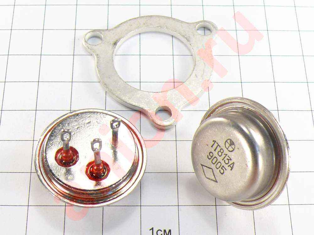

The most powerful germanium transistors in the USSR are 1T813B.
30A, 80 V, 50 W.

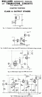

Of course it does. When even a Cadillac could only afford one transistor, they used it class A with a huge heatsink. Used far less battery/generator power than a couple of tubes plus the high voltage vibrator. I don't see my GE or RCA manuals just now, but here's Mullard 1960. 2 or 3 Watts out.
The 14V supply connections look odd because wired positive ground.

I can't even imagine how you can burn P605.
They are made on very reliable "conversion technology".
By the way, there is P605A, with more amplification.

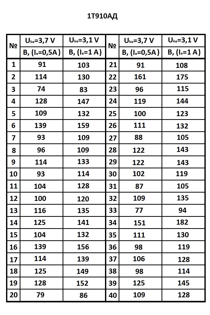

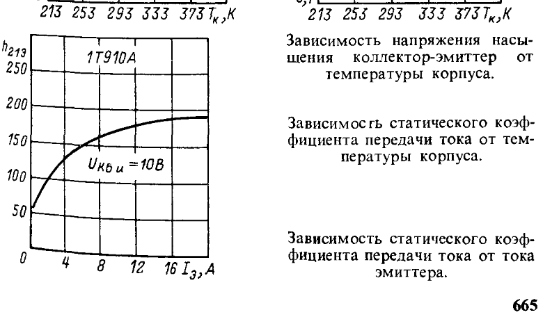

In SE you can try 1T910AD.
Current 10 A, pulse - 20 A, voltage 32 V, collector power 35 W. Current gain in the range of 50-350. The gain increases monotonically to 20 A current (!!!) (second attachment). Frequency 30 MHz.
The third attachment is a pair selection table.
At two points: 0.5 and 1 A of emitter current.
