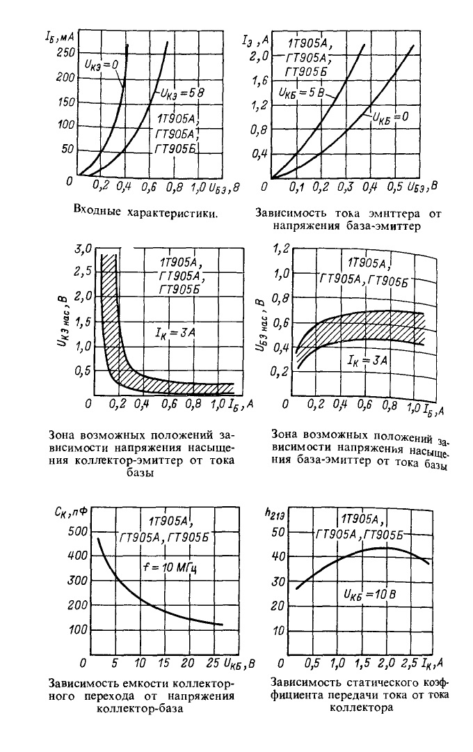

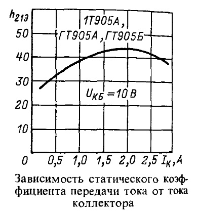

It is possible. This transistor seems to be the latest development of high-power germanium high-frequency in the world.
But it is limited in the collector-emitter voltage.
There is also GT905 (1T905), metal body, or plastic.
60 V, 3 A, 6 W, frequency up to 60 MHz.

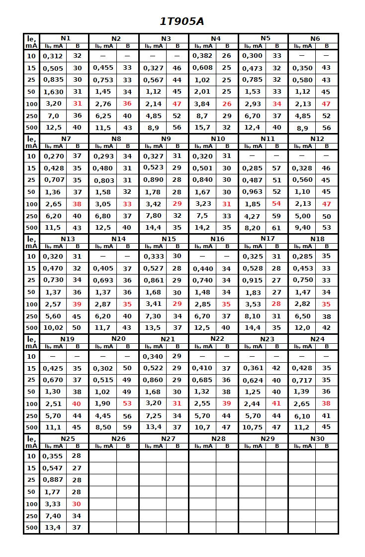

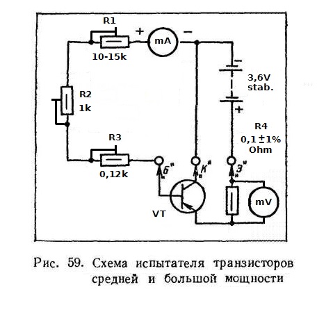

Attachments - measuring table, and diagram of the measuring stand.

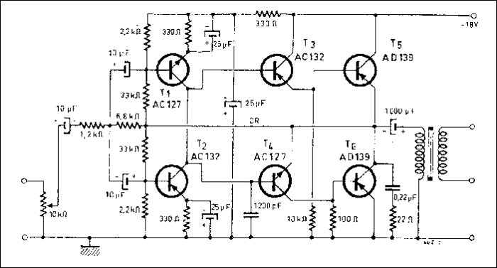

Complementary pairs ГT402, ГT404 fit well in the buffer to the output stage. But they need to be equipped with radiators. Circlotrons can use ГT321, ГT403, П605А, 1Т906.

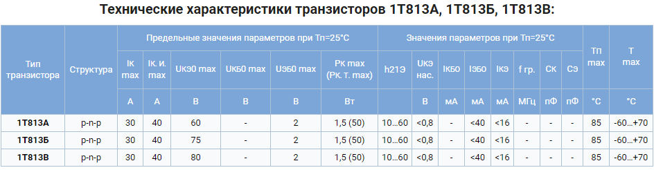

1Т813 differ only in voltage Uke. I have them.
Can You sketch sch please?
Preferablu +,- rails.
I need buffer to drive input transformer (phase splitter) i my amp. (Small primary winding Lp, need smal generator Req...)
And maybe some AC komplements to use? I dont have ГT402, ГT404
It seems like AC187 AC188 maybe? Also I have AD161/AD162?
