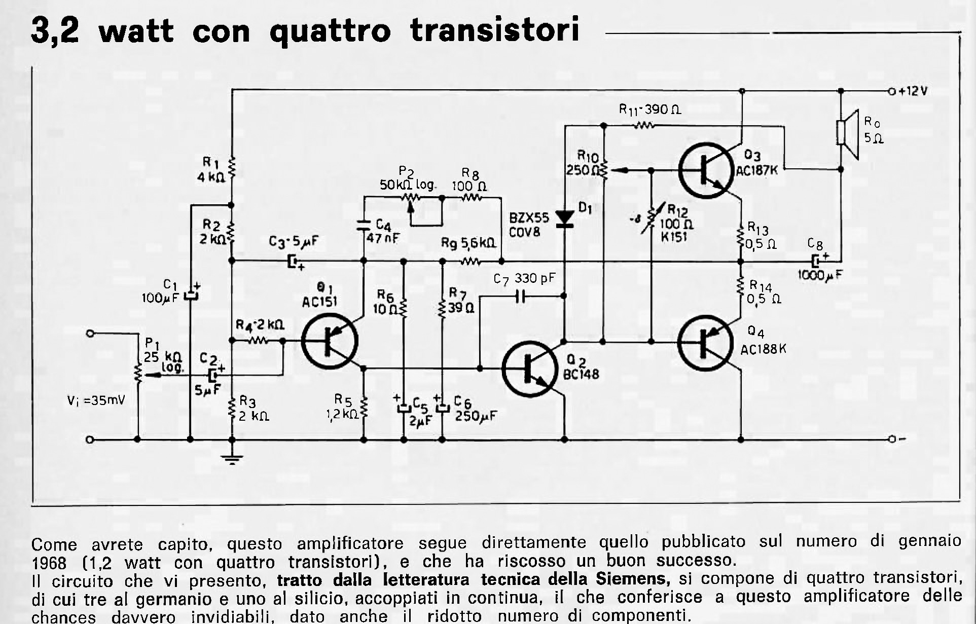

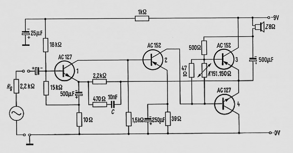

On the left first version by Siemens 1.2 watts 100 % pure Germanium flea amplifier.
La version 3,4 watts are interesting as well and can work with 12V car batterys :^)

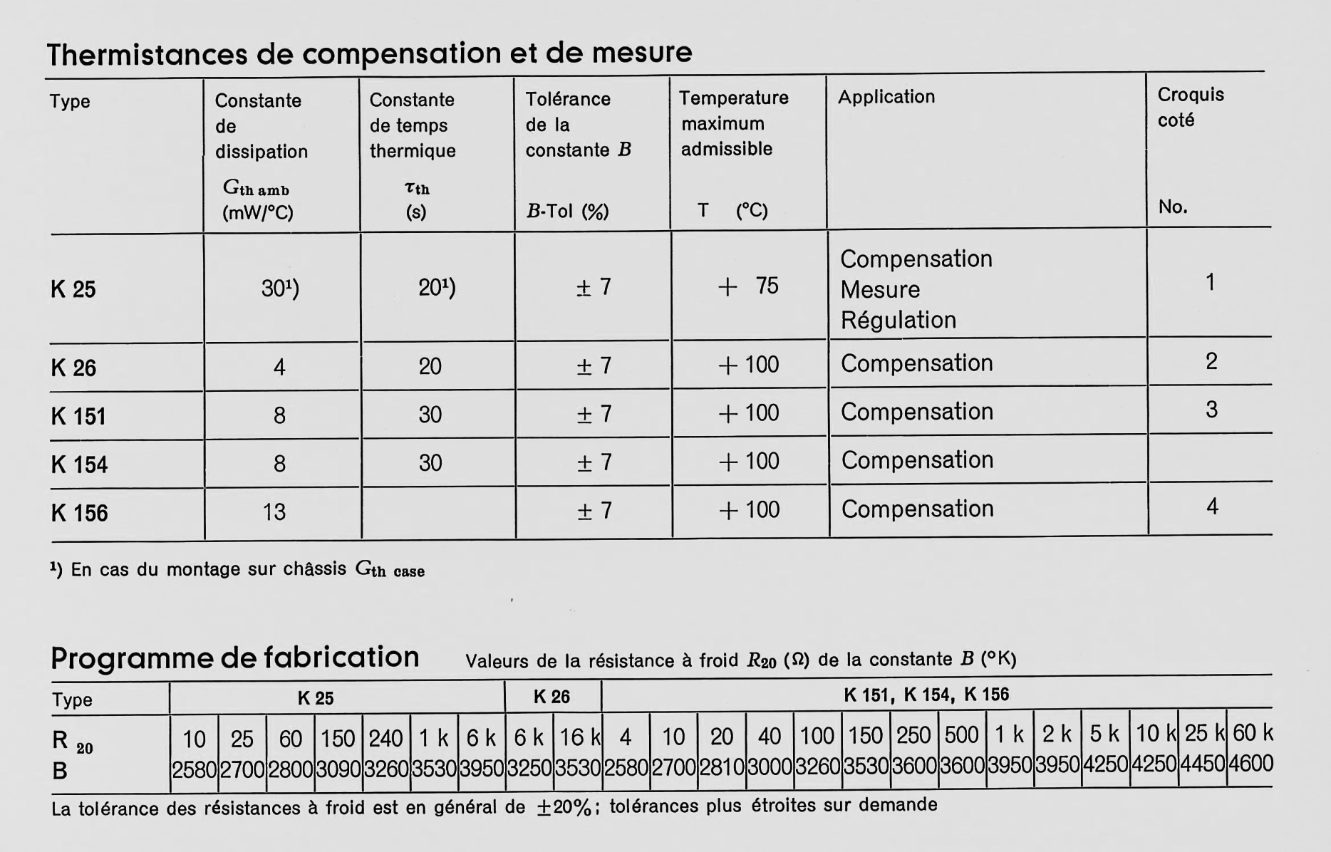

Edit : K151 component is a thermistor
( information source are from old Siemens catalogue in French language )

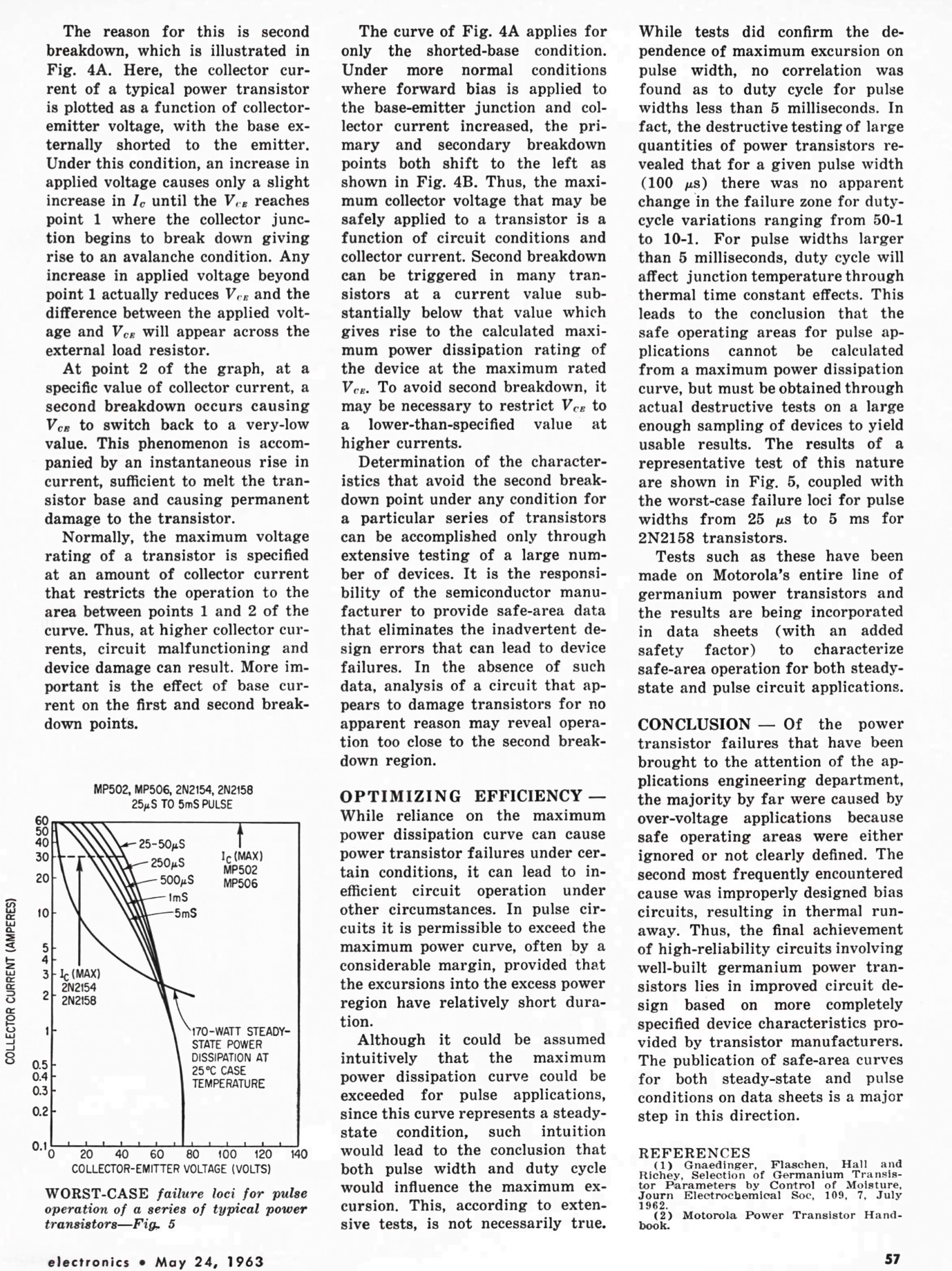

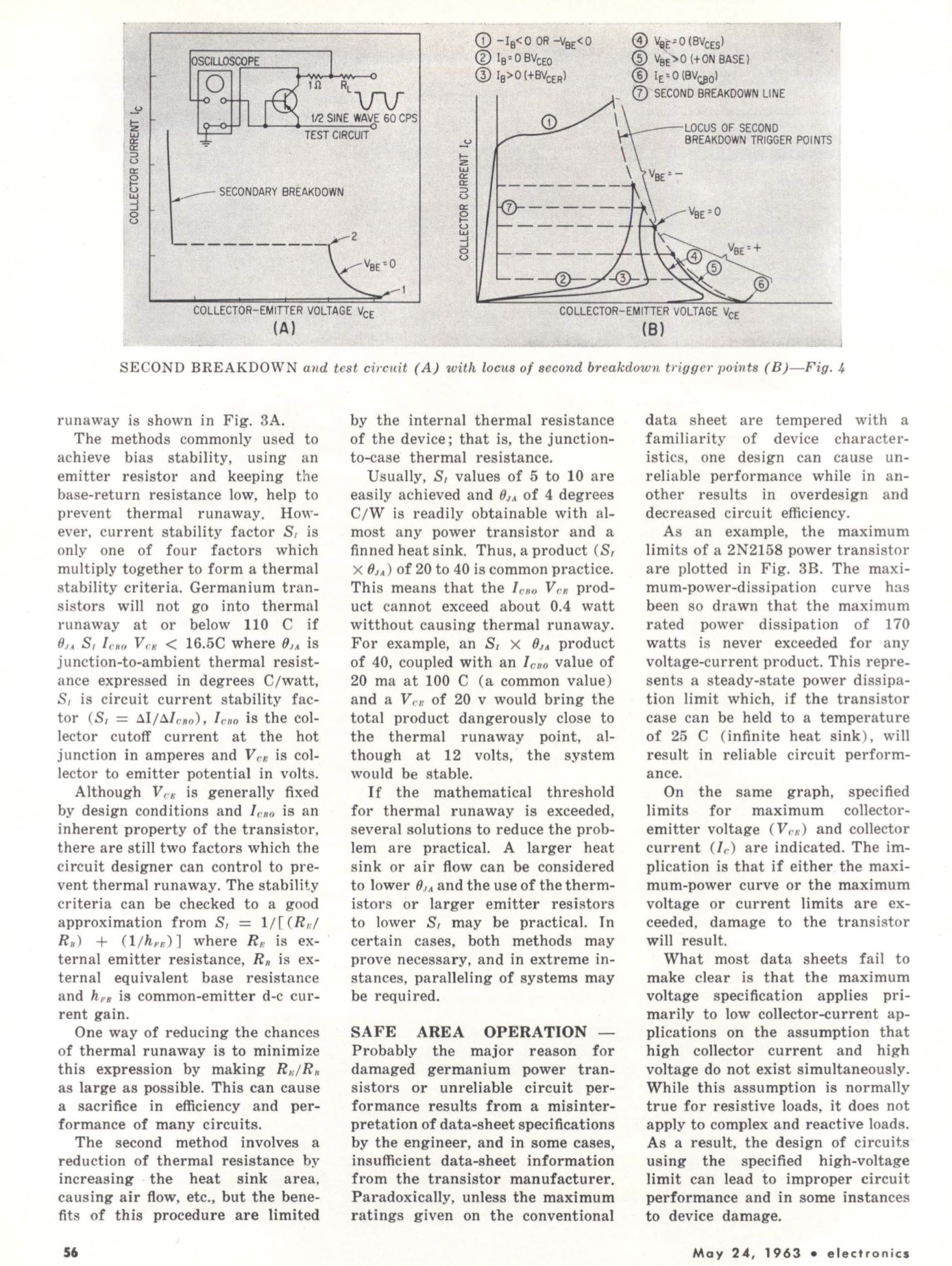

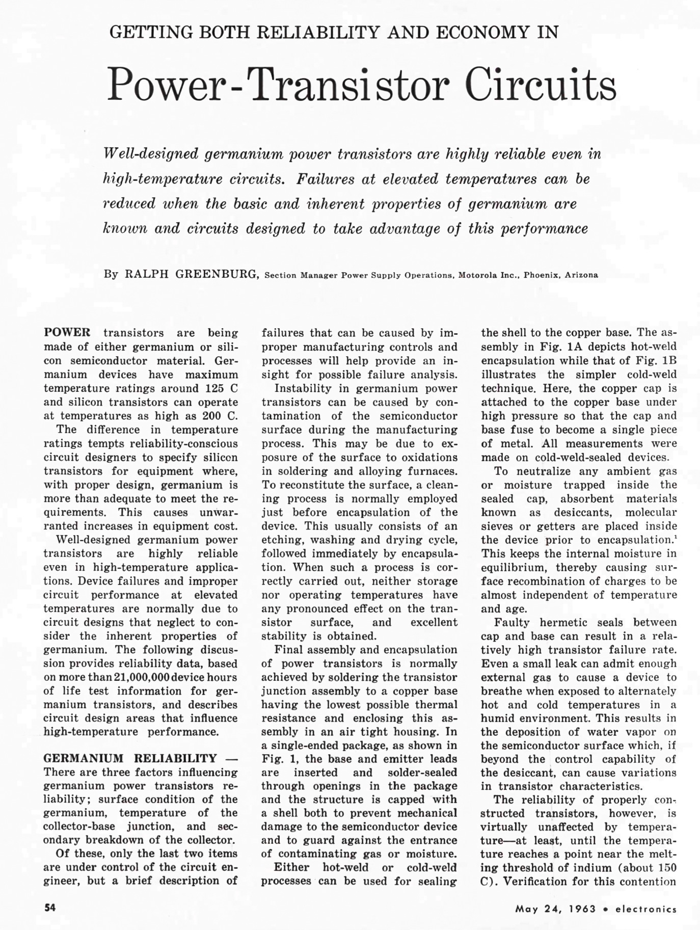

Pages of an article : Important parameters for reliable Ge circuits design.

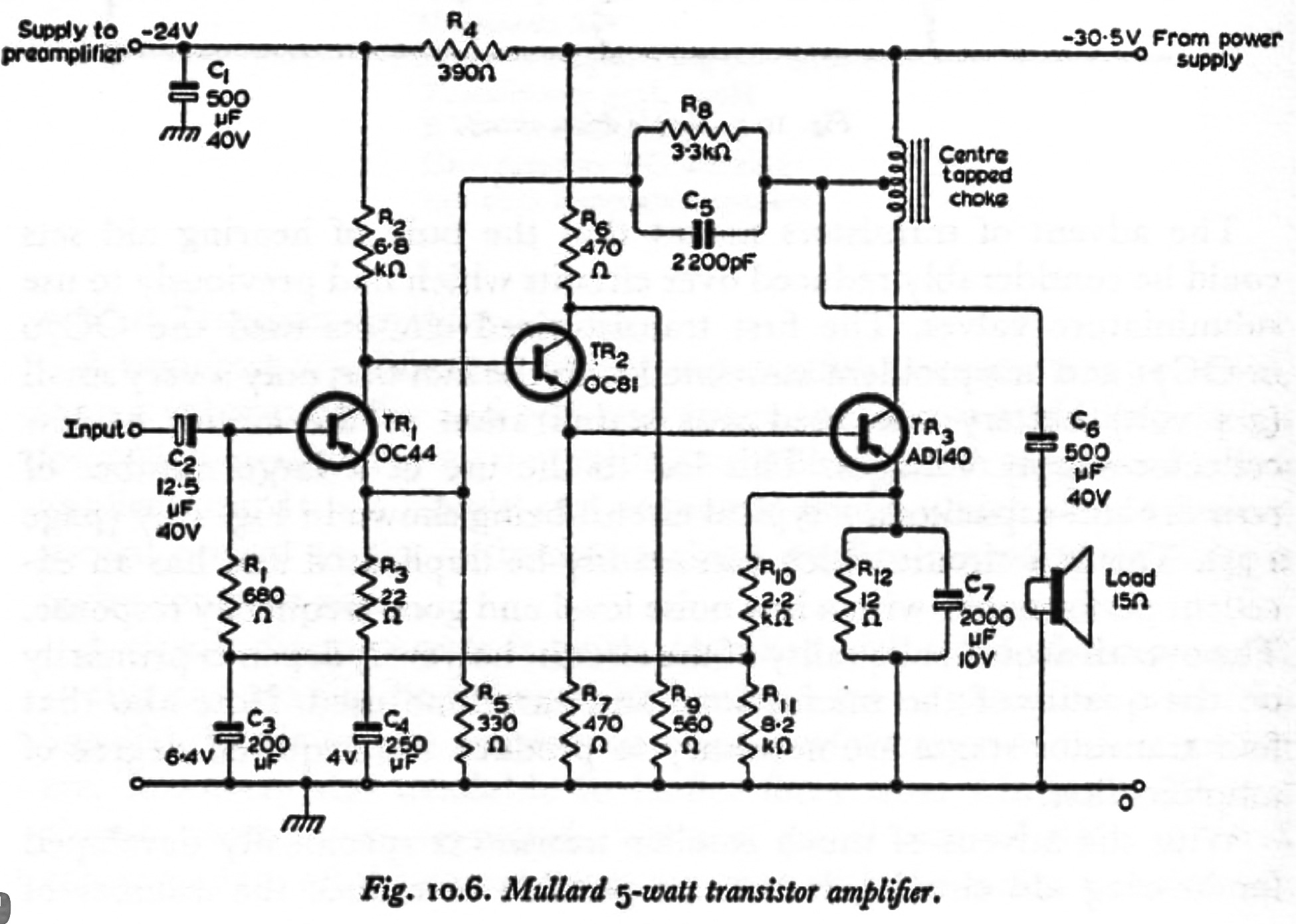

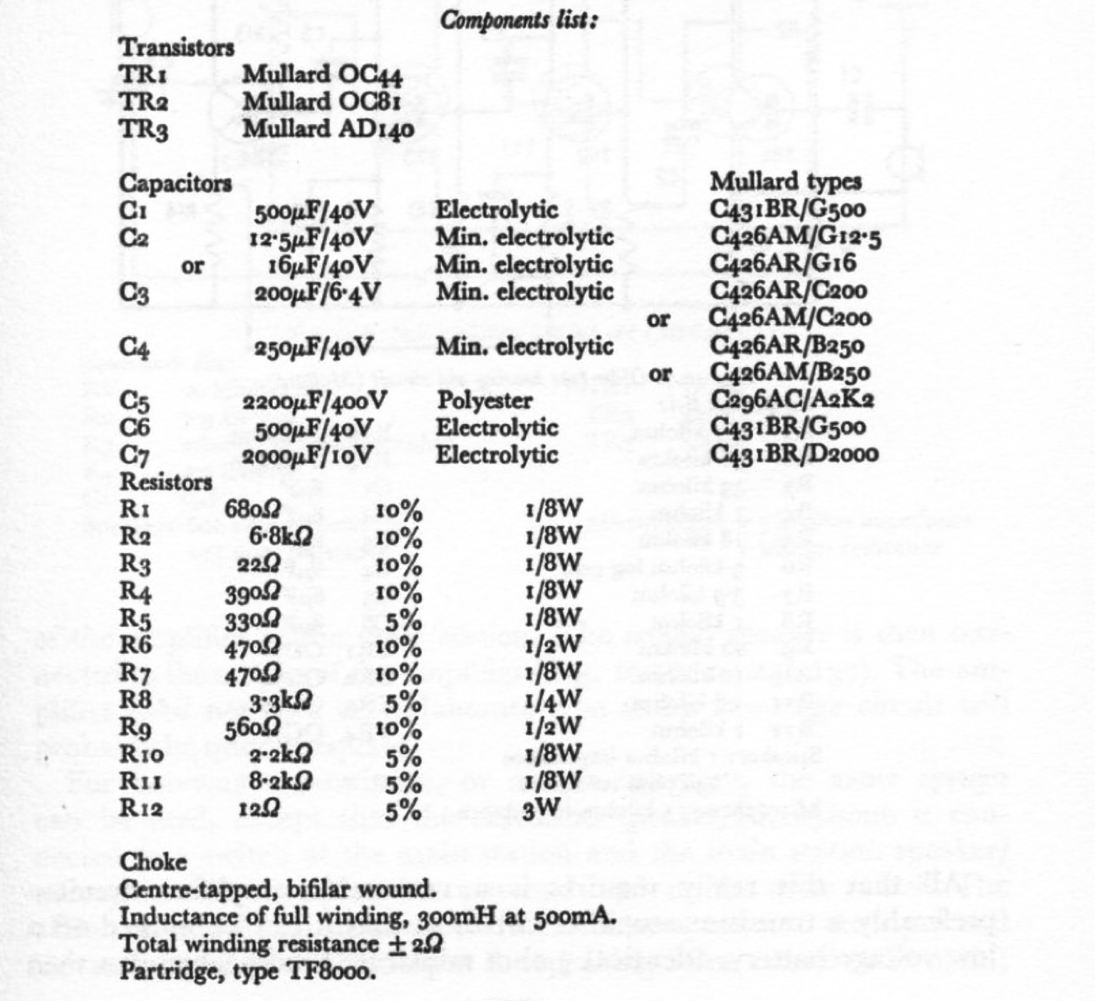

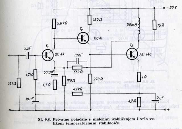

5 watts Müllard circuit with choke is minimalistic,
I guess can be loud together with 16 Ohms Altec or TAD compression driver & horns

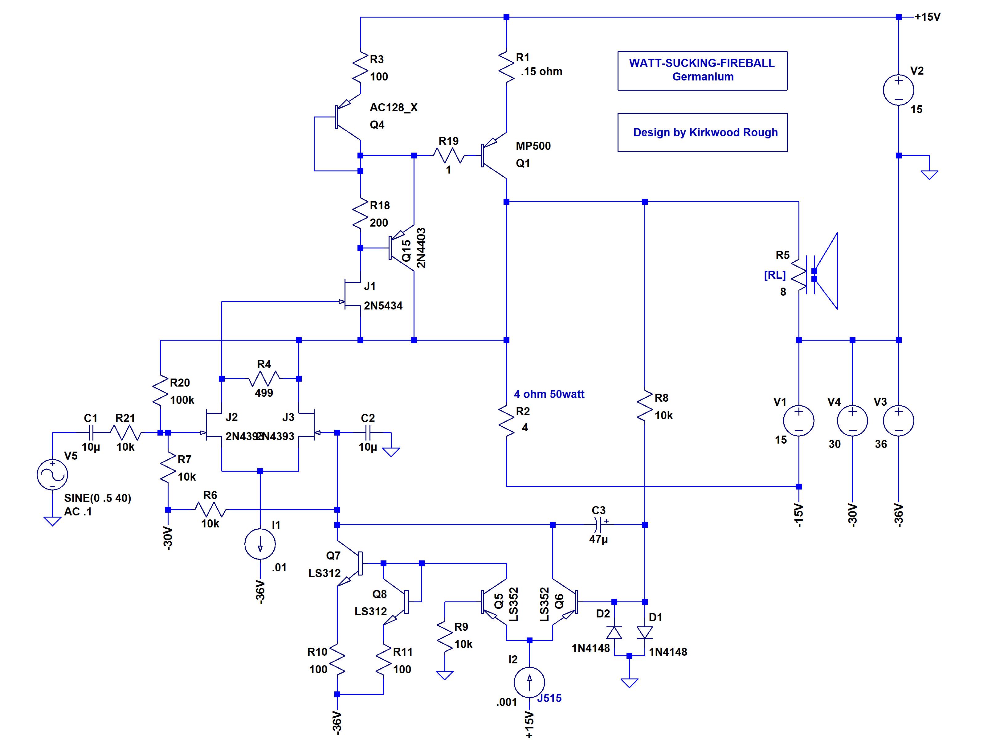

Very interesting design from one of my favorite ing-s Kirkwood Rough. Link from this site:
Watt Sucking Fireball Series
Seems like very powerfull Ge device?
https://pccomponents.com/datasheets/MOTO--MP500.pdf
