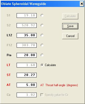

Hi Everyone,
Hornresp can now calculate the construction data for an axisymmetric oblate spheroidal waveguide having a non-zero throat entry angle. The following example and screenprint demonstrate how the method would be applied to obtain the necessary dimensions for a 2 inch diameter, 5 degree half-angle throat entry on an OS waveguide having a fully-formed length of 35 cm and an asymptotic mouth flare tangent angle of 20 degrees.
Procedure:
1. Open the Horn Segment Wizard for an oblate spheroidal waveguide design.
2. Click on the option button alongside the LT (Throat offset length) text box.
3. Enter L12 = 35 cm, Fta = 20 degrees, ST (Throat entry area) = 20.27 sq cm, AT (Throat half-angle) = 5 degrees.
(Note that moving the mouse pointer over the LT, ST or AT text boxes displays an explanatory description of the variable).
4. Click on the ‘Calculate’ button, and then click on the ‘Save’ button.
5. Display the Schematic Diagram.
6. Select the File > Export menu command.
7. Save the data to a *.csv file.
8. Open the file in Excel and manipulate the data in the ‘Length (cm)’ and ‘Radius (cm)’ columns or plot the axisymmetric waveguide profile as desired. Progressive flare tangent angle data is given in the ‘Angle (Deg)’ column.
Note that only the exported data refers to an oblate spheroidal waveguide having a 2 inch diameter, 5 degree half-angle throat entry. The schematic diagram and calculated response results still apply to a fully-formed oblate spheroidal waveguide with zero degree throat entry.
The example oblate spheroidal waveguide with a 2 inch diameter, 5 degree half-angle throat entry is effectively a fully-formed oblate spheroidal waveguide having a 19.10 sq cm area throat, but with the throat end truncated by 1.68 cm (the throat offset length LT as calculated by the Horn Segment Wizard).
Although I have tested the new functionality quite thoroughly, there is always the possibility that something may have slipped through. If you come across any bugs please let me know.
Kind regards,
David
