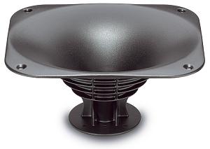

"Sounds" a bit like XT120/XT1086/XT1464 from 18sound ... anyone have heard any of these?
Magnatar has and has the pair of 120's for sale.He seems to prefer something else now, but I'm pretty sure they aren't bad..
That looks more like a 1086, which I was lusting after, but somewhere on some thread here there is a photo that shows a mold made from the interior of the 1086 and there seems to be a kink (diffractor
Lynn Olson bought a pair of 1464's to try with his 1.4" drivers. I suppose someday we will get an opinion from him..

Variac said:Magnatar has and has the pair of 120's for sale.He seems to prefer something else now, but I'm pretty sure they aren't bad..
That looks more like a 1086, which I was lusting after, but somewhere on some thread here there is a photo that shows a mold made from the interior of the 1086 and there seems to be a kink (diffractor) in one direction of it. Too bad as I really wanted it. If this is wrong and it is really OK someone please tell me. I THINK that the 120 doesn't have this, but is smaller so doesn't handle as low a frequency.
I bought a pair recently. The pictures are correct. There's a fairly sharp transition in the horizontal axis, the vertical is smoother. The overall shape transitions from a vertical oval at the throat to a horizontal oval at the mouth.
