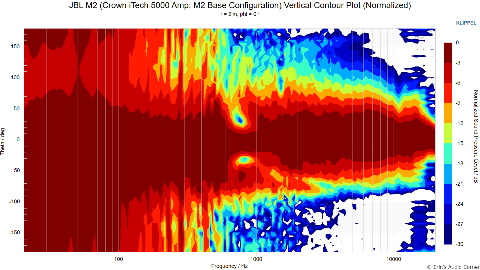

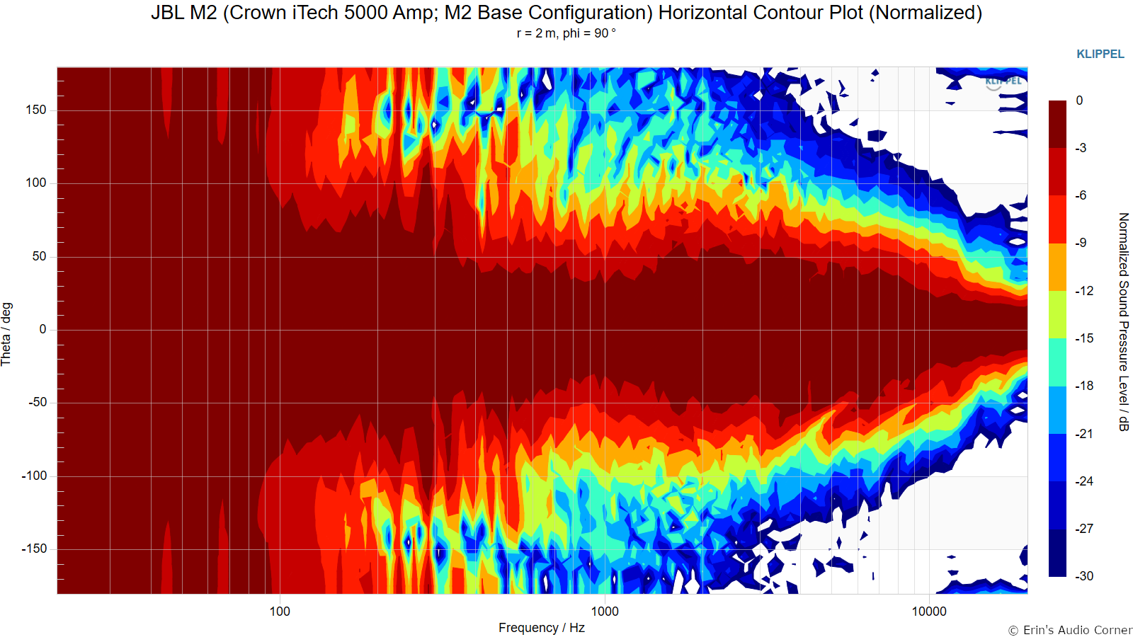

Both the JBL M2 and 2384 get's narrower in the highs. Especially horizontally. Vertically they do slightly better. Overall, M2 doesn't really have a particular uniform directivity. 2384 is better but I haven't seen an independent proper measurement of it.

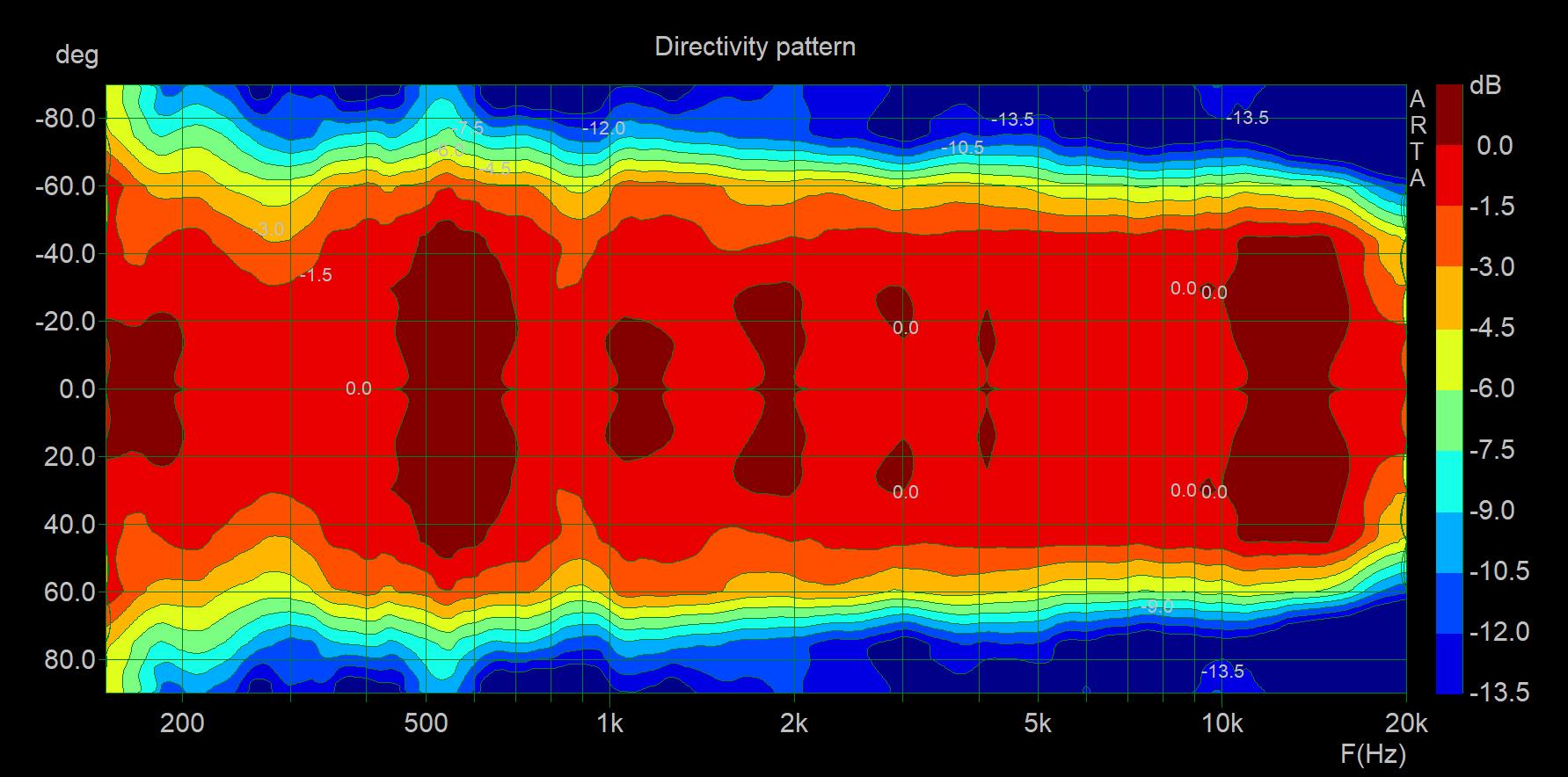

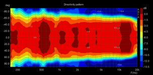

In comparison, a horizontal polar of a diffraction slot horn below. Take not that this is measured indoor without any gating. The directivity is much wider than what it actually is, which is common with indoor measurements.
JBL M2 (Crown iTech 5000 Amp; M2 Base Configuration) Horizontal Contour Plot (Normalized).png383.8 KB · Views: 2,169
JBL M2 (Crown iTech 5000 Amp; M2 Base Configuration) Vertical Contour Plot (Normalized).png391.2 KB · Views: 2,140
Erin did a Klippel test a little while ago.
IMHO, the narrowing directivity in the top end of the M2 isn't really that much of an issue since there isn't much content up that high anyway.
Why would that be? Indoor measurements can be just as accurate as outdoor ones.
Where's the quote button on the latest message?
Gedless wrote: "Why would that be? Indoor measurements can be just as accurate as outdoor ones."
I'm not really sure, but I'm seeing this when I compare my indoor measurements with anechoic ones. And I hear others are experiencing the same thing.

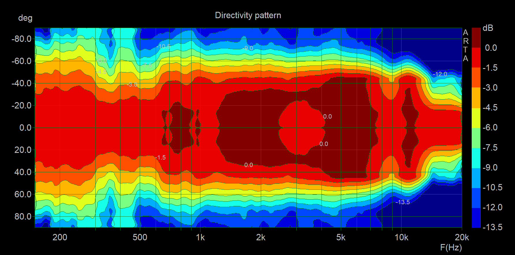

Below is an indoor measurement of the Klipsch K402 (no gating FIY). Same thing here. It's much wider than the approximate 90° directivity Klipsch has published.
I think what Earl might have missed is your mention that "this is measured indoor without any gating.".
Is that really what you mean by an indoor measurement?
You are correct Marcel, it is not correct. I did catch the gating comment, but wanted to see if Omholt realized this was the issue.
