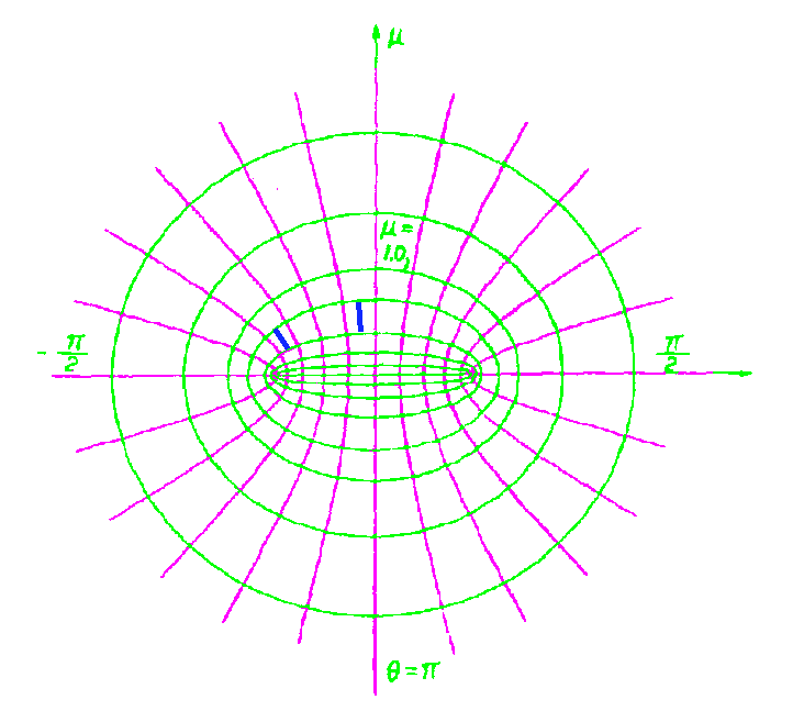

For a part of my job I often work with orthogonal sets of curves, also I teach to my students the difference between an "equal area" transform which one keep area constant through the transform but not the shape and "equal angle" transform which one keep the shape constant but not the area.
Then I personnally live in an Euclidean world and I listen in that same Euclidean world that's why I would prefer if the wavefronts will be parallel in its "equidistant" meaning.
Just for the other people who want to undertand what it means, I put in attached file a graph everyone would recognize as the oblate spheroidal coordinate system (mu, theta). For what I understood the profile of the OS waveguide follows one curve in violet color. This means if I am right that the wavefronts are in green color.
I draw two segments for 2 different value of theta between 2 wavefronts. If the wavefronts were parallel in our Euclidean world the 2 blue segments should have the same length. Correct me if I am wrong but they have not.
So if the green curves are wavefronts and if speed of sound is constant (within the conditions in the waveguide) they are not reached at the same moment... But may be I am wrong in my interpretation and the green curves are not wavefronts...

Your interpretation is not completely wrong, but I think that the point you try and make about "Then I personnally live in an Euclidean world and I listen in that same Euclidean world that's why I would prefer if the wavefronts will be parallel in its "equidistant" meaning." is completely without justification and given with only the weakest of support, which is basically "I don't like it." I don't like the idea that the waveguide contours for LeClerq or Avantgarde waveguides are drawn using equations that are completely incorrect as far as wave propagation goes and hence these contoure are drawn simply because they look good - no scientific justification is available. This kind of approach to engineering is simply not one that I could respect.
Because the OS solution is singular at the ends of the line it has to become complex (in a mathematical sense). But this is no different than the solution to a spherical wave near the origin where the phase angle between the pressure and the velocity are not in quadrature (as they are in the far field). So when talking about phase wavefronts, as you are, you must be careful about what it is you are talking about, the pressure wave or the velocity wave. For large off axis points very close to the origin disk ( the origin line in your drawing) the phase of the wavefronts for either the pressure or the velocity are not not coincident with the coordinate lines, but the group velocity of the magnitude of the wavefront is.
This effect becomes apparent in the OS because it changes with angle, while this situation does not change with angle in the spherical case and is not as apparent, but still occurs near the singularity. This gives the appearance of a changing wave speed, which it is for either the pressure or the velocity, but not for the wavefront when properly defined.
In any case, good waveguides are not usually used out to the angles that you have shown in your example and at points nearer the axis this effect is minimal - meaning that the pressure and velocity are very close to being in phase and as such the impedance is very close to be purely real. Because of the gradual slope of the impedance for an OS waveguide it can be shown that it will also have the lowest reactive component of any countour. I'm surprised that you missed this point.
Hello Earl,
Thank you to have (partly but largely) confirmed my analysis about the non equidistance of the "theorical wavefronts" in the OS waveguide.
About your direspect of the Le Cléac'h horn: this horn is designed in order to provide the most constant resistive acoustic loading to the driver and this can be maintained down to low frequency. People using Hornresp can verify it very easily and may compare to an OS waveguide (for which I could never obtain with Hornresp the low reactance you claim at least in the middle of its useful frequency range see attached graph).
Directivity of the Le Cleac'h will be controversial only at high frequency when using compression driver. The same Fc horn mounted on a 17centimeter loudspeaker is often judged as giving a very wide sweet spot. I cannot see anything in that an audiophile could disapprove.
What lead me to the question of the "theorical" non equidistant wavefronts in the OS waveguide was the difference between the published pulse responses for the OS waveguide at different angle (specifically 0° and 22.5°). I found that the difference in their shapes was quite noticeable... I have no other comments to do on that.
BTW: Is there a formula giving the evolution of the area of the wavefronts in the waveguide versus their distance to the throat?

First, you must not have read what I wrote very carefully because the wavefronts are equidistant when defined correctly.
Second, thanks for proving my point that for equal cutoffs, the OS will have lower reactance and a smoother resistive load that the LeClearch horn. You, of course, have choosen to compare apples to oranges by NOT setting the cutoffs the same. When this is done what I claim will be clearly evident as true.
Of course there would be an equation giving the area as you desire. I would have no use for this equation so I have not developed it, but it probably wouldn't be too hard.
