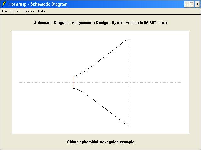

Variac said:
I hope that we can get a really good calculator posted so that some wacko-big 'guides will be made!
Hi Variac,
The Schematic Diagram Export tool in Hornresp can be used to obtain OS waveguide construction dimensions. The only constraint is that the throat entry angle is fixed at zero degrees.
Kind regards,
David

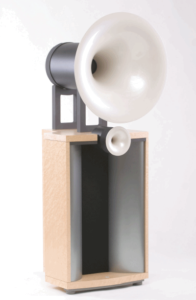

salas said:
Hello Earl
Can you comment on this ? Technical principles of its profile, claims in text. Its been around rather a lot in high$ home systems. It used Ciare woofer and B&C compression driver once I repaired a 15 inch one.
I've heard them and they are actually quite decent. But you better make A LOT of money to be in that ball game. They are very very expensive. I can't understand how he got the patent claim that he did - it seems so obvious to me and I'm sure that I could find prior art.
Yechnically, very wide waveguides like this are not such a good idea. But the low diffraction - not discontinuities - is a positive.
Thank you Earl. I have listened to some models of them in several occasions. Decent but still some typical horn style residue. Avantgarde faired better to my ears.
