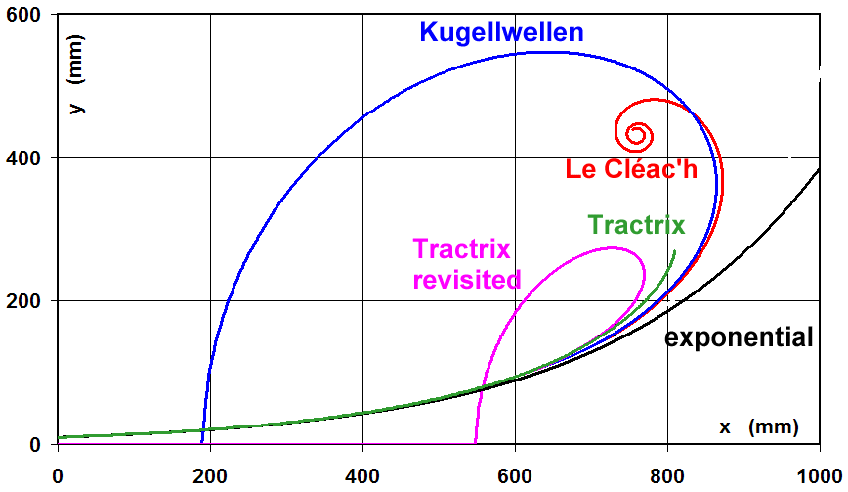

David McBean said:
Hi Earl,
Just to clarify - the Avantgarde speaker is actually a spherical horn, which is slightly different to a tractrix horn. The two profiles can be compared in Hornresp.
Kind regards,
David
I don't have Hornresp - could you explain the difference? They are both just contour drawn on a piece of paper with no real theoretical justification correct? Doesn't the center of the circle defining the contour move forward at a different rate?

Hello,
I think the horn called "spherical" in Hornresp is better known as Kugellwellen and was first designed by Rösch at the Klangfilm Laboratories. Litterature about this horn is rare.
See:
H.Schmidt
"Über eine neue Lautsprecherkombination"
"Funk und Ton"
N°5, 1950, pp.226-232
The Kugelwellen'theory is based on sherical cap wavefronts all of them having a radius which is the double of the tractrix horn of the same cut-off frequency. The expansion of the area of the wavefronts is according to an exponential law.
What Hornresp doesn't show is that a Kugelwellen horn possess a profile that roll back at the mouth (see attached graph).
The Tractrix doesn't curve back because, near the mouth, the expansion of the theorical spherical cap wavefronts departs from the exponential law. I used to revisit the Tractrix profile according to an exponential expansion of the wavefront and in that case the profile of the "revisited tractrix" rolls back at the mouth (see attached file). Both the Tractrix, the Kugelwellen and the Tractrix revisited are based on "constant speed" translated spherical wavefronts along their axis and thus their "theorical wavefronts" or isophase surfaces are not parallel. This is a one of their negative features...
(but is the OS waveguide also based on non parallel wavefronts = isophase surface , or not, that's an interesting question...)
Note: on the attached file the Le Cléac'h horn was calculated using T = 1 (expansion of the area of the wavefronts according to an exponential law). You may see that the Kugelwellen and the T=1 Le Cléac'h horn posess a similar profile on more than 90% of their length.
Best regards from Paris, France.
Jean-Michel Le Cléac'h
David McBean said:
Hi Earl,
Kind regards,
David
The OS contour is based on a solution to the full 3 dimensional wave equation. The wavefronts are, by definition, iso-phase, but that does not mean parallel in common understanding. They are parallel in the sense that they travel along and perpendicular to a set of orthogonal coordinates, which in a non-Euclidean geometry sense is the deffinition of parrallel.
The OS solutions are analytically exact in full three dimensions and as such they are the only true solution of the wave equation for a flared contour, all others being only approximations, some better than others.
