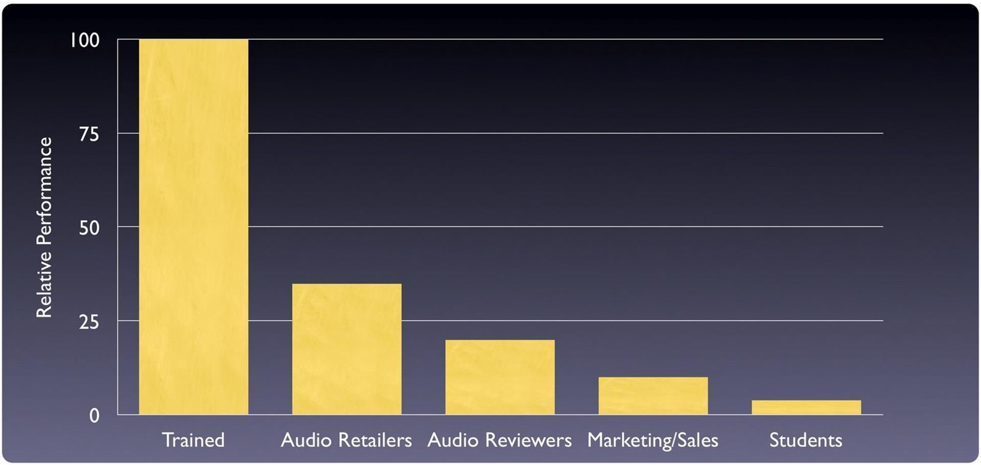

You don't need a blind person to identify a sound. You need someone whom can identify the finer qualities of sound. If a blind person is not in frequent exposure to the sound being evaluated, it is of no value.
Which are not audio retailers or reviewers. Neither students.
Listener performance:

Listener training has some value, I agree, but IMO it makes far less of difference than prejudice does. In other words, I would be far more inclined to value the unprejudiced opinion of an average joe off the street listening blind than I would the prejudiced opinion of an acclaimed golden-ear guru in a sighted audition. Realistically, the guru can never be expected to set aside his philosophical convictions built over decades.
Sean also makes the case that while students are less stable, given enough of them their results are indistinguishable from the experts. They can do the job, just not as fast.
But, as I quote before, we found a case that was the exact opposite. And these were Harman Qualified Evaluators.
This is why you have to do a with-in subject variability. If you do this, which we always do, then you know what the subjects are capable of detecting.
Then there is the case when I was manager at Ford. I had a gauge R&R study done on or "expert listening group" - the in-house golden ears. All self proclaimed experts. Results - the gauge was "not capable" when taken across all ten listeners. There were two listeners who were capable, but as I said, all ten claimed to be capable.
No matter how you cut it, listening tests are never as easy as people want to make them.
