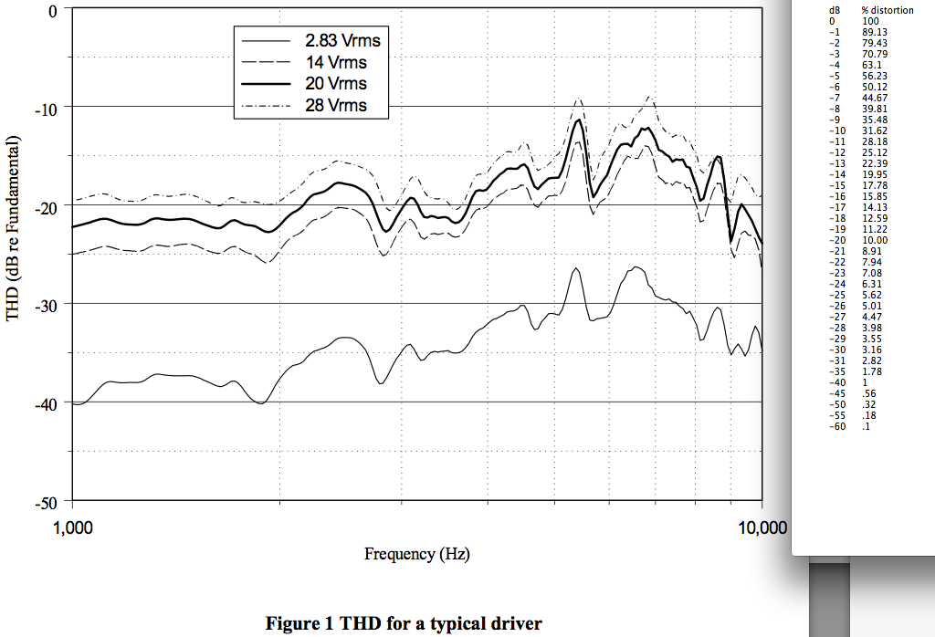

After (finally) looking over your white paper, "Subjective Testing of Compression Drivers", the test protocol you used and I used in :
http://www.diyaudio.com/forums/multi-way/212240-high-frequency-compression-driver-evaluation.html
are quite similar, with the following differences:
1) Rather than using a plane wave tube, I recorded the output of various drivers on a narrow conical horn on a large flat baffle.
The horn used has similar response to a plane wave tube above 800 Hz, so the difference between using a horn vs. plane wave seems to be little.
2) Rather than using one EQ for all the drivers, individual EQ was used for each driver, making source differences less, subjectively minimizing or eliminating differences when low drive levels are employed.
3) Rather than comparing three (high) voltage levels covering only a 6 dB range, each resulting in high levels of distortion (5-10% at 1000 Hz ranging up to 10-35% in the 4-9 kHz range) my tests were done over approximately 15 dB range with levels resulting in a range of much lower to higher levels of distortion than your test.
4) Rather than college students comparing three high levels of distortion to each other, my test allows any one that cares to compare the original source recording to the equalized response of drivers played back at various levels.
I have no doubt in your conclusion that at the three high levels of distortion, the three tracks were statistically similar in rating.
However, the distortion attributes of each of the drivers may be as different as the linear distortion (frequency response) are, so question your conclusion that the subjects were only detecting linear, rather than non-linear distortion differences.
I agree completely with your observation:
"In hindsight it is apparent that the addition of a dummy source, one that was in fact the reference, would have added value to the interpretation of the results. It is most unfortunate that this possibility was not seen beforehand."
My test allows for that possibility, you may possibly revise your conclusion after listening to the different drivers at different voltage levels yourself.
Since all the drivers equalized (linear) recorded response sound virtually the same as the source recording at low voltage drive levels (if you hear differences, please comment) but sound different at high levels (again, anyone not hearing those differences please comment) my conclusion would be that differences in non-linear distortion do make drivers sound different at high voltage input levels.
Art
Earl,
Art
Art, I don't believe that this is true. There was statistical significance across drivers, but not across levels. Had the distortion been significant, even if it was different across the drivers, it should have been detected by the level change. Changes which did change the measured THD by an order of magnitude as I recall. Based on the results, your claim simply cannot be correct.
How do we know that the distortion in your test is not somewhere else in the system?
If neither of us made an error in our experimental design and implementation then the only explanation that I can see is that we were testing at different absolute levels - yours being much higher than ours at you highest levels.
In neither of our experiments were we sensitive to diffraction effects and that's a serious limitation, especially when dealing with horns.
After some tens years of researching this specific topic (not horn in general, just the audibility of "harshness/distortion" in them) my conclusion is that the internal diffraction effects, HOMs, etc. are the most likely cause of a poor sound in a horn/waveguide device; that nonlinear effects, while they may be present (although the data here is controversial), are not significant enough to overcome the negative effects of diffraction.
1) The three levels you tested at are not an order of magnitude apart in terms of distortion or level, they are only 6 dB, while the distortion difference is only around 4 dB to 6 dB different.Art, I don't believe that this is true. There was statistical significance across drivers, but not across levels. Had the distortion been significant, even if it was different across the drivers, it should have been detected by the level change.
1)Changes which did change the measured THD by an order of magnitude as I recall. Based on the results, your claim simply cannot be correct.
2)How do we know that the distortion in your test is not somewhere else in the system?
3)If neither of us made an error in our experimental design and implementation then the only explanation that I can see is that we were testing at different absolute levels - yours being much higher than ours at you highest levels.
Had you included the 2.83 level, there would have been an order of magnitude difference.
Given three level choices, orders of magnitude would be far more revealing of difference than three with only a 6 dB range.
2) I am confident that the recording system is not resulting in the distortion we hear, the B&K 4004 mic, and the digital recorders used have virtually no distortion, while the driver distortion is easily measurable, just as you measured in "Figure 1" posted in #6605.
I was actually surprised that the distortion was not as apparent on the recordings as it was live.
3) The drive levels I recorded at were less than, equal to, and greater than your test levels, assuming you used 8 ohm nominal drivers.
This makes the difference in distortion far greater, and more apparent than in your test protocol.
Art
Art
I accept your critique of our experiment, had I to do it over again I would make changes.
My critique of your experiment is that it is not blind, which in my book is the first requirement for any study on audibility.
Art,Art
Your critique is valid, though the labeling for each of my recordings is so arcane that even I can't remember what all the recording conditions are without looking them up on the cheat sheet.
For the average person, the labels would have about the same value as diamonds, squares and triangles.
You could have Lidia play the recordings for you blind, with an A/B to the original source recording.
If your hearing is anything like mine, I'm sure you will be able to easily detect the recordings with high drive levels, and I doubt you will notice much if any difference between drivers played at the lower levels.
I have faith you will also hear the difference in the distortion "character" between the drivers.
I trust our old hearing's response a lot more than 27 blind college kids from 2005 😉.
Art
