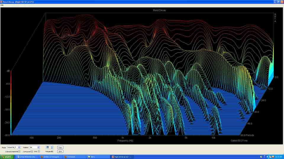

What may not have been mentioend is that to a degree you can examine the room reflections with ARTA.
Here is sonogram view of a Burst decay of a very directional speaker taken at the listing position.
In this display, intensity, frequency and a scale based on wavelength (instead of time) is used, in this view, time is now wave periods. In the ETC i posted earlier, one can see a very visible floor bounce which is the first significant thing to arrive after the direct sound.
In this view, a reflection that caused a delayed signal of say 10 periods at 500Hz, will also make one at 20 periods at 1000Hz and so on. AS a result, delayed or reflected sounds show up as an arc.

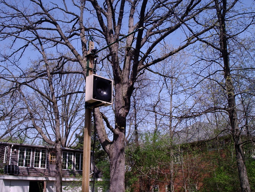

Nice setup Tom. That has to result in some good data.
BTW, what is that crazy multi-cell thing on the roof? It looks like a 15 cell horn with each cell broken up into 4 parts. RCA?
It keeps the birds from flying into the windows.Nice setup Tom. That has to result in some good data.
