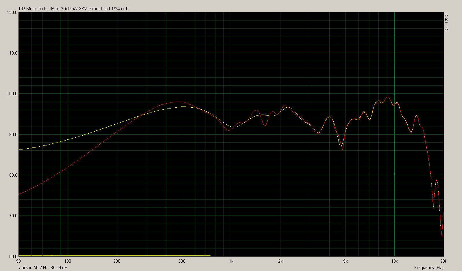

Markus,1ms will result in those gated measurements being valid from 1kHz upwards.
This is a common fallacy in windowed FFT measurements. "Valid" ? Maybe, technically. Accurate ? No way.
People seem to forget (or be unaware) that the window time doesn't just affect the lowest "valid" frequency, as if there were a hard cut-off where everything above it is accurate, it also affects the measurements frequency resolution throughout the entire frequency range.
What is the frequency resolution with a 1ms gate time ? Yes, that's right, 1Khz. This means the entire measurement is smoothed with a 1Khz wide window, and any variations narrower than 1Khz (such as resonances) will be smoothed out. From 1-2Khz you effectively have octave smoothing that will remove all detail such as resonances, with the effective smoothing gradually becoming narrower per octave as frequency goes up.
If you don't believe this is a serious problem, look at the example I've attached below.
Red is the response of a driver with a 3.635 ms window time, while yellow is the exact same measurement with a window time of 1.333ms - the smallest that ARTA will allow. Both are within the reflection free period for the measurement set up.
The time-bandwidth limit for 1.333ms is 756Hz, which is even more generous than your 1ms/1Khz example. (278Hz for 3.635ms)
By your reasoning everything above 756Hz is valid. It's clear from looking at the results that there is a severe loss of resolution for at least 2 octaves above the time bandwidth limit, and the driver resonance between ~1.4-1.8Khz has been completely smoothed away by the 1.333ms window period. (In fact even the longer window period is still too short to accurately identify the centre frequency and width of the resonances)
Without a "longer than necessary" window time you would not even be aware a resonance was there, so how could you correct for it if you were trying to apply EQ.
Notice that even at 4.8Khz a narrow deep notch is significantly smoothed by the shorter 1.333ms window period.
As a rule of thumb I don't consider anything within 2 octaves of the time bandwidth limit to be "accurate". A 1ms window time has no hope of providing sufficient frequency resolution to correct for narrow band deviations in response at anything below approximately 4Khz, so I stand by my original assertion.
Windowed measurement techniques are an extremely useful thing but people need to be aware of their limitations, and their poor frequency resolution with short window periods is an under-appreciated source of significant error. What you can't measure, you can't correct.
Actually, ARTA limits the number of samples to a minimum of 128. You have been using a 96k sampling rate. With a 192k you can do shorter gates, but not all sound cards allow it.
Yes you're right the limit is 128 samples, and I do use 96Khz for all measurements.Actually, ARTA limits the amount of samples to a minimum of 128. You have been using a 96k sampling rate. With a 192k you can do shorter gates, but not all sound cards allow it.
A simple way to trick it though is simply move the start pointer further back 😀

Markus,
I'm fully aware that frequency resolution is affected. In our 1ms example it becomes 1000Hz which is pretty coarse. But, then again, we're dealing with (well) engineered and finished products and all we want is to optimize the way sound is perceived (think Bark scale).
