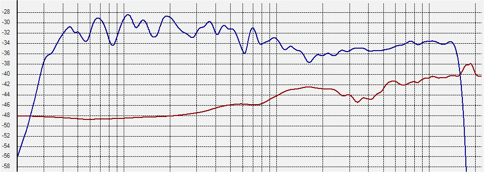

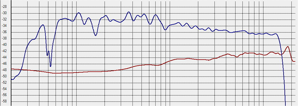

Not quite. If you don't mind I think I've stumbled across a fundamental (objective) connection, and hope you could tell me what it is. My directivity does vary, eg it narrows above 500Hz, the woofer is a little wider than the waveguide at the crossover, the waveguide narrows just a little like a tractrix horn, plus the usual issues, but nothing huge.
When I have previously set the crossover to the power target, I have felt the need while listening to EQ away from it...and always to the same place within 2dB of the calculated curve. Most noticeably dropping a couple of dB above the crossover.
So yesterday I was looking at your older Summa response and was thinking about the power dip near 2k which is accompanied by a narrowing of the pattern. And then I saw it...
If I look at the included angle between the -6dB points and compare this angle to a different frequency, there's an apparent connection to the power response. The relative coverage angles at two frequencies seems to relate to the relative power response that you've chosen and plotted for them. Wider gets more power and narrow gets less. Even taking the log*20 of the ratios seemed to give me the number difference in power that is shown on your plot.
So I went and plotted my directivity as a function of the widths of the -6dB points per frequency. Then pretending it was a power target, I crossed the drivers to meet that (using my usual sim and working with my peviously calculated power responses of each driver). The measured result from my listening chair was the same result I always achieve by ear, except for a straight response from around 2kHz up. I tilted that toward a few dB down at 10kHz like always prefer, and all is well.
Ok, thats good, still not sure that I understand. For the most part the -6 dB points will track the power response, especially in a CD waveguide. I don;t think that will be true of other types of sources as well however.
I did say things wrong in my previous post and wanted to correct that. The DI is what cannot be changed by EQ. Hence if along the listening axis the DI is not flat then there is nothing that you can do electronically to correct it. If, however, you can find some axis for which the DI is flat, but the listening axis is not flat, then that can be corrected with EQ. This is why I plot those in my plots and how I design the crossover. They show what is acoustic and uncorrectable and what is correctable with EQ. Looking at a single axis curve or a stack of curves will not show you this.
If there is a point I'm aiming at learning it is how to create a power target for a given speaker (without listening). It has been said that it shoud be mostly flat but I'm finding this limiting. Anyway, here is the change since using a planned power target.
A) Subjective result (old, typical)
Listening position response of all sources. Includes DI plot for 20 degree axis chosen solely for its smoothness of DI.
The need of shelving above the crossover was correctly predicted.
On the other hand the initial driver targets were fabricated and then tweaked, sometimes blindly, sometimes badly.
B) Objective result
This sounds better. These have been asking for a greater dip at 2k although that would seem counter-intuitive.
Includes DI plot for 10 degree axis, chosen because it corrected the direct response (by using the same directivity narrowing issue against itself). I can see this was poor logic and is wrong, and I will be looking into splitting the difference at 15 degrees to find a more smooth DI.
Significant improvements below the crossover although it isn't easy to tell this from the two plots.
I can't take this much further as it is.

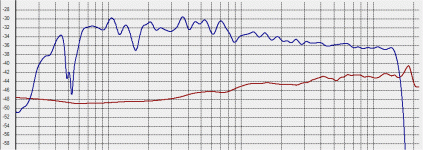

How are you calculating DI? You cannot measure DI in a room, its deffinition requires anechoic data.
Calculating DI and power response is not trivial and it took me years to be able to do this with reasonable accuracy. Thats why I question how you are doing it.
So the DI axis can be chosen w/respect to any arbitrary axis?
Obviously the polars are then asymmetric, but just go ahead and integrate/average them to get the power response and DI?

I have a set of discrete anechoic polars. I have processed them to create one extra plot that I use where I need a power response. Plus, I have one phase set from 20 degrees (one for each driver).How are you calculating DI? You cannot measure DI in a room, its deffinition requires anechoic data.
The 'power' calculations ignore phase. I have insert the chosen phase plot into a few of the polars and also the 'power' plot so that I can make use of it experimentally in a sim.
On this occasion I built a crossover (for a single main speaker) using the 'power' plots, and saved the total response. I then substituted the 10 and 20 degree plots in turn with the previous phase and impedance data intact, recalculated the crossover and divided the result by the saved total to give me the DI.
I use my computer for the power calculations to save time. I essentially take the ploars and weight them based on the region at each angle, and average them.Calculating DI and power response is not trivial and it took me years to be able to do this with reasonable accuracy. Thats why I question how you are doing it.
I'm assuming so. I have some reasons for not wanting to choose too low or too high an angle, and would prefer something less than 45 degrees.So the DI axis can be chosen w/respect to any arbitrary axis?
This is what I'm presently doing. The polars are not symmetric, and I don't think this is a significant problem, within reason, although it does seem to put up some constraints.Obviously the polars are then asymmetric, but just go ahead and integrate/average them to get the power response and DI?
