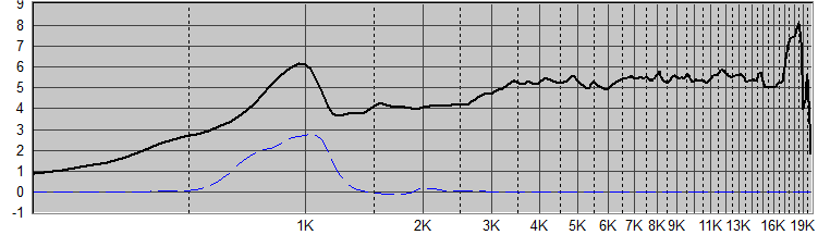

Here is the (interpolated) DI for the 25 degree axis using the corrected power response. The blue trace shows the amount of DI contributed solely by the crossover. I'd like to shift the crossover a little to knock over the DI peak at 1k, but I'm caught between a 650Hz tweeter resonance and some cone breakup.
Question, is the DI based on a point or a plane? ie if I need to figure the SPL as the average around a vertical plane then I'd need to weigh in the cancellations around the crossover region.
In other words the DI plots were created from anechoic data, then I simmed in the crossover rather than to 'build and measure'.
And I just realise that's another mistake I've made. The directivity index should be 3dB higher around the crossover than I've accounted for due to power losses from lobing.
OK, so I guess I'd need to calculate the power response of the drivers after crossing them, convert the powers to a linear magnitude and then sum them?
I can't imagine this will be totally accurate due to the fact that I'm hardly dealing with coaxial point sources, but I assume the errors would average out somewhat in reality.
This is precisely what I do, but its is a complex thing to get right. You need magnitude and phase data at many angles, and the magnitude and phase of the crossover into the speaker load. Then you can sum the two, but only if the field data was taken with a common point of reference, otherwise the sum won;t be correct. Even then, I have done hundreds of these kinds of simulations and it is veryt difficult to get a simulated result that is exactly the same as the actual result. It has taken me years to get this to work. The crossover is very sensitive to phase and the phase is very sensitive to the measurements.
Once you get this to work then you can get the DI from the power and polar response, but only if this all works out correctly. Otherwise the DI will not be correct.
I see. I was going to write some code to break the drivers into a large number of sources. I was just getting stuck on choosing the common point of reference (and the shape of the field if not spherical...), when I realised I couldn't reasonably predict diffraction or cone breakup.
Quite correct. What you have to do is to measure the actual sources in the enclosure that they will be used in. Then you can proceed to simulate the crossover. Trying to model the actual drivers will be very inaccurate at the upper end of the lower driver in the crossover. This will prevent any useful simulations of the crossover.

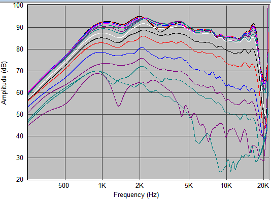

DI is defined with respect to the axis being considered. It is the frequency response along any axis normalized by the power response (in dB). The power response is independent of any axis so it stays constant as the axis of consideration is changed.
I see, thanks for clarifying the definition.
Referencing DI to a single point seems potentially hit and miss. On the other hand there seems no mention of the orientation of the axis used so I wonder whether DI should be calculated using the average over a small circle of a sphere?

I have a set of Summas, and I'm happy with them, but I notice that a bit of 'air' is missing in the top octave. You can see this in the measurements of all the Gedlee speakers; they drop off around 16khz.

First the drop in those older plots is a result of an anti-aliasing filter in the measurements and it not accurate, but yes, the response above 18 kHz (where there is actually a large peak)drops just like a DE250 does on any other device. But the real question is if the downside of using a super tweeter (crossover, more lobing etc.) will be the cure being worse than the disease. IMO it would be.
That the newer DE250's do have more high end than the older ones is also true.
I always thought the lack of "air" on horns was from a narrow dispersion pattern up high, and just came with the territory of constant directivity speakers.
My Waveguides don't narrow at HF's - most "horns" do however, like exponentials, they beam quite a bit. If they 'beam" then they aren't "constant directivity".
