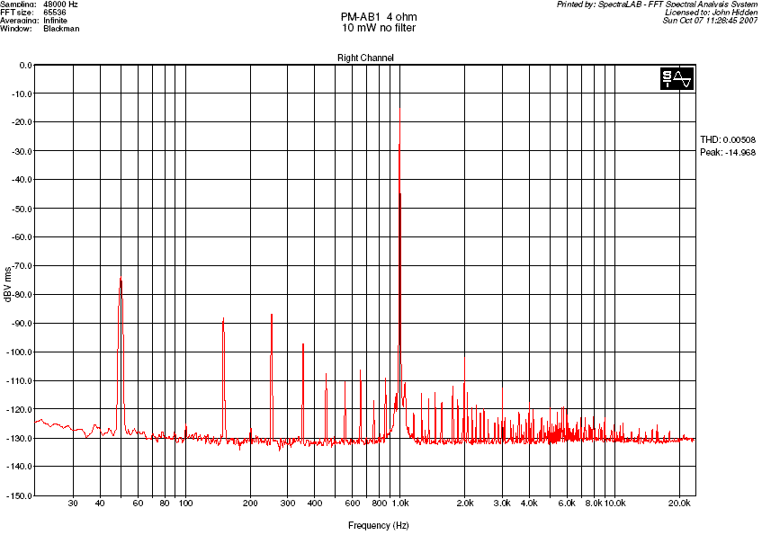

10 mW without filter:
The noise modulation is away, but high order spuriae from the generator appeared.
I am not sure if the methods shown much for my amps, one of them is class A and the second is class AB with EC. I guess the method would show more for traditional class B design, but I have no such amplifier at the moment.

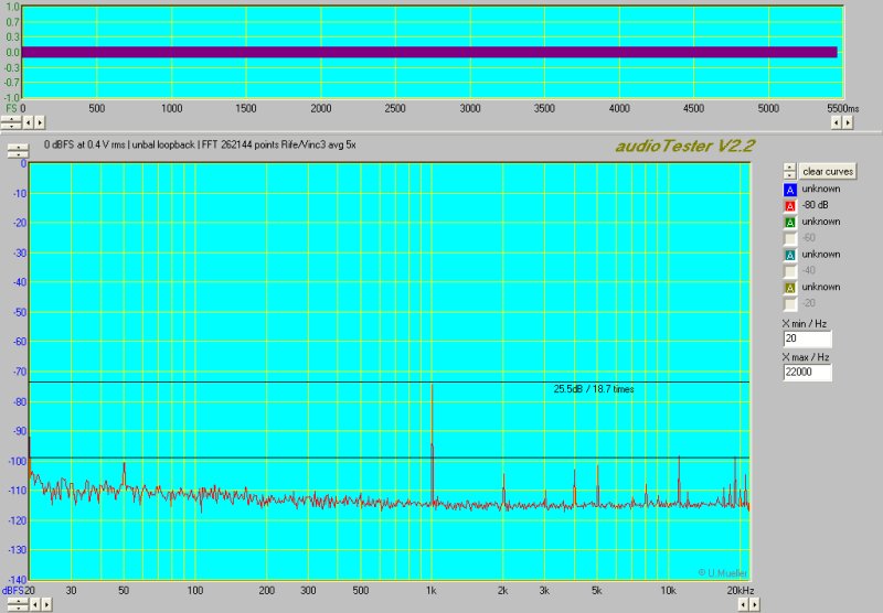

FWIW I tried some primitive loopback tests with my M-Audio USB pre, digital attenuation only. I get the noise floor down to close to -120 dB or so with averaging of a long FFT (0 dB for this sound card is at 0.4V, above this it is clipping pretty bad). But some high level harmonics remain practically constant regardless of input level. See attached the -80 dB measurement. There is no DUT here, just loopback. I'll have to check if it is the input or the output that is distorting.
Yes, the loopback method always brings digital spuriae. Try to play both with output D/A and input A/D level to find optimum.
Also, calibrate the input level. I do it at 1Vrms = 0dB, so you can read what was the actual Vrms level at the card input. After simple maths, you see it fits to those 10mW/4ohm measurements.

I played a lot with the in and out (analog) levels of the M-Audio, this is already the best combo I could come up with. I use -10 dB for out and 0 dB for in, beyond this I don't seem to gain anything.
The M-Audio Pre is a bit odd in that all in and outputs are AC coupled: both balanced and unbalanced in and outputs have no direct DC path to ground. Balanced operation results in some improvement of course, but for better or worse I can't use the proper method to connect unbalanced equipment, which would be to ground the "cold" lead at the input: the sleeves of the balanced in are not connected to ground either.
Calibration: the inputs have attenuators, but in front of these attenuators there must be some clamping diodes to prevent overload, because input >0.4V rms results in heavy harmonics even with attenuated signal. But yes, I could "calibrate" it by calculation, if not by applying actual 1V rms.
Try to set sampling rate to 48khz, these artefacts looks much like resampling. (converting 48khz to 44.1khz)
Most soundcards always work at fixed 48khz.
Also try to not use digital attenuation, changing volume also creates artefacts.

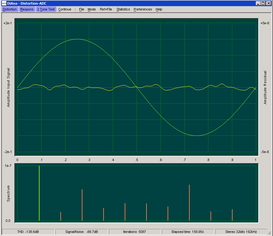

As I told before (post 125), I'm using a kind of software 'lock-in' combined with averaging a large number of cycles. Now I like to show some results. The first picture represents the noise floor and/or residual from a test signal of 5kHz. It is obtained just by subtracting the results from two identical runs.
The upper windows shows the fundamental and residual, while the lower window shows the spectrum (on a linear scale). The amplitude of the 2nd harm. = -1560dB and the 3rd = -144.9dB. The measurement bandwidth is 50kHz.
In the next post, you'll find the measurement results on a commercial amp.

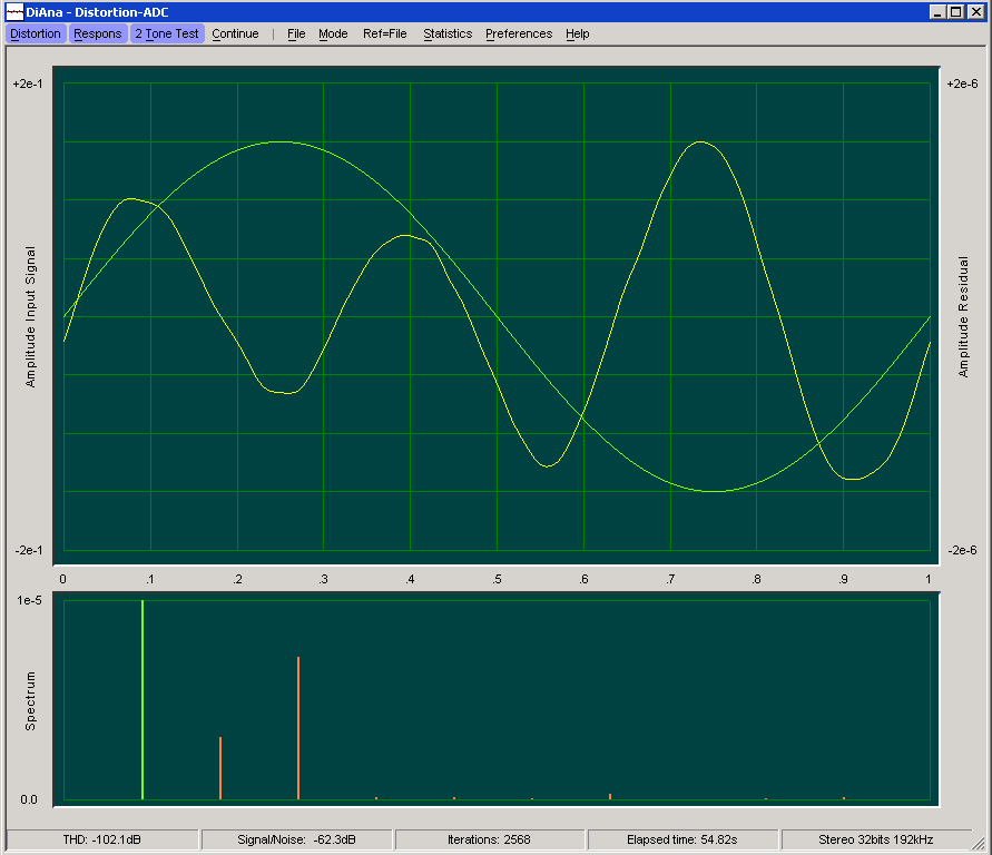

And here is the distortion of a NAD317 at 5kHz and Po=91mW
H2 = -109.9dB, H3 = -101.7dB and BW = 50kHz
This result is obtained by subtracting the residuals from two runs, one with the amplifier and one with the measurement setup alone.
Cheers, Edmond.
edit: No cross-over distortion is visible.
Edmond Stuart said:
... It is obtained just by subtracting the results from two identical runs.
I think you can't simply subtract the distortions unless you know the phasehifts of these distortions. Because of these phasehifts you don't know if the distortions from measuring and from amp add or subtract.
Especially even harmonics tend to cancelling.
Mike
Mike
Hi Mike,
Good point. Although I didn't mentioned it explicitly, I do apply a correction on the 'reference' distortion, based on the phase and frequency response of the DUT. It is a rather complicated affair, as in this case too, the phase and frequency response of the sound card has to be determined first, then a run with the DUT included and finally, subtract from this response the result of the first run.
Cheers, Edmond.

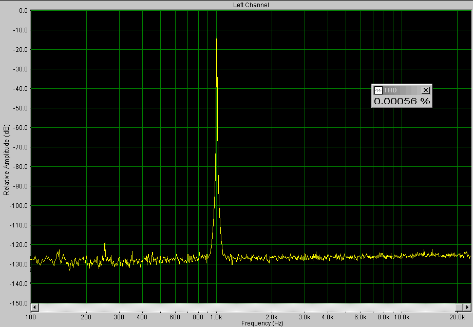

finally got it, how to obtain satisfying results with my ONYX sound card.
All plots were taken without any additional equipment. Setting all levels analogue to their best does the trick.
What can be seen here is that it is possible to get a reliable 110 dB dynamic range.
Note that the Y-axis is dB FS ( full scale ) not dBV !
What can be seen here is that it is possible to get reliable measurements down to roughly –140 dBV.
This is a stunning 1/10.000.000 V = 100 nV.
Note that this is only true with weak signals as dynamic range is less than 80 dB.

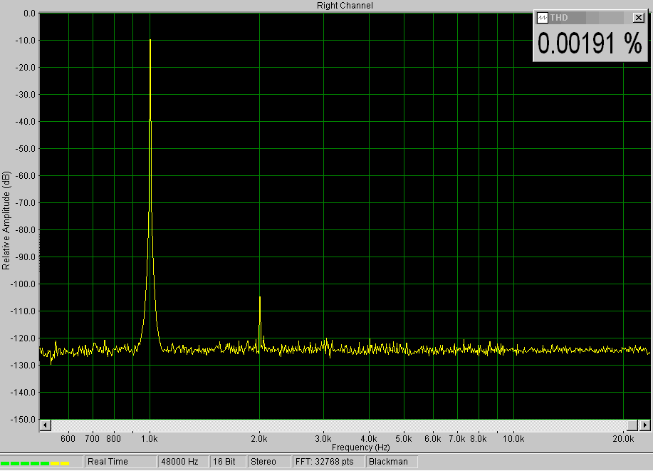

Having solved the hurdles of proper measurement setup I now can compare to the measurements Earl did in posting #16
http://www.diyaudio.com/forums/attachment.php?s=&postid=1311718&stamp=1190930297
First DUT is a discrete build KENWOOD car amp
This one isn't supposed to be of finest quality but doesn't measure that bad.
Note that these kind of amps do have switched power supply.
