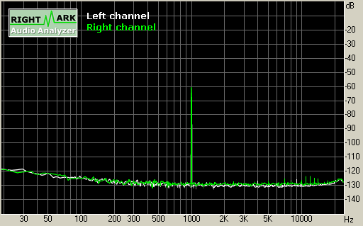

PMA said:
This is a mess I get from USB soundcard, with AK5365 A/D converter. 0dB = 1Vrms.
Stock, out of the box, or any modifications?
I have an older M-Audio USB sound card, 16 bits only, and with diff in and out I am lucky to get -90 dB (on a laptop with batteries). Seems there has been progress...
PMA said:
OK, I shown only 0.3 micro Volts narrowband.
Arny Kruger has high res spectra of most of the major highend soundcards on his web site (pcavtech.com) doing 24bits on -60dB inputs. Even his top card has spurs. What I meant is that when you are actually digitize low level signals there are non-harmonically related spurs (sometimes a lot of them) rather than just a thermal noise floor.
I can't imagine a useful amplifier THD measurement that you couldn't do with a good sound card and a little work.
EDIT - I just noticed that Lynx2 soundcard is $1100
Thanks, I will visit his site.
Yes, the Lynx is not cheap.
I have my -60dB result here, but only loopback right now. The external signal was better.

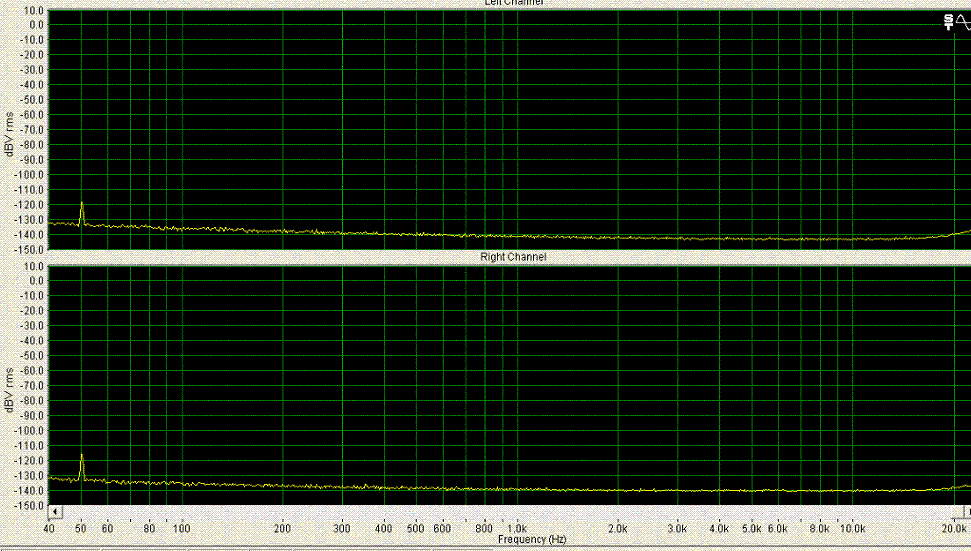

Hi
PMA, here is what the firewire Mackie Onyx 400F does on line-in and mic-in.
Note that the line-in does have a roughly 10-20dB headroom here translating in +/- the same performance shown from your card. I assume that in the pic of post 126 your 0 dB = 1 Vrms also equals full scale, no ?
The mic-in gain was set to provide full scale at 1 Vrms hence the " better " performance than line-in which in fact is misleading.
Signal was taken from the output with a 60 dB resistive attenuation.
Averaging was 100 for all plots.

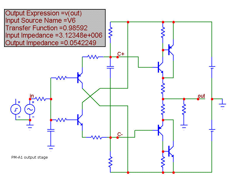

Thanks for the schematic.
scott wurcer, thanks for the www.pcavtech.com link. Sadly the Mackie isn't tested.
Sent you two mails but seems they didn't reach you ?
Greetings
Michael
