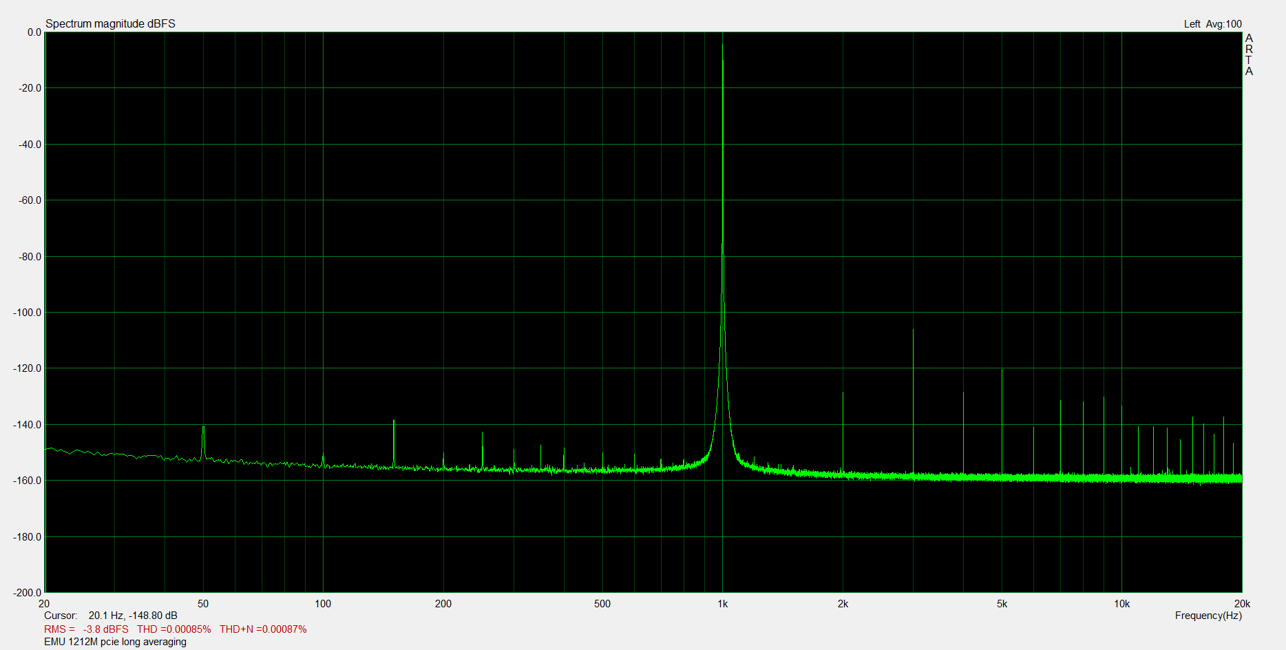

Generating a very low distortion and noise signal at very low levels is probably a bigger problem. I do it in code, double precision floating point, so it is very clean.
How do you create a very low distortion and noise signal at very low levels without a pre-amp? My sound cards have only a "digital" volume control, so making a very high resolution signal at very low levels is not possible. When generating a signal at 1Vrms with long averaging (without additional external hardware) I can get good results (see below).
See also the difference between long and short averaging...
