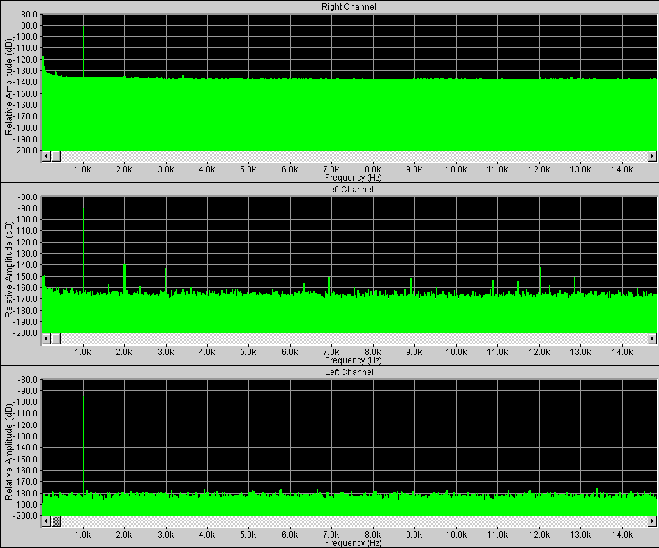

I tried this approach (or at least what I think it is), using the hints given by Mr.Geddes and writing a C quickie according to that.
Now what can I say.... THIS IS INCREDIBLE!
Please look at the attached plots, showing loopback measurements of my soundcard, at 24bits and 48kHz. The top plot is trying to FFT (16K block size, no windowing) a -90dBfs-Signal in the conventional way, the center plot is what I got using the Geddes method, and the bottom plot is the stimulus alone, for reference. The sound card has 0dBfs == +6dBV levels. It uses an AK4524 24/96 2ch-codec which has analog input gain adjustment, while output gain is controlled digitally. Therefore I leave the output gain always at 0dB, but the input gain can be adjusted without penalty over a +-18dB range, both noise floor and signal shift up and down in unison. The outputs are buffered/filtered with MC33078 op-amps. The inputs are AC-coupled with a cheap 10uF electrolytic, AC-input-impedance is 10k (DC: 15k) and there is a resistor divider to accomodate the +6dBV input range (because +-2.83Vpeak would exceed the range of the codec, running from +5V).
With the conventional method, even with massive averaging, the noise floor is a tad above -140dBfs and there is no way to indentify any harmonics there. We can see some spuriae at ~300Hz, 3.4kHz, and the 50Hz hum. With very much guesstimating one might identify a tiny wiggle at 2kHz, which could be the 2nd harmonic... or just anything else.
With the Geddes method (averaging some 1800 blocks, which would in theory lower random noise by 32dB if I get that right?), I could lower the average noise floor to -165dBfs, this is more than 20dB better (the claimed increase in resolution) and only some 25dB above the inherent test signal limit of -180dBfs, using 24 bit resolution. The hum components and other unsynced spuriae are gone, as one would expect. 2nd and 3rd harmonic are cleary indentified as being about 50dB down from the fundamental, also H7, H9, H11, H13 are visible. Indicated THD was a reasonable 0.45%, while THD with full-scale signals is around 0.0004%, the harmonics more than 110dB down.
Note that the test frequency was ~987Hz, not 1kHz, therefore the harmonics shift a little to the left, compared to the 1kHz grid. The peak at precisly 12kHz is fs/3 (fs=48kHz). Some other non-harmonic artifacts can be seen, these might be alias products and/or IM components with the sample frequency (the stimulus frequency in this quick test wasn't optimized in this regard. But I used a prime multiple of the FFT resolution frequency to get the generator and converter distortion down as low as possible). Also note that I upped the input level a little to get close to -90dBfs reported level, but that was uncalled for because the stimulus was generated to have -90dBfs and then I also got -95dB reported from the analyser when I FFT'd the stimulus, after the measurement. That "error" is an effect of the chosen FFT parameters, but I wasn't aware of that. Measuring took quite a while, I recorded the signal for 10 minutes, and the program worked another 4 minutes on the data.
This really is a great improvement in resolution, and this was only my first try, nothing optimized. Such a simple idea, but truly ingenious. Thank you, Mr.Geddes!
Regards, Klaus

You show very well what the technique is capable of. It allows you to see what cannot be seen otherwise.
Good job!

Klaus, this looks great indeed. Do you think I could perform this as well though I'm NOT firm in C++ ? What do I need ?
I tried to teak my setup.
I can come somewhere close (10 dB) to your limits when I lower the sensitivity of my line-IN to around 0 dBFS = 20 dBV AND use max resolution.
With 262 144 FFT points the noise floor is down at roughly –155 dBFS. The measurement took less than a minute with averaging set to 5.
Measurement is in loop back mode . Y-axis in dBFS is valid for ALL plots. Input frequency was shifted for clarity.
Concluding from the different settings shown in the plot I would expect a ten times crancing the resolution up would lower the noise floor another 10 dB.
I'll might ask if 2x10^6 FFT points could be implemented though right now I can't think of any real benefit from that.
An other way to look deep into the noise floor is shown in post 178 by engaging a good ( mic- ) pre amp.

Now the actual noise RMS level will increase as the bandwidth increases, of course
Ah, so it does indeed have some thermal noise then. At least we've got this clear.
(but so does the signal) but the level in any particular bin DOES NOT increase.
I agree subject to the proviso that the bandwidth of each bin remains constant.
I'm not going to argue with you about a paper that you haven't read.
But this is yet another red herring. I'm arguing about what you've posted here. And you've still not answered my first question, just brushed it aside.
