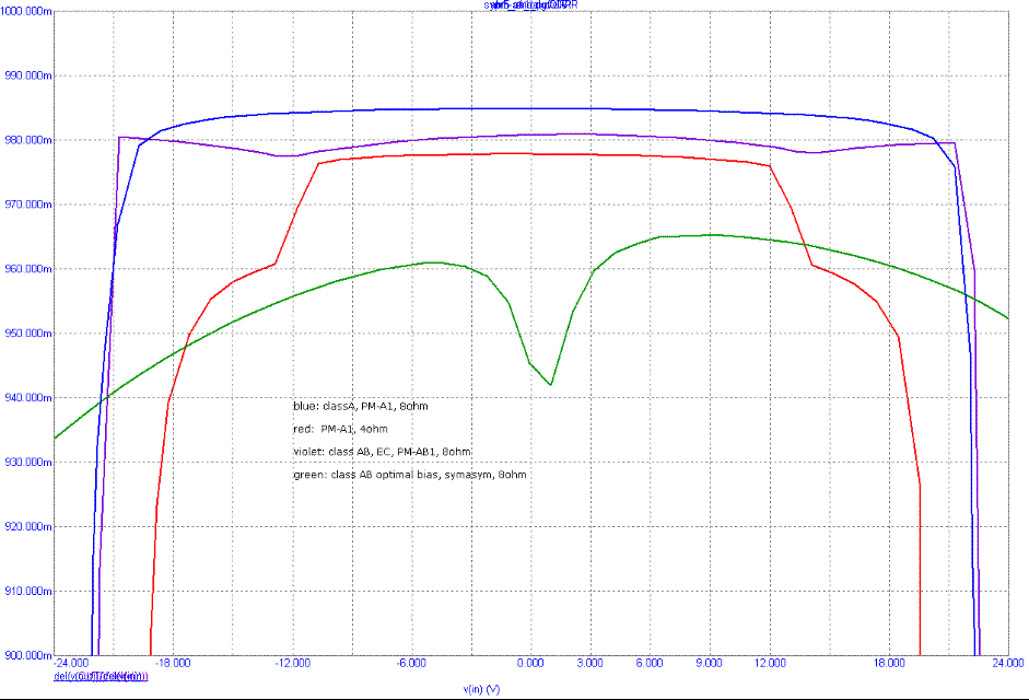

I will make these measurements on my class A design again and this time I will store them. I will make the same set on my class AB design with error correction, for comparison. The reasonable level of measurements would start at 100mVrms, i.e. 1.25mWrms into 8ohm load. I hope you will make some conclusion from my measurements 😀

I believe that the image I am attaching is saying similar information. These are transfer functions of several output stages that I have built and compared. These curves perfectly fit to listening test results of the amplifiers with those output stages and show importance of smooth transfer of smaller signals.

I am perturbed at how bad you have made Symasym (optimum bias ClassAB without error correction) look in comparison to ClassA.
Can you confirm Re and Vre for your test set up of the Symasym?

Is this a spice simulation?
Yes, it is. All of them are built and working, though.
Andrew, these are only ouput stages, without any global NFB. The symasym iddle current is about 40mA in this simulation. But, I operated it first at 150mA and then at some 500mA, after listening tests.
Class A is a CFP ("my" diamond buffer topology), much more linear, than 2EF.

These were ONLY output stages, not complete amps. NFB decreases and hides the non-linearities.
Just to add - the power supply voltage in those examples was 2 x 27V.
Well, what I am trying to say is, the proof is in the pudding - I am more interested in measurements on complete amps, regardless of how the nonlinearities are being taken care of. Of course the more linear to begin with, sans NFB, the better etc. But again, the proof is in the pudding of the final product.
IMHO to uncover kind of non-linearities before NFB application is very, very important. The most important reason for me is that the listening results correspond to these characteristics. I have done too many "standard" measurements on complete amplifiers that discovered nothing, so I do not rely on them.
