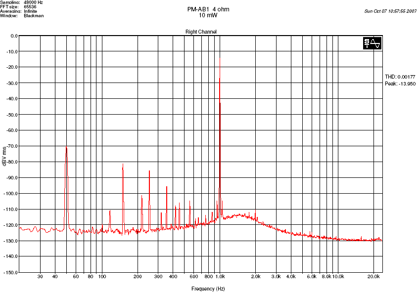

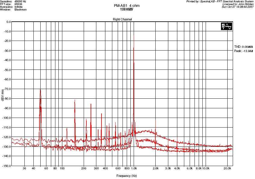

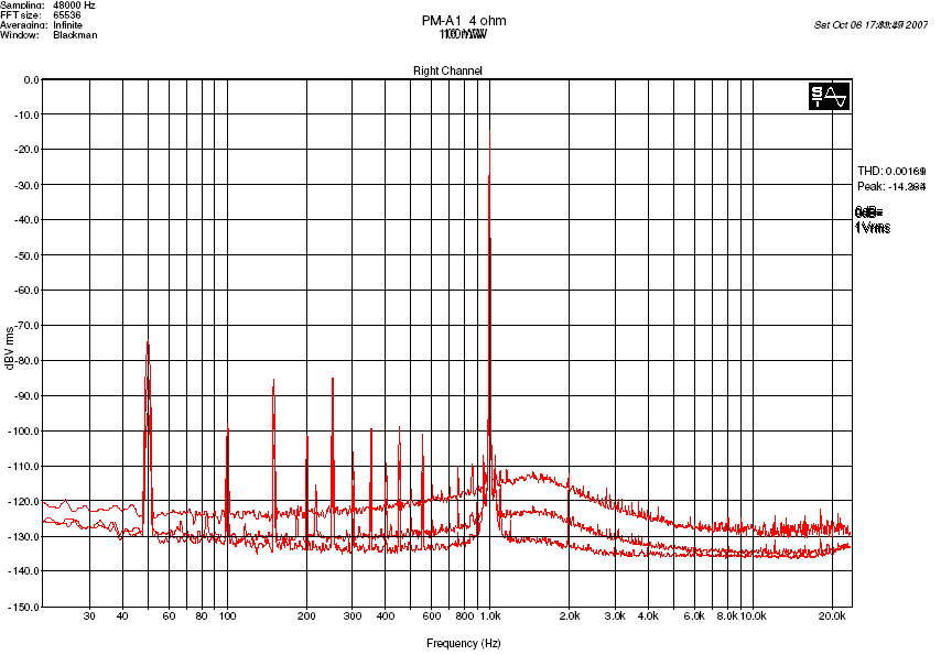

As promised, I made measurements at low power. Load was 4ohm, power 10mW, 100mW and 1W. I equalized measurements at same peak level, corresponding to lowest power, by means of a voltage divider. Peak level is always declared in plots.
For low powers, there seems to be generator contribution in noise floor modulation. Amplifier itself, wit input shorted, does not show such increase and modulation of noise floor, measured at same sensitivity.
The 1st plot is complete view at all the 3 measurements:

Well, i should be easy to distinguish generator effects from generator+amp effects, by measuring
- generator by itself into some input impedance similar to the amp's
- generator into the amp, signal off
Because it could also be the amp's reaction to generator input.

Generator itself was measured, but it is not the case. The amp has 27dB voltage gain and amplifies generator noise floor. This is not seen when measuring generator itself. The solution would be voltage divider at generator output.
But why is there noise floor modulation in the case generator+amp, but not in the case generator alone? The amp should amplify all noise equally no?
MBK said:But why is there noise floor modulation in the case generator+amp, but not in the case generator alone? The amp should amplify all noise equally no?
The dynamic range is different. You must set generator amplitude 27dB lower with amp. But there are further results.

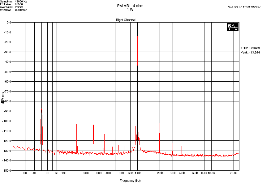

I am sorry but I made a fatal mistakes in the PM-AB1 measurements (posts no. 153,4 and 5). I forgot to switch on power supply of the LP active filter behind the generator, so all the distortion was from that.
Hereby the corrected image. You can see again modulated noise floor, this results from the active filter.

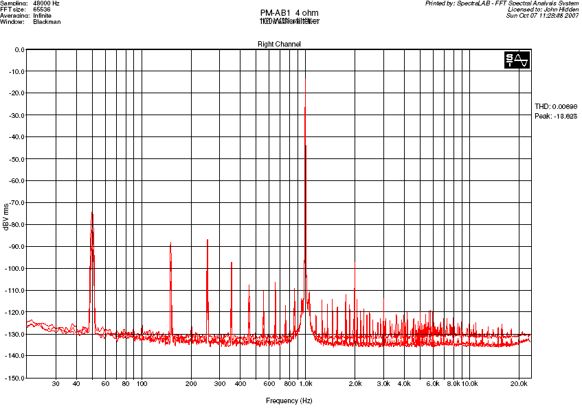

Mods,
thank you very much.
I can now repeat measurement without active filter. This will, however, insert some high order harmonics, as the generator output is not perfectly pure. But, it will remove noise modulation.
