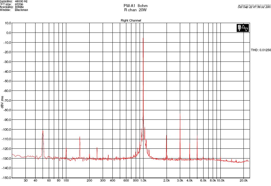

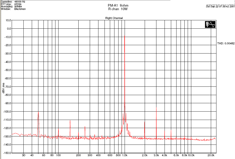

Andrew, try to magnify the image. At 20W,
2nd = -101dB (compared to 1st, 1kHz)
3rd = -79dB
4rd = -109dB
5th = -102dB
No higher harmonics measurable.
Max. is 30W/8ohm.
3rd = -79dB
4rd = -109dB
5th = -102dB
Max. is 30W/8ohm.

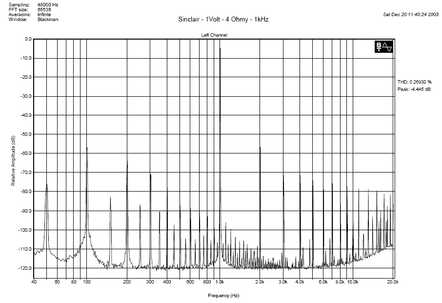

Hi
Earl, yes you are right of course. It was a simple 1 kHz stimulus just to show a reference for what can be achieved " normally "
PMA, can you provide a measurement of your soundcard alone to show its limits ?
Telling from the pics above it is also 24 bit with its noise floor around –120 dB.
For easy comparing I suggest the pics should be normalised to 0 dB stimulus and made in 20 dB steps like Earl did in his first one.
With SpectraLab you also should have the possibility to freeze several measurements in one print ( at least my version can do that ).
Greetings
Michael

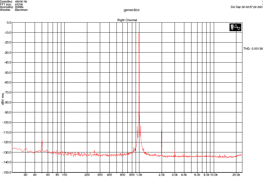

My measurement limit is like below. I use sine generator and -100dB/dec LP filter to remove generator harmonics. Generator without filter has 0.003% THD, but some harmonics up to 9th.
0dB here is 1Vrms. The card has fine distortion from -10dBVrms lower, it increases between -10dB and 0dB to some 0.0025%. For about -15dB, the distortion is about 0.0009%, that is my limit.
Dynamic range is up to some 135dB (for 64K record, this is important), but then the card distortion increases.
For the amplifier measurement, there was a voltage divider of some 26dB attenuation in front of the measuring card. The card input accepts no more than some 1Vrms and has low distortion up to some 300mVrms.
Is that a passive filter? 5pole if my sums are right?PMA said:My measurement limit is like below. I use sine generator and -100dB/dec LP filter to remove generator harmonics. Generator without filter has 0.003% THD, but some harmonics up to 9th.
How effective is it in reducing the measurable distortion, i.e. what does 0.003% become after filtering?
Any chance of a schematic?
It is the active filter. Sallen-Key. 2 blocks, 3rd order + 2 order.
But the 2nd harmonic component is most probably that of the soundcard. So I do not know the distortion of the generator + filter itself. Another image here, generator + filter + soundcard (my limit at -15dBVrms):

I have not stored such files. This is an OL true class A amplifier with very very low distortion. The distortion at levels under 1W is lower than my measurement limit, useless to save and show. And the amp does not create higher order harmonics up to some 8 - 10W.
I measured something like 0.0004% at 125mW on another equipment. Again, limit of the method used. And nothing else than the 2nd or 3rd.

Hi
Excellent setup PMA !
Best I can do is also a roughly 110 dB harmonics but to achieve that I have to balance BOTH output and input levels of my soundcard. Which means I can EITHER have low harmonics OR low noise floor.
No extra filter in between though.
Averaging is 50 for all
Earl, do you think I can get measurement below the limits above with your method ?
Greetings
Michael
