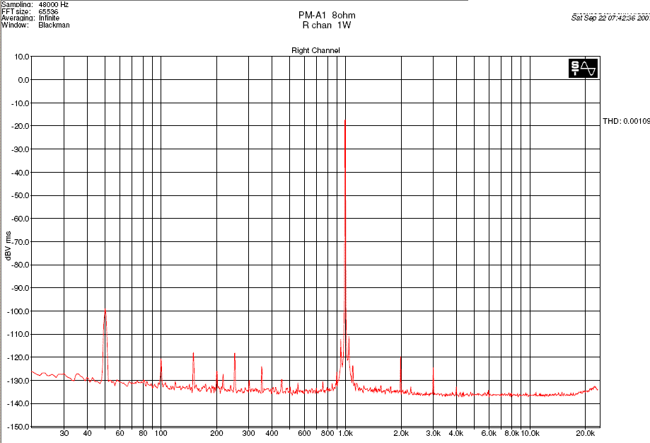

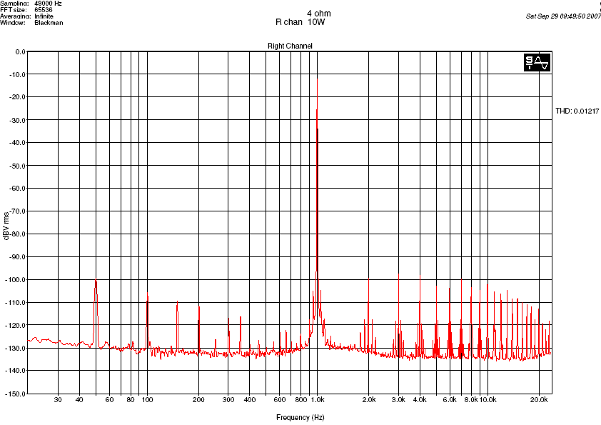

PMA said:This is what I get from class A amp at 1W/8ohm. It is considerably less distortion than Ayre or Pass. And only 2nd and 3rd components. It does not have global NFB. Would it sound better, or worse than Ayre and Pass? 😉
I'd have to see the spectrum at several output levels along with a comparison with these other amps using the same test.
Your test appears to be at a pretty high output level since the noise floor is so far down.
No, it is at 1W/8ohm. You have to read 1st harmonic level, which is at about -17dB of Y axis. I can provide you set of mesurements from 1W to 25W, no problem.
