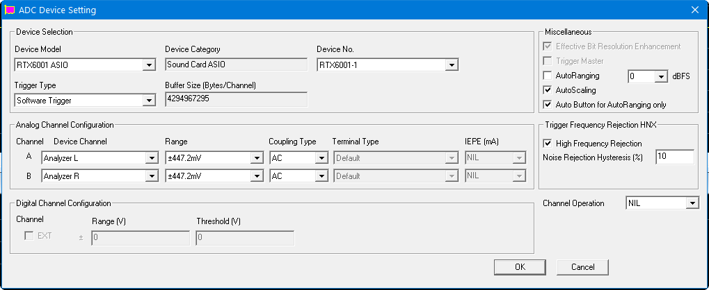

Techland, can you repeat this test with 24bit and compares RTX6001 and AP?
I saw a big difference (680ps vs 260ps) in a dac btw 16-24bit measurement on our RTX.
Also the lower limit of 2.21 ps with the 48 kHz 24 bit test signal, perfectly transmitted digitally (zero jitter), seems questionable. It should be 0...

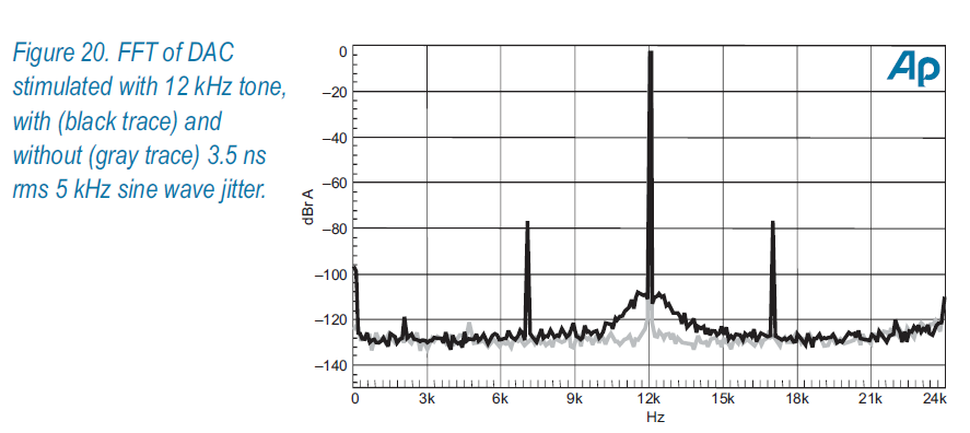

The above formulae can be derived from phase modulation. There are also good references on the internet such as:
1.Audio Precision Application Note #5: Measurement Techniques for Digital Audio.
2. ADI, Converting Oscillator Phase Noise to Time Jitter

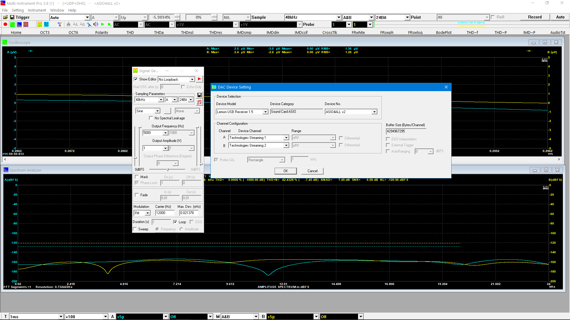

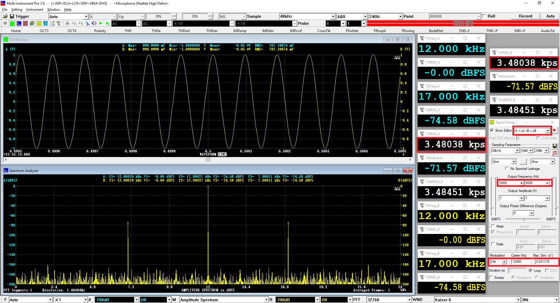

One test example of the above Jitter Measurement Panel Setting
The signal generator of MI supports phase modulation. It is thus handy to simulate a jitter signal with a known frequency and amplitude and then measure them against the theoretical values as well as other reliable references such as those from AP.
The relationship between the max. phase deviation (in degree) and RMS jitter level (in second) can be derived as follows:
A pure sine wave signal can be written as: y(t) = sin(2 * pi * fc * t). If jitter presents, it will be phase-modulated by the jitter signal as follows:
y(t) = sin(2 * pi * fc * (t + Jpp / 2 * sin(2 * pi * fj * t)))
where fc is the carrier frequency, fj the jitter frequency, Jpp the peak-to-peak jitter.
The max. phase deviation (in radian) is then: 2 * pi * fc * Jpp / 2 = pi * fc * Jpp
The max. phase deviation (in angle) is then: fc * Jpp *180 = fc * Jrms * 2.828 *180 = 509 * fc * Jrms (degree), where Jrms is the RMS Jitter level.

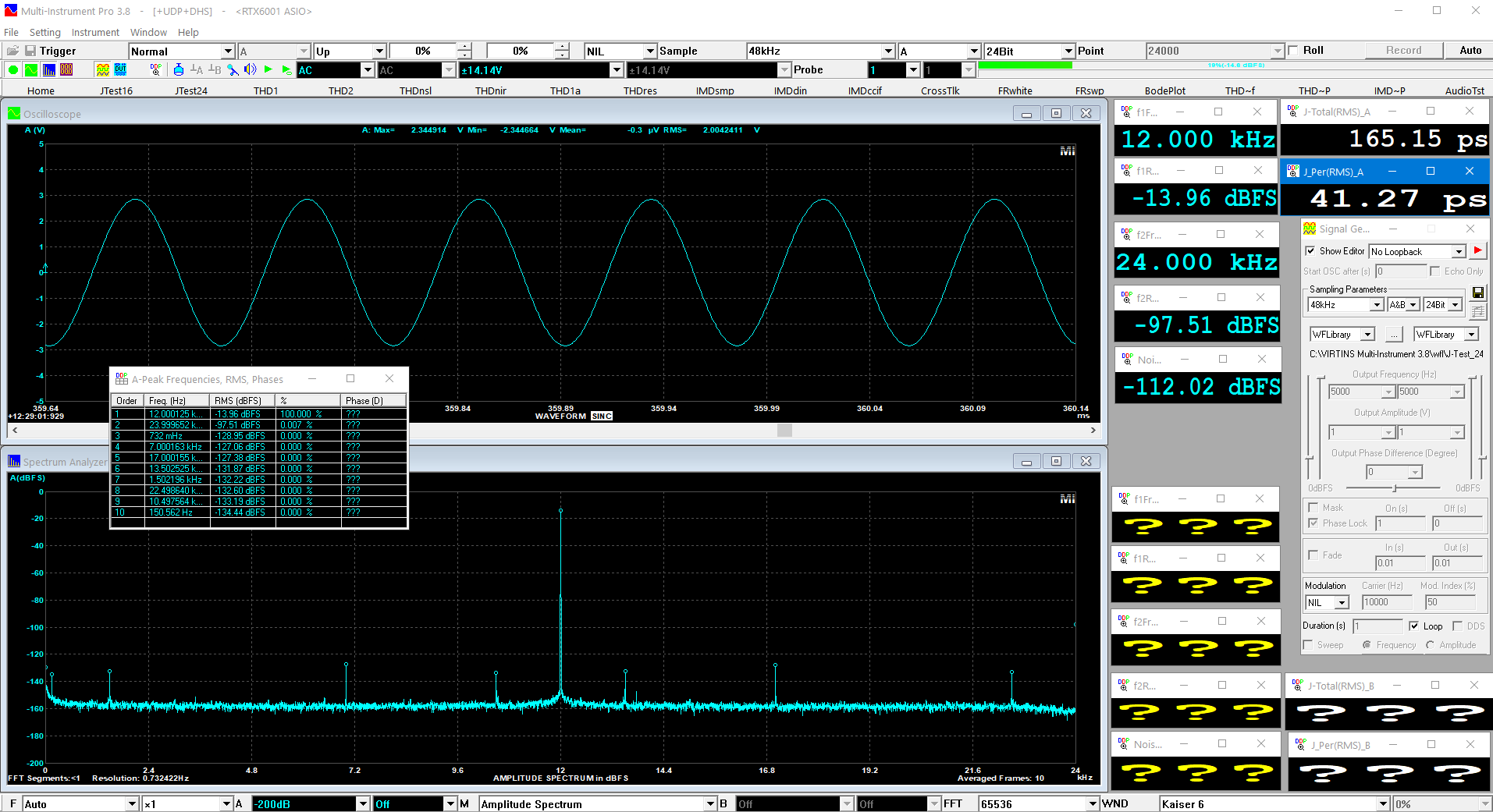

Now, let’s generate a 12kHz sine wave signal that is phase-modulated by a jitter frequency of 5kHz and a RMS jitter level of 3.5ns (i.e. 509 * 12000 * 3.5 * (1E-9) = 0.021378 degree), and sampled at 48kHz, 24 bits. MI is set to software loopback mode "iA=oA, iB=oB".
It can be seen from the attached screenshot, the measured RMS jitter level is 3.48ns, which agrees well with the theoretical value. You can also find the same simulation from Fig. 20 in Audio Precision Application Note #5: Measurement Techniques for Digital Audio (see attached picture from this AP document, the document download link can be found in the above post).
By the way, ordinary phase modulation generates multiple pair of sidebands. Jitter level is usually very small compared with the test signal period. So only the highest sideband pair becomes prominent in the spectrum. This make it look like amplitude modulation.

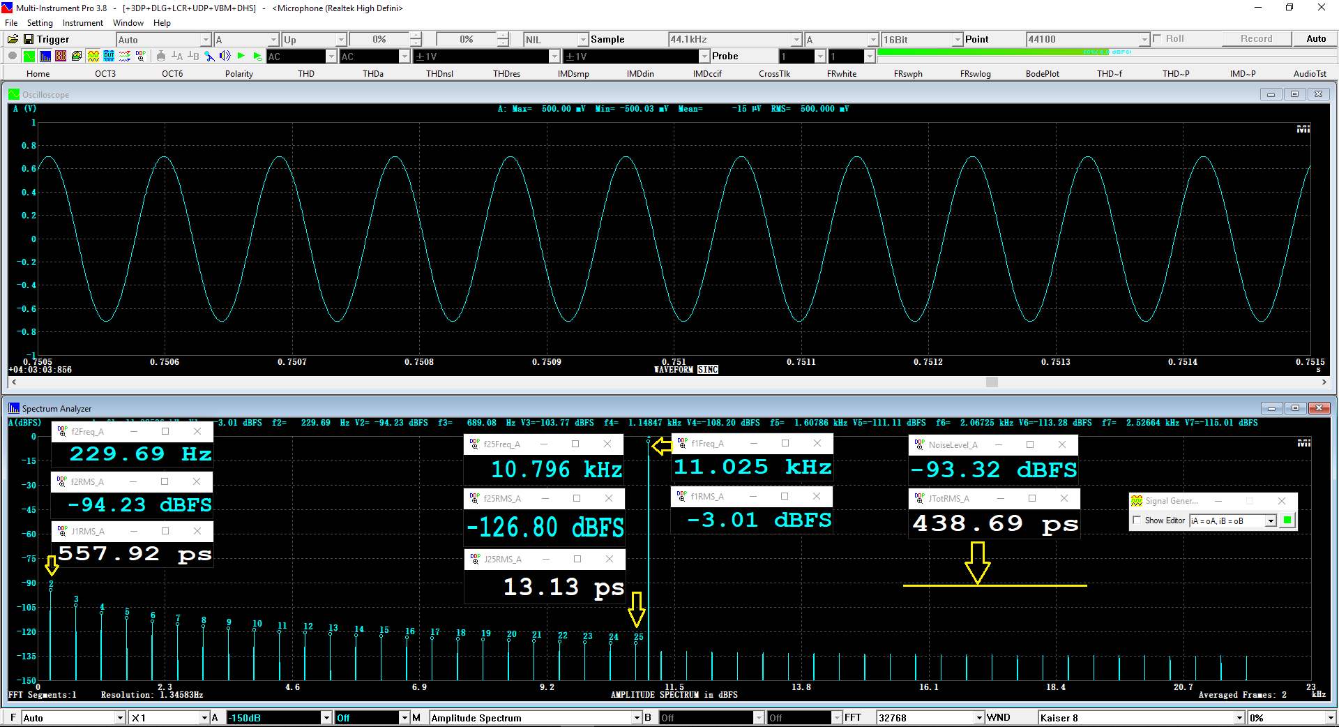

For example the Miller measures the 16 bit JD test signal at around 120 ps, but that is peak to peak! Using the above new J-Test psf at 44.1 kHz, your MI measures them at around 620 ps rms, which equals a whopping 1753 picoseconds (digital to digital test, bit-perfect).
Thanks for this information. I have done a search on the internet and found that the 120 ps you mentioned probably came from this stereophile article “A Case of the Jitters”. I quote the relevant description in the article as follows:
“However, the NI cards that are the basis for the Miller Analyzer use 16-bit A/D converters. Although the Miller software uses extensive signal averaging to lower the contribution of these converters' self-noise, it limits the system's resolution to around 120 picoseconds of jitter, which is higher than the jitter of the very best digital audio products now available. “
The lowest measurable RMS jitter “120 ps” above is due to the noise level of the hardware, not the total residual RMS jitter of the 16-bit JTEST signal itself. The apparent wideband noise level can be brought down by increasing FFT size (together with Record Length) in order to make those submerged periodic jitter sidebands to show up. It looks like that “120 ps” is limited by the max. FFT size supported. Just a guess...
Although the total residual RMS jitter of the 16-bit JTEST signal sampled at 44100kHz is 439 ps (see attached). It does not mean the lowest measurable RMS jitter is 439 ps. Attached screenshot illustrates this idea. The residue will only hide about 13 ps RMS jitter sidebands located exactly at the place of the residual sidebands. Although the left most residual sideband has a RMS jitter level of about 558 ps, but the right most "pairing" residual sideband has a RMS jitter level lower than 13 ps. Therefore, any periodic RMS jitter level higher than 13 ps will still show up even if they overlap with the residual sidebands. In this screenshot, the apparent noise level is below 150dB in between the residual sidebands, leaving a plenty of head room for random and periodic jitter to show up.

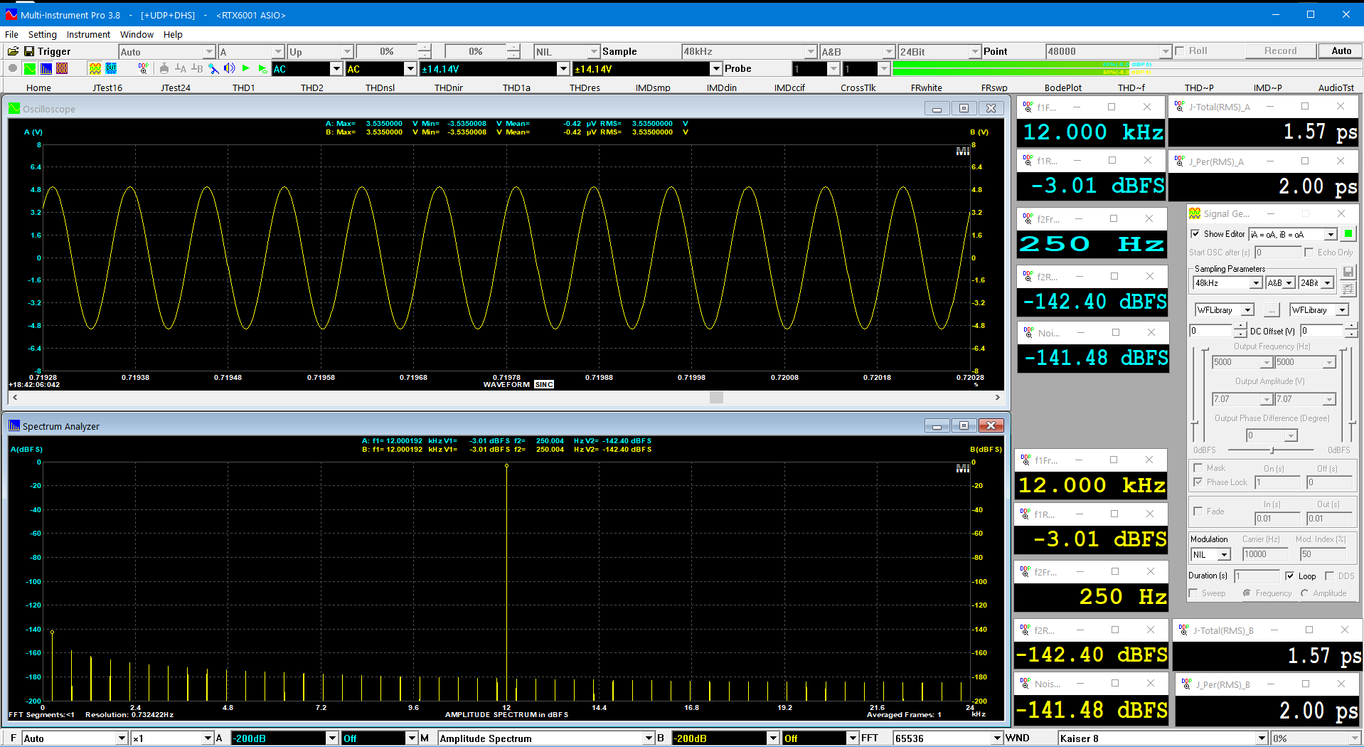

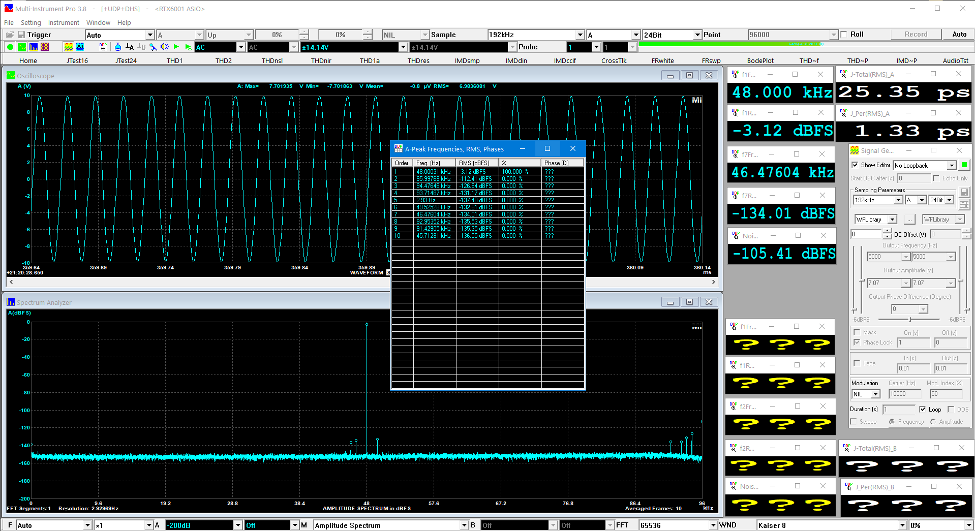

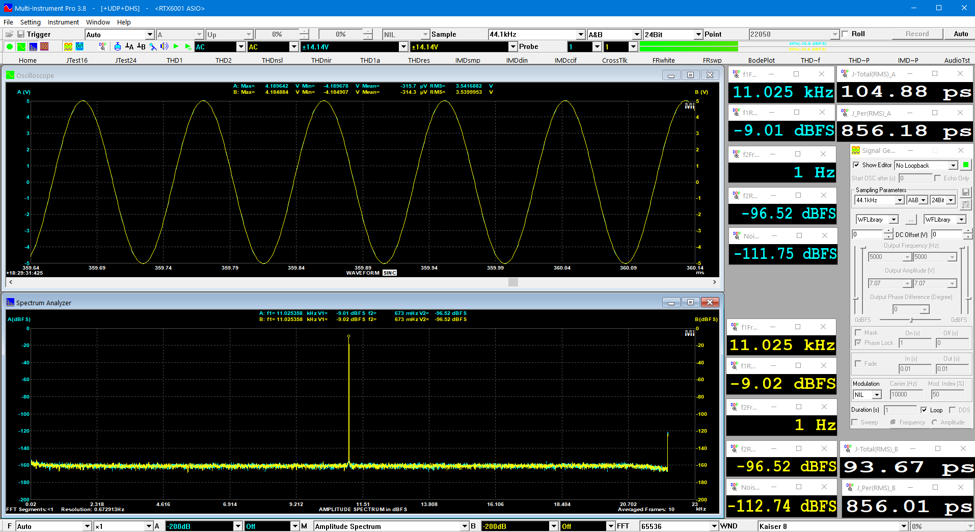

I tried to understand well all of these Virtins' information and take a little time to apply them.
Here three attachments, the first and second was an internal RTX loopback (24bit) at 44.1K & 192K sampling.
There is no zero measurement, but the 192KHz wants a little to be perfect.
Another, is that the f2Freq was the 250Hz for the 48KHz sampling and 1K for the 192KHz sampling.

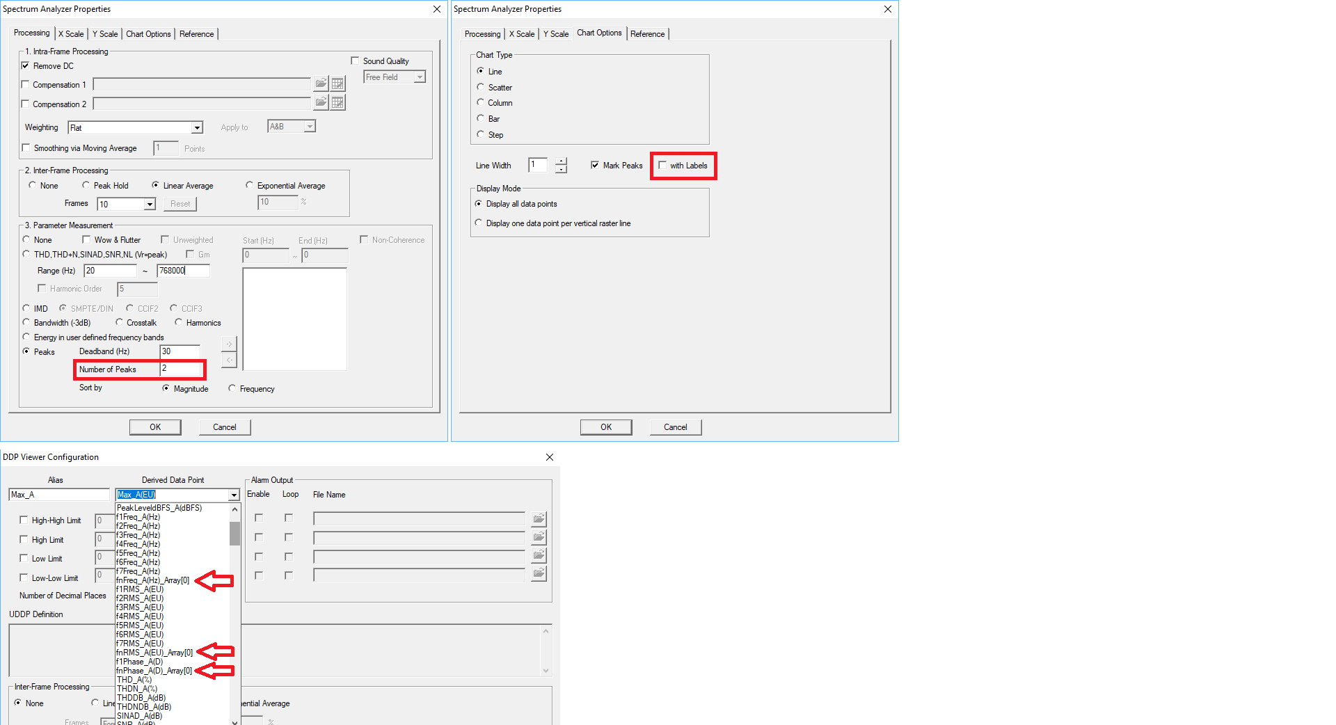

I can't to find the way to measure the exactly sideband of the fundamental freq. I tried with the F3...fn but the software count other freq.
Then I tried with the external RTX loopback with SE->XLR connection, this is the third capture, the bigger Periodic Jitter due to 2nd freq. measurement that was the peak of 673mHz.
I tried to decrease the X-Axis with the mark of "Start with 20Hz" but it hasn't worked, the same with the 20-20000Hz range.
The search for the second peak done all over the X-range and you can not to set it to a limit range.
I think, it would be very useful to can manually limit the X-range that the software search for the second peak.

I catch at this capture the side peak of the 48KHz.
I saw that the 46KHz side peak was the 7nth peak from the DDP Array and I replace the 2nd freq. with the 7nth freq. at the Per.Jitter measurement formula.
A 1.33ps was the Periodic Jitter approximately.

Am I wrong or something has gone from my mind ?
From this point of view, with this method can't we to test how jitter correction the specific DAC can be?
For example, I open two MI instants, the first plays the signal as the Virtin's signal example at the post #507, via my usb receiver (Arta4all driver) without ADC capturing enabled, the second MI instant has the role of ADC capturing that is the output of a specific DAC with anti-jitter technology, without generator enabled.
At the 2nd instant, this of Jitter measurement, I see that the Periodic jitter (modified measurement -> 4th peak, as the example) is a much less (almost 40ps) a far away from the input.
I agree that we giving a signal with a specific content but some DAC manufacturers claim that their own DAC's have an anti-jitter technology inside.
Every SD-DAC has. Additionally some DACs have anti-jitter technology for external clocking, like via SPDIF or AES (for USB you don't need that, it runs on internal clock). Either in the chip itself (ESS) or externally in the clock circuits.
No, because that requires you to modulate the SPDIF input, or internal clock that drives the DAC.
At the 2nd instant, this of Jitter measurement, I see that the Periodic jitter (modified measurement to the side peaks next to 12KHz) is a much less (almost 25-30ps) a far away from the input.
I don't understand your example. And to see a DAC signal in MI you need an ADC, whose exact jitter behaviour is unknown to you...
You have right that I haven't used a SPDIF.
Also, I am looking more carefully at the Virtins' example and I have done a terrible error in my example.
I haven't use a PM Modulation but a FM! Completely wrong all my example!
From your later posts, it looks like that you have already found the way to pick the correct frequency, amplitude, and Phase DDPs of any peaks. Here is the summary (see attached):
1. To put the spectrum analyzer in peak detection mode, right click the spectrum analyzer and select [Spectrum Analyzer Processing]>”Parameter measurement”>”Peaks”. You can specify the Deadband (minimum distance between two peaks in Hz) and number of peaks (up to 100) to detect. You can also specify whether these peaks to be sorted according to magnitude or frequency. These peaks can be labelled automatically if you right click the spectrum analyzer and select [Spectrum Analyzer Chart Options] and tick “Mark Peaks” and “with Labels”.
2. You can access the frequency and amplitude DDPs for the first seven peaks via f1Freq_A(Hz) ~ f7Freq_A(Hz), f1RMS_A(EU) ~ f7RMS_A(EU).
You can access the frequency, amplitude and phase DDPs for all the peaks via DDP arrays: fnFreq_A(Hz)_Array[0], fnRMS_A(EU)_Array[0], fnPhase_A(D)_Array[0]. Replace “[0]” with the array index which starts from zero. For example, if you want pick the 99th peak, replace"[0]" with “[98]”.
You can use the frequency compensation function of the spectrum analyzer to do that. For example, if you only want to detect the peaks within 20Hz ~20kHz, in the frequency compensation file ( a CSV text file), enter the following two lines:
1,20,0
2,20000,0
Which means that 20Hz gains 0dB and 20000Hz gains 0dB, and the software will perform linear interpolation in between automatically. Outside the range defined by the first line and last line, a gain of -1000dB will be assigned by the software. Please refer to Section 3.3.2.8.1.2 of the software for details.
