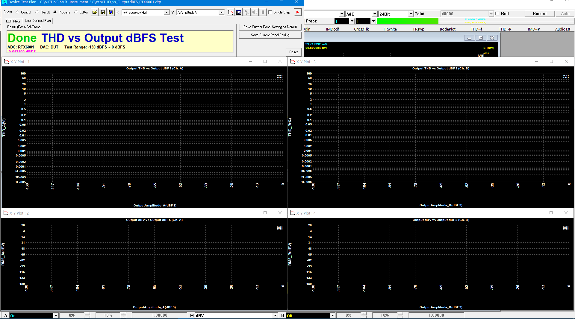

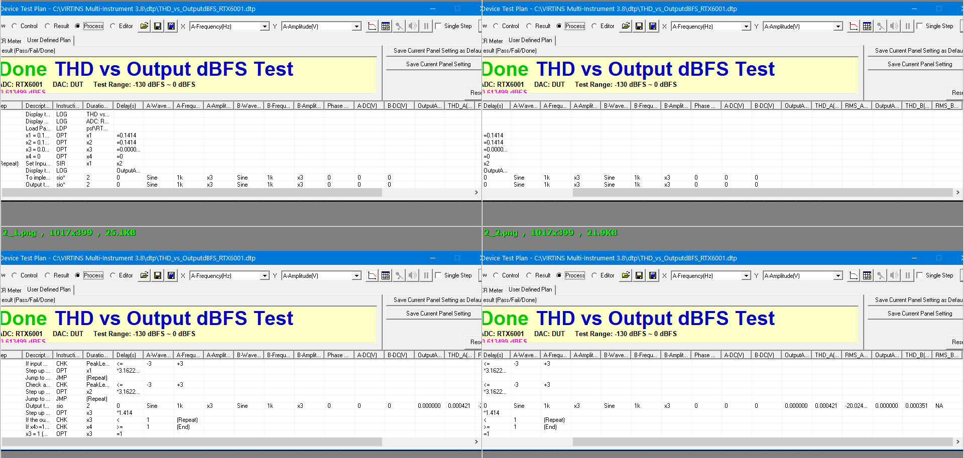

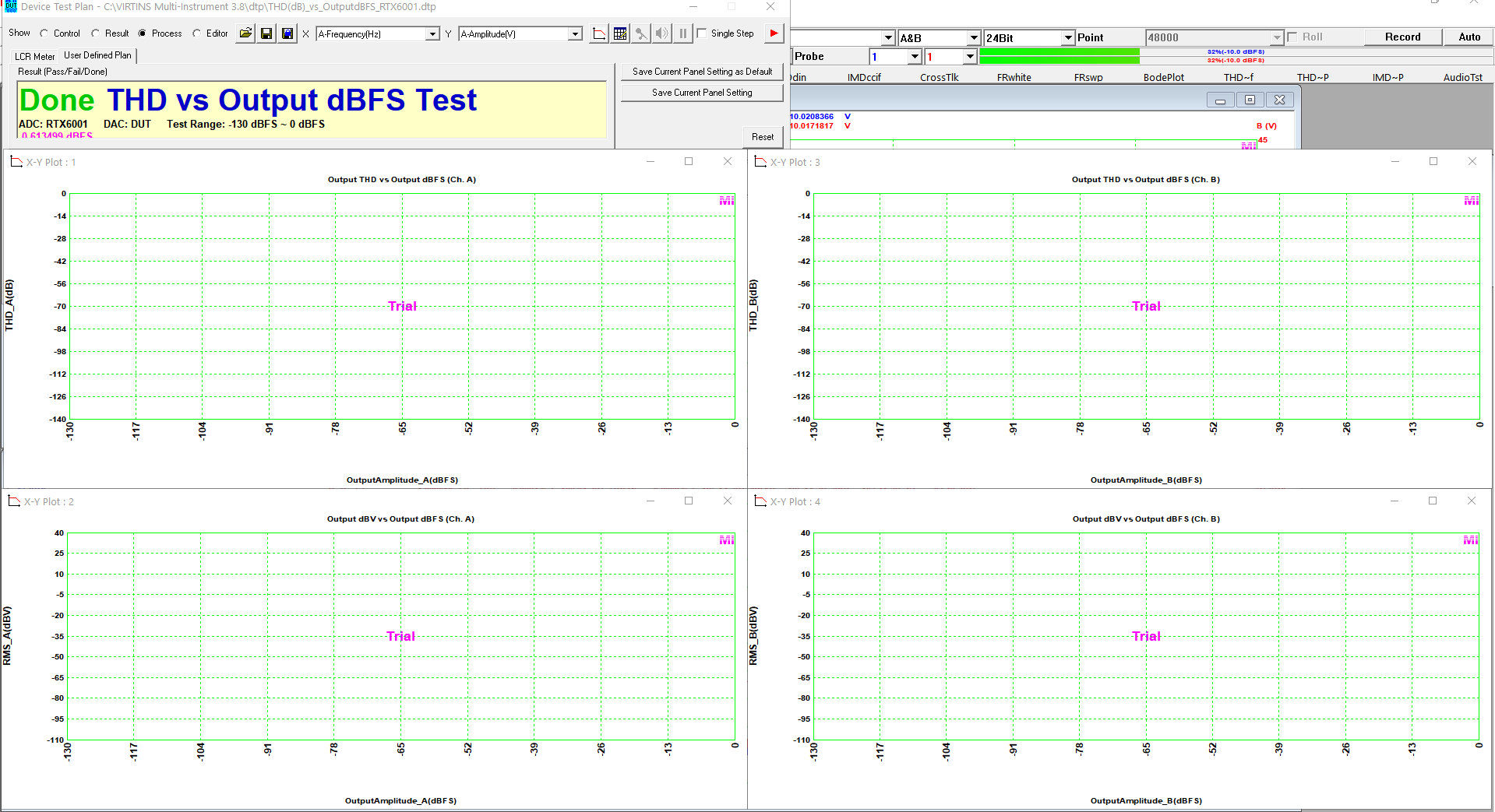

I tried the test of 536 post but I have a problem that I make me to laugh!
The test is Done but I haven't any graph on Display!
Here the screen captures.
What I have wrong?

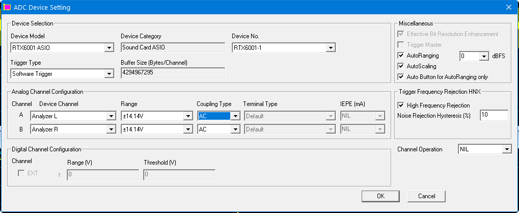

You can use [help=>[About] to check whether you are using V3.8.5.2.
Also, do not tick "Auto Ranging" and "Auto Scaling" in [Setting]>[ADC Device]. "Auto Ranging" is done within the script in Device Test Plan. Just use the default setting.]%[/help]
I had already installed the V3.8.5.2
I tried without "Auto Ranging" and "Auto Scaling" in [Setting]>[ADC Device].
I had a suspicious that correlated with my MI-Pro package, for this reason I tried and with trial version that including everything.
The relays click OK, the ADC varies OK but...
Unfortunately, same behavior.
Is there any other member with success?

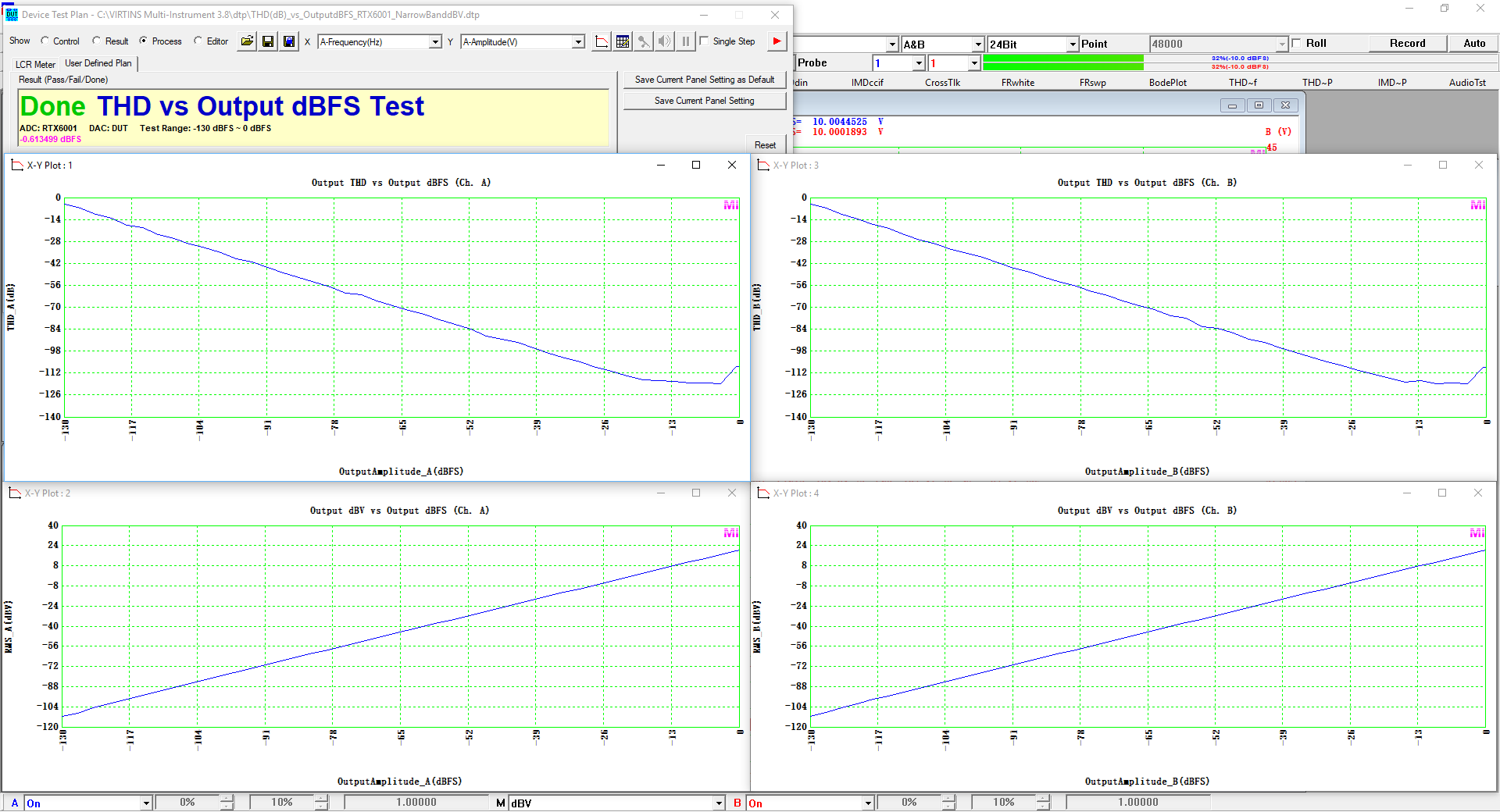

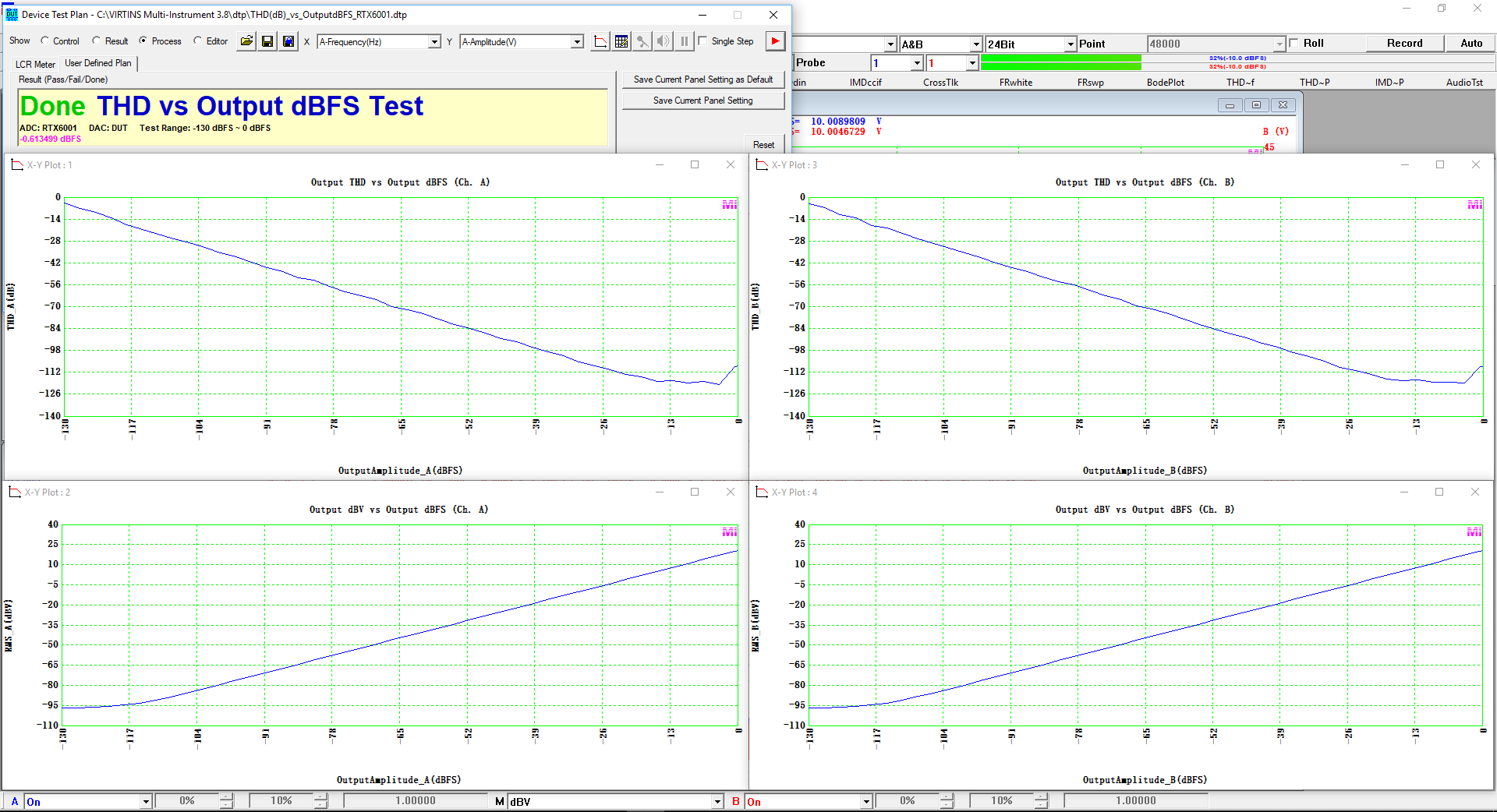

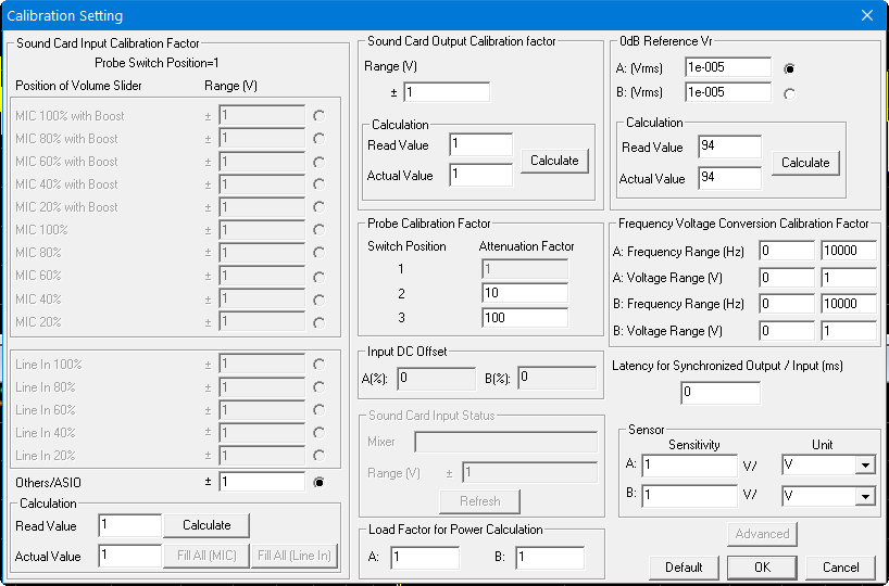

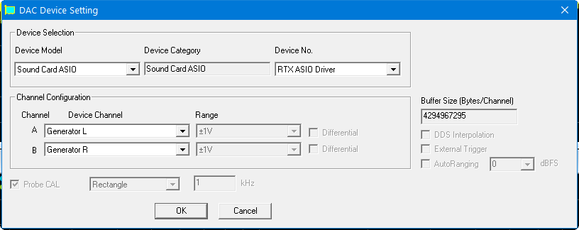

The function "THD vs output dBFS" and "Output dBV vs Output dBFS" is now available in V3.8.5.2. You can load the Device Test Plan named "THD_vs_OutputdBFS_RTX6001.dtp" to perform the test. It can be used to measure a DAC using RTX6001's ADC. This device test plan is configured using variables and is able to perform RTX6001 input autoranging based on -3 dB criterion. The step from -130dBFS to 0dBFS output is also configured as 3 dB. There are only 20+ test steps in total. So these parameters can be easily found and modified.
Please note that in this test plan:
1. [Setting]>[ADC Device]>"Device Model" should be set to "RTX6001 ASIO" or "RTX6001 MME".
2. [Setting]>[DAC Device]>"Device Model" should be set to "Sound Card ASIO" or "Sound Card MME" and the DAC under test should be selected in "Device No." selection box.
3. [Setting]>[Calibration]>"Sound Card Output Calibration Factor">"Range (V)" should remains as "±1V" (the default value). It is used as the 0 dBFS reference in this test plan.
The following is the test result of RTX6001's own DAC @20dBV. (It was switched to the 20dBV gain setting when [Setting]>[DAC Device]>"Device Model" = "RTX6001 ASIO". After that, let [Setting]>[DAC Device]>"Device Model" = "Sound Card ASIO" and "Device No." = "RTX ASIO Driver"). During this test, the input range of RTX6001 will automatically changed from ±141.4mV to ±44.72V as the output dBFS steps up from -130dBFS to 0dBFS.

I am OK now, I had to uninstall and reinstall the MI-Pro.
THD vs Output diagram and DAC Linearity are very useful DAC tests.
I think that the DAC Section has completed.

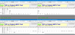

The bottom right process window in your Post #544 shows that the data for OutputAmplitude_A(dBFS), THD_A(%), RMS_A(dBV), OutputAmplitude_B(dBFS), THD_B(%), RMS_B(dBV) are 0, 0.000421, -20.024, 0, 0.000351, NA respectively. The "NA" is the problem. You can move the DTP window and X-Y Plots aside in order to show the oscilloscope, spectrum analyzer and multimeter windows behind and find out why the RMS_B(dBV) is not available. It should be shown in the multimeter window.
@lemon
Glad to know the problem has been solved. I did not notice that you have already solved it.
Yeap, the problem is solved 🙂

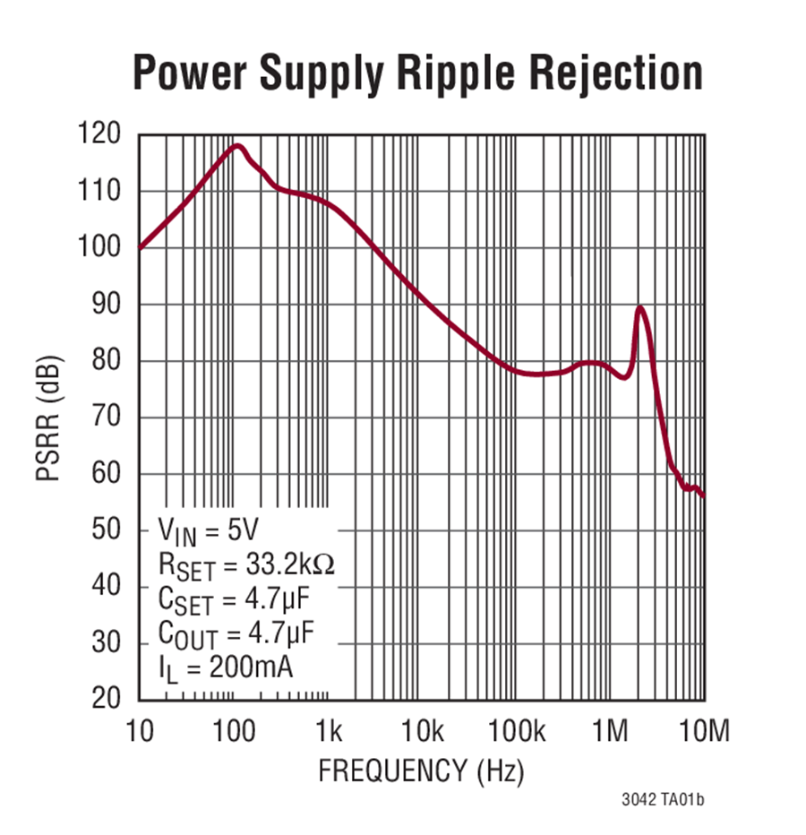

The real limitation for these measurements is the 95 KHz max frequency of the RTX or almost any soundcard. The plot you show with a 2 MHz bump shows a potential problem with stability at that frequency which should be addressed.

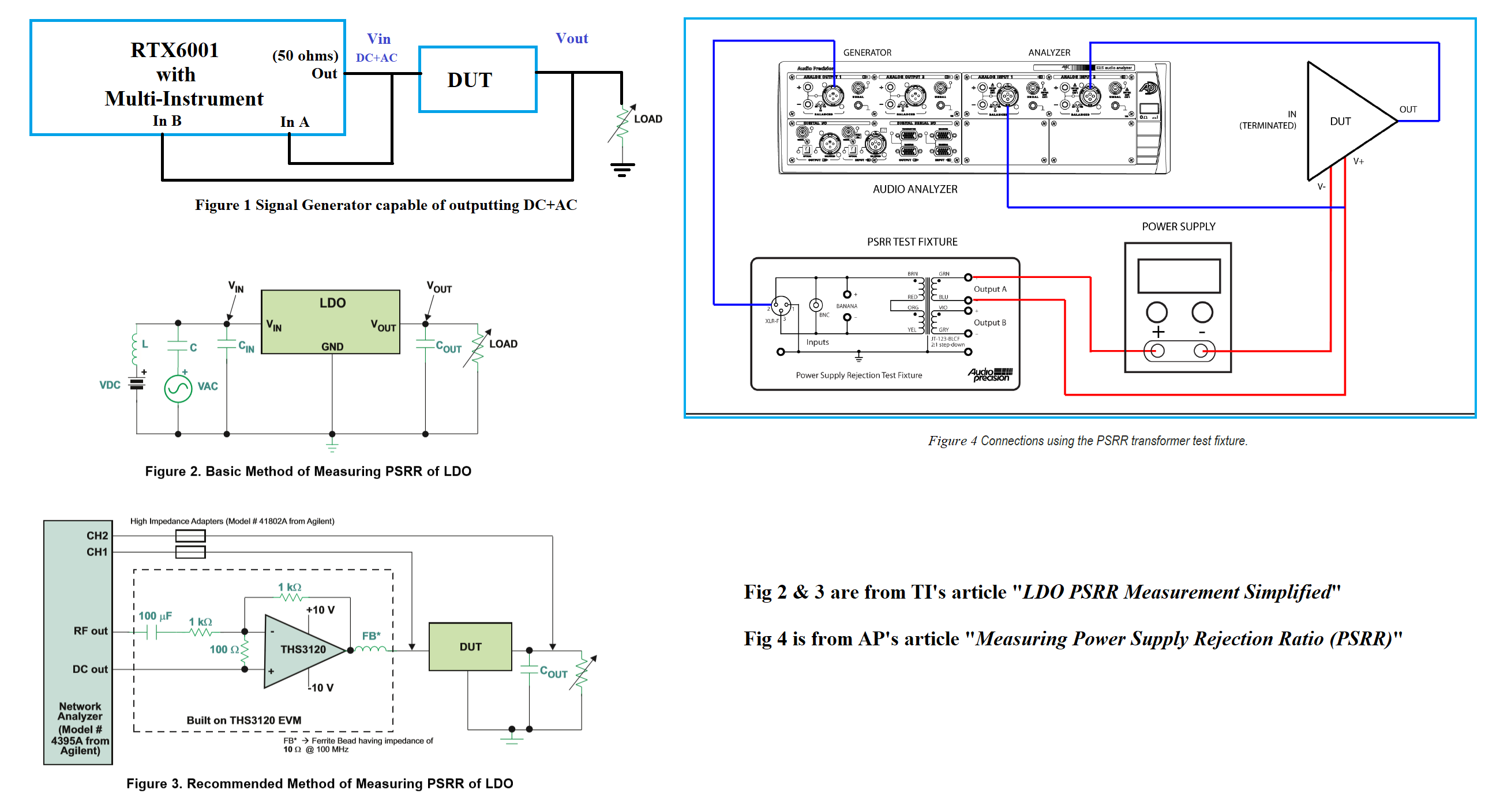

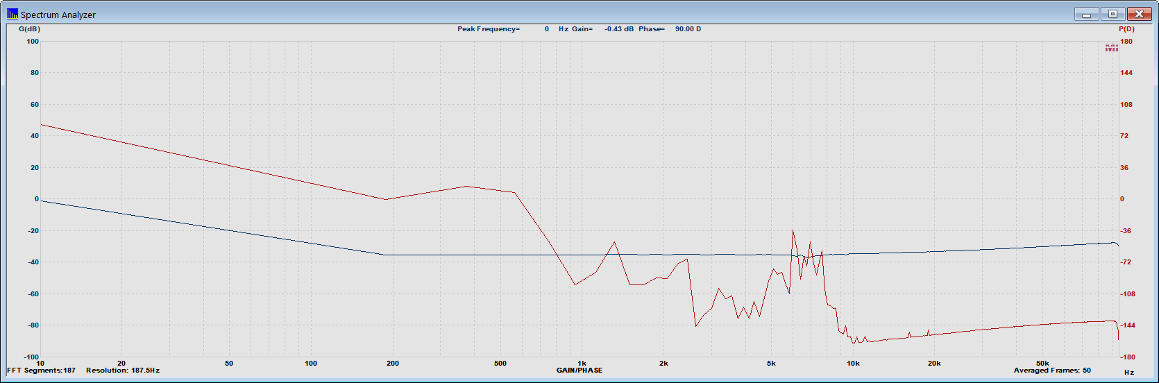

PSRR disturbing AC voltage injection methods
The power supply Zo & Phase measurements completed previously inject the disturbing AC voltage to the power supply's output, whereas in the power supply PSRR tests here, the disturbing AC voltage should be injected to the power supply's input.
The attached picture shows four methods to inject the stimulus. Figs. 2&3 are extracted from TI's article "LDO PSRR Measurement Simplified" at
http://www.ti.com/lit/an/slaa414a/slaa414a.pdf. Fig. 4 is from AP's article: "Measuring Power Supply Rejection Ratio (PSRR)". Fig. 1 is simple but with a limited output current and voltage.

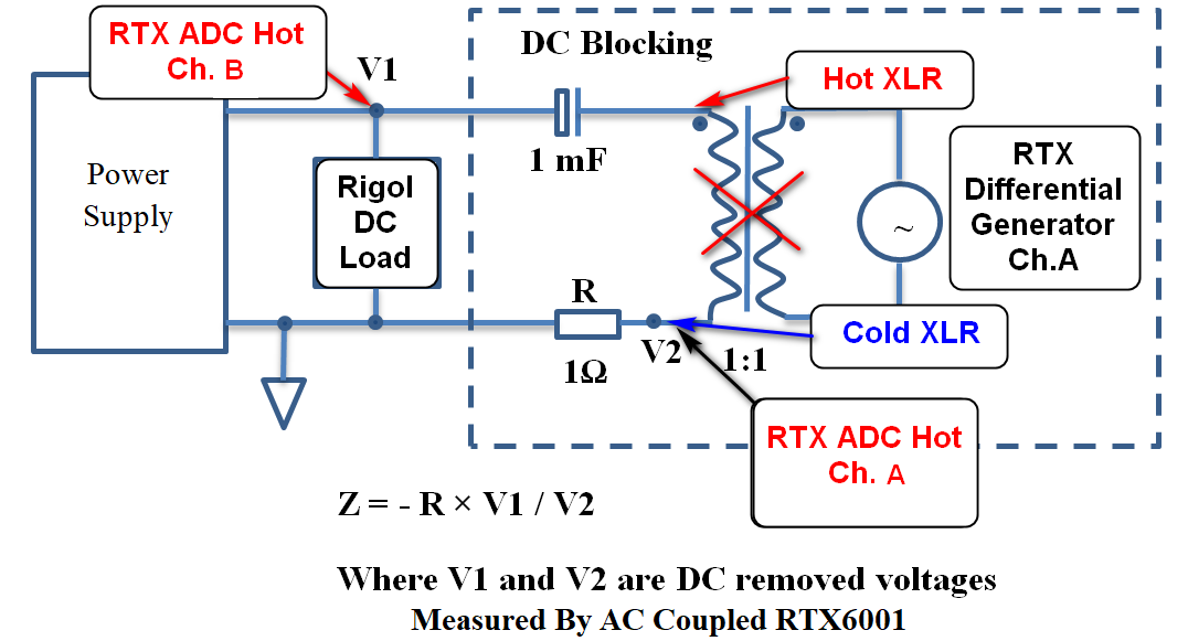

in the PSU Bode Test can I used the diagram that we used at the Zo & Phase measurement (as the attachment)?

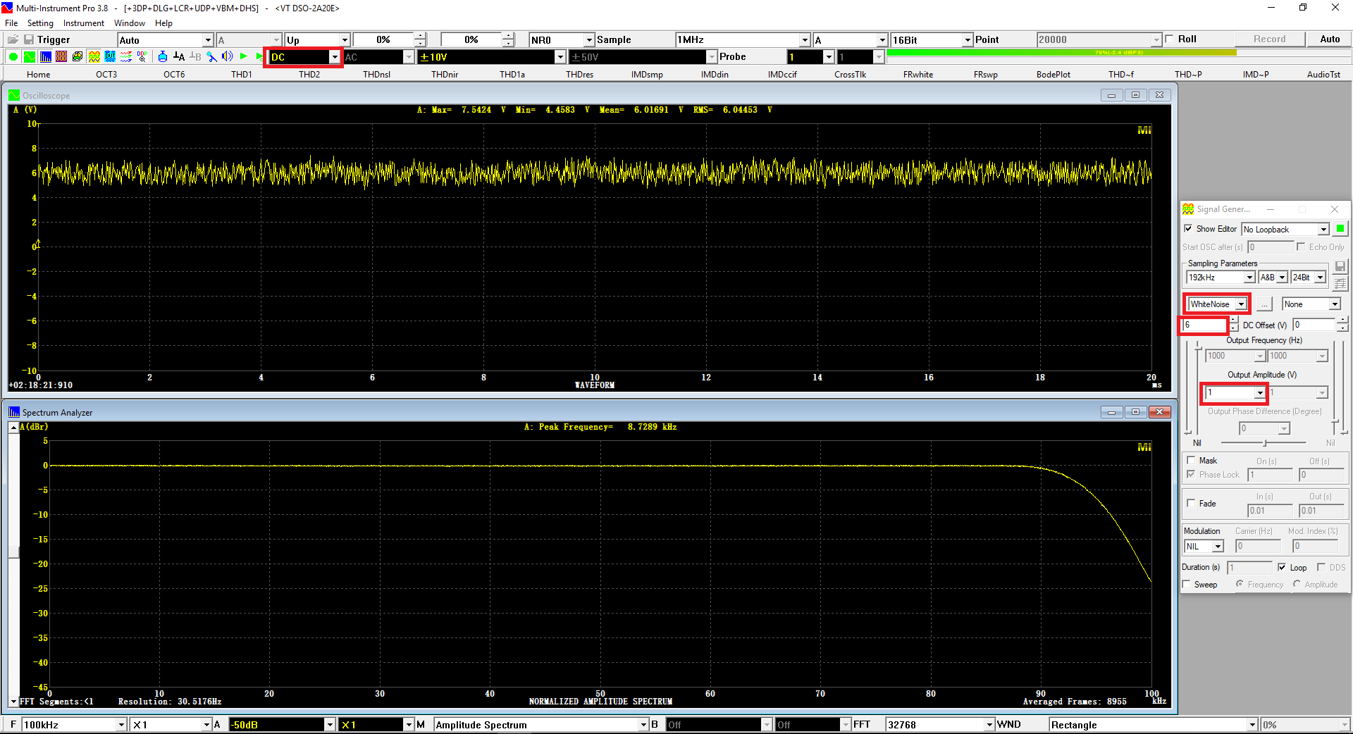

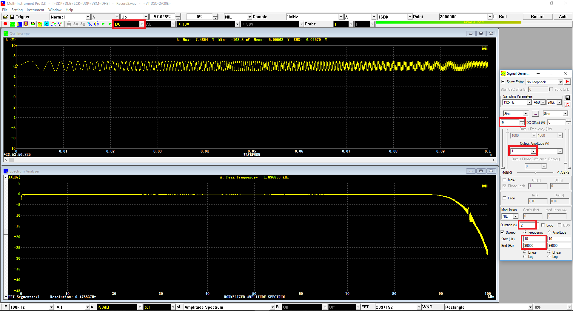

Post #555 showed an example of outputting 6 VDC + 1 VACpeak (1kHz) by RTX6001. The signal can be used as frequency stepped sinewave excitation through Device Test Plan in Method 1 described in the above post .
The signals in the following two examples can be used with the Bode Plot function in Method 1.
(1) 6 VDC + 1VACpeak (white noise) output by RTX6001 and measured by VT DSO-2A20E
(2) 6 VDC + 1VACpeak (10Hz~96kHz linear frequency sweep) output by RTX6001 and measured by VT DSO-2A20E
Both graphs actually reflect the frequency response of the RTX6001 signal generator.
