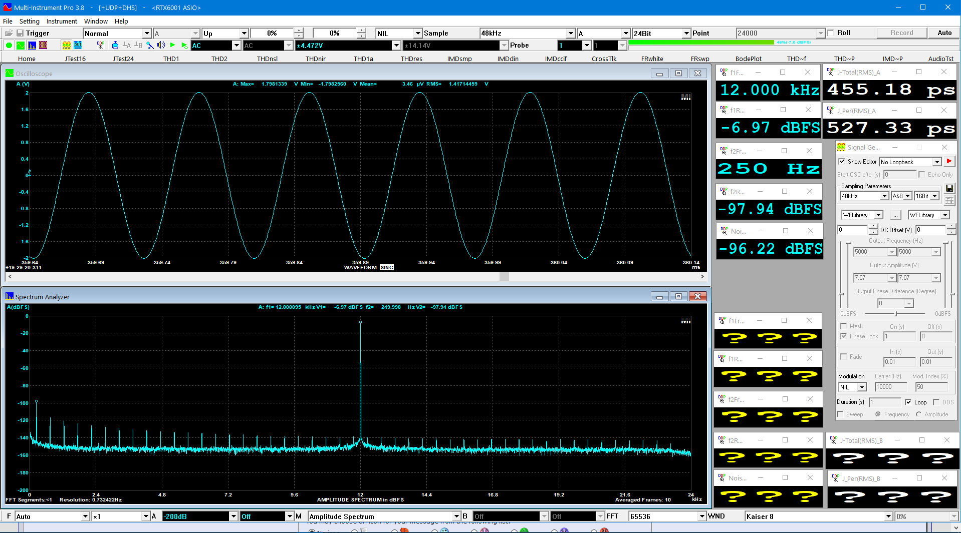

At the J-Test 16bit is that properly to set the ADC to 16bit or 24bit?
The following result was came with Altor JG-384 signal generator as the role to source, set to 48KHz J-Test 16bit (12KHz/0.25KHz) @ 0dB mode and the connection was the DAC via the Optical SPDIF connection.
The analogue output of the DAC input to the RTX ADC and the capturing was to 16bit and 24bit.
I see at the 24bit ADC capture due to lower noise floor that the residues peaks are more "true" to measuring.
Is that some kind of trick that helping to us or it was a lucky moment?

The lower noise floor from the 24 bit capture does show more details. I see no clear jitter artifacts in that plot. Certainly nothing to justify a 400 pS jitter measurement.
A 24 bit test from the Altor won't show the LSB on any DAC I have encountered. The LSB is below the noise floor on all of them. The Altor is a great tool. I recently used it to make some test files that I had confidence in.

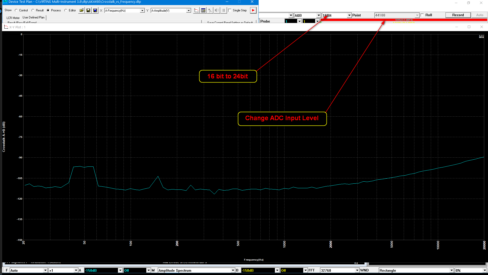

I need to change the parameters of the Crosstalk vs Frequency Test.
Look at the attachment:
1) from 16bit to 24bit
2) another ADC Input Level
I looked inside the "Crosstalk_vs_Frequency" dtp file with notebook, but only the way to change the resolution and output can find.

For anyone that interesting about it, here the information about it.
At the /dtp folder, there are all the DUT tests, here is located the Crosstalk_vs_Frequency.dtp file.
At the first lines of this file, there a path for appropriate .psf file for this testing, note the path.
At the /psf folder, locate the above .psf file that Crosstalk_vs_Frequency.dtp opens.
Open this file via MI software and do the appropriate changes that you want (level, bit, e.t.c), then save it with the a new name.
Then open the Crosstalk_vs_Frequency.dtp file with notepad or another text software and change the path of .psf file with the new one.
That's all
With same way, you could to change and the others .dtp files like Crosstalk e.t.c

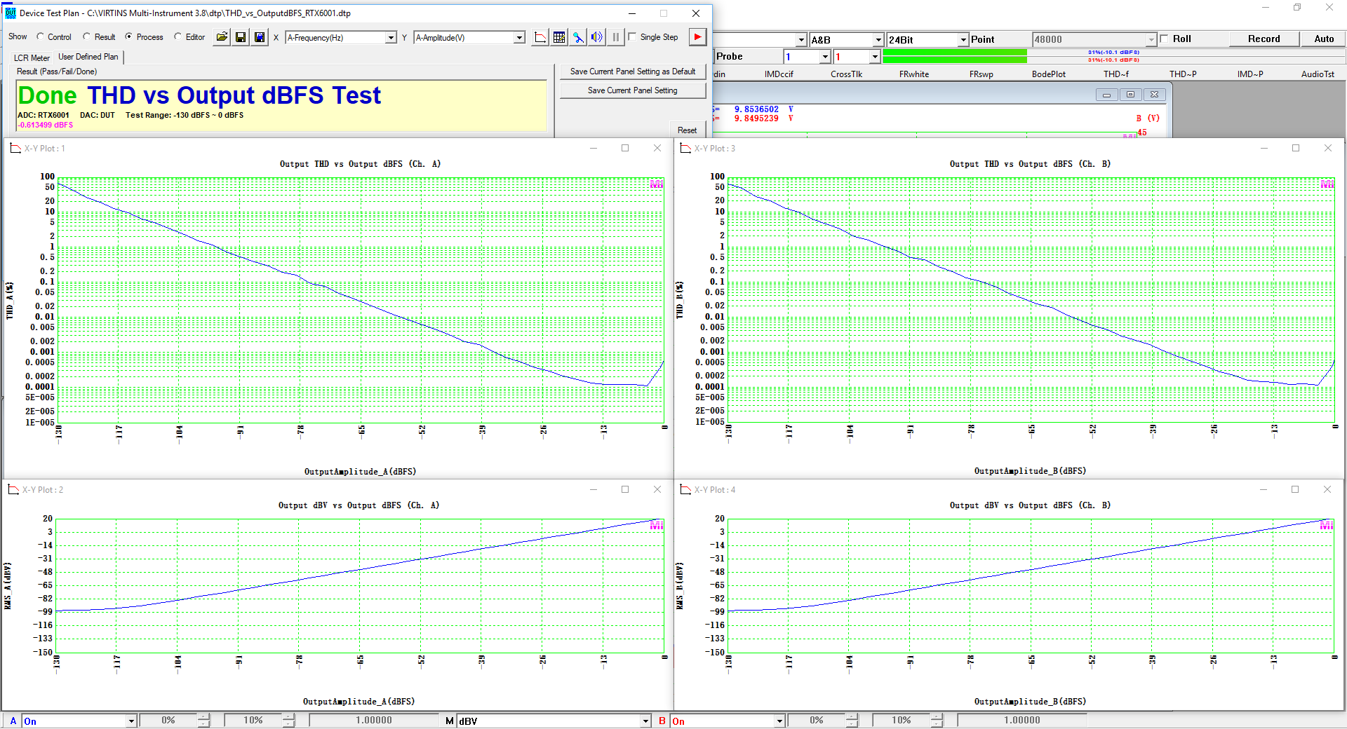

Virtins, Does MI have inbuilt panels to perform a linearity test on a DAC? This test would sweep digital input level from 0 dBFs to -130 dBFs and track output amplitude with expected value. Many thanks.
The function "THD vs output dBFS" and "Output dBV vs Output dBFS" is now available in V3.8.5.2. You can load the Device Test Plan named "THD_vs_OutputdBFS_RTX6001.dtp" to perform the test. It can be used to measure a DAC using RTX6001's ADC. This device test plan is configured using variables and is able to perform RTX6001 input autoranging based on -3 dB criterion. The step from -130dBFS to 0dBFS output is also configured as 3 dB. There are only 20+ test steps in total. So these parameters can be easily found and modified.
Please note that in this test plan:
1. [Setting]>[ADC Device]>"Device Model" should be set to "RTX6001 ASIO" or "RTX6001 MME".
2. [Setting]>[DAC Device]>"Device Model" should be set to "Sound Card ASIO" or "Sound Card MME" and the DAC under test should be selected in "Device No." selection box.
3. [Setting]>[Calibration]>"Sound Card Output Calibration Factor">"Range (V)" should remains as "±1V" (the default value). It is used as the 0 dBFS reference in this test plan.
The following is the test result of RTX6001's own DAC @20dBV. (It was switched to the 20dBV gain setting when [Setting]>[DAC Device]>"Device Model" = "RTX6001 ASIO". After that, let [Setting]>[DAC Device]>"Device Model" = "Sound Card ASIO" and "Device No." = "RTX ASIO Driver"). During this test, the input range of RTX6001 will automatically changed from ±141.4mV to ±44.72V as the output dBFS steps up from -130dBFS to 0dBFS.
