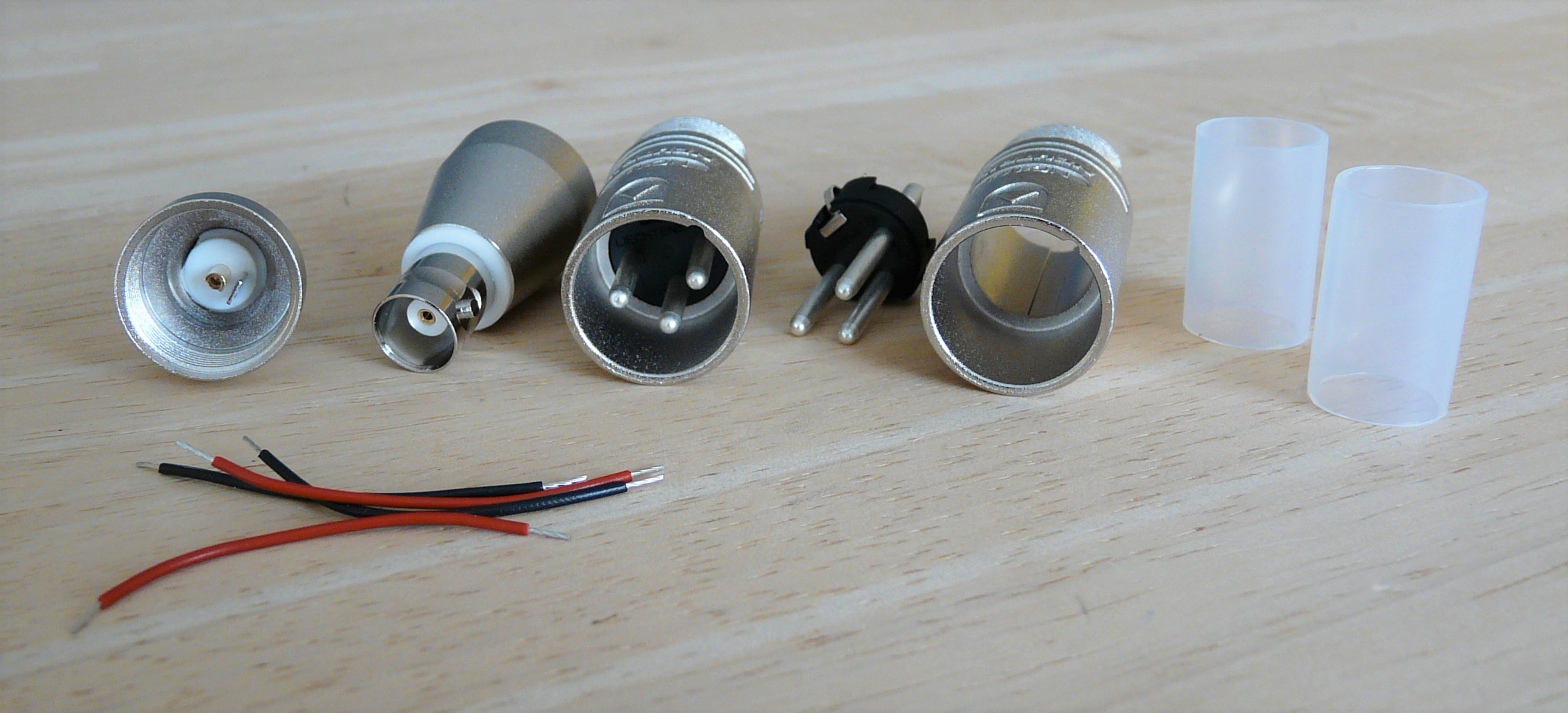

XLR-BNC adapter
The RTX only has XLR inputs to the analyzer, so if you do single-ended measurements you need an adapter. These are standard products and most people have them in their parts box probably.
But there can be a catch, which I ran into. For XLR, pin 2 & pin 3 are the signal pins, pin 1 is the equipment chassis connection. You should never connect pin 1 to signal ground as this normally causes noise on the signal lines.
In XLR-BNC adapters one of the signal lines, normally pin 3, is interconnected to pin 1, opening up the possibility of ground loops and noise.
What to do?
Neutrik (as often) to the rescue. They sell XLR-BNC adapters that are un-assembled where you can wire the internal connections as you want, complete with a pair of stripped short wires! See the attached picture. I build up a pair with the central BNC to pin 2 and the BNC 'ground' tag to pin 3. (The BNC 'chassis' is isolated from the XLR shell). I kept pin 1 internally unconnected; when you plug it into the RTX it connects to the chassis through the shell, and that is how it should be.
When you look for these adapters on the Neutrik website, you won't find them (at least I didn't); you only find NA2MBNC, which is internally wired with pin 3 and pin 1 interconnected.
But Mouser sells the unwired version as NA2MBNC-UW (UW stands for un-wired). The female version is NA2FBNC-UW.
Jan

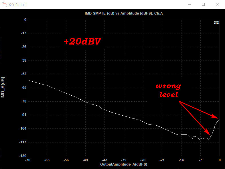

Hi to all,
I try to capture an IMD-SMPTE vs Amplitude measurement (dB scale) via DTP Tool in dB scale.
At my first effort, I modified an exist dtp file for that purpose.
I inserted as "Data to Captured" the:
  1. IMD-SMPTE, Ch.A (dB),IMD_A)dB)
  2. Amplitude, Ch.A (dBFS),OutputAmplitude_A(dBFS) and removed the old ones.
Then, I choosed a X-Y Plot with IMD-SMPTE (dB), Ch.A and Amplitude (dBFS), Ch.A, I saved the dtp file and ran it.
Almost everything went well (see at the end).
But, if I reload this dtp file again, the variables of X-Y Plot have dissipated and IMD-SMPTE vs Amplitude is appeared.
Of course, if you run the routine, data values don't captured.
Another issue, is a kind of artifact at the graph capturing when the output gen rating jumps to the next range (for example -20dBV->0dBV).
It seems that the level of capturing is changing and causes a different graph at this area.
I would realy appreciated if someone give me a help...
My mistake was that I changed the Alias name of Derived Data Point (DDP).
For example the DDP IMD_A(dB) has an Alias IMD_A(dB), this alias is the text that presented on X-Y axis.
Because I don't like the text "IMD_A(dB)" but I preffer the "IMD-SMPTE (dB), Ch. A", I changed the Alias text. And the problems begun...
Now I have a right dtp file that works well every time that running (see the capture).
But, I would like to improve it.

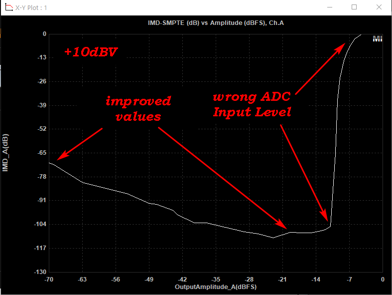

This dtp file opens the psf file \psf\RTX6001\IMD_SMPTE_60Hz(4)_7kHz(1)_FFT131072_RTX6001.psf that has a specific ADC Input Level. Accordingly to this level the precise of IMD measuring changing.
See the attachments files, they are IMD-SMPTE capturing in different ADC Input Levels.
As you can see the low or high level of capturing relates with the input aplitude of ADC.
Here, I prefer to determine the exactly ADC level at the dtp file to have an optimum capturing of IMD.
The manual of Mi-Pro says that the SIR Instruction set the input Range by A-Amplitude (V) area.
This area can be a real number (V) or variable (x1-x5), but I have error with all of that. All the time I have the message "Measuring range not supported"
Any help about this?

@lemon, thank you for your questions.
As you have already figured out, the aliases of the DDPs to be captured “IMD-SMPTE, Ch.A (dB)” and “IMD-SMPTE, Ch.B (dB)” contain a comma “,”, which happens to be the control character in a DTP file (a Comma Separated Variable (CSV) file). It interferes with the data parsing process when loading a DTP file. We have thus tightened the input validation of the Alias edit box in the DTP configuration panel in the next version. Thank you so much for your finding.
Your DTP uses a fixed Input Ranges for varying output voltage. It does not contain an auto ranging function for optimum distortion performance. Although it is possible to implement an auto ranging function by explicitly specifying the Input Range of RTX6001, the number of steps required will be much more than a DTP using a variable based method instead (see attached).
The attached DTP uses Variable x3 for the output voltage of the DUT and Variables x1 and x2 for the Input Ranges of the two input channels of RTX6001. It contains an auto-ranging function. The auto-ranging function starts the Input Range of RTX6001 from the lowest one: 0.1414V, conducts a trial run (the two "sio*" steps. The first one is used to actually switch the Input Range. It allows RTX6001 to become stable after the possible relay switching before the trial measurement is performed by the second one) and steps up by 10dB (the RTX6001’s attenuation incremental) if the measured PeakLeveldBFS in the trial run is greater than -3dB. The last “SIO” step is the real measurement and only the DDPs obtained in this step are used for the X-Y Plots.
When the SIR instruction is used, the input range value must be within 5% of the hardware supported, otherwise, "Measuring range not supported” error message will pop up. Please also note that the SIR instruction does not actually switch the Input Range until a SIO or STI instruction is implemented.
It seems that the level of capturing is changing and causes a different graph at this area....
It should be reasonable to expect some small difference in distortions when the same test tone with the same amplitude output or input using different voltage ranges of RTX6001.
