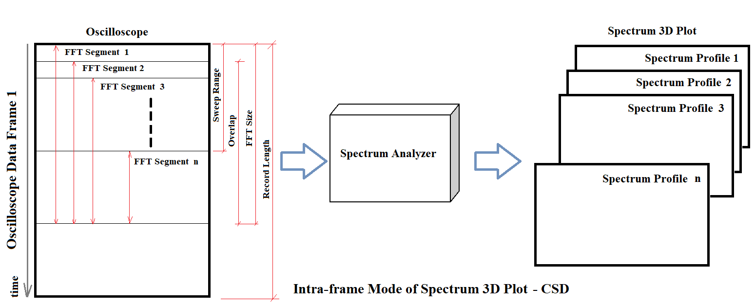

6. Cumulative Spectral Decay (CSD)
This screenshot shows an impulse response (IR) that is 20 ms long and a CSD that spans 19.9 ms or so. The last line of the CSD therefore corresponds to the last 0.1 ms of the impulse response. The Fourier transform of this 0.1 ms long piece would have the lowest non-DC frequency bin at 2/0.1ms = 20 kHz, and the frequency resolution is also 20 kHz. However, the CSD plot in the screenshot is very different, as it shows frequency bins at low frequencies and high resolution throughout the entire time span. What's going on with this CSD?

Good questions.
1. Apparent FFT frequency resolution vs Real FFT frequency resolution
The real FFT frequency resolution is equal to 1/T , where T is the time length of the data used in FFT.
The apparent FFT frequency resolution is equal to [Sampling Rate] / [FFT Size].

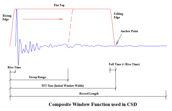

In CSD, the time length of the data used in FFT dwindles as the start side of the data window moves along the time axis. As a result, the real FFT frequency resolution becomes coarser along the way. On the other hand, the apparent FFT frequency resolution remains unchanged as the FFT size is kept constant through zero padding during the sliding process. Nevertheless, the deterioration of the frequency resolution can still be observed because zero padding in effect is equivalent to interpolation.
To answer this, I must use a more precise method with an accuracy of 1 data sample.
In CSD, when the start side of the data window slides along the time axis, there is another parameter – “Overlap Percentage” (see the definition in the figure below) which is used to control the sliding step.
The number of spectral profiles in CSD is determined by:
[Number of Spectral Profiles] = 1+[Sweep Range] / ([FFT Size]-[Overlap Size])
where:
[Sweep Range] = [FFT Size] × [Sweep Percentage]
[Overlap Size] = [FFT Size] × [Window Overlap Percentage]
In that CSD example, [FFT Size] =1024, [Sweep Percentage] =90%, [Overlap Size] =99%, then:
[Sweep Range] = 1024 × 90% =921, [Overlap Size] = 1024 × 99% =1013, [Number of Spectrum Profiles]: 1 + 921 / (1024-1013) = 84 (as shown at the bottom in that CSD screenshot).
The sliding step is then: 1024-1013=11 (samples). This means that the last spectral profiles uses only 1024-(84-1) × 11 = 111 samples. The real frequency solution of the last spectral profile is then: 44100/111 = 397.3 (Hz). The apparent FFT frequency resolution is 44100 / 1024 = 43.07 Hz. The center frequency of the two FFT bins around 397.3Hz is 9×43.07 = 388Hz and 10×43.07 = 431Hz. The software has chosen the better one: 388Hz as the starting frequency of the CSD. I must say your estimation of 380Hz by simply looking at the small graph is very accurate indeed. 🙂
This would mean that in the last line of the CSD, the first data point would be at 431 Hz, the second point at 862 Hz, the third at 1293 Hz, etc. Looking closely at the CSD plot, you can see that this is not the case. The first data point is about 380 Hz, and the data/curve resolution is much higher than 431 Hz. How can this be?
where:
...the apparent FFT frequency resolution remains unchanged as the FFT size is kept constant through zero padding during the sliding process.
I see, you are padding the data with zeros before applying the Fourier transform. I prefer not to do this because it results in a higher apparent resolution (as you explained in your post). I think this is misleading, because it does not show the raw data as it is. It might be useful to annotate the CSD plots accordingly so people know that they are looking at somewhat "fictional" data resulting from Fourier interpolation / zero padding.

I think a higher apparent resolution resulting from zero padding is an advantage rather than a disadvantage here. It does not introduce fictional frequency components, but rather it provides denser spectral lines and eases the so-called “picket fence effect” issue. The signal here is not periodic and is time limited. The Fourier transform of N-point discrete-time samples in time domain (called DTFT, Discrete-Time Fourier Transform) is thus a continuous function of frequency. Sampling DTFT in the frequency domain yields DFT (Discrete Fourier Transform) and its faster version FFT. This frequency domain sampling can be of any points. The common DFT and FFT algorithm happen to use the same number of points as that in the time domain for the purpose of easy calculation and convenience, i.e. N points in the time domain yields N points in the frequency domain. It possible to make use of the common DFT or FFT algorithm to extract more than N points from the same continuous DTFT function. The way of doing it is zero-padding. In other words, FFT with and without zero padding are both extracted from the same DTFT function but with different sampling intervals in frequency.

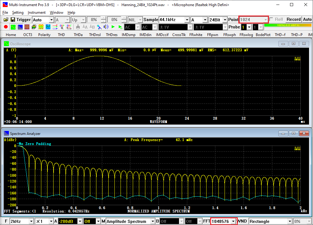

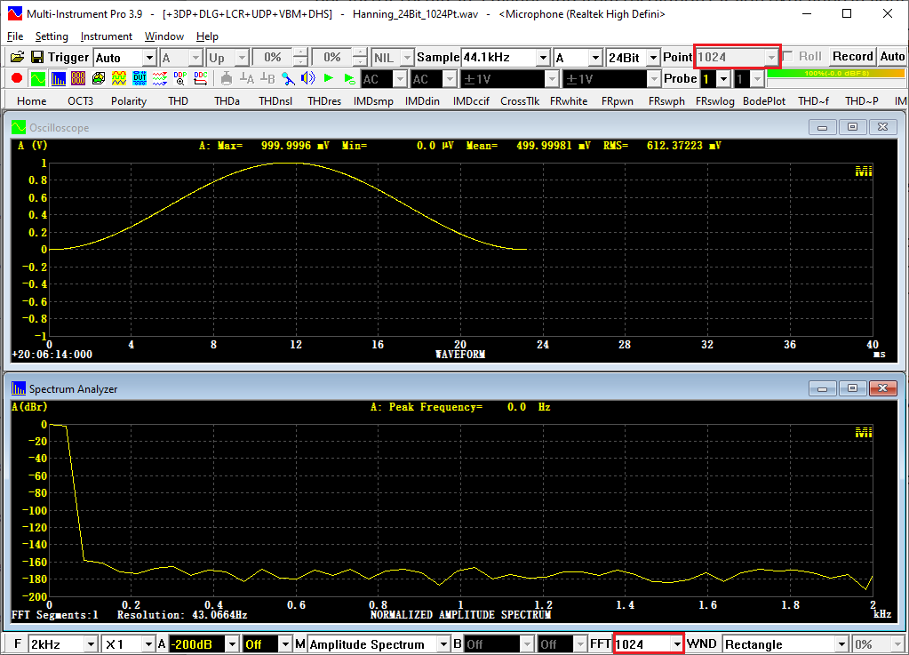

The following two screenshots show an extreme case where zero-padding is a must to ease the picket fence effect in order to reveal the true spectrum of the data. The data in the time domain is a 1024-point Hann window. The first screenshot uses a 1024-point FFT while the second one uses a 1048576-point FFT. In the second screenshot, 1048576-1024 =1047552 zeros are padded at the end of the raw data in the time domain.
[Record Length] = 1024, [FFT Size] = 1024, i.e. no zero padding.
[Record Length] = 1024, [FFT Size] = 1048576, i.e. 1047552 zeros paded.
Obviously, the second one is the well-known spectrum of a Hann window. The first one happens to sample exactly at the troughs of the real Hann window spectrum as shown by the cyan reference curve in the second screenshot and thus creates an illusion.
Back to the CSD plot, zero padding is the defato implementation in various CSD software, even only for the purpose of speeding up. With a sliding step of only one or a few data samples, much slower DFT instead of FFT will have to be used if zero padding is not used. Moreover, different fractional octave smoothing and window functions are usually used in CSD. They will change the outlook of the CSD more drastically than zero-padding.
No fractional octave smoothing is applied in that CSD plot, but it can be applied if needed.
I think a higher apparent resolution resulting from zero padding is an advantage rather than a disadvantage here. It does not introduce fictional frequency components,...
It DOES introduce fictional frequency components! As you wrote, the resolution of the Fourier transform data is 1/T. If the result has higher resolution, data was added that is not in the original raw data. That's what I mean by "fictional".
...but rather it provides denser spectral lines...
Sure, the CSD looks "nicer". But it's misleading, because it shows fictional data. Just plot the CSD without the zero-padding touch-up. In many cases you'll realise that the fence simply is not there. I fell for this more than once.

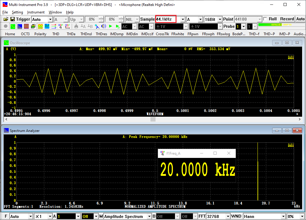

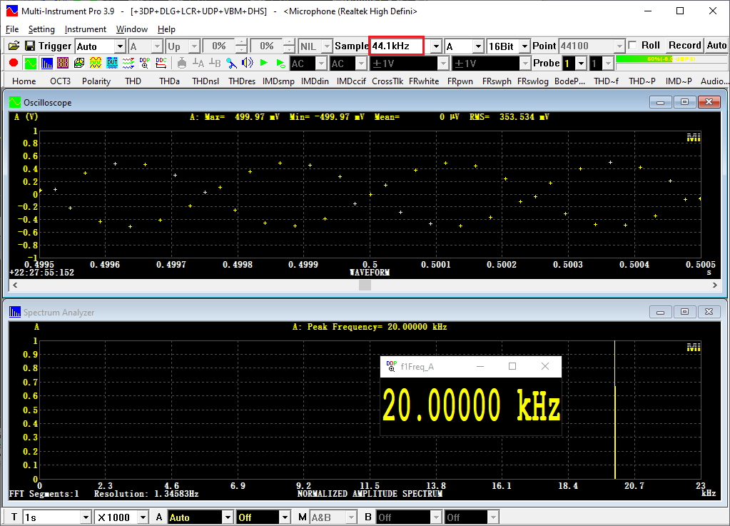

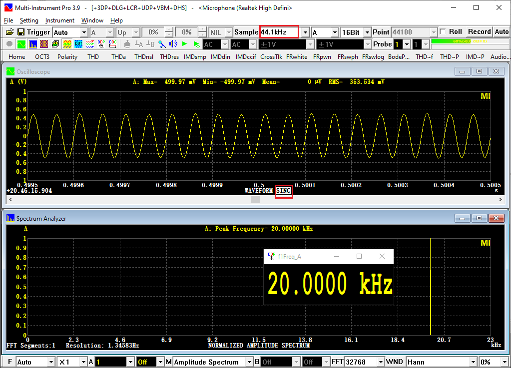

Similar things happen in time domain. Linear interpolation is usually not the optimum option. The following three screenshots show a 20kHz sinewave sampled by 44100Hz (i.e. only 2.205 samples per cycle), with no interpolation, linear interpolation and SINC interpolation (a sort of zero padding in frequency domain in order to get more samples in time domain) respectively. Obviously the last one (with SINC interpolation) is the closest representation of the actual waveform.
No Interpolation
Linear Interpolation
SINC Interpolation
