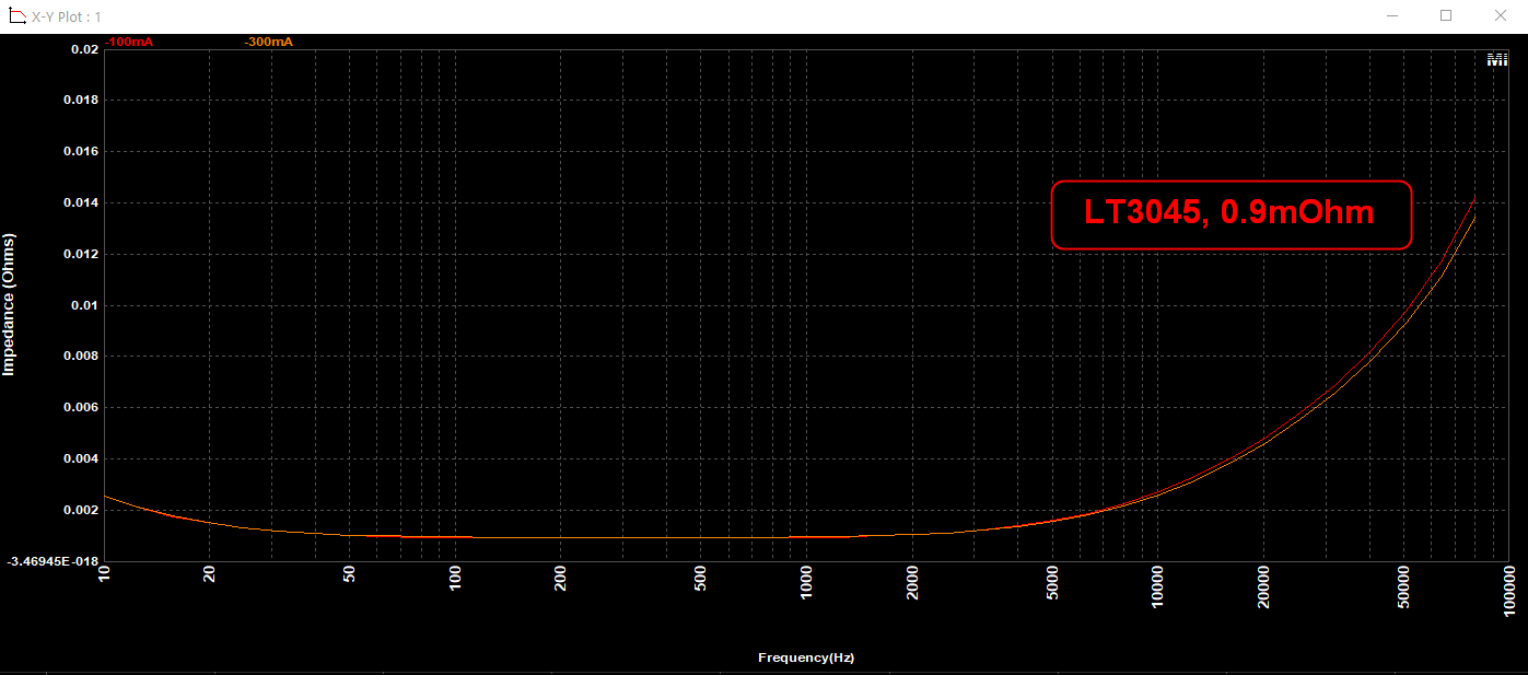

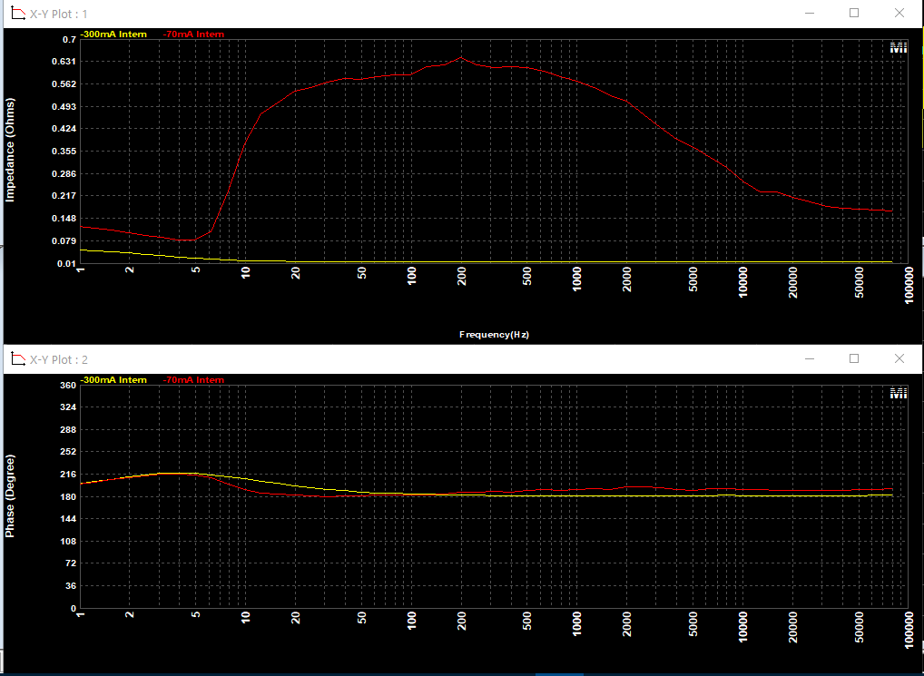

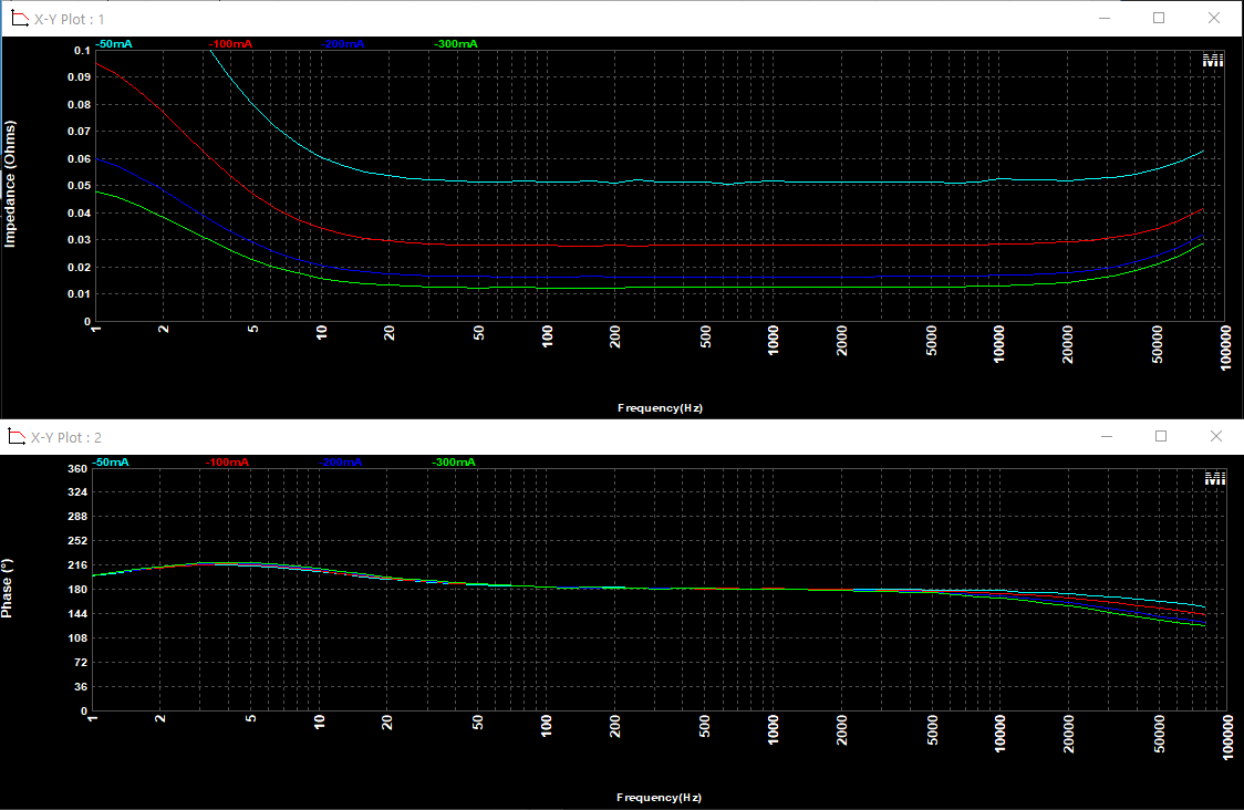

Virtins, I tested a shunt regulator and I observed that with a low internal reg current I took wrong measurements (see the first attachment, the 300mA internal reg current is right but the 70mA internal reg current the graph is completely wrong).

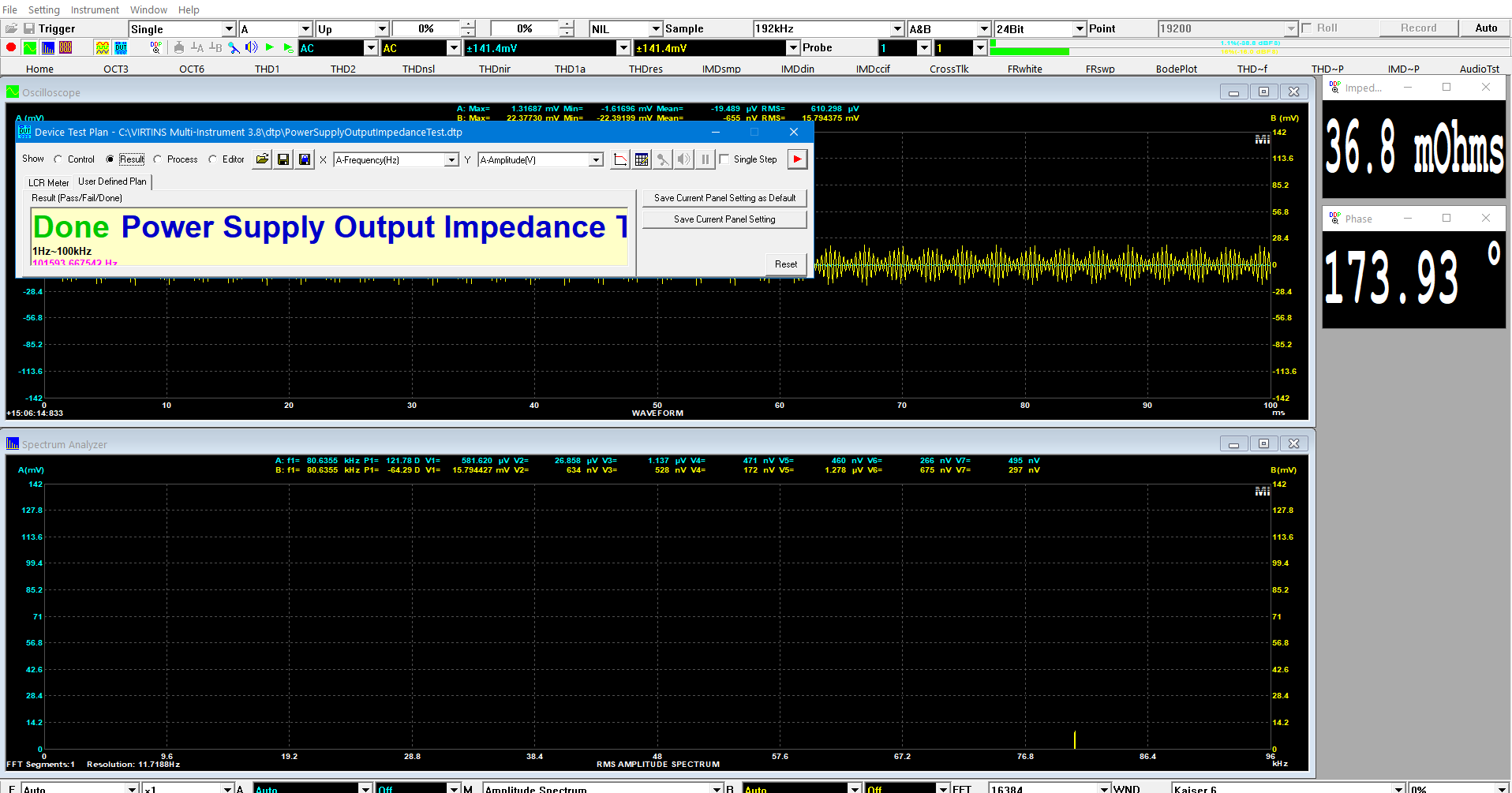

I remember that you had setup the output to 10V differential (100mA current).
I remember the Jan Didden' words that he told me that the generator current not to exceed the 10-15% of total dc load current.
For that reason, I tried to modify the .dtp file and the .psf files to 2V output.
I opened the .dip file -> Editor -> change the steps 10, 14 and 18 from 10V to 2V (I done an insert and then delete the line with 10V).
But, I lost the Impedance and Phase window graph and I can't find how to restore them.
I run the new .dtp, I see that the measurement impedance is right but without graph.
Any help?

When you edit a device test plan, any existing X-Y Plots will be closed. You will need to reconfigure them. After finishing editing the device test plan,
(1) Select “A-Frequency(Hz)” for X axis, “Impedance (ohms)” for Y axis and then click the “X-Y Plot” button to open a X-Y Plot for Impedance ~ Frequency Graph.
(2) Select “A-Frequency(Hz)” for X axis, “Phase (Degree)” for Y axis and then click the “X-Y Plot” button to open a X-Y Plot for Phase ~ Frequency Graph.
(3) Right click each X-Y plot to configure their X and Y Scales properly. Position and size the above two X-Y Plots properly on the screen and then click the File Save button to save the modified device test plan.
The above X selection box, Y selection box, X-Y plot button and File Save button can be found at top of the Device Test Plan window.
The device test plan can also be modified through a text editor such as Windows Notepad. In this way, you will not need to reconfigure the X-Y Plots for this particular case.

From what I have understand, the AC current from the generator is important to right measurement.
A general rule about this, is to be 10-15% of DC-Load Current.
Nice to change the output gen. value output via Notepad, quickly! This change needs to done only to .dtp file not to .psf files, isn't it?

Keep in mind the impedance defined by the active circuitry (instead of a cap) can be quite nonlinear with amplitude. You should look at the supply behavior at currents up to the peak load current. Most supplies are not equipped to sink current (except shunt regulators and designs specifically tailored to that task) so keep in mind the max current you push in. A lot of what you are exploring can be done using a fast load switch (power Mosfet in series with a resistor) to stress the load from off to on and back. Some of the speaker measurement software like Arta could be persuaded to transform that impulse (voltage and current measured) into impedance vs frequency. I don't know if Virtins can do that. Its similar to the load tests for IC power supply chips.
Demian, the non linearity at the graph of post 463, not caused by the PSU but from generator current that was big. The 75-80mV at the V2 point of Virtin's diagram caused overload input.
Because I didn't know how to change the .dtp flle, I done a manual measurement with analogue generator and TrueRMS multimeters - but I had keep the generator current btw 10-15% of total PSU load - without any non linearity issues of PSU.
The Zo was good as LTSpice said.

.dtp is a txt file while .psf is a binary file. Thus a psf file cannot be edited using a TXT editor.

Power supply output impedance generally varies with the DC load. AC perturbation needs to be small compared with the DC current, so that it will not deviate the power supply too much from its normal behavior at that particular DC load. Similarly for power supply control loop test.

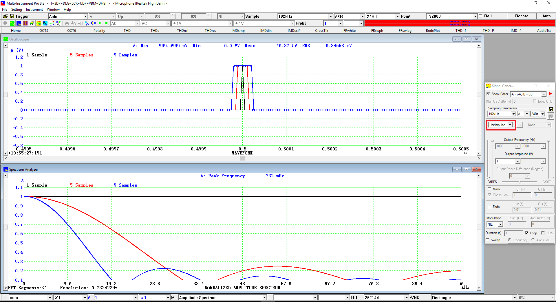

Impulse can be used as a stimulus in MI for (speaker) impedance measurement Methods 1 & 2 mentioned in Post #393. The spectrum of an impulse is flat, similar to that of a white noise. In fact, Bode Plot and Impedance/Phase Plot can be measured in one-shot using any broad-band stimulus (no need to be very flat). The frequency stepped sine activation method gives the highest SNR, though.
By the way, I think I stated wrongly in Post #393 that the existing impedance measurement method 1 & 2 in MI cannot be used to measure the power supply output impedance 😱. It should be possible using Method 1 & 2 through a different connection.
An isolated driver for the powerfet from an audio pulse would be needed I think. How long a current pulse would be required? I would think something like 1 sample. And typically pulses have little energy at low frequencies. Is that a problem here?

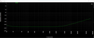

In this case, the perturbation AC voltage across LT3042 is about 90mA x 0.1 x 2.8mohms =25 uV. Based on my previous loopback simulation, the output impedance can be measured with reasonable accuracy even at about 1 uV. The phase measurement will become inaccurate first.
This is fantastic (1 uV) and I am very happy about it!

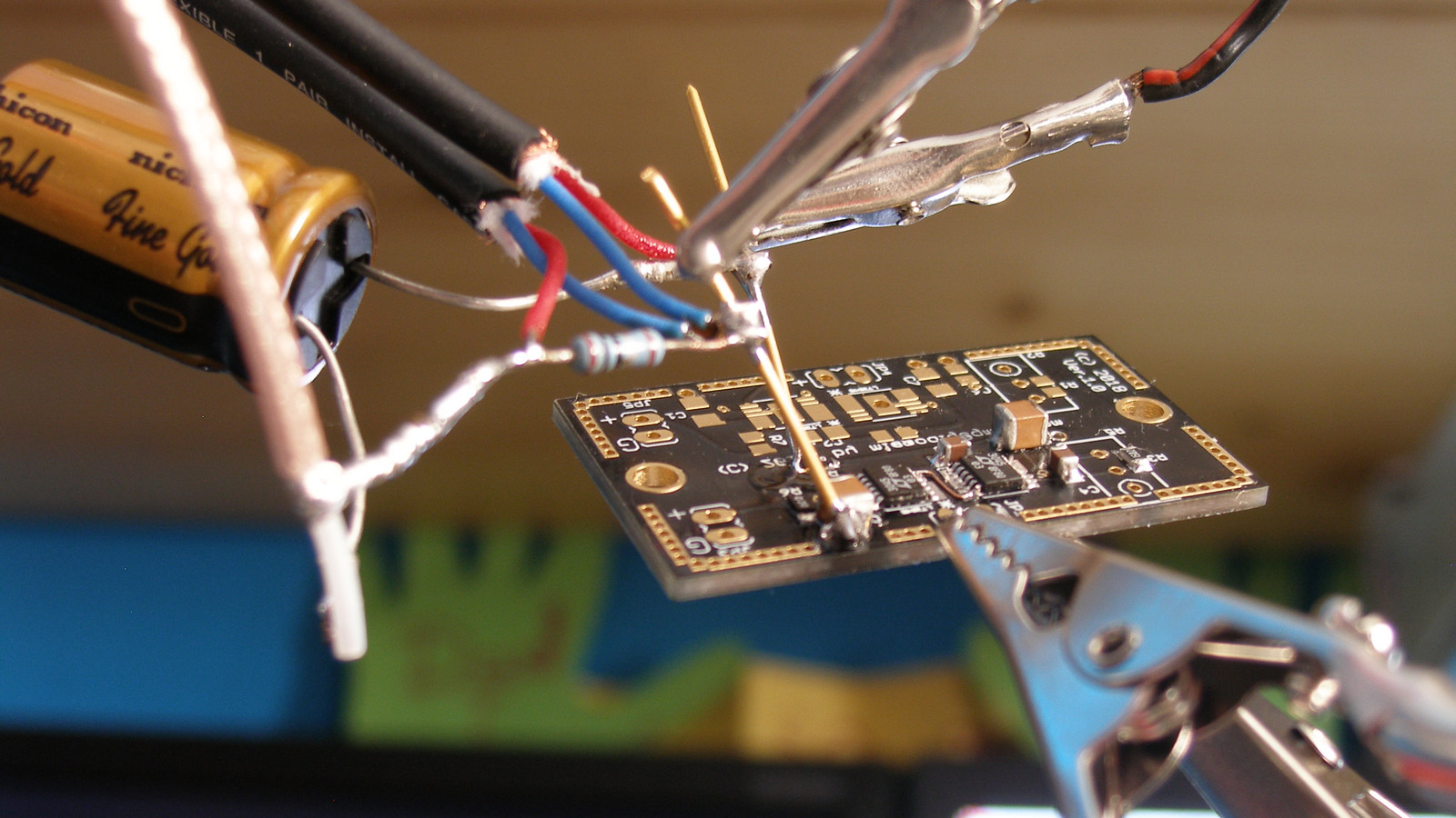

I do some experiments with the LT3042 pcb to find how down can be the Zo!

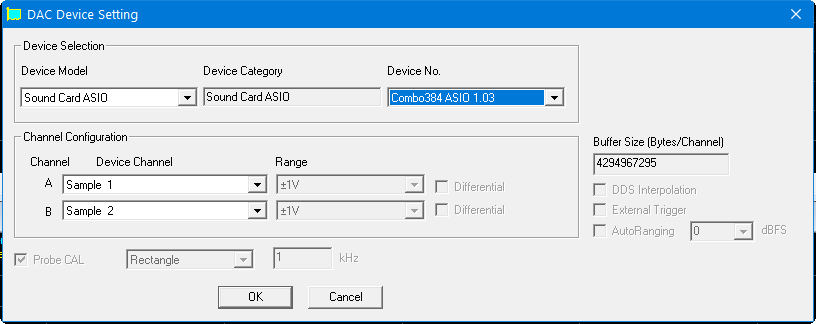

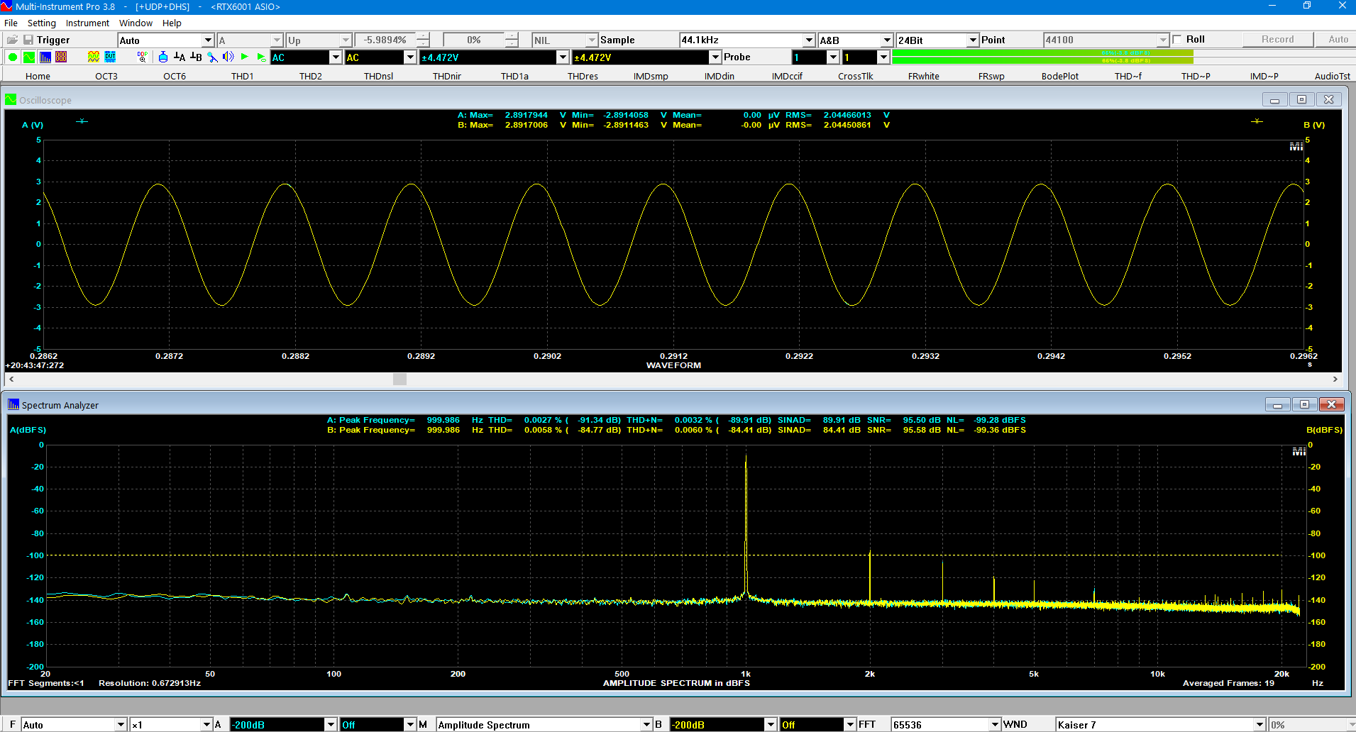

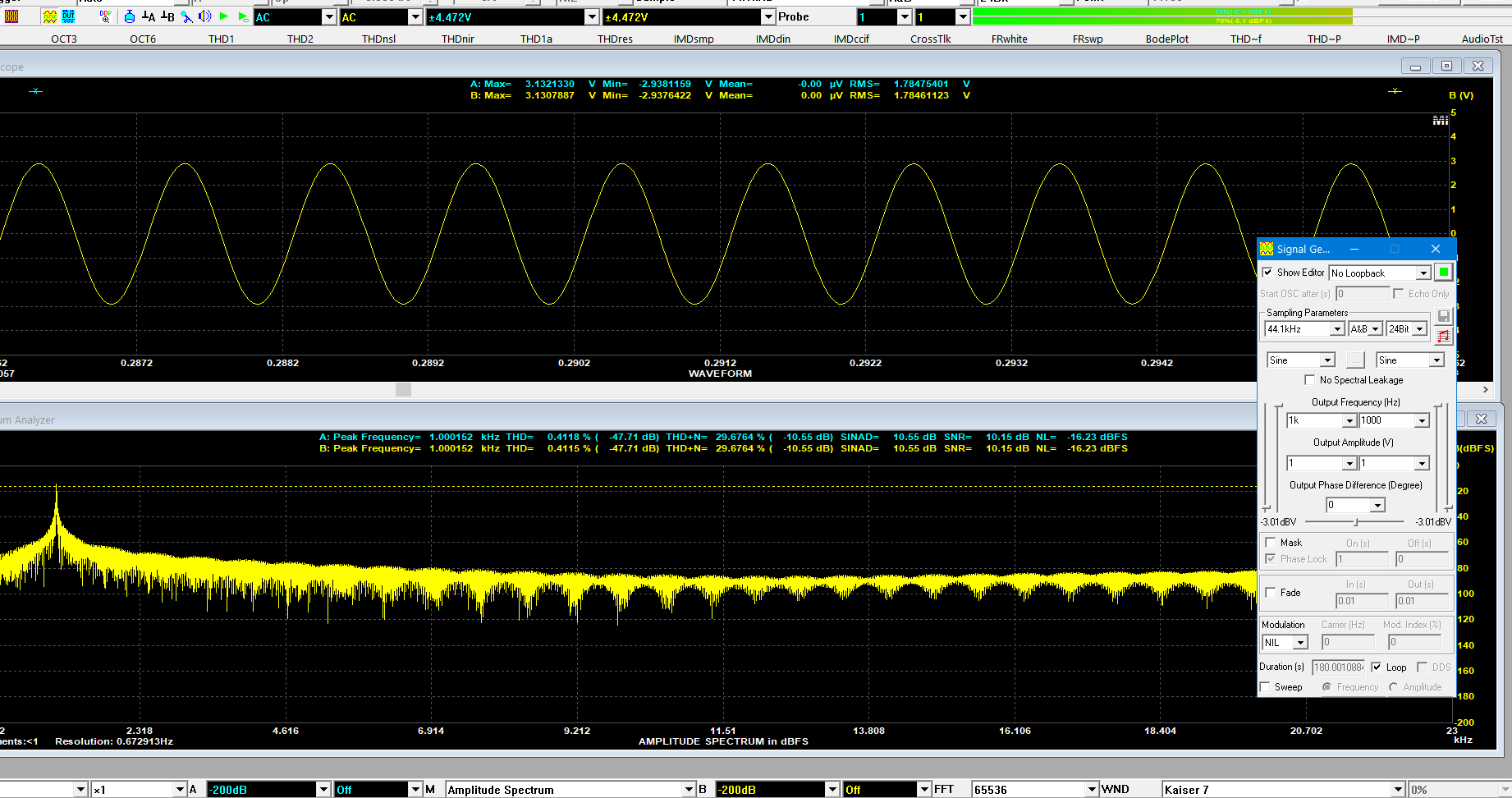

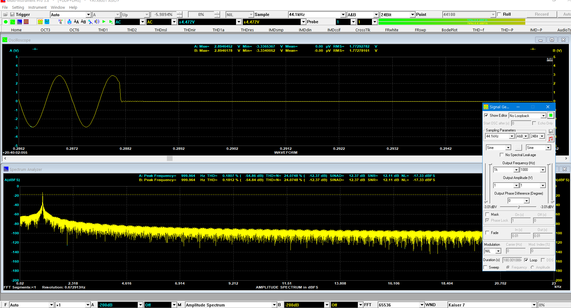

I have a problem to have a THD dac measurement.
If the source was the foobar and the output goes to RTX input, it is OK (capture 4).

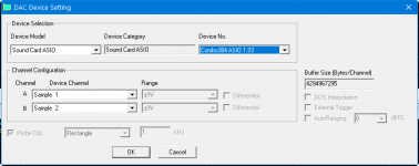

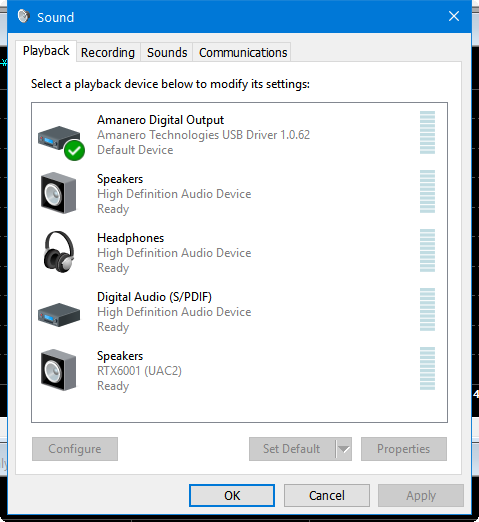

This DAC uses an usb receiver (Amanero Combo).

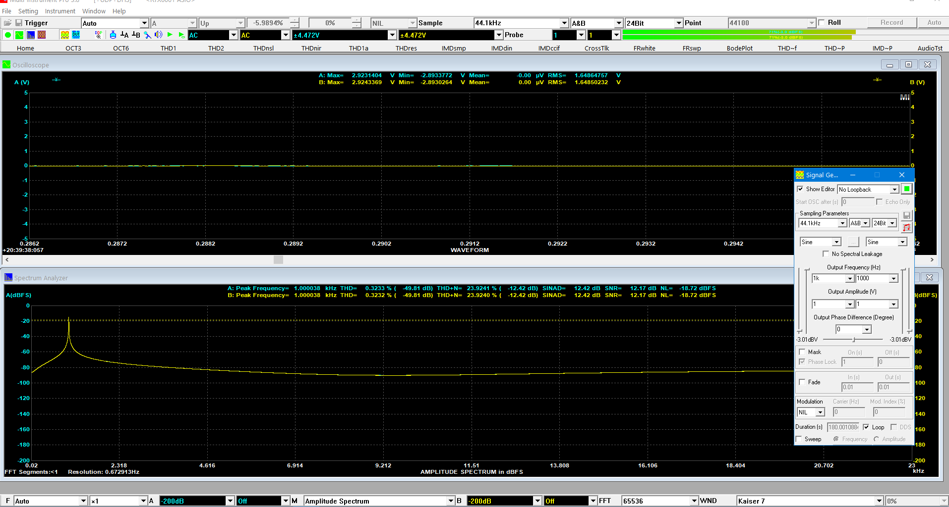

If I choose on the MI DAC section the Asio: Combo Amanero and the MI ADC the RTX as input, I can't take right measurement, the RMS output isn't stable and the oscilloscope captures burst signal or nothing or normal with a random series (captures 1-3). Probably this is normal because double use of the ASIO driver, one for the Amanero and the other for the RTX

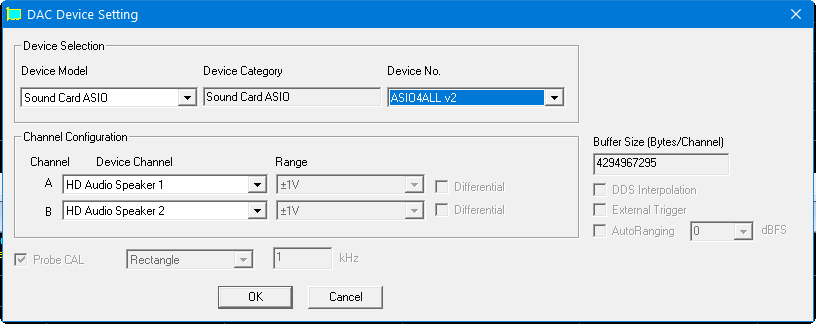

Additional, I tried with Asio4all a driver that have the capable to customize the input and output. At the MI DAC driver, I found the Asio4all driver but only with HD Audio Speaker output.
There is no any other button to customize the asio4all driver.
Of course if I choose as is the asio4all driver, when I press the Play at the Signal Generator, I listen the output from the PC Speaker not via Amanero, the windows audio setup is OK (Win 10 Pro).
Any help?
